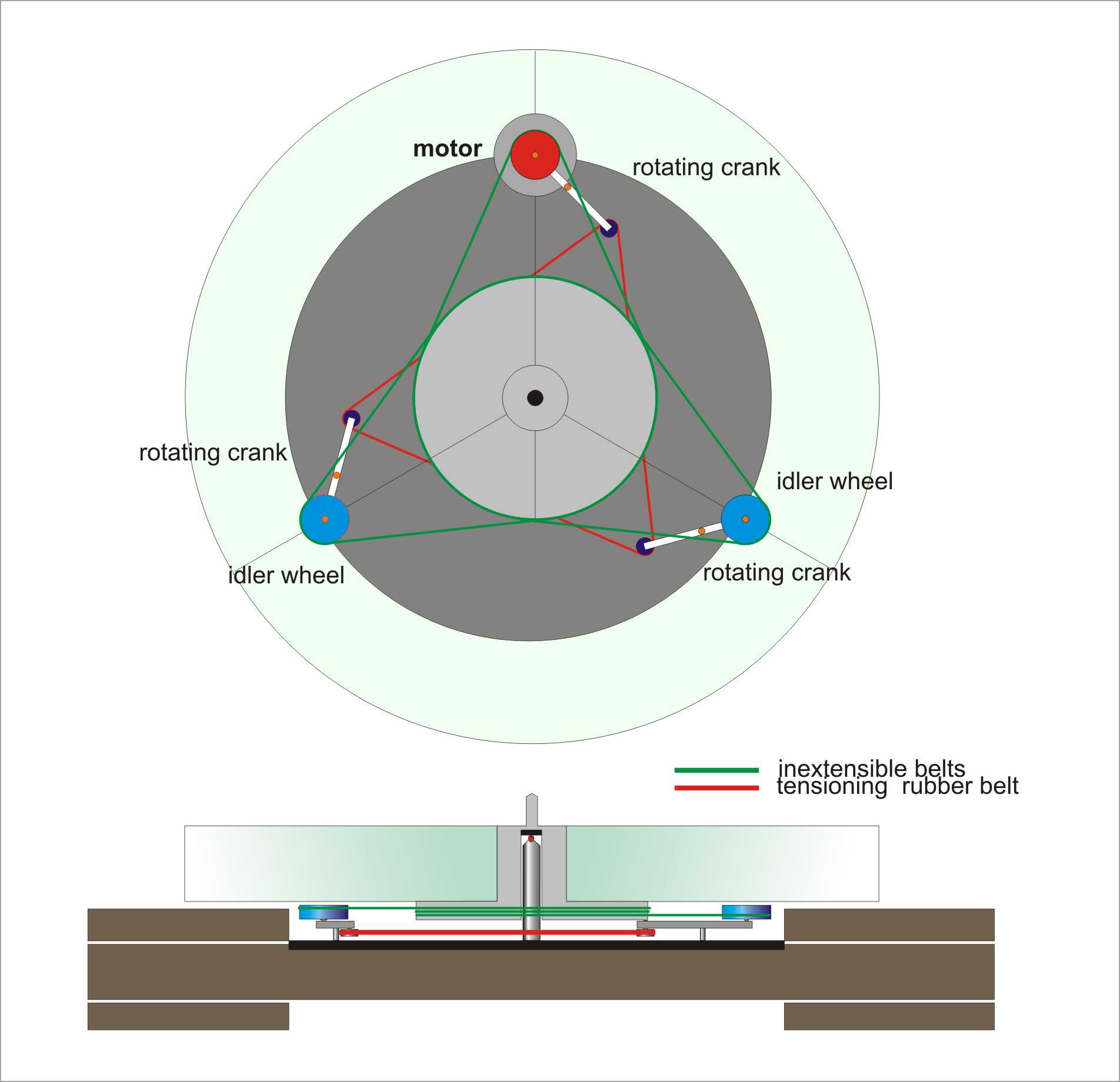

Niffy, since you made me want to put again the hands on a TT, here an idea for your 3 belts...
c
Hi Carlo,
I think the tensioner belt is not desirable as it will allow the idlers to move which in turn will allow the sub-platter to move which will result in a worse runout of the platter. I did have the idea of mounting the motor directly under the center of the platter. I would have three idlers equidistant from the center of the motor/platter with a belt from the motor to each idler then a belt from each around the sub-platter. This would keep the tension on all belts more even and offer greater isolation from motor noise. It would also unload the motor bearing in the same way it unload the main platter bearing. Unfortunately this idea is not retrofitable to my deck so will remain a thought experiment. One motor, six belts. All the advantage of multi-motor without the downsides. Probably.
To set the tension of my belts I measured the stretchyness of the belt material then made the belts to the length required to give the desired tension.

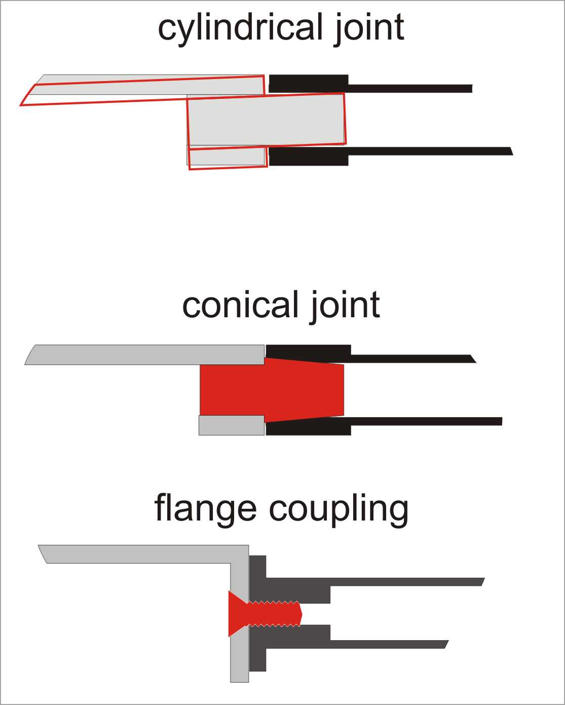

Detachable head shell?
Aside increased effective mass, and 8 useless contacts almost no difference, just remember to braze it to the wand after installing ...
I'm joking, but I think it suffers from a weak design* that can resonate like a reed musical instrument. A simple conical or flange joint would suffice to avoid it, as even the worst mechanic knows. (attachment A)

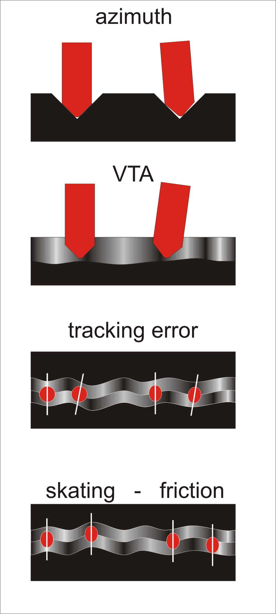

The Azimuth adjustment - imho - has greater consequences than the VTA, as well as skating or carriage friction compared to the (small) tracking error (attachment B - see also attachment on #2556)
Adjusting the azimuth can be very simple, just laying the head shell on a square block on the surface of the platter; hoping that the cartridge manufacturer works with strict tolerances (it's needed machinery and procedures that are anything but artisanal).
carlo
* Shortly after inventing the detachable headshell arm (a very welcome pastime) it's designers came out with the "Series II - improved", without it.
