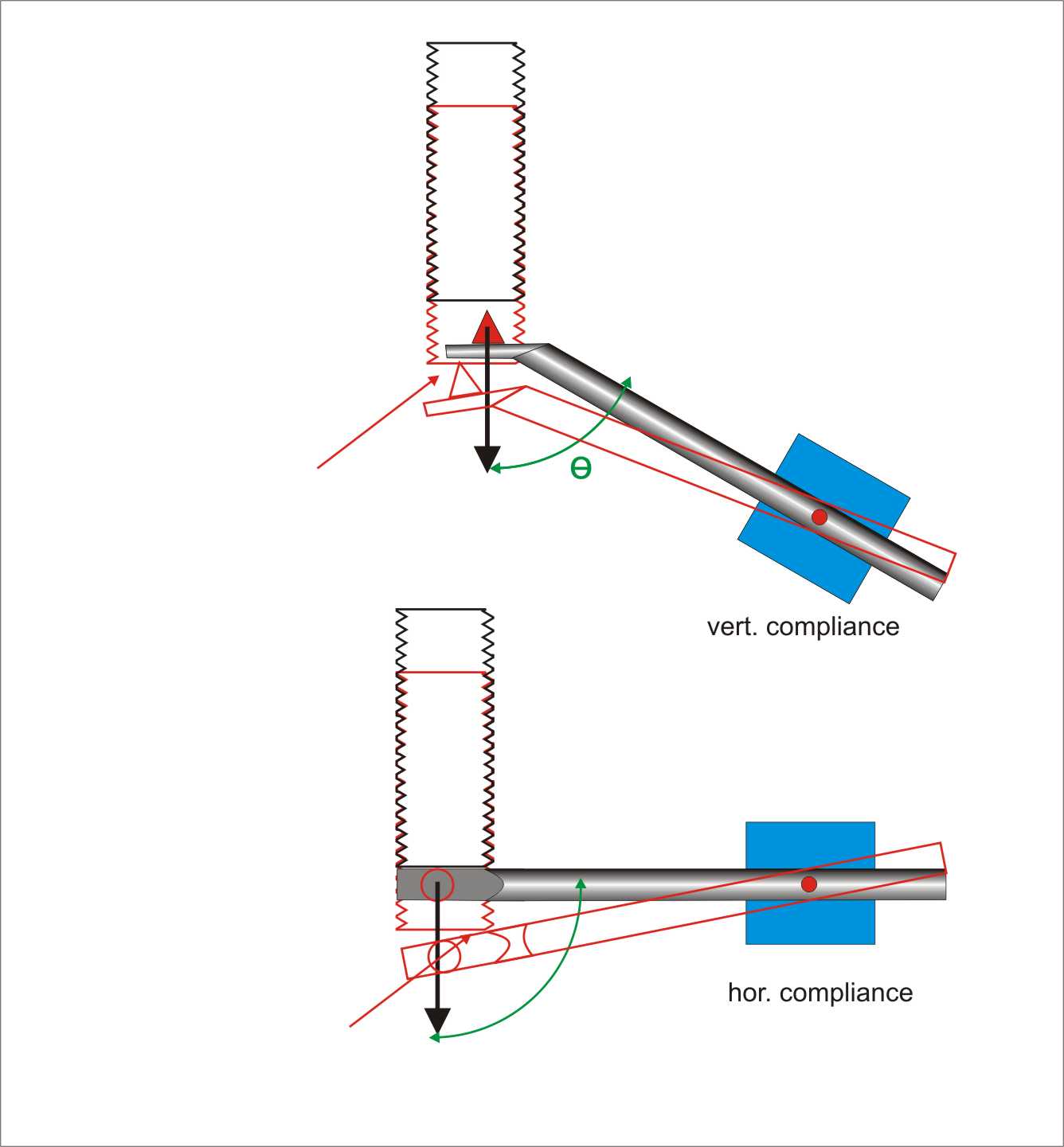

Lil Casey MK2 carbon - measurements
These tests repeat exactly those made for the Lil Casey MK1, with the same inverse pendulum rig and the same calculation procedures (# 2574 for photos and formulas ; # 2605 for results correction)
MK2 - horizontal movement
displacement S = 26 mm - theta angle = 4.26 ° - friction F = 1.63 mN
MK1 was S = 22 mm - theta angle = 3.6 ° - friction F = 1.41 mN
MK2 - vertical movement
displacement S = 32mm - theta angle = 5.24 ° - friction F = 2.01 mN
MK1 was S = 75mm - theta angle = 12.4 ° - friction F = 4.87 mN
The horizontal movement is a bit worse (carbon fibre is maybe softer than anodizing) but the vertical movement has less than half the frictions of before. Reducing weights was worth the effort.
Now vertical and horizontal frictions are very similar, and this explains the fluid and coherent behaviour seen with the macroscope, following easily even almost imperceptible eccentricities or warps like a gimbal TA (MK1 was ok on eccentricities, but faced small warps with the stylus bending).
This was my main target for a radial rail tonearm. But can it be still called a tonearm? there is no arm at all, just a moving carriage with both movements really parallel.

Now since the stylus moves in 45° direction for pure L or R signal, shouldn't be the horizontal and vertical compliance the same? Or should we consider the stereo signal as vector sum of monophonic (L+R, horizontal stylus movement) and spatial signal responsible for the stereo effect (L-R, vertical stylus movement)? In the latter case the difference in hor and vert compliances could cause narrowing or widening the stereo field.
Or not, because the stylus follows the shape of the groove in either case. Perhaps the intention was to move the horizontal and vertical resonance frequencies apart from each other, maybe in accordance to the difference of the excitation signal in the two different planes.

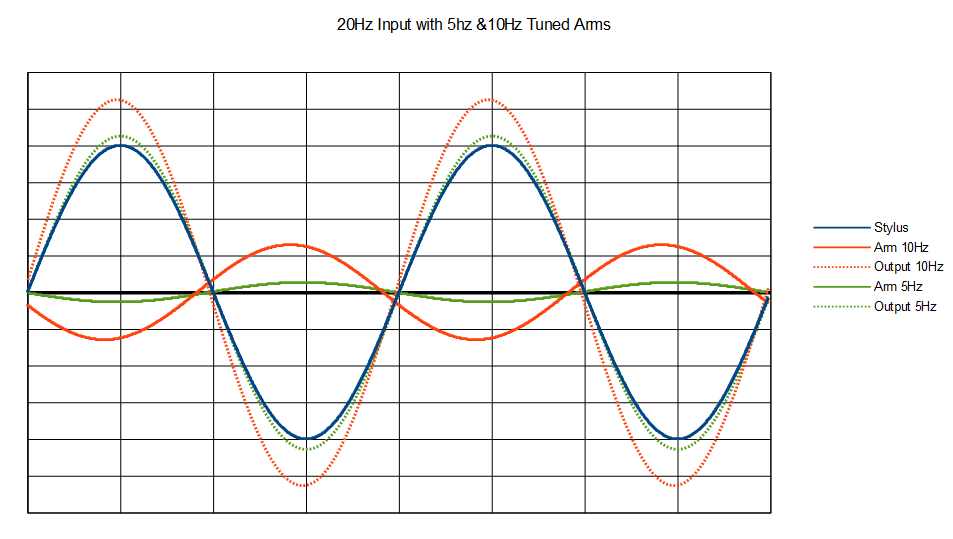

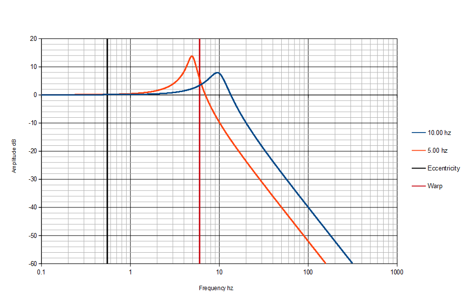

Hi Icsaszar,
It would seem logical to have the compliance and the effective mass the same in both the vertical and lateral planes if we just consider the stylus as moving at 45°. It is better as you suggest to look at the stereo signal as a vector sum. The product of the cartridge compliance and effective mass determines how much the cartridge body will move relative to the neutral axis of the groove. The ideal solution would result in zero relative movement. Due to physical limitations this is not possible. The aim is to select a combination of compliance and mass that will result in the smallest relative movement. Of course the arm also has to be able to track warps and eccentricity whilst keeping the cartridge aligned with the groove. The compliance and mass will result in a resonant system. It is important to ensure that the resultant resonant frequency is above frequency of warps and eccentricity and below the audio band.
The graph below shows the amount that the cartridge body will move relative to the movement of the stylus. The blue trace shows an arm/cartridge tuned to the recommended 10hz. The orange trace is for an arm tuned to 5hz. The black vertical line is at 0.55hz, the rotational frequency of 33 1/3rpm, and represents the frequency of eccentricity. It is also the lowest frequency at which warps occur. The red vertical line represents the highest frequency at which warps occur. Warps at this frequency will be at a very low amplitude.
For the purpose of this graph I have assumed that compliance is constant at all frequency. If the compliance were to decrease with frequency, like with the audio technica, the slope above resonance would be shallower meaning that there would be greater relative cartridge body movement. If the compliance increases with frequency, as I believe the ortofon and goldring do, the slope would be steeper resulting in less cartridge movement. This seems like a better option to me.
The blue trace has its resonant peek safely above the highest frequency of warps and below the audio band.
The orange trace has its resonant peek within the range effected by warps. If the vertical tuning was set to this frequency then warps could cause excessive vertical movement of the cartridge. The resonant peek is however still a long way above the frequency at which eccentricity occurs. At the frequency of eccentricity neither trace is noticeably above the 0dB line meaning there is very little relative movement. The orange 5hz line is slightly higher but is still very low. The really big difference is above resonance in the audio band. The movement of the cartridge body is over 12dB lower with the orange 5hz tuned arm. This is particularly important at very low frequency. At 20hz the blue 10hz tuned arm is only at -10dB whereas the orange 5hz tuned arm is at nearly -24dB.

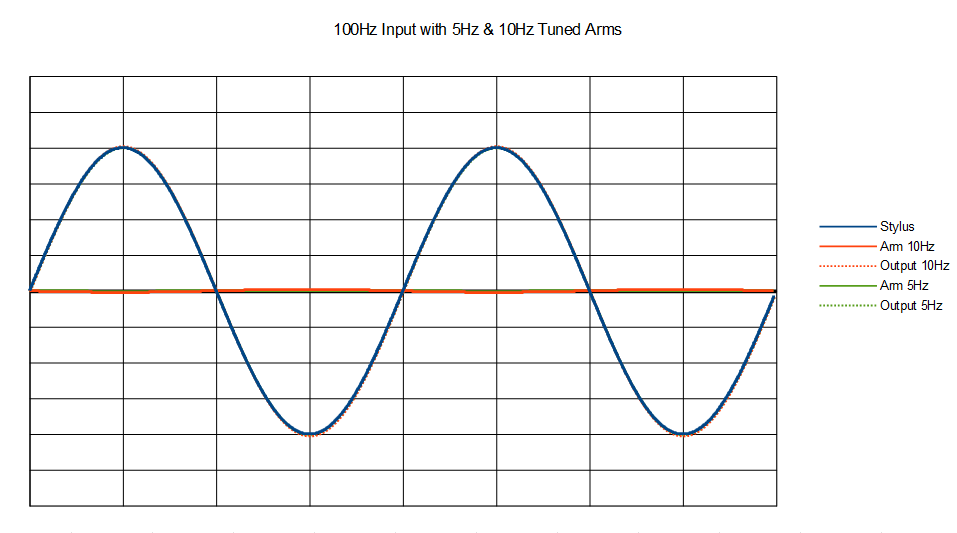

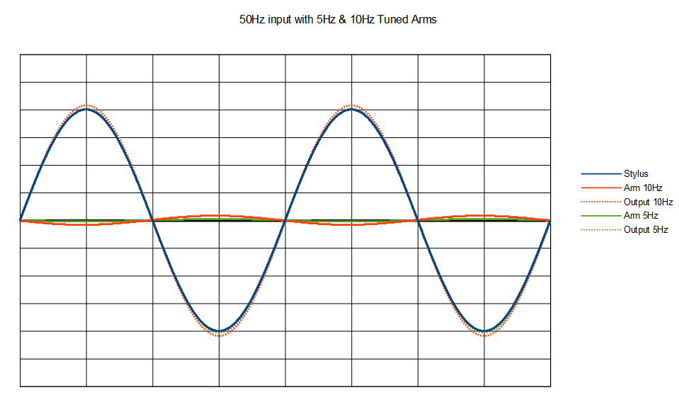

In my arm I purposely tuned the lateral resonant frequency to be much lower than the vertical. The actual frequencies are slightly different to the ones shown here. As warps only occur vertically it does not matter that the lateral resonance is within the range effected by them, it is still way above the frequency of eccentricity. This means that the cartridge body will move a lot less laterally in the audio band than if tuned to the same frequency as the vertical. Mono signals are modulated purely laterally with no vertical component. In order to prevent the stylus from being thrown out of the groove by excess vertical motion low frequencies, below about 120hz, are cut only in mono. By tuning the lateral resonance to a lower frequency results in much lower movement of the cartridge body.
To illustrate this more clearly the following graph shows how much the cartridge body actually moves relative to the stylus with a 20hz sine wave. Again this graph assumes that compliance is constant with frequency.
Above resonance the movement of the cartridge body is out of phase with the movement of the stylus meaning that they are actually moving in the opposite direction to each other. (At resonance the cartridge body will be at -90° to the stylus) This means that the deflection of cantilever will be greater than if the cartridge body was stationary. This can adversely effect tracking so minimising excess motion is desirable.
As you can see the motion of the arm tuned to 5hz is much lower than that of the arm tuned to 10hz, about 4 times lower. The motion of the 10hz tuned arm is really quite large. It does not matter if your speakers do not have significant output at 20kz. If the groove is modulated with very low frequency the cartridge body will move at this frequency. If playing a note in the midrange would you prefer the cartridge body to be stationery or waggling about at low frequency. Of course you would prefer the cartridge body to be as stationery as possible.
As you increase in frequency the difference in cartridge movement between the 5hz and 10hz tuning remains at about 12dB. The absolute difference between the two does however decrease dramatically as the frequency increases. The next two graphs show the relative movement of the cartridge to the stylus with 50hz and 100hz signals.
The difference between the two become almost indistinguishable from the motion of the stylus by the time you get to 100hz. At this frequency the motion of the cartridge body due to the compliance/mass effect is almost zero. (Other factors like bending mode resonance and compression waves will still cause relative motion but these are not effected by the tuning of the arm). So by the time you get to frequencies where there is stereo information, above 120hz, the motion of the arm is essentially the same vertically and laterally.
There are definite benefits to making the lateral compliance and effective mass higher than the vertical especially in the reproduction of bass frequencies. Reducing lateral motion of the cartridge at low frequencies by lowering the resonant frequency has benefits across the entire audio range.

Hi Carlo,
"may this be responsible for the other 10% in my AT95 test? a 0.5 mm shift of the contact point is about 10% of the stylus length."
I would say probably not. The deflection you point out would effectively lengthen the cantilever which would therefore have a greater lever effect. If anything this would increase compliance not reduce it. I think it is much more likely that the manufacturers make the vertical compliance lower than the lateral on purpose.
Congratulations on the substantial decrease in vertical friction and effective mass. The big question is how does the mkii sound in comparison to the mki? The total elimination of the armtube and all the nasties that come with it has got to be one of the main goals of tonearm design.

I would like to understand your graphics better: how are composed the movements induced by the defects of the disk (which are measured in mm) and those of tracking (a few tens of microns)?

Hi Carlo,
All four graphs show relative movement of the cartridge body compared to stylus movement.
The first graph is a log-log plot. 0dB in this graph means that the cartridge body is moving the same amount as the stylus. - 20dB means the cartridge body is moving 1/10th the amount the stylus is. A 6dB difference is equivalent to an absolute difference of double so -6dB of 1mm results in 0.5mm of movement and -6dB of 1micron is 500um. The final three graphs are each at a set frequency and have a linear vertical scale. Again these show the ratio of groove modulation/stylus movement to cartridge body movement. I have added the overall motion of the cartridge relative to the stylus on these three.
I hope this answers your question.
