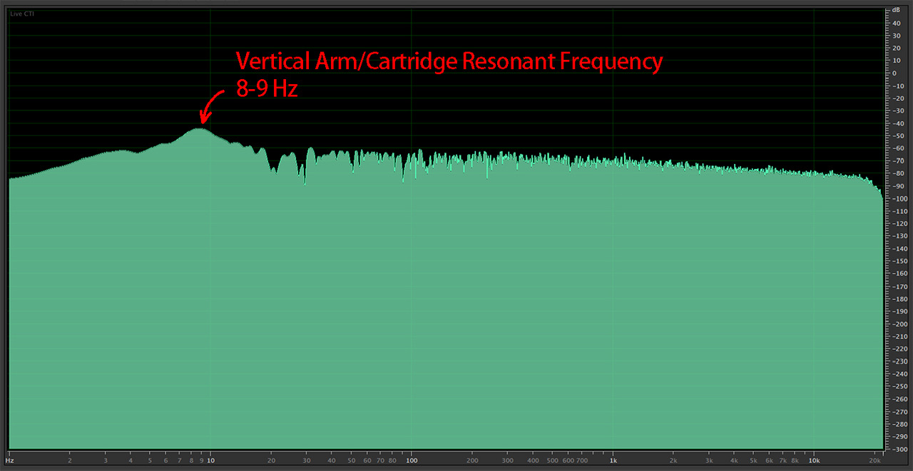

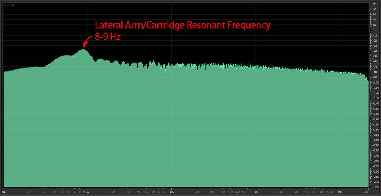

For a pivot arm, its vertical and lateral masses are almost same. Such statement has a precondition, i.e. both fictions vertically and laterally are same.
On my air bearing arms, the vertical and lateral resonant frequencies are same. So, it is safe to reason that its vertical and lateral masses are almost same as well. Please see attached images. The vertical and lateral fictions of the bearing is same, too, just as pivot arm.
For mechanical linear arm, its vertical and lateral frictions should be same ideally. However, it is not always same due to its construction. In order to have same resonant frequencies vertically and laterally for a mechanical linear arm, its fictions and masses should be similar vertically and laterally.

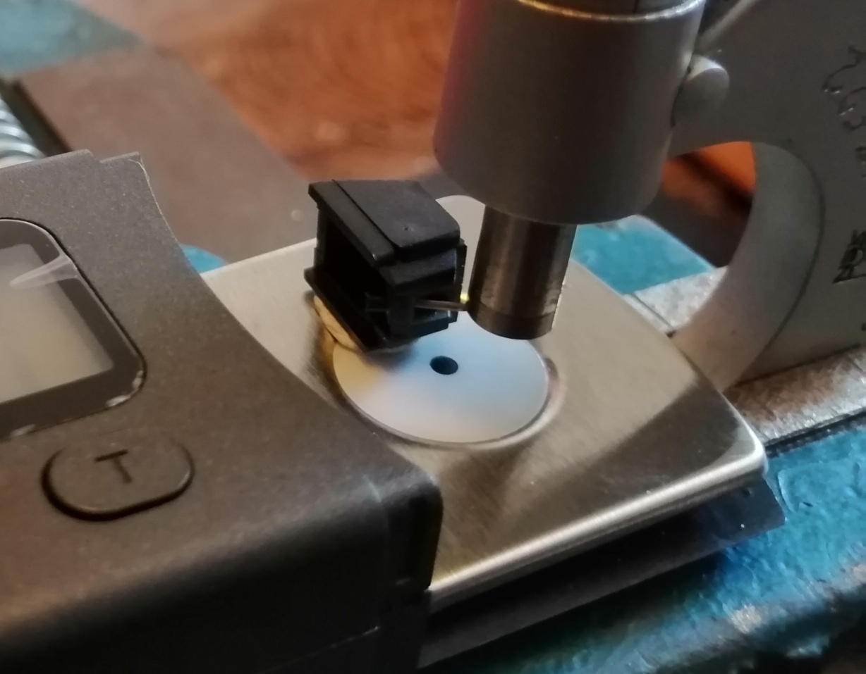

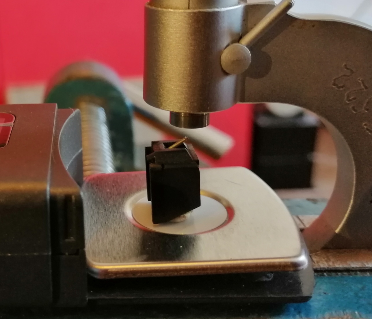

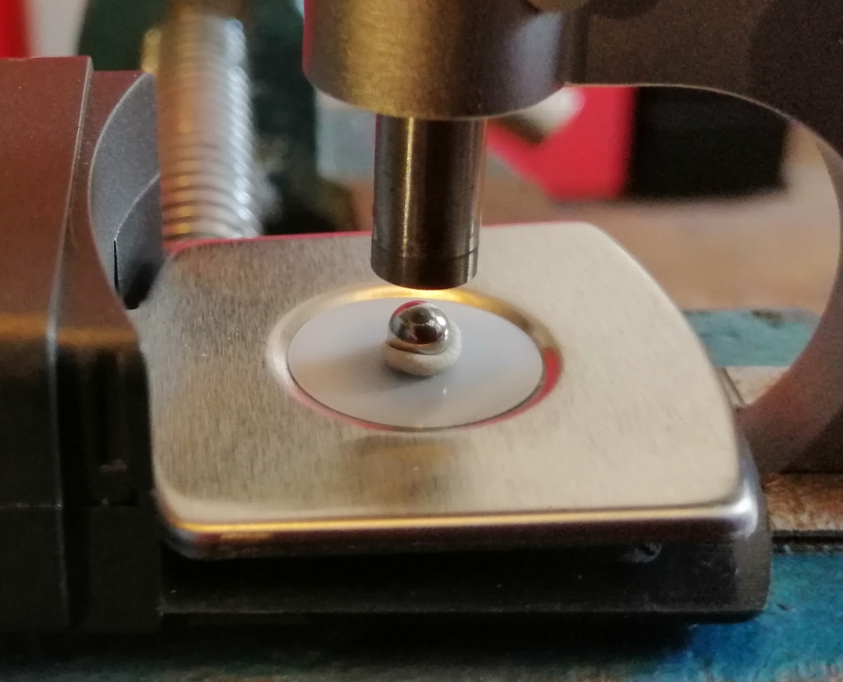

I have just had a go at measuring the static compliance of one of my old cartridges, an Ortofon 520 moving magnet. The set up is really simple. It consists of a micrometer clamped in a vice and a stylus force gauge sat between the open jaws of that micrometer. My micrometer is marked in increments of 10um (0.01mm) so I can accurately lower the upper jaw towards the force gauge in small steps. As I am only measuring the compliance I don't need the whole cartridge, just the detachable stylus assembly. The stylus assembly is placed upside down on the force gauge and secured with a blob of blutak. As the micrometer closes the upper jaw presses on the stylus. The force of this contact is registered by the gauge.
Before I measured the stylus I measured how much the force gauge deflected under load. I varied the load from 0g to the gauges maximum of 5g by gradually lowering the micrometer in 10um increments. I had attached a small ball bearing to the gauge so that the contact would be in the centre of the measuring plate. I was basically measuring the compliance of the force gauge. This would need to be subtracted from the results of measuring the cartridge compliance. I repeated this 5 times so that I could take an average. The tests gave consistent results and showed that the force gauge had a compliance of 1.52um/mN.
I first measured the vertical compliance. Again I made several sets of measurements. I had planned on presenting the results in the form of a graph so changes in compliance with load could be seen. This was unnecessary as the compliance remained consistent with varying load, nothing is more boring than a straight line graph.
Measuring lateral compliance was a bit more tricky. I turned the stylus on its edge and aligned the upper jaw of the micrometer so that its edge touched just the very tip of the cantilever. I again recorded the force resulting from deflecting the cantilever in 10um steps up to 150um. I repeated several times then turned the stylus body over and repeated pushing the stylus in the opposite direction.
The Ortofon 520 cartridge has a listed dynamic lateral compliance of 25um/mN. I had anticipated that the measured static lateral compliance would be a bit higher than this. I also expected that the vertical compliance would be a bit lower than the lateral. I was surprised to find that the static lateral compliance was 16.3um/mN and the static vertical was 11.6um/mN. I had always thought that compliance increased with decreasing frequency so that static compliance would be higher than dynamic. This would tend to suggest the opposite. It is possible that I had mixed up stiffness and compliance somewhere along the lines. Stiffness increases with decreasing frequency? Vertical compliance was lower than lateral as predicted.
Another possibility is that the suspension of this particular cartridge had stiffened with time. It has been 10 years since it was last used. I will have to dig out another stylus and test that to see if I get a different result.
If static compliance is lower than dynamic then it would follow that tracking error due to bearing friction and tonearm inertia would be lower than I had previously calculated, which wouldn't be a bad thing.
Of course the third possibility is that I totally messed up this test and that the results are in error. I don't think this is the case and I really don't like the idea of throwing away data just because it doesn't fit my model.

I couldn't resist and did a quick measurement of my 2M blue cartridge. This is much younger than the 520 and has been in use much more recently. The 2M blue has a listed lateral compliance of 22um/mN. I measured the lateral static compliance at 19.53um/mN and the vertical at 16.54um/mN. This would indicate that I was indeed incorrect in my assertion that compliance increases with decreased frequency. It would also suggest that the suspension of the 520 cartridge had stiffened with age. The decrease in lateral static compliance compared to dynamic is not great, 11%. This would mean that the standard equation for determining the resonant frequency of the system based on published compliance figures will be reasonably accurate laterally. The vertical compliance is quite a bit lower than the published lateral figure, 25%. This may cause problems when calculating vertical resonance. You can probably use a slightly heavier arm than the equation would suggest.
If these measurements are accurate then, as I said in the last post, the tracking errors due to friction etc would be slightly lower than previously calculated.

Hi Jim,
I think we are pretty much in accord. In combination with the cartridges compliance the effective mass puts the resonance at the correct frequency. The damping then controls the amplitude of said resonance.
A lower resonant frequency will mean that the cartridge body will be moving less at audible frequencies (which is good) but will be more likely to be excited by warps or eccentricity (which is bad).
I still don't understand why it is important to have the resonant frequencies at the same (or similar) frequency.
Niffy
Niffy

I'm pretty certain that the measurements I made were reasonably accurate. Both the scale and the cartridge seem to be very linear which makes calculations much easier. A 10mN force would deflect the scale by 15.2um. With the 2M stylus fitted the total deflection laterally would be 210.5um. The deflection of just the cantilever would therefore be 195.3um or about 0.2mm.
When measuring laterally the micrometer only touched the cantilever adjacent to the stylus so the readings will be the same as if the micrometer was actually touching the stylus. The difference in the vertical and lateral readings is due to the compliances actually being different and not how I took the measurements.
Niffy

Carlo asked what the deflection would be with a 10mN force. I assume this is because he used a 10mN force when testing his cartridge. I calculated the static lateral compliance to be 19.53um/mN. With 10mN of side force the cantilever would be deflected 195.3um. The 210.5um would be the total deflection measured on the test rig with a 10mN load. 195.3um of this is due to the deflection of the cantilever and 15.2um due to the flexing of the stylus force gauge itself. Added together they equal 210.5um and doesn't represent anything outside of this test. There is no "standard deflection" during operation. The deflection of the cantilever will be constantly changing due to the ever changing forces acting upon it. One of the aims of tonearm design is to make these deflections as small as possible so only the relative motion of the stylus due to groove modulation remain. The aim of these tests was to get a better understanding of the compliance of the cartridge. Compliance is a very important aspect of the cartridge that determines how it interacts with the record and the arm.
Niffy
