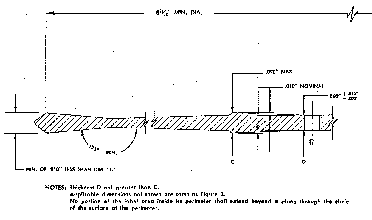

In my books the last thing you want is a recess cut in the centre of the platter for the label. If you do have a recess and then use a central clamp the record will be pressed down into the recess in the middle. The edge of the recess will act as a fulcrum pushing the outer edge of the record upwards and away from the platter. This will also have a habit of excentuating warps. All round a bad idea.
It is much better to do exactly the opposite. In the centre of my platter is a 60mm diameter disk whose edge is flush with the surface of the platter. The cross section of the disk is a smooth sin wave that rises 1.2mm above the surface of the platter at its centre. I use a screw down clamp as much greater force can be applied than with a gravity clamp and it doesn't load the bearing. The clamp has a recess, also 60mm in diameter, on its lower surface. As the clamp is screwed down the outer edge of the record is bowed downwards onto the platter. As the clamp is screwed down further the entire playing surface is forced into intimate contact with the platter. This is an excellent way of getting rid of warps as well. This type of clamp is called a Reflex clamp. It actually works as a vacuum hold-down with most records. After I remove the clamp I have to use my thumb nail to lift the edge of the record to let in a bit of air before I can lift the record off the platter. Only the most warped of records have any gaps between record and platter.
It is true that many vintage record players had thick ridged rubber mats. It is also true that many vintage record players sounded awful. I think there might be a connection. I have heard many a vintage deck sounding fine, but they all had upgraded platters and mats.

Hi Niffy,
I personally like recessed label area of platter. If the diameter of recess area is slightly larger than label of record, and the diameter of clamp is slightly larger than recess area, it won't introduce warp. If you put a thin piece, donut shape and slightly thick than the height of recessed area, of rubber around spindle, it may even reduce warp.

Hi Jim,
If you make the recess larger then the label and the clamp larger the recess the cartridge will hit the clamp. The label comes up to a couple of millimetres from the runout groove.
If you are putting the donut of rubber underneath the record you are making the central point where the record contacts higher than the surface of the platter. By using the donut you are converting your central clamp into a Reflex clamp.
When I used to own the pink triangle deck I used it with an SME clamp. This clamp gripped the outside of the spindle then pulled down. It was nice as it didn't need a threaded spindle. It's a really solid piece of kit, probably the same as the one you have. The pink triangle had a label recess but I used a penny washer to convert it into a reflex clamp. It didn't work at all well when used without the washer. My current smooth dome is a refinement on the washer idea and does seem to work quite a lot better.

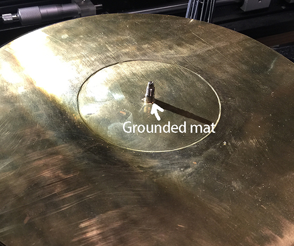

Hi Niffy,
You are right. I measured my table. The diameter of reassessed area is 11 cm. Actual reassessed area may be smaller because I cover the platter with my DIY mat. Record label is 10 cm. The diameter of SME clamp is 8.8 cm.
Here is a photo of my diy mat. It is brass sheet I bought from Blick Art supply store. Cut in size to glue on top of 1 mm donut shape carbon fiber.

Niffy,
I used a small hammer to hit the middle of brass sheet to make reassessed area.
The bearing of SME 20 is grounded and the spindle sits on a steel ball. I got the inspiration from Benz LPs cartridge. The motor of Benz LPs sits on solid brass. In the process of building my linear arms, I tried many shims made with different material to see how it affected sound. Brass is one of my favorites. My other favorites are carbon fiber, 2024 aluminum, magnesium. Brass mat is natural extension of my knowledge for material.
Does the brass mat reduce static? It is a tricky question to answer. I used have a lot of statics in my room under certain weather conditions sometimes. I could hear low pops noise while I was taking records off the platter and thought to get an anti-static fan to reduce statics. But it never happens since I installed the brass mat. So, I assume it works. At beginning, I used copper conduct tapes to cover the carbon fiber mat. It did reduce static as well. However, I prefer brass for its sound.

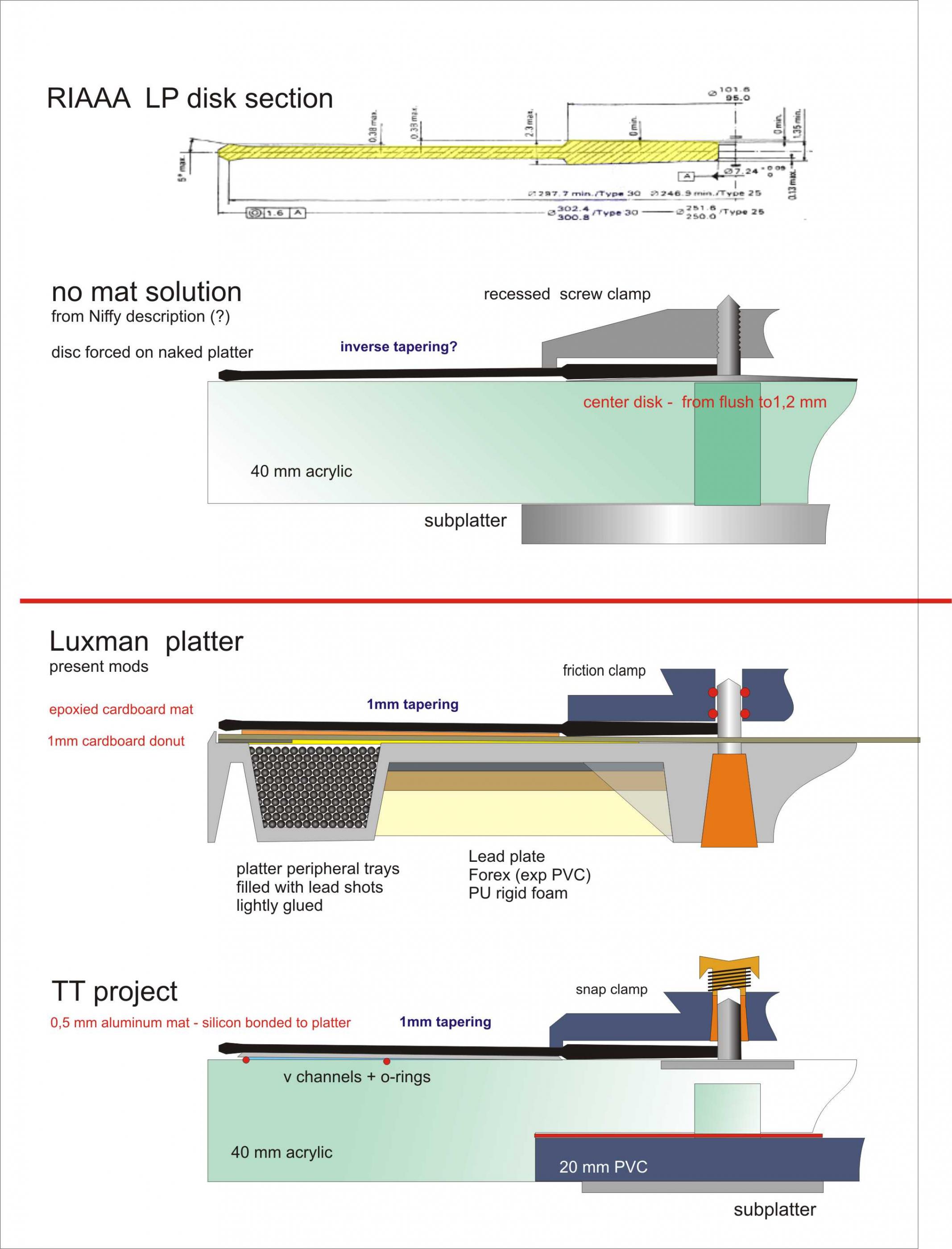

Hi Niffy, i'm trying to better understand your clamp system (drawing according to your description, hopefully), because the idea of avoiding the machining of the acrylic platter attracts me a lot: everything is possible in this world, but to make the recess without a big lathe seems rather complex.
As you said, pushing the disk against the recess can raise the outer edge (bad idea, quote) but, considering that the clamp pushes to the center perhaps it is enough to give a small raised support on the outside and let it do his job, with much less force. Currently my cardboard gadget works fine on my old Lux TT, but maybe diying a new TT it can be improved quite simply.
Of course using a linear TA we have to consider that small tapering when leveling.

Hi Carlo,
Your picture of my clamping system is close to what I actually have. The raised section in the centre of the platter is more of a smooth dome than the cone that you show. Your picture shows the clamp contacting the record outside of the label area. This would cause the cartridge to hit the clamp on the runout groove. The label section is about 100mm diameter and the clamp only 75mm. The clamp is entirely within the label area. The idea of the reflex clamp is that it bows the record downwards onto the platter, your diagram shows the record remaining flat. The cross section or the record that you are using appears exaggerated. Get out an actual record and look at the changes in thickness, they are quite subtle. The downwards bow of the record will be mainly in the thicker label area. The thinner playing area bows back upwards to keep the entire playing area in contact with the platter.
Tapering the surface of the platter will have a similar effect, the surface of the platter will be a concave cone. (I mentioned exploiting this as part of my record centering idea) The down sides of tapering the platter are that in order to adequately flatten the record the tapper would have to be quite severe. This would result in a noticeable variation in VTA across the record and an azimuth misalignment. The azimuth can be corrected easily enough if the arm has this adjustment. Creating the taper accurately would require the use of a lathe if using a bare platter or a profiled mat. A less severe taper can be used if combined with a Reflex clamp or peripheral clamp.
I used a router to cut the recess for the lower part of the Reflex clamp. This was one of the easier parts of making the platter.

Niffy, thanks for the useful clarifications; that sketch was just a scheme, made using the Riia section which exaggerates the proportions to highlight that disks are not flat, and normally without a recess may remain floating. Even the edge is important and uses a tapering to slide the stylus into the first groove.
The 1mm tapering generates just an angle of 0.35 °, but it is more than enough to flatten the warps of my disks (I try to keep them well): the idea was of making a 0.5mm aluminum disk resting on an 1mm outer ring, and then glue it by pushing at the center. But your system is much easier, and I think I'll try to copy it.
