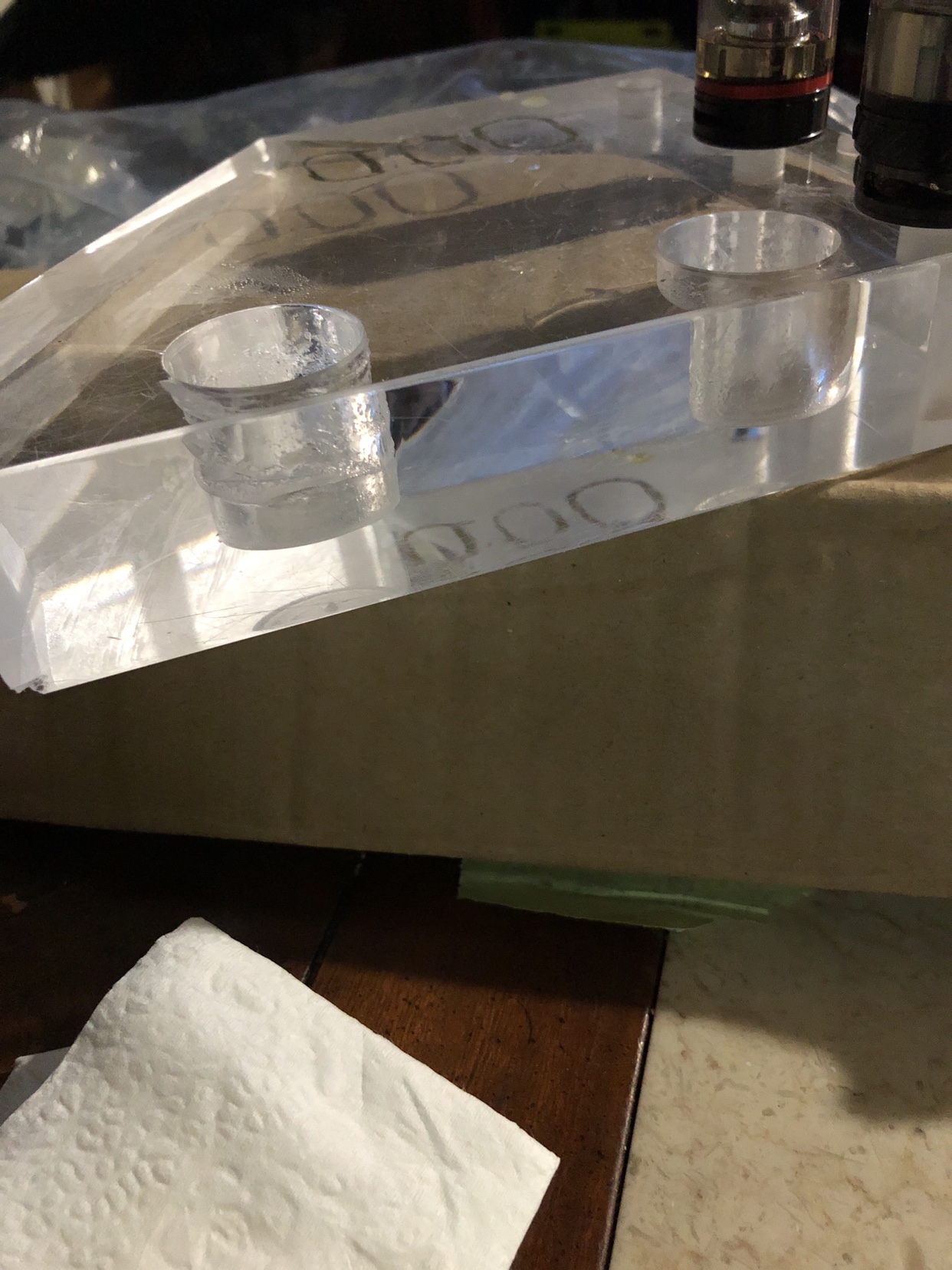

It’s the real deal bullet proof glass. My brother bought all the items from a bank that closed down. All the safes and all the
B/P glass that was for all the bank tellers
The last pic is from a full metal jacket 308 shoot from 10 feet
As you can see it did not go though it. Lol
This stuff is 1.25” thick
Hi carlthess40,
It doesn't really answer the question as to whether the bullet proof glass is a plastic or silicate. I can see no evidence of lamination which would suggest that it is a plastic. The fracture pattern is more like I would expect from a plastic. Although I have performed quite a bit of materials testing I have never resorted to the use of small calibre artillery, so I might be a bit hazy as to the type of fracture pattern to expect.
If it is plastic/plexiglass it will probably make a fine platter. If it is an actual glass then it will need some form of platter mat or it could be used as the base layer in a two part platter.
Either type of material could be successfully incorporated into the plinth of a turntable.

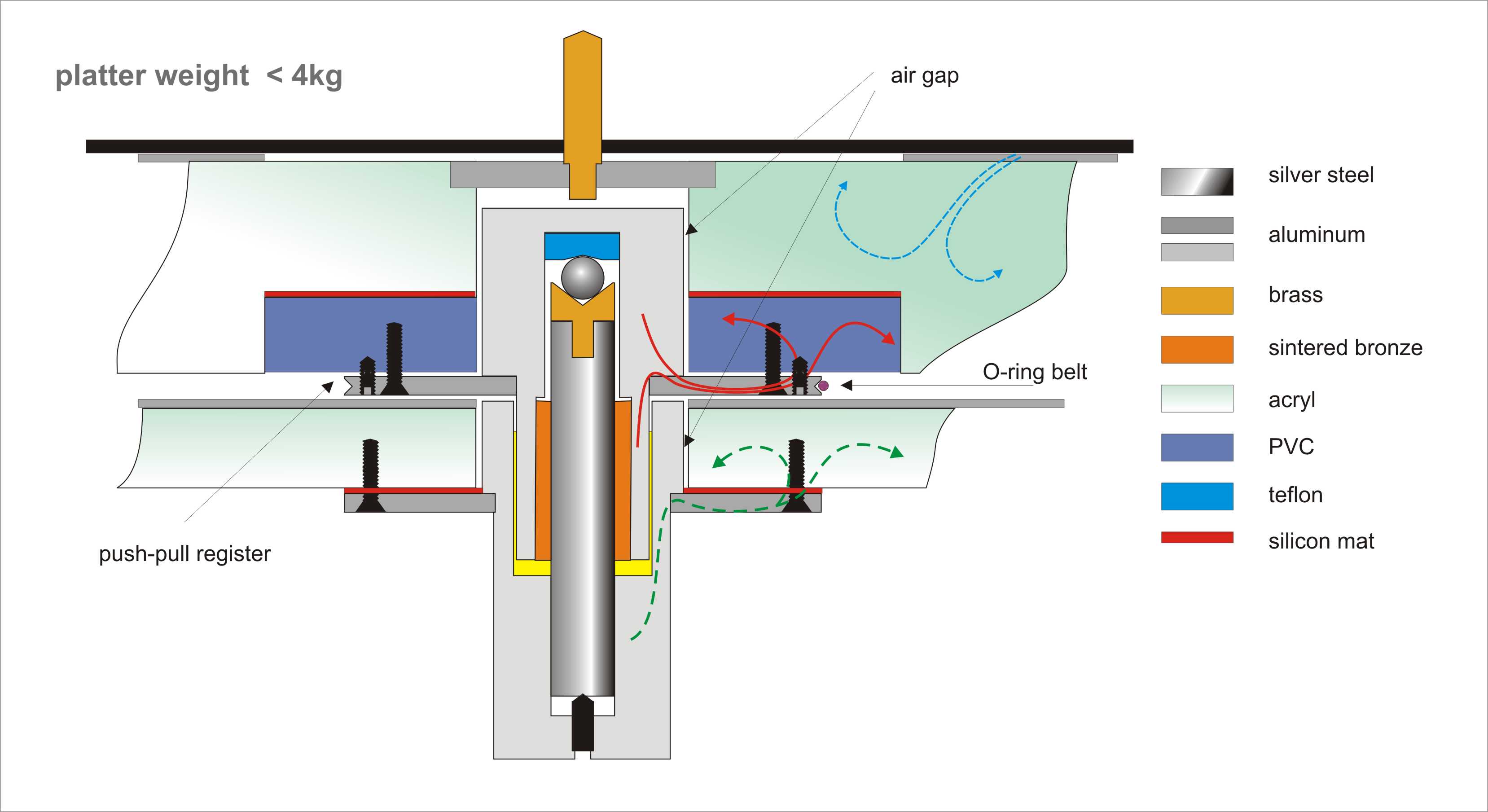

Hi all
sorry to go back to basics, but I would like to understand better this argument, to take advantage of your results. When saying - this sounds better than that - maybe it would be necessary to specify what we want to achieve, because there are two problems that seem completely different, to me
1 - the platter must not transmit the noise of the bearing and/or motor to the disc. For this it is used
A a completely isolated motor - B a dead silent bearing - C a platter with high impedance to resonances - D a soft and not so dense mat (felt - foam - etc)
2 - the platter must absorb the resonances induced by the tracing on the disc itself. For this it is used
X a medium to heavy density elastic mat (+ clamp) - Y a rigid mat perfectly adherent to the plate, or no mat at all (again + clamp)
1 - D solution is the most beloved by some manufacturers because it masks defects in A B C, but also by many audiophiles who like a richer sound. (there was an entire school). Not my case.
A + B seem indispensable, but being almost unknown on this earth the condition C can be extremely useful. The problem is the material (or materials) of the platter, but the bearing to platter joint plays even a bigger role.
2 - X solution is the most commonly used, but it's a difficult compromise (from no absorption to free resonances, as in D) - Y is difficult to obtain, because the disk must become one thing with the platter itself (just a non perfect contact brings troubles).
When the platter transmits noises from the bearing to the disc the Y is clearly to be avoided.
My TT project stopped at B (decent bearings, but not silent), some results obtained by attaching the bearing only to the subplatter (also used to register the wobble) and various tests on how to connect the sub to the platter.
carlo

Hi Carlo,
To me the primary role of the platter is to allow the energy caused by the tracing of the groove to propagate away from the stylus and to prevent any of it from then returning to the stylus.
I don't think that the platter should have acting as a barrier between the bearing/motor and stylus as its main responsibility. A major point of my sleeveless bearing was to reduce bearing noise as far as possible. I cannot hear any noise at all from the bearing when using my mechanics stethoscope. (I initially thought I could hear some. Turned out that I could still hear it when the platter wasn't rotating or even fitted. It was a combination of the blood moving through my hand and traffic noise, not the bearing at all. ) Likewise I cannot hear any motor noise breakthrough south of the motor mounts. Motor isolation is even more important to me than most as my motor is mounted on the sub-chassis. I chose to tackle motor and bearing noise at source rather than trying to deal with it further down the chain.
The predominant type of vibration caused by the stylus/groove interaction is compression (sound) waves. By impedance matching the platter to the record the energy of this stylus/groove interaction can propagate away from the stylus with minimal hindrance. Having a material that attenuates the compression waves as much as possible is of course desirable.
As the compression waves move through the platter they induce bending waves. These form a pattern of nodes and antinodes that change depending on the frequency and position of the stylus. The best way to visualise how these occur is by looking at chladni plates.
YouTube
This is an over simplified example as only a single note is played and forms stationery nodes. Real music would produce more complex patterns that constantly change. The simplest pattern of nodes is where they form a cross with adjacent antinodes being out of phase. Of course chladni plates are designed to resonate in order to demonstrate the effect. Making the platter out of a material with better damping and by simply making the platter thicker can prevent the more complex patterns from forming and greatly reduce the formation of the simplest patterns. Ideally we want to prevent any patterns from forming as these represent resonances. (Increasing the thickness of the platter also means that the compression waves have to travel through a greater mass of material before they can be reflected back, reducing their amplitude). In addition to making the platter thicker making it out of a couple of distinct layers should increase damping and prevent the formation of resonances.
The plinth and part of the sub-chassis of my deck are made of sandwiches of aluminium and acrylic. The plinth is 20mm acrylic with 5mm aluminium skins. By itself the aluminium rang like a bell when struck. It also readily transmitted sound waves. The acrylic was quite dead and was inefficient at transmitting sound waves. Just gluing one piece of the aluminium to the acrylic massively deadened the whole thing making it much better than either material was in isolation. The addition of the aluminium didn't appear to effect the transmission of sound through the acrylic side. The addition of the second skin improved the deadness of the structure but substantial increased its ability to transmit sound waves. Please note that I am differentiating between bending and compression (sound) waves as they behave differently and need to be treated differently. Possibly the best solution would be a thick layer of aluminum with a thick layer of acrylic (or similar plastic) bonded to it. As proposed by AVWERK, though I might be tempted to go for less dissimilar thicknesses.
A reasonably thick layer of acrylic will by itself offer substantial damping and resistant to resonance. Whether there is a worthwhile improvement in adding an extra layer would require further investigation. I suspect that it will be marginally beneficial.
Apart from having the best impedance match to record vinyl acrylic does have a couple more things in its favor. It is considerably cheaper than all of the other materials that have been discussed here, it is also readily available in a wide range of thicknesses of up to 100mm. It is probably the easiest to work as well. I think a lot of people are put off acrylic as it isn't seen as high tech enough and can appear visually tacky.
Niffy

Niffy, to rely on your knowledge and experience is not just a privilege, often brings decisive advantages.
What you say about the vibrations induced on the disc is absolutely relevant: simply trying mats of different materials is enough to get the clear proof of that.
Test after test convinced me too that the only way to handle the problem is to make the disc solidary (not so easy) with a platter capable to absorb those vibrations, and I think I will go to plexy for the advantages you describe, and that somehow I know.
However, this aspect needs an indispensable premise: an absolutely dead silent turntable.
Several steps behind to this achievement I have to make first a main bearing that behaves correctly (some sintered bronze bushing bought look promising) and to be able to absorb the residual noise before reaching the platter.
I'm starting from where I gave up: a traditional (?) inverse bearing, but now increasing the bearing to platter separation through a PVC subplatter + a small air gap. (attachment)

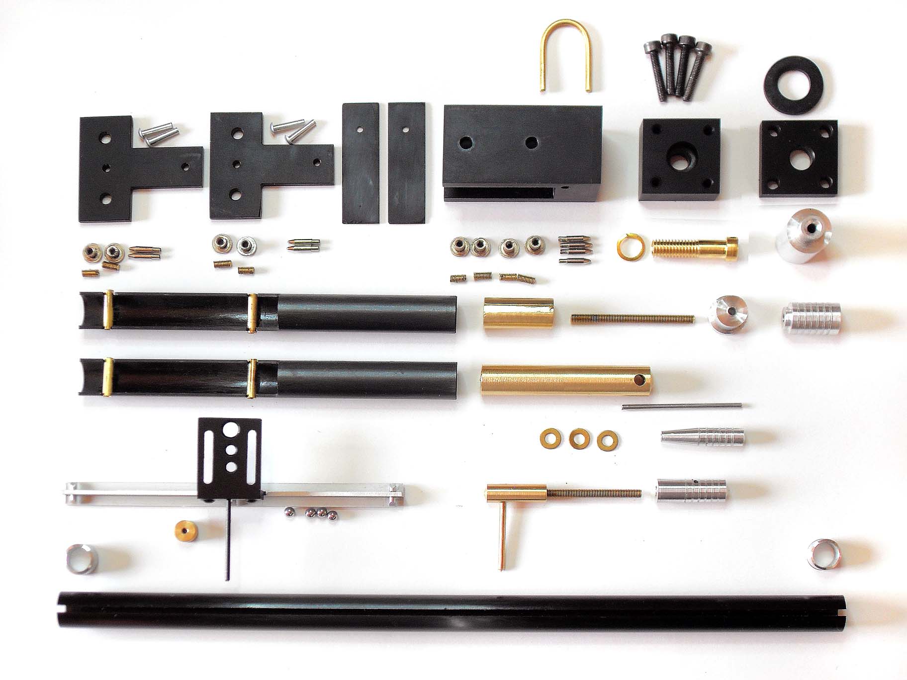

Back to topic: Lil Casey mk2 parts almost made. (attachment)
Now begins a very careful bonding - assembly, since the pen-tips must be perfectly aligned, and the rail - parallelogram system too. That means time, and other templates (again!).
To be continued
ciao carlo

Earlier I suggested the use of a couple of similar layers or a gradient of layers to absorb compression waves. In my last post I introduced the idea of using dissimilar layers (acrylic and aluminium) to damp bending waves within the platter. I think that the latter has greater potential. If making a very thick (80mm+) and heavy platter I would suggest making the layers of a similar thickness. For lighter platters I would suggest making the acrylic somewhere in the range of twice as thick as the aluminium. My reason for this is that the acrylic is the platter and is the thing that is in direct contact with the record. Having a thick layer of acrylic will absorb as much of the compression waves as possible. The aluminium layer is there to damp the bending waves within the acrylic.
The alternative option is to have a thick layer of aluminium with a thinner layer of acrylic on top. In this case the acrylic is acting more like a thick platter mat trying to impedance match the record to the platter below. Having a thinner layer of acrylic will result in greater reflection from the acrylic/aluminium boundary. Of course the platter with the thicker layer of aluminium will weigh a lot more than the platter with the thicker layer of acrylic assuming the same overall thickness. This will require a more substantial bearing and the associated noise penalty.
My platter is a solid piece of acrylic 40mm thick. If I wanted to make a two layer aluminium /acrylic platter of the same mass it would probably be something like 20mm of acrylic with 8mm of aluminium or 15mm of acrylic with 10mm of aluminium. Both of these options would result in much greater reflection than I currently have from the underside of the platter. Would a thinner two part platter actually offer greater rigidity or damping, probably not. At these sort of dimensions I feel that a single piece, single material platter will be superior. Another benefit to me is that the 40mm acrylic platter would have a lower centre of mass. This helps to keep my sleeveless bearing stable.
If we were to be comparing an 80mm single piece acrylic platter to 40mm acrylic with 15mm of aluminium (same mass) I think the differences would start to swing more towards the two piece platter. I think that once you get up to this sort of mass and thickness the difference in sound is going to be quite subtle which is why I said in the previous post that the benefits will be marginal.
I have been thinking mainly about using acrylic and aluminium. Of course the plastic could be one of many different types. Delrin or PVC being obvious alternatives. The aluminium could be replaced by steel, magnesium, corian or a laminated combination of materials.
Unfortunately we cannot easily determine which material or combination of materials is going to sound the best without actually building platters and playing records. We can however narrow the range of options to those most likely to work well.
Niffy

Hi carlthess40,
Niffy
Will I know it’s not glass as I can cut it with a jigsaw blade made for plexiglass and plastic materials like that and when you cut it does not melt back on itself and it is super super hard to cut and for the statement of small caliber bullet , the 308 is a massive caliber cartridge and I was just showing in that photo the type of energy this stuff will absorb and it is classified as bulletproof ,but my question still is this. , is there anyone out there who would be able to machine two or three of these for me and I will provide them with some of this material so that they can make themselves one or two for themselves
