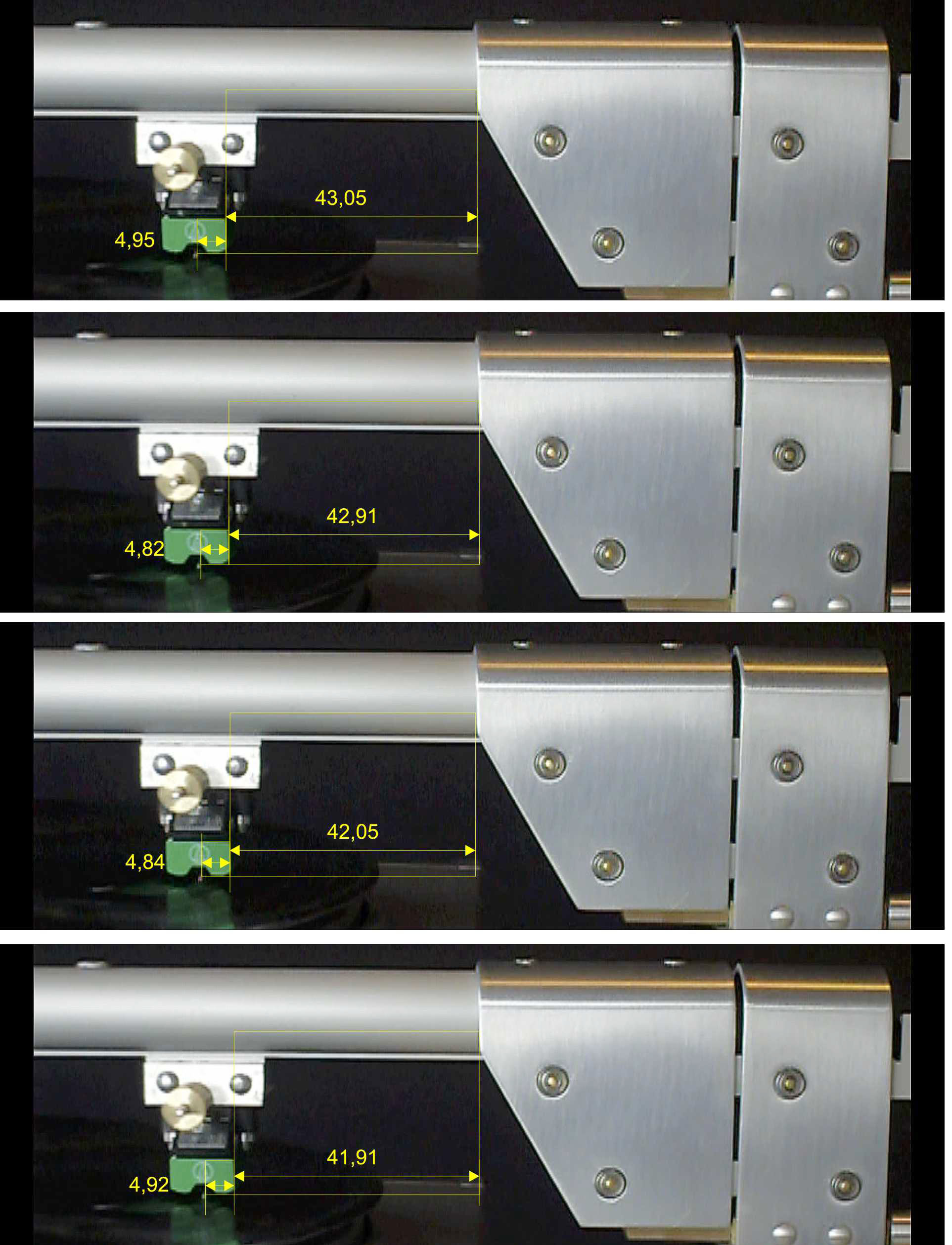

I am trying to reconcile the calculations of you and the pics of nocdplz, at 10mN deflection— one give micrometer displacements, other serveral tenths of mm’s
I am still mystified-
If a cartridge is 20mum/mN, it describes the movement relative to force- which force is this, where does it come from and how much is it?
My assumption-wrong off course- is an arm has an effective mass of 20 grams, this equals a force of 200mN, compliance =20, then the stylus would move 200x20mum=4000mum=4 mm ???
Trying to get picture of the stylus movement in normal operation, not eccentricity
How far does the stylus/cantilever go out whack when its slugging 20 grams around 😉 😉
What am I missing here, how can it be reconciled
Thx

Hi Coolerooney
what a mess: sorry I can't say more than what I've already said, Niffy will certainly be more scientific.
Consider that:
the first image is the analysis of the video of my "crash test" (1.3 mm eccentricity and 3 mm warp are limit conditions, never seen on listenable disks) and the measurements are related to the dynamic bending caused by those defects (accelerations). Since no one publishes videos of this kind, and everyone loves to see just what confirms his opinions I explained that for me "the severe side bending" was more similar to that of a damped pivoted than a linear one, thanks to a horizontal mass much lighter than normal (no shaft and no relative counterweight) - See post #2547.
the second image is the measure of static bending (uniform motion) similar to what is caused by frictions and levers of the carriage+shaft.
Niffy calculates this stylus bending using the compliance: his method is absolutely correct and brilliant, but the results differed from what I observed (not too much, 2 or 3 times bigger, a possible mistake with homemade tests). Hence my doubt about the compliance measure provided by the manufacturers: compliance is usually used to calculate the resonance of the system, so my hypothesis was that it is measured for micro movements of the stylus during tracking and not for the bigger forces that may generate a bending. See post #2621
Now: the effective mass (vertical and / or horizontal) is an inertia, so it comes into play only when there is an acceleration: horizontal for eccentricities, vertical for warps . Not during the uniform tracing motion. Many valid passive realizations - mechanical, or on air bearing - commercial or Diyed - use carriages with relevant weight (> 50 gr), with reference results.
If this is your problem, maybe you are off track: the problem is the carriage friction, not the weight.
But even this does not concern you, since you will use an active system, and sophisticated gadgets to cancel warps and eccentricities, if I remember well. You're going to face many others that i can barely imagine
carlo
I knew that article. I can't wait he will be able to build such a cartridge, an essential complement to dream tonearms; but I'm afraid I'll die long before I can see it, happily listening to good music with a simple unipivot and a nice Dl103, coming from 50 years ago tech.
Yes: as said 0.37 mm observed, 0.065 mm calculated with the compliance = 5,6 times more.
Obviously the tip remains steady into the groove, while the arm is pulled by the weight, rotating on the elastomer: where is the problem?
An advice: to do your own calculations according to Niffy, and your own test according to my setup: an hour spent so takes away a lot of doubts, diyer's style.
Now a curiosity: why do you worry about stylus bending? with your active arm absurd weights and excessive frictions of the carriage mean nothing at all (if it works, that's why they make them).
Your bending will vary between the threshold of the servo and 0, and then between the threshold of the servo and 0, and then between the threshold of the servo and 0, and then between ...
ciao carlo
I think that test was the static test with 10mN of force. With your 20um/mN cartridge the calculated deflection would be 200um or 0.2mm. Your measurement of the photos showed 0.37mm which is 1.85 times as great. I think the 0.065mm deflection was on the dynamic test and cannot be directly compared to the 0.37mm deflection. I thought your measurement was a bit pessimistic at the time, I thought your photos showed less deflection.

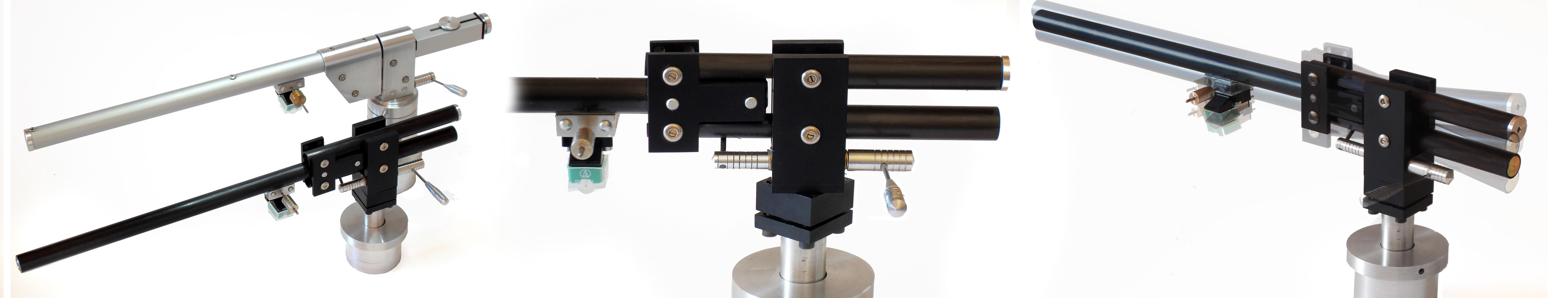

Lil Casey MK2 carbon -- the radial rail tonearm
This new arm (see #2758 - #2833) represents an evolution of the first Lil Casey, to which may refer those interested both for the conception #2355 #2383-4, construction #2440 #2469-70 and measurements. #2547 #2574-2605.
Even if the previous arm behaves correctly (carriage effortlessly sliding) and plays pleasantly my records since a couple of months, there remained two weak points to work on: excessive vertical eff. mass - frictions on the parallelogram.
Since the signal is generated simultaneously by both horizontal and vertical movement of the stylus, imho the vert. and hor. effective mass should be quite similar to get a coherent behavior. I know there are completely different opinions and theories, but this is mine.
In order to improve those aspects I've used a carbon fiber tube to halve the moving masses and pen tip bearings to reduce parallelogram frictions, obtaining a simple compact arm with the same comfort of use of the previous one (rotatable and leveling base, lifter) and -hopefully- better performances on warps.
The arm is just ended, but from the first tests the movements seem OK: the carriage sliding is just a bit worse, while the vertical articulation (the main goal of this design) is greatly improved.
The construction needs just a (small) circular saw and pillar drill, but can not be called trivial - skill, templates and a lot of care are necessary, especially for the geometry of the parallelogram.

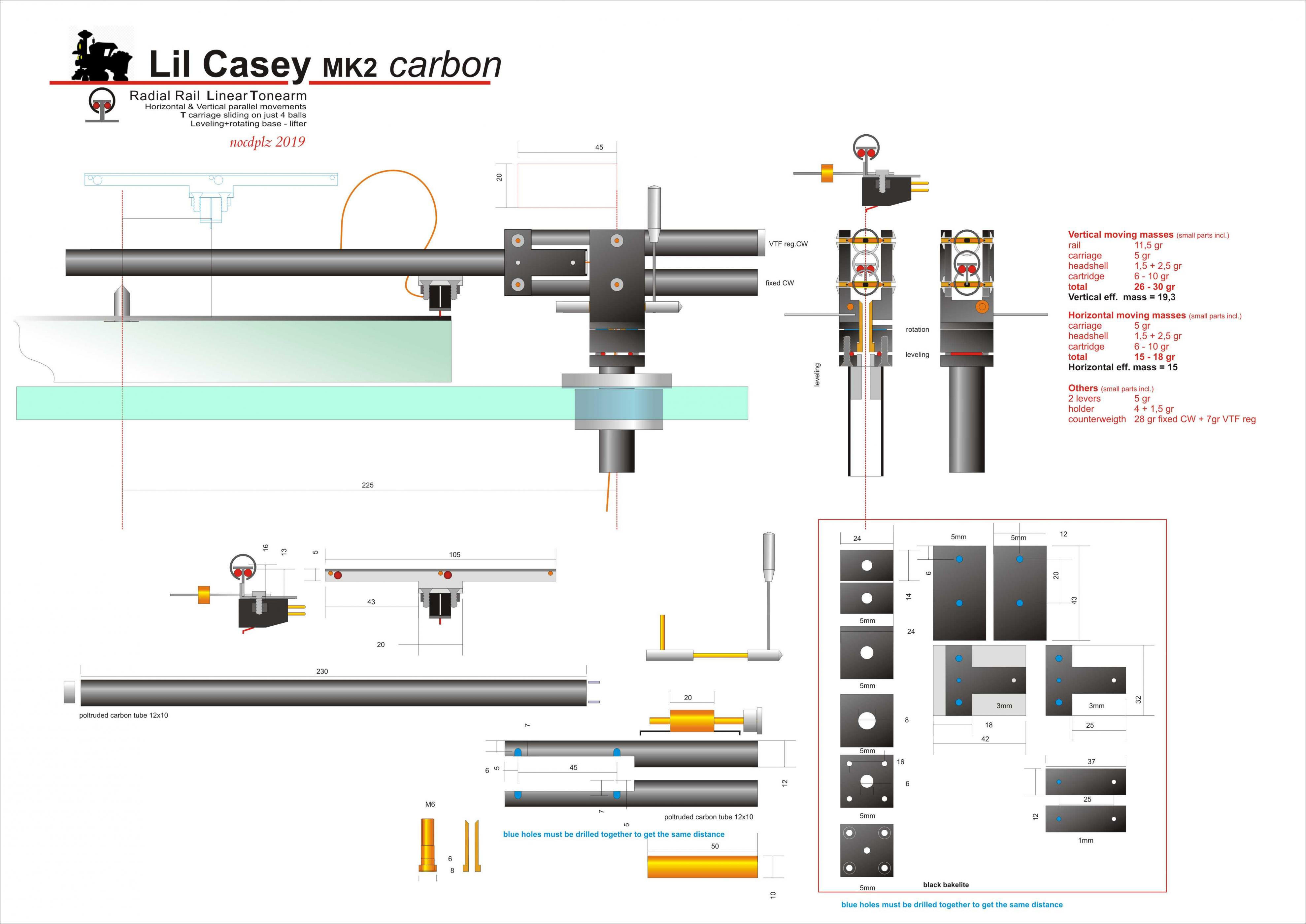

Photos and construction drawings as attachment
carlo
Niffy, I am curious to know your method of measurement, certainly less naive than mine: and given that the variations with respect to the calculation were significant but not huge (in the second answer, reading the old post in a hurry I kept the wrong data ) certainly the problem deserves to be better examined
Hi Carlo,
As always I am thoroughly impressed with the fit and finish of your work. Lil Casey mk2 looks amazing. Hope the sonics match the visuals.
I have heard many people say that vertical and horizontal effective masses should be the same. It is one of the main criticisms leveled at linear tracking arms, that the vertical and horizontal masses are different. Although I have heard it stated that they should be the same I have never heard a cogent reason for this to be the case. I have solid reasons why it is better for them to be different. Could you please expand on your reasoning for them to be the same.
If you don't mind I'll wait for the new batteries for my stylus force gauge to turn up. Then I can post pictures and a description of the test as well as any results.
Niffy
