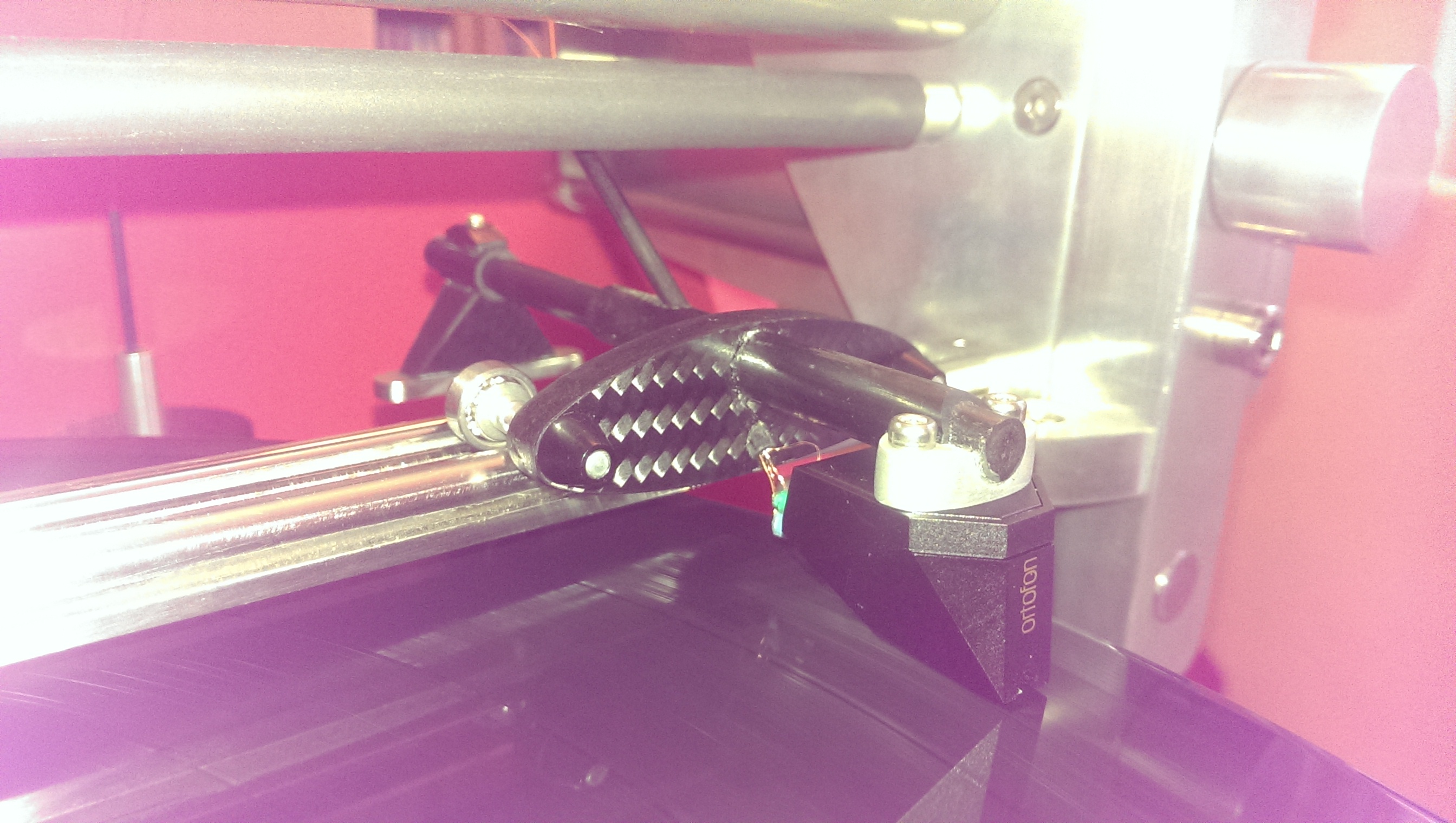

Your set up allows really rigorous measurements, by simple means at hand: great, I'll replicate it sooner or later.
Testing the AT95, the leaflet declared a so big difference between static and dynamic compliance that made me think that the problem could not be simple. My "kitchen test" gave almost double values: I thought that the friction of the pulley reduced the weight force, but perhaps instead "freezes" the fall of the weight when put in traction.
Better so, if the values are so small, one less problem to worry about
When measuring laterally, the micrometer was only touching the cantilever to the stylus...
irrelevant for sure - is that from the photos seems aligned to the center of the scale the stylus tip. I would align the fulcrum, because that should be the point where the force is exerted

Hi Carlo,
The audiotechnica data sheets does show a surprisingly large difference between static and dynamic compliance. As most users are going to be tuning their system to around 10hz the supplied figures are pretty much useless being at 0 and 100hz. If we had some idea of how these two points are connected we would have a better chance. Does the compliance vary linearly or possibly logarithmicly or are there discreet discontinuities? I doubt even audiotechnica have this information on file. A nice graph showing compliance against frequency would be lovely. I suspect they don't produce such a graph as too few users would find it useful and it would probably just confuse many others.
I get your point about aligning with the fulcrum. It shouldn't really make any difference. I aligned at the stylus as compliance is a measure of the linear movement of the stylus under load applied at the stylus.

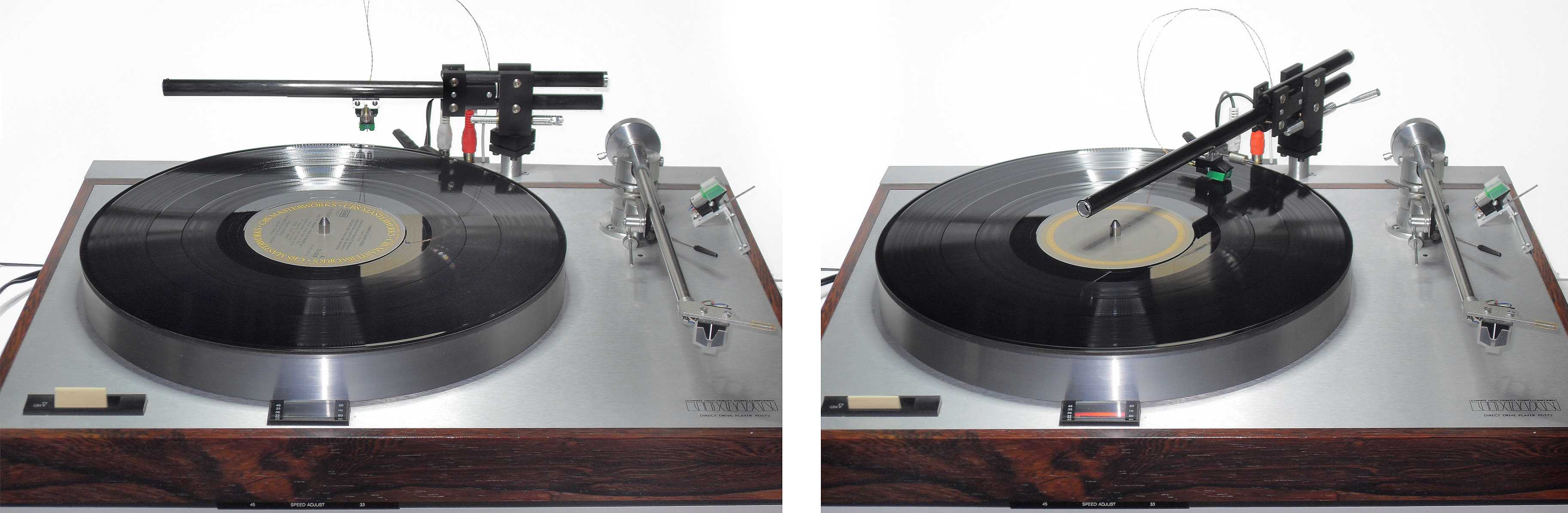

Lil Casey MK2 carbon - the 2° radial rail TA
For those few interested in strange experiments, here are the clips of my crash test (1.5 mm eccentricity - 3mm warp - VTF 1.8 g) of the new Lil Casey MK2. (sorry for the quality: I was a product photographer, then allergic to videos)
Hope you'll like the results, since I can't do better, at least for now. Seen with a 10x macroscope seems ok to me, but haven't found other videos to compare with.
Next WE the pendulum test for the hor. and vert. frictions measures.
carlo

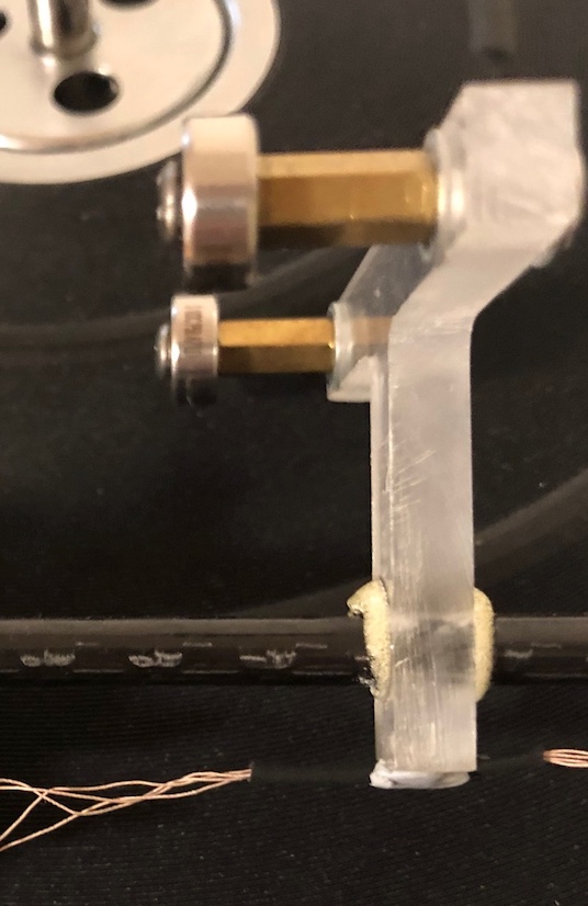

For the original design, does it make sense to add a bearing for vertical plane?
In the original design the play in the lateral bearing act as the vertical bearing. Adding a single bearing as you have shown would allow the armtube to rotate laterally due to the play in this bearing. It would also give you a double vertical pivot The advantage of placing a bearing in the position you have shown is that it puts the vertical pivot closer to the record. I think it's better to locate the lateral bearing closer to the record and allow the play to act as the vertical pivot.

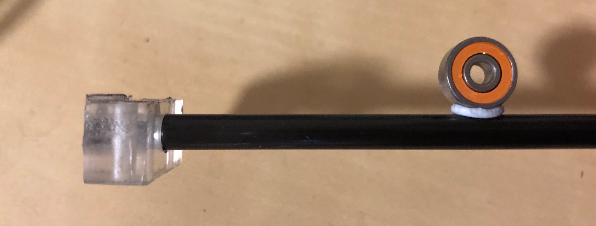

Here's how I did it.
Niffy
When I was using ballrace bearings I had the same problem. I found that by repeatedly raising and lowering the arm the reading on the scale settled down and became more consistent. I would initially set the manufacturers recommended force and fine tune by ear.

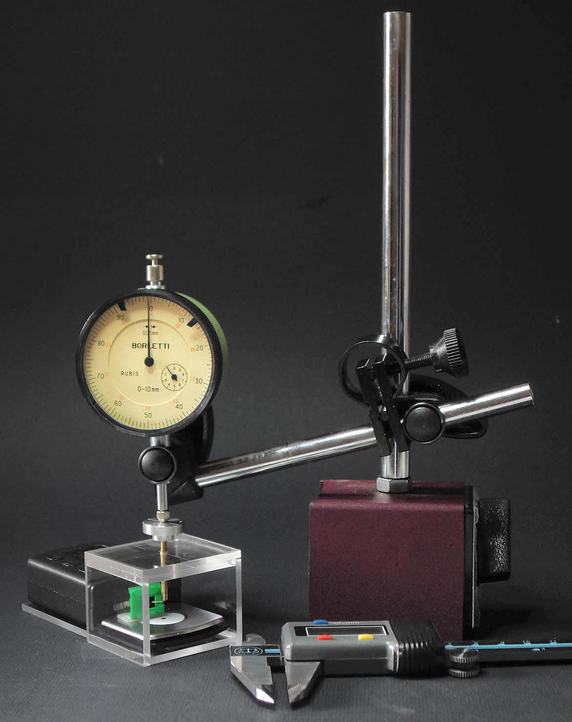

Hi Niffy - your scale rig is so smart that I couldn't resist.
Here is a simple version, some bits of plexy and a screw whose height can be measured with a digital caliper or a dial gauge.
Of course I measured the AT95 cartridge of my old test, with results that + or - confirm yours.
horizontal
0.5 gr = 0.14 mm -- 1 gr = 0.26 mm -- 1.5 gr = 0.35 mm*
vertical
0.5 gr = 0.11 mm -- 1 gr = 0.18 mm --1.5 gr = 0.28 mm -- 2 gr = 0.32 mm -- 2.5 gr = 0.44 mm*
given that on the vertical there is the VTF pre-loading I wanted to see if this altered the compliance:
between 0 and 1 gr = 0.18 mm --- between 1 gr and 2.5 (1.5VTF +1gr) = 0.26 mm.
Interesting, like the fact that unscrewing does not give the same values, as if the elastomer maintained the compression.
Conclusion: none. Maybe each cartridge tells a different story, and the matching of the arm ....

Hi Carlo,
Love the plexiglass box. For consistency between our measurements it looks like you have exactly the same scales I was using. I do believe that you are correct in saying that each cartridge tells a different story. I have diamond a closer look at your figures when I get a chance.
Niffy
Hi Carlo,
The deflections you measured do seem to be in keeping with the manufacturers specs. Your average lateral compliance is 21.4um/mN which is pretty close to the published 20um/mN. Vertically the compliance is 16.8um/mN. The difference in vertical and lateral static compliance is very similar to the difference I found with my cartridge. This would seem to suggest that vertical static compliance is normally lower than lateral. A larger sample group than just two examples would be required to confirm this. How does this relate to dynamic compliance?

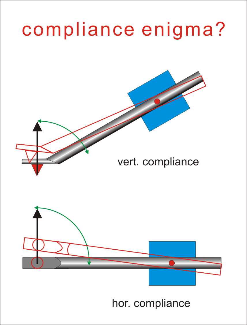

Being the elastomer a cylinder of homogeneous material, where comes from the difference between vert. and hor. compliance? (if there is one)
Can this be the (simple) solution?

Now since the stylus moves in 45° direction for pure L or R signal, shouldn't be the horizontal and vertical compliance the same? Or should we consider the stereo signal as vector sum of monophonic (L+R, horizontal stylus movement) and spatial signal responsible for the stereo effect (L-R, vertical stylus movement)? In the latter case the difference in hor and vert compliances could cause narrowing or widening the stereo field.
Or not, because the stylus follows the shape of the groove in either case. Perhaps the intention was to move the horizontal and vertical resonance frequencies apart from each other, maybe in accordance to the difference of the excitation signal in the two different planes.
Hi Carlo
Having different compliances will work in a very similar way to having different effective masses. Most tonearm manufacturers seem to have similar vertical and lateral effective masses. By making the lateral compliance higher the resonant frequency laterally will be lower. If the tests we've performed are an accurate indication the difference in resonant frequency will not be great, about 10%. As eccentricity and lateral groove modulation start/occur at lower frequencies than warps and vertical modulation having the resonant frequency tuned to a lower frequency laterally makes sense. This is assuming that the difference in static compliances are continued in the dynamic compliances.
The difference in compliance could indeed be partially due to the fact that the cantilever is sloping as shown in your diagram. With a 20° tracking angle you could expect a difference of up to 10%. Our tests have shown a difference closer to 20% so it would seem that, as Hiten pointed out, the elastomer is purposely shaped to give different compliances.
