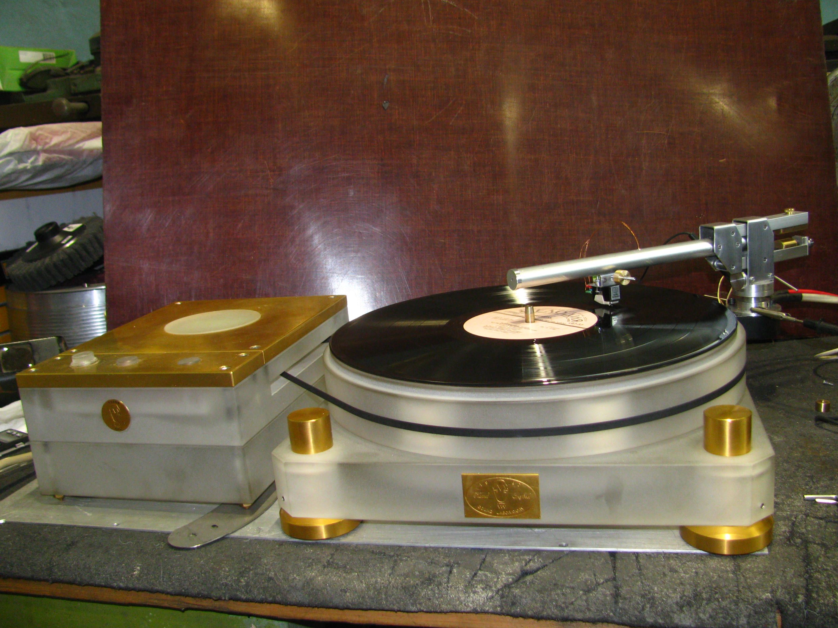

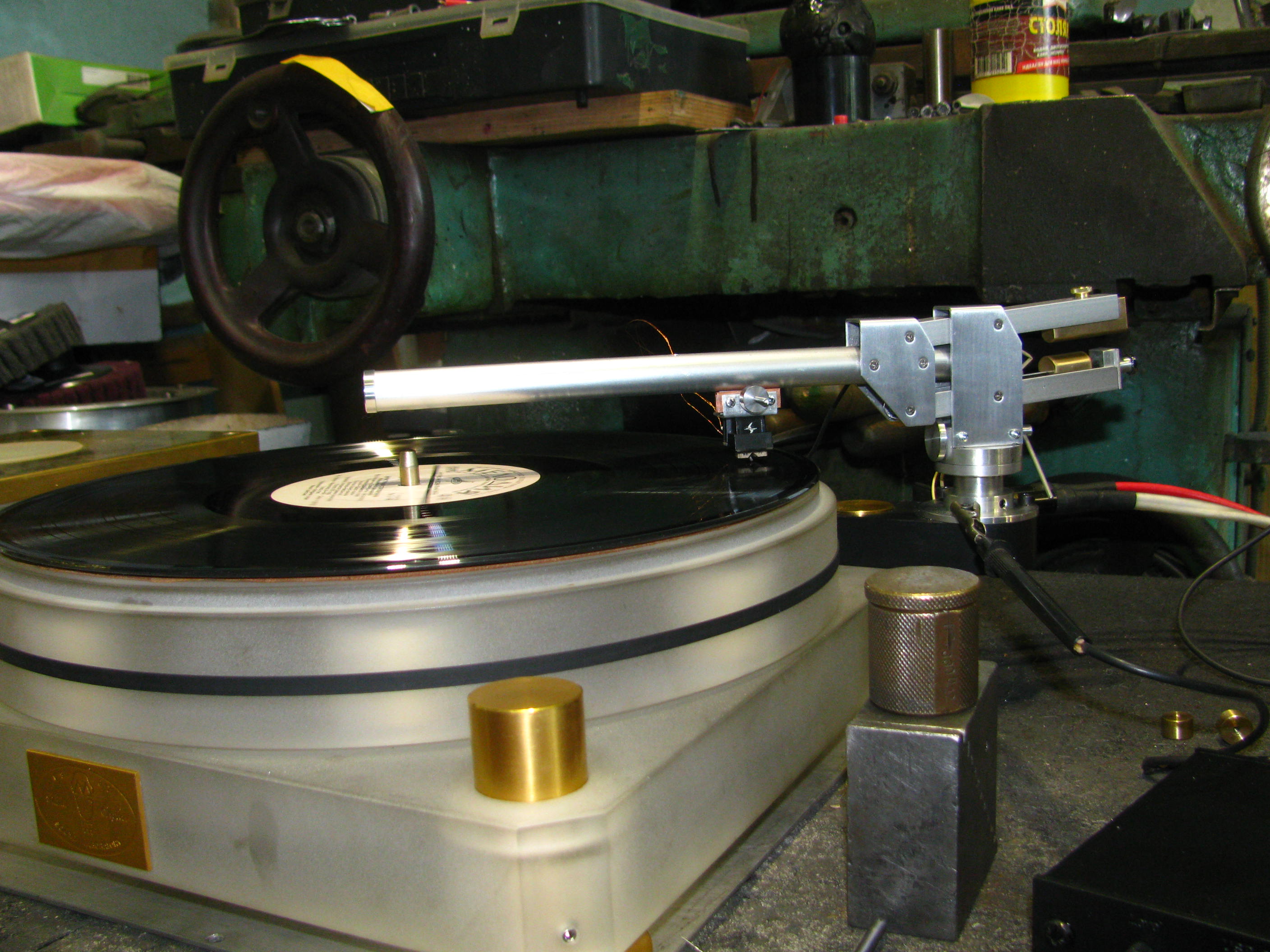

Carlo, thank you. The arm isn't my. Friend, who had made it, doesn't speak English. Anyway, if he will have any further questions, I can write and discuss with you.
For now, the arm together with turntable went to respectable audiophile home to undergo sonic expertise. By the way, the turntable on the picture was built by the same guy, named Eduard.
Second picture here taken in the Eduard's workshop.

Walter, I would be curious to know how Eduard built the carriage and the bearings, and how thick is the rail. His eccentric lifter is really nice and maybe I will copy it. With mine to raise the rail you have to lower the lever, which is counter intuitive.
Now some "trade - well a bit exaggerated - diyer's secrets".
Carriage - it is necessary to use spheres with a diameter that gives a support at 45 ° on the tube, that is centered with respect to those on the T: this way the rolling planes are parallel and the friction at minimum
Resonances of the rail are silenced with a strip of self-adhesive velvet in the inner upper part (same for plugs contact)
Pentips are inserted in a small tube and separated by 1-2 mm of O-ring chord (very elastic and durable). This ensures that the pressure is uniform and easily adjustable
Cables are grounded with a spiral of the same wire around only before the loop, for flexure issues (a bigger loop may be better)
Anti tilting CW adjustment must be get with dynamic checks, and is related to the VTF - the new smaller rail (12mm), provides a better self centering - the most favorable position found was with the radius aligned in the middle of the cantilever = 2 mm overhang. Variations in stylus drag during play bring no visible motion, but if someone made poltruded doublevee profiles ....
The rest was already said it in the old posts and drawings, and you've interpreted it beautifully.

Carlo, his tube is 15mm diameter, with 2mm walls. Carriage is close to your drawings. Vertical bearings are all small ball bearings, and they work very well.
I think, Eduard will try carbon tube too. Question is where to buy them? Any link would be helpful.
Walter
Walter
Carbon tube - try on Amazon or model shops; here in Florence i go to a retailer of kites and spares.
2 mm thick aluminum is too heavy (knowable from the CW size); on my mk1 was 1mm and was too much too - reduced to 0,4 mm on lathe brought to bad resonances.
Bearings: 8 or 4?
Before audiophile's verdict, what are Eduard's and your first impressions? The first impact is more significant than the opinion after getting used, imho.

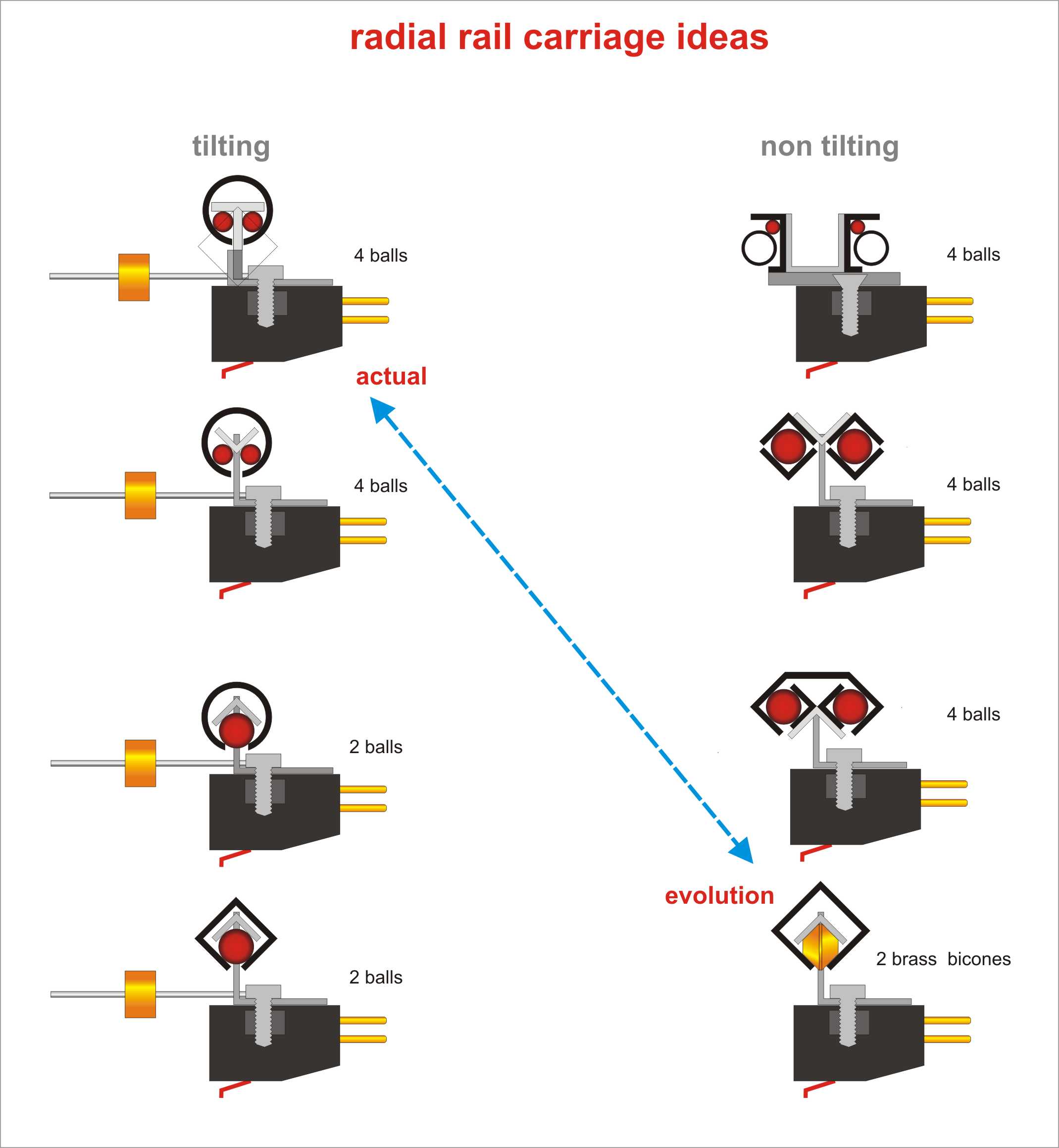

If the prototype makes you think -like me- to go ahead, here are some ideas for the carriage tilting problem, avoiding the small CW and its boring set up.
The solution at the bottom is very simple, just replacing the balls with 2 turned bicones. But first we should find a 12x1 square carbon profile, that seems unavailable.
Have fun - carlo
Have fun - carlo

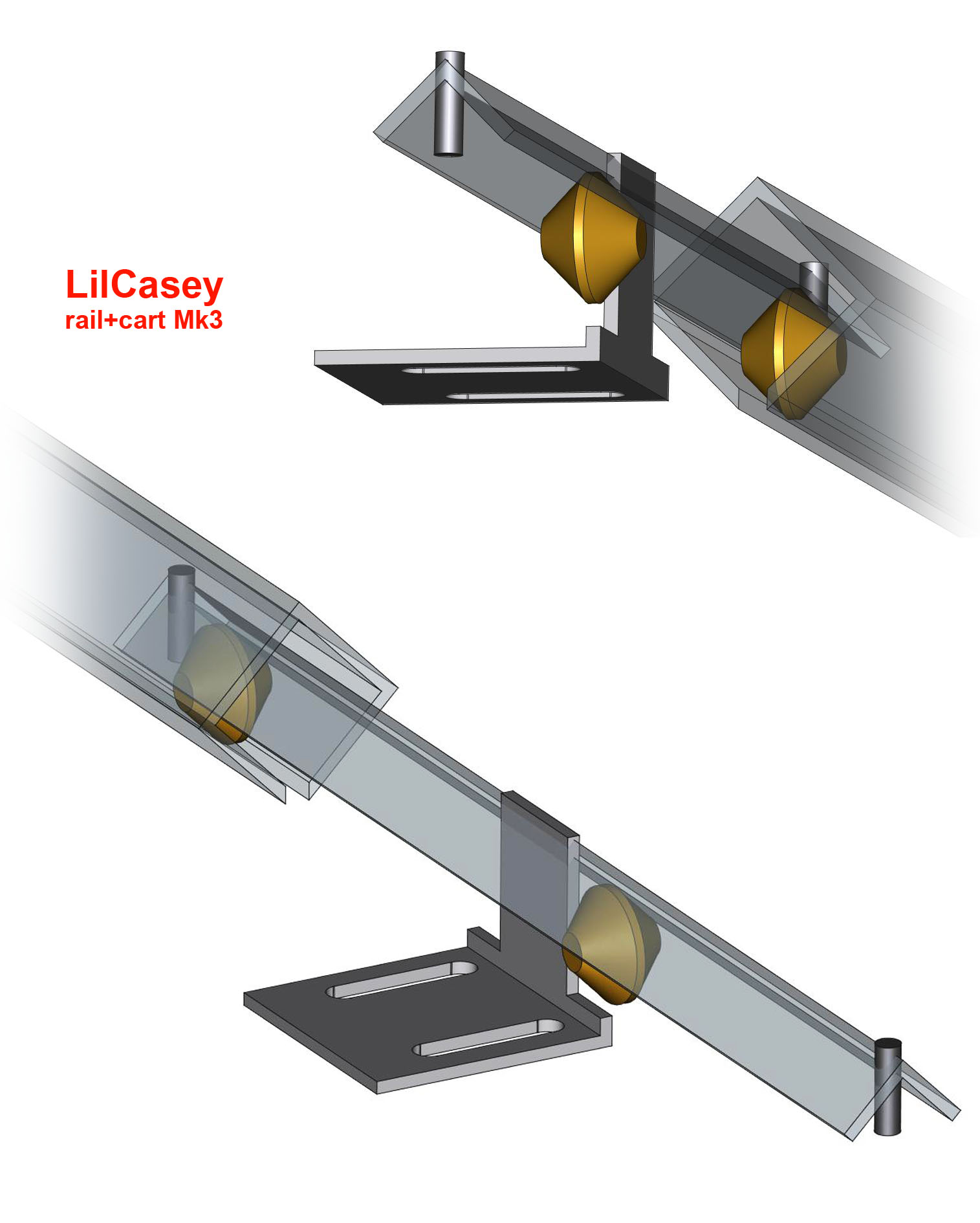

rail + cart = something like that ...
c2
Clever idea. However, it may introduce too much of friction.
+1 on the clever idea. The tips of the cones and their bases will travel the same distance but their diameter will be different which means that there must be a certain amount of sliding taking place for the cones to roll. This will result in greater friction than balls. I had great success using items originally designed as jewellery in my arm, the rings I used for my wheels. Have a look at titanium body piercing jewellery. You can get a whole range of cones. Most seem to have a tip angle of 55-60° but some are available with more obtuse tips if you look hard. They are internally threaded so two can be screwed together back to back. I don't know how accurately they are made, the rings I purchased where very accurate. Being made of titanium they will be light and hard, both desirable properties.
From your drawings I think the second down on the right looks the best option. It will be heavier than the cones but also much more stable and lower friction.
Niffy
Niffy
Thx Super, thx Niffy: clever? hopefully - more friction? hopefully not.
In a non recirculating bearing there is no motion of the balls surface relative to rails (then no sliding): in the actual solution every ball has 3 contact points (x4 balls): with the bi-cones 4 contact lines (x 2 bicones). Unfortunately the bicones must be turned precisely with 45°+45° to sit perfectly on the upper and lower V profiles - this ensure no possible tilting (and no chattering). Being of 4mm diam. weight doesn't care - brass or inox will be ok
The non recirculating bearing is far different from wheels, since there are no axes issues (in doubt ask Egyptians for moving their pyramids)
The sol. 3 is the most used for recirculating bearings. in this case maybe better the sol. 2 (better distributed weight) but the rail could be heavy and/or flexible = to avoid.
For now i will not test these solutions. The actual is plainly working: once set up the CW for that cartridge there no need of further interventions. No problem if you don't sell tonearms.
It was just the last aspect still to investigate and tweak
carlo
