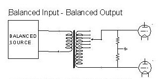

I want to use a balanced dac into a sowter 9336 attenuator transformer.This would output in balanced mode to the preamp. What
would be the value of the resistors used on the output of the transformer and does the midpoint of these resistors go to the virtual
ground of the preamp.

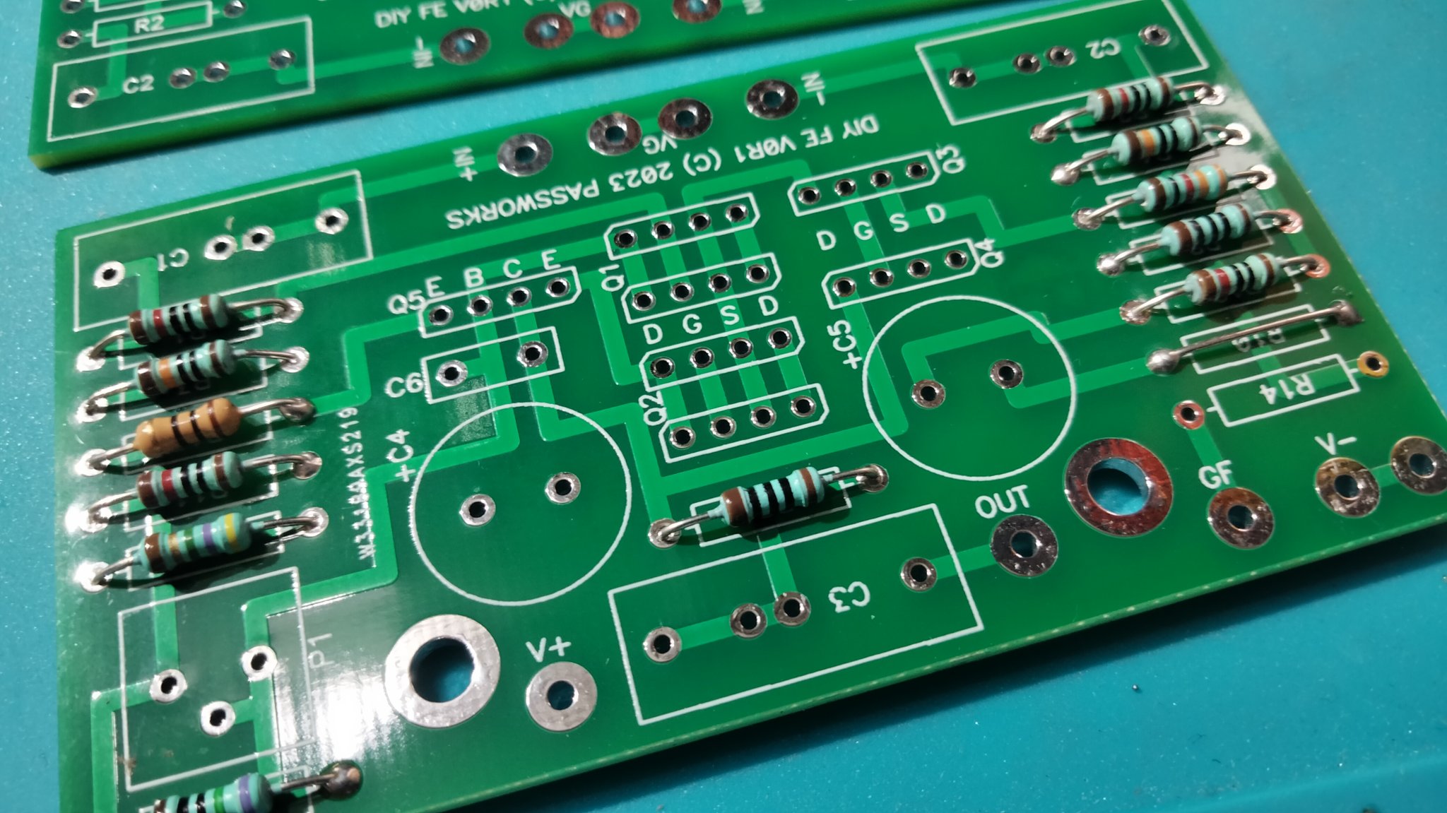

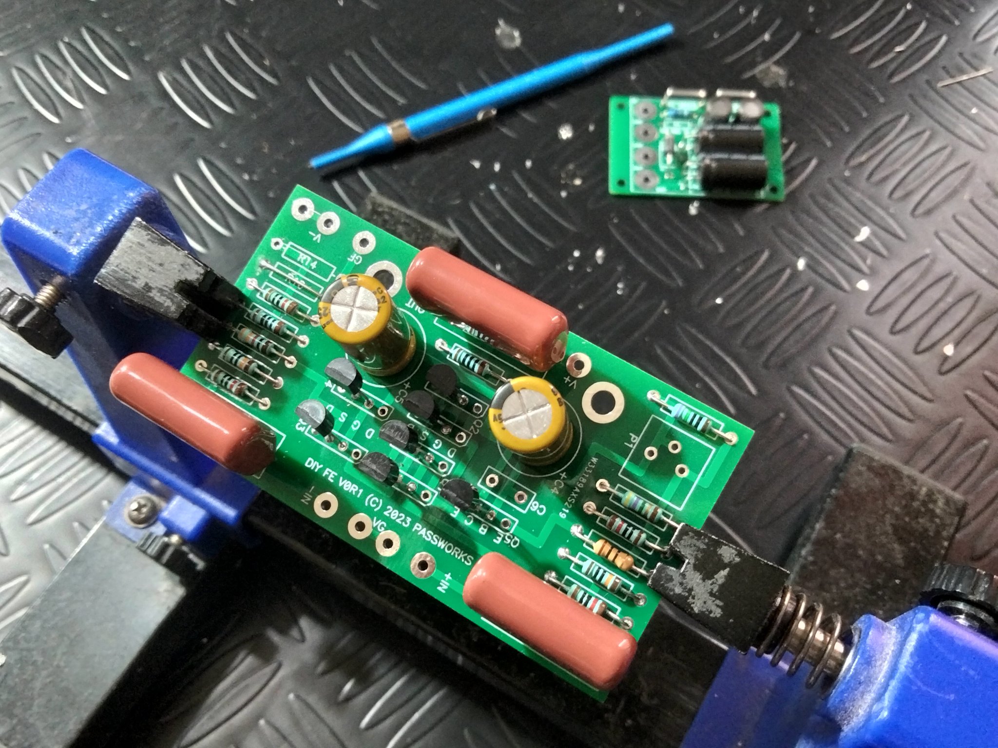

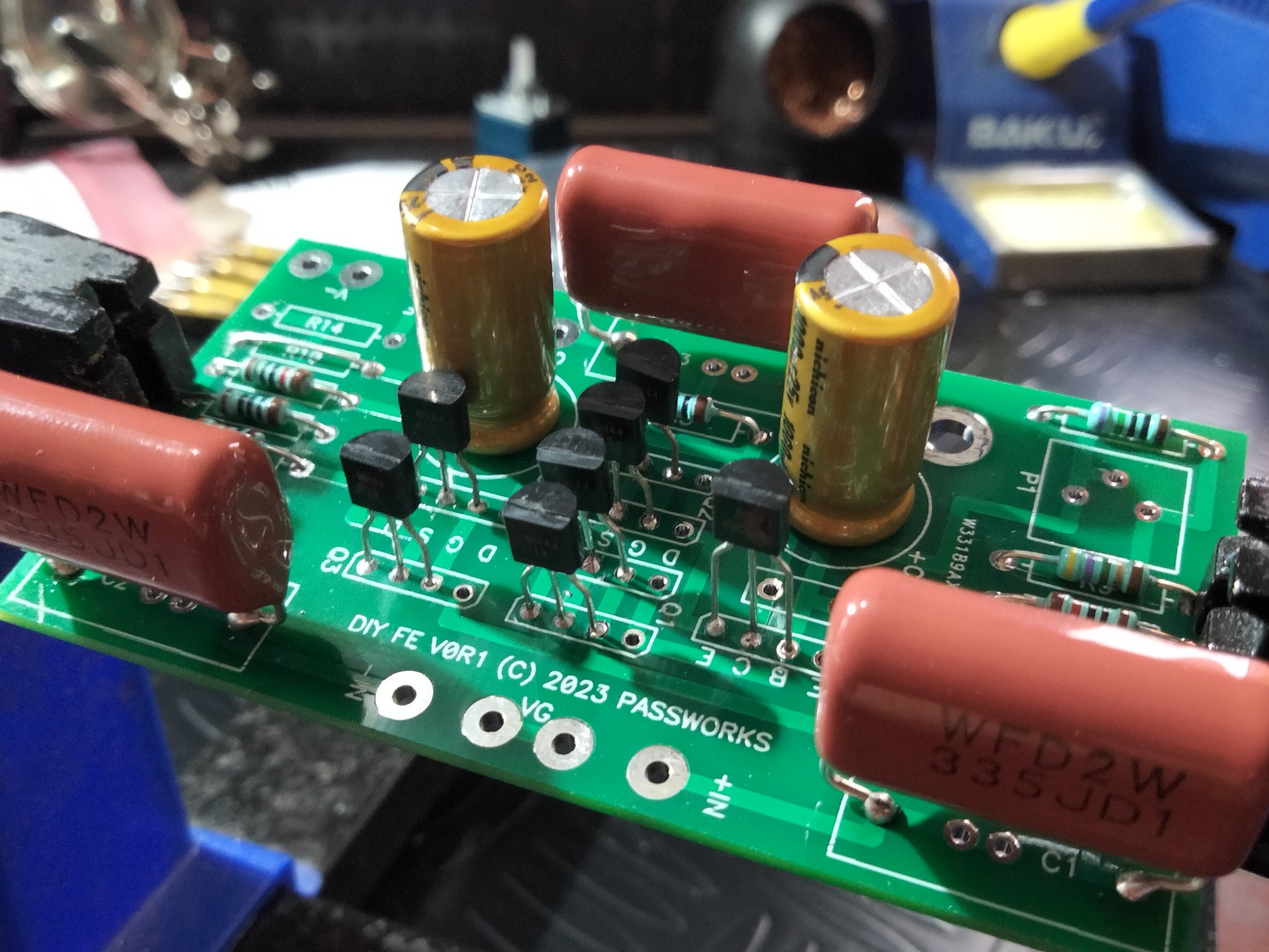

Yes, the layout is very tight. My alu chassis has dimensions 172mm x 291mm x 60mm only.

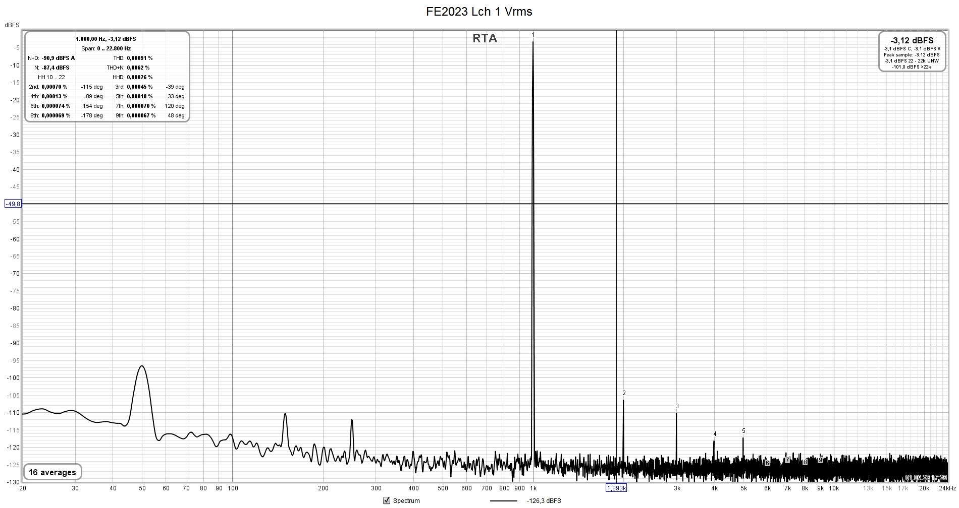

Last days I have done some distortion measurements with 10k load. Despite of the last quick test was good,
but not good enough. SMPS I used is better quality supply approved for medical applications
(Mean Well IRM-30-48ST 48V 630mA 30W) with input and output filter and ripple and noise max 300 mVpp.
But in the last spectrum were peaks with ominous frequencies 94 Hz, 188 Hz, 376 and so on.
Taking a 100 nF capacitor direcly to output screw terminal has calmed down all these intermodulation products.
It looks nicer now and sounds smoother.
Reactions: Ben Mah

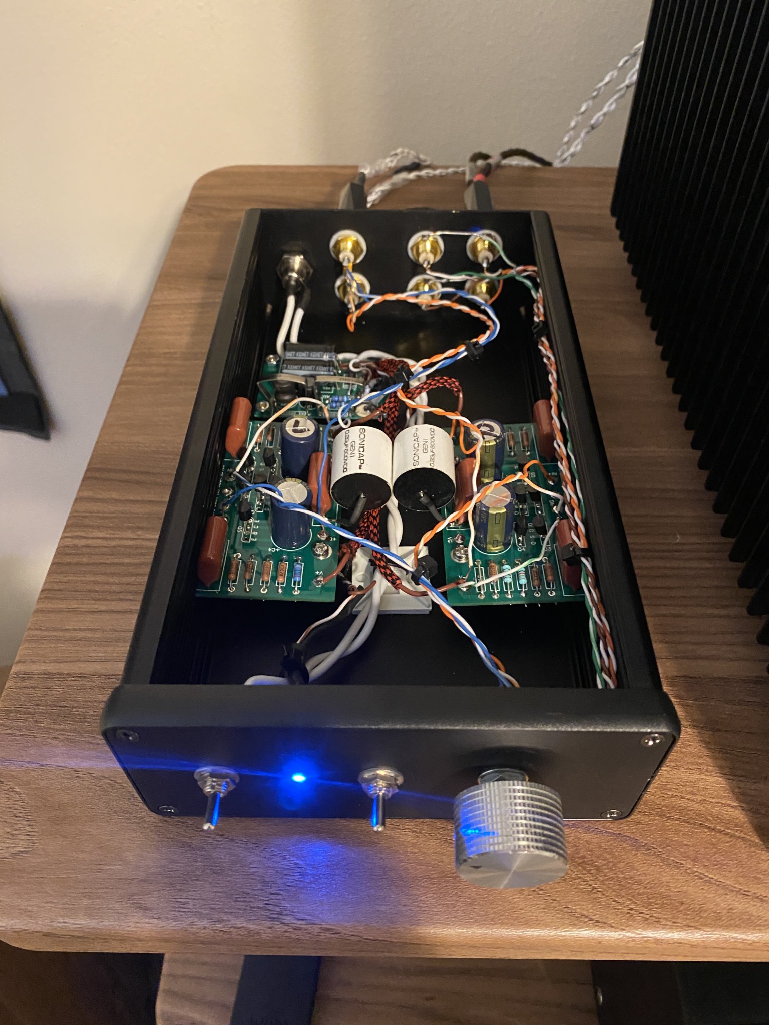

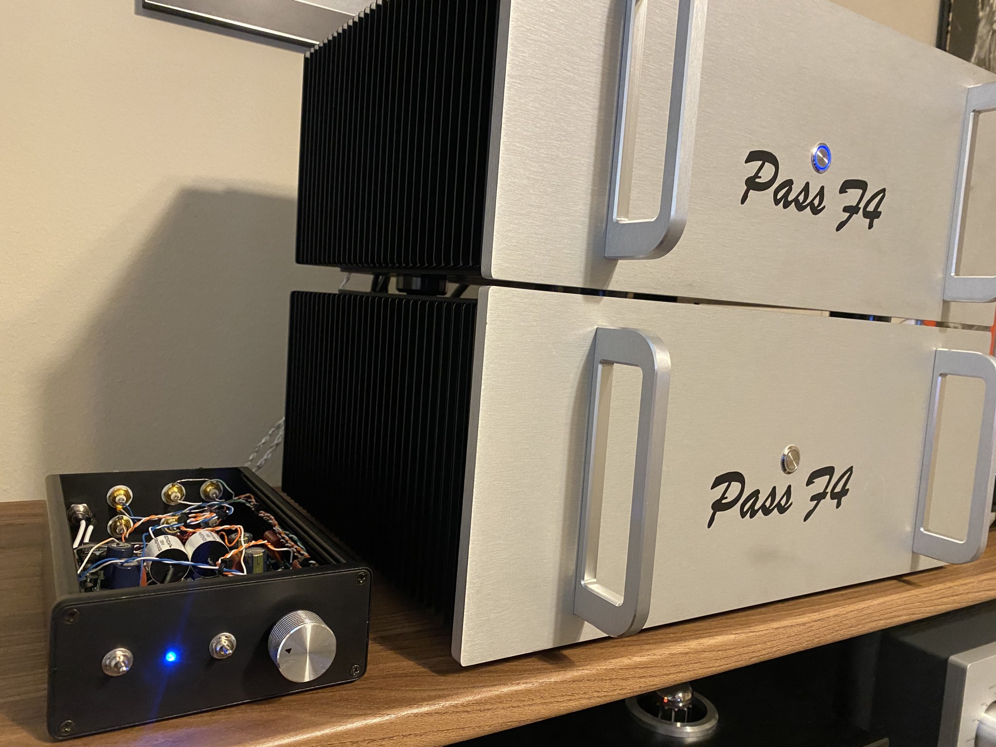

Thought I would share my FE build to use while I build my Balanced BBA3.
Used a small Hammond chassis with 48V SMPS. Also had some spare .33uf Sonicaps that had been sitting around for a long time I added as coupling caps.
Tons of gain for an F4 and sounds fantastic…. Need to hook up the second one now!
