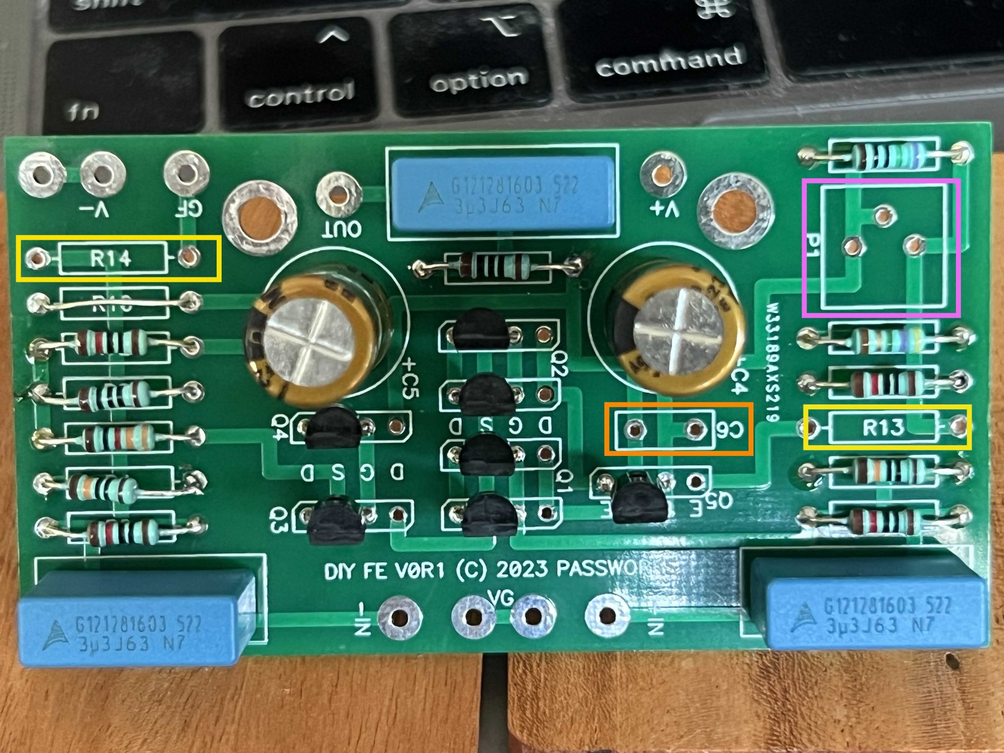

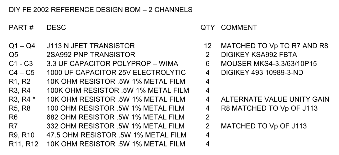

Dear Gents,
I started filling my newly aquired FE board from the DIT Store and did not noteice there are other components that are not in the previous board.
I filled and followed the BOM from Papa's article.
Then ended up with a few missing parts. I would appeciate if I can be guided on with component values that goes in the board as highlighted:

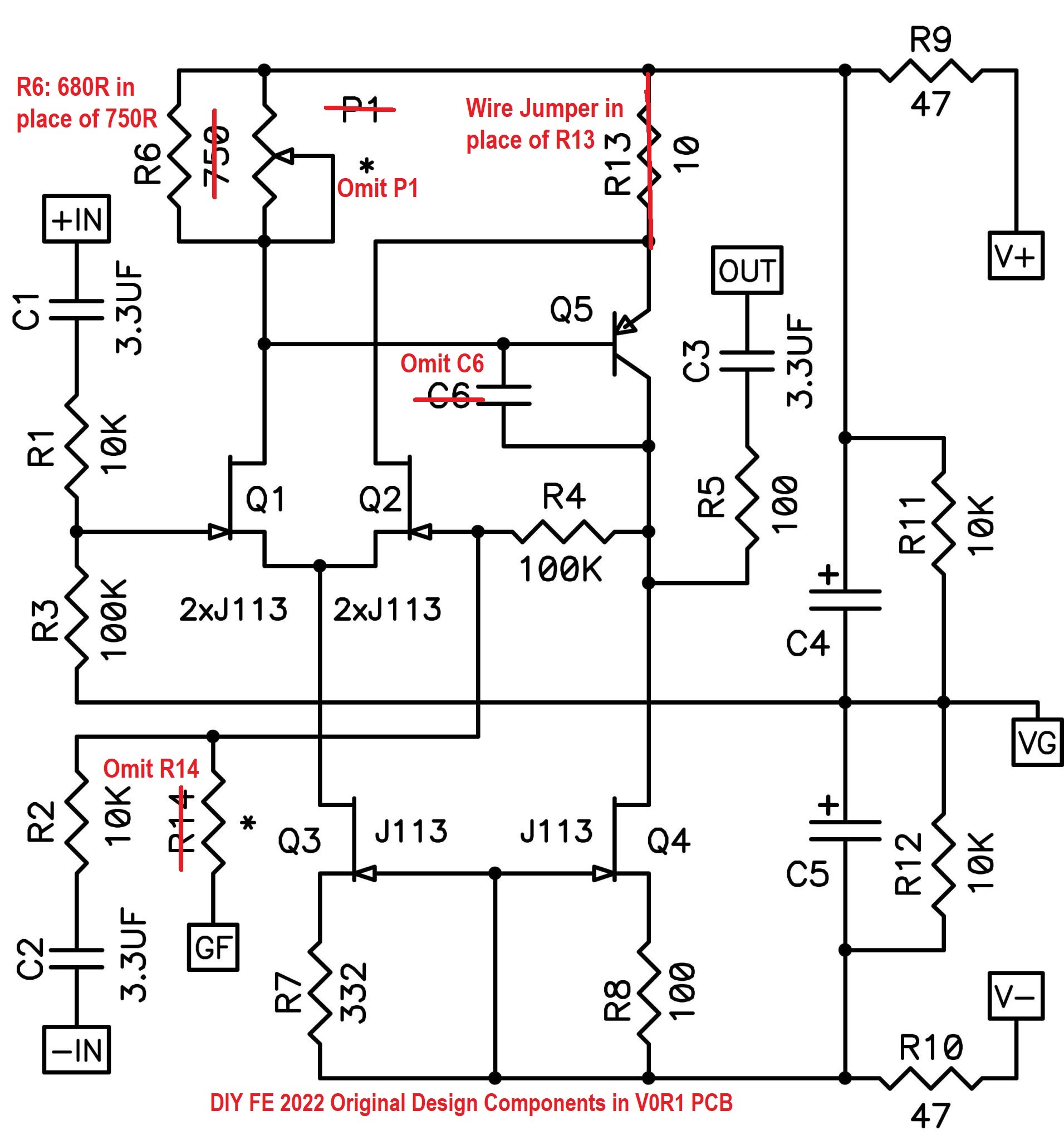

1. R 14 and R 13 ? (yellow) I am not sure if they are the same value?
2. P1 ? (pink)
3. C6? (orange)
Thanks in advance.
If you want to just use the original V0R0 version parts in the V0R1 board, just ignore P1, R14, and C1 (leave empty), place a wire jumper in the R13 position, and install the original 680 Ohm resistor in the R6 position.

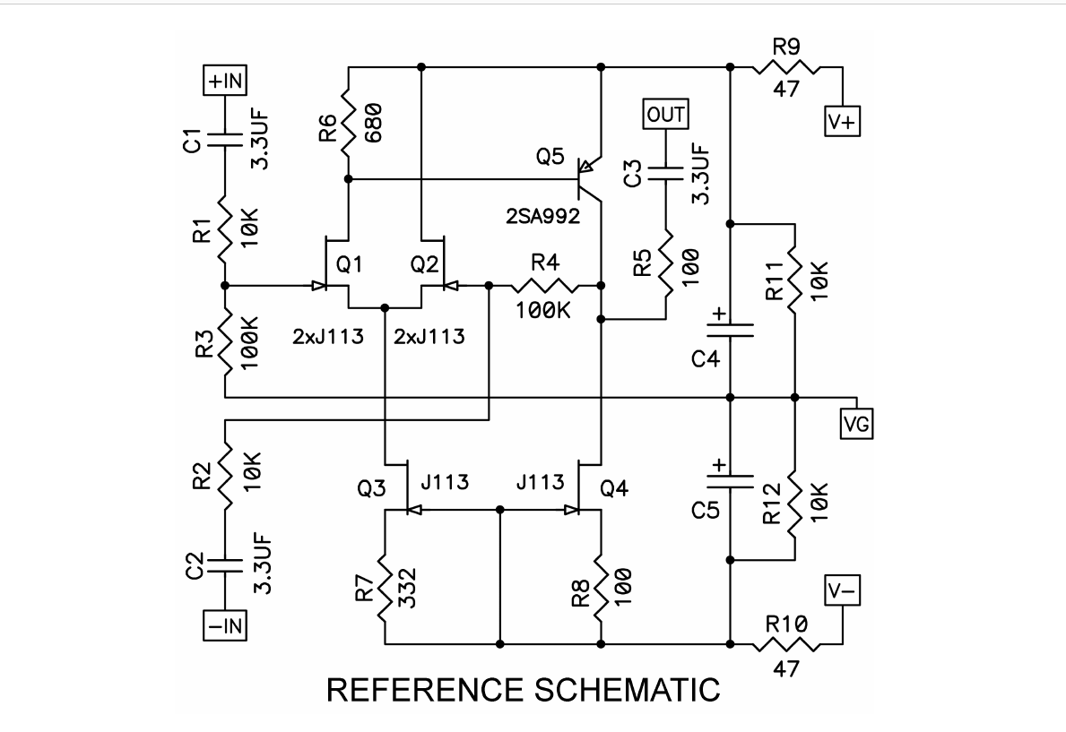

Relative to the other Fairchild types still available, the J113 seems to have an Idss that is actually measurable when matching devices, or around 24mA in my experience. The Idss "minimums" on those Fairchild data sheets are almost meaningless. The J111 and J109 typically have Idss >100mA, for example.
As to the reason NP used them as CCS, I would guess he wanted to keep the same part as for the diff pair, for economy of BOM and prolly because he has so many.
Yes, I have about 300,000 of them. They aren't particularly special, but they
hold up to 70V and they have a decent transconductance figure and aren't very
noisy. I select them by Vp, which reliably translates to Idss and a chart I made
up of CCS current vs Vp vs resistance. Also they come with formed leads which
halves the effort to test them....

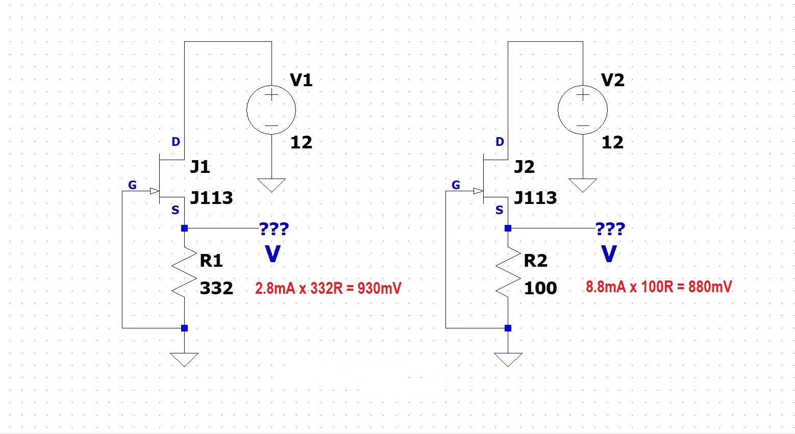

grimberg, If your goal is to sort some J113 for the DIY FE 2022, you can set up the J113 circuit and measure the voltage drop of the source resistor.
Out of curiosity I measured the J113 source resistor voltages of one of the channels of my DIY FE 2022, R8 was 0.95V (0.95V/100R = 0.0095A) and R7 was 1.4V (1.4V/332R = 0.0042A), so 9.5mA at the output stage and 4.2mA at the input stage - close enough.
