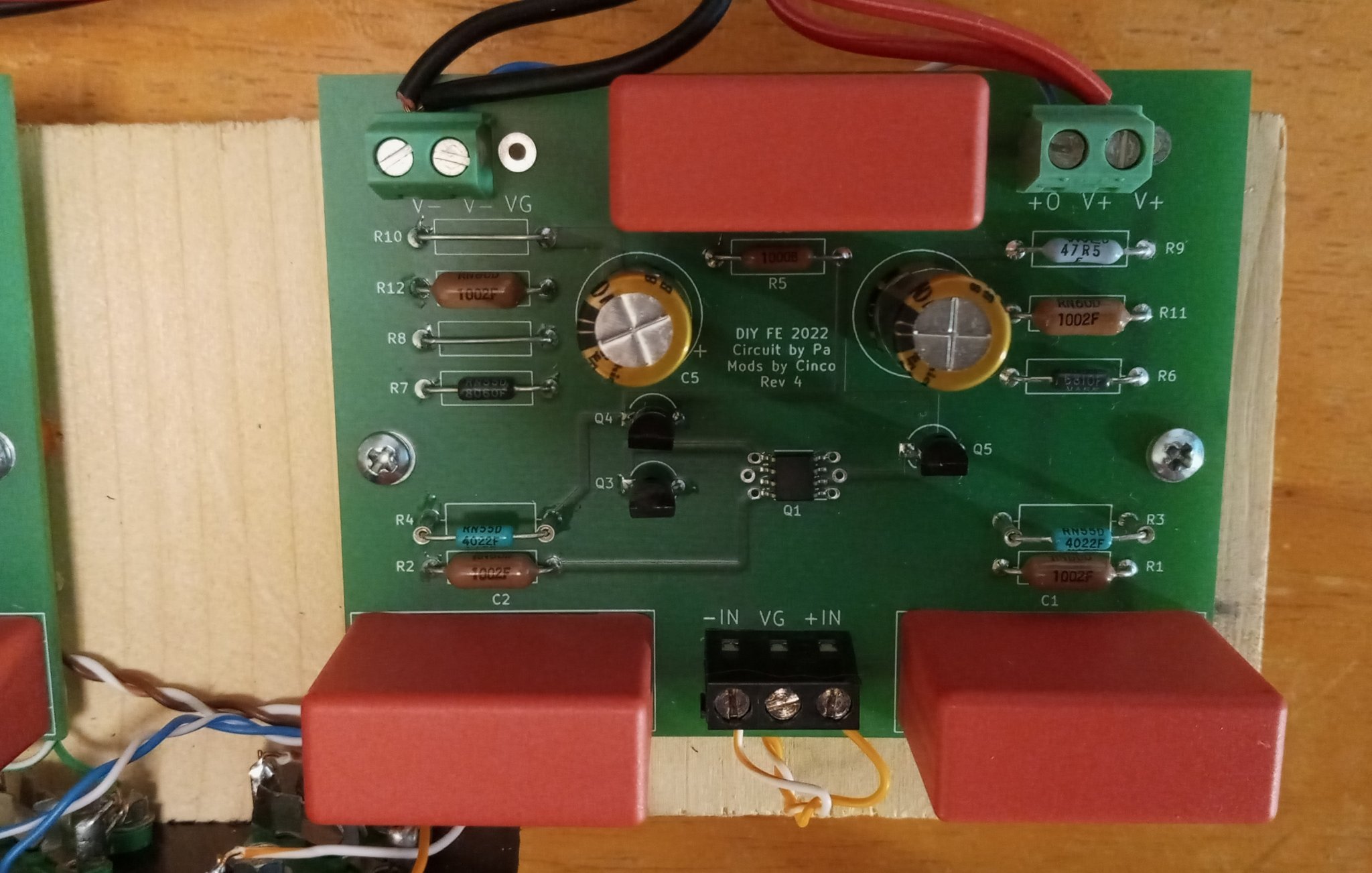

I started with +12dB (which is R3 & R4 = 40kohm) on my MoFo. I like to socket things until I settle on a permanent value,
When I'm happy with the value, I remove the socket then solder in permanently.
BTW, these are my own PCBs with Texas Instruments JFE2140 as the long tailed pair. Can also use LSK389 SOIC or TO-71.
I got a little impatient waiting for boards to be stocked in The Store. :sly:

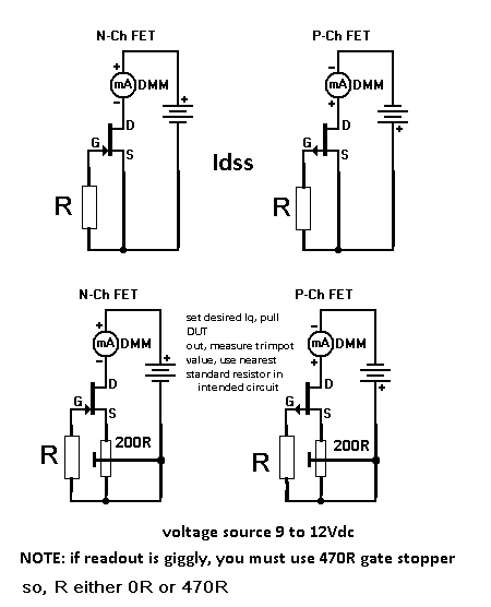

Hi
what are the Current Source Transistors in this build ? is it J113 and if so how did you select the correct J113 as I have bought 30 of them and all of them have more than 6mA and most of them above 10mA. Do you have extra PCB's as I want to use JFE2140 as i have those.

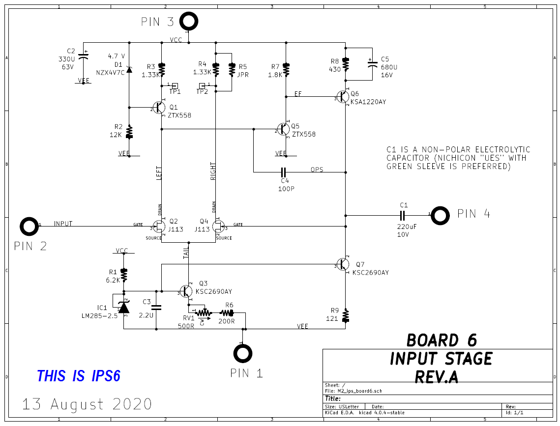

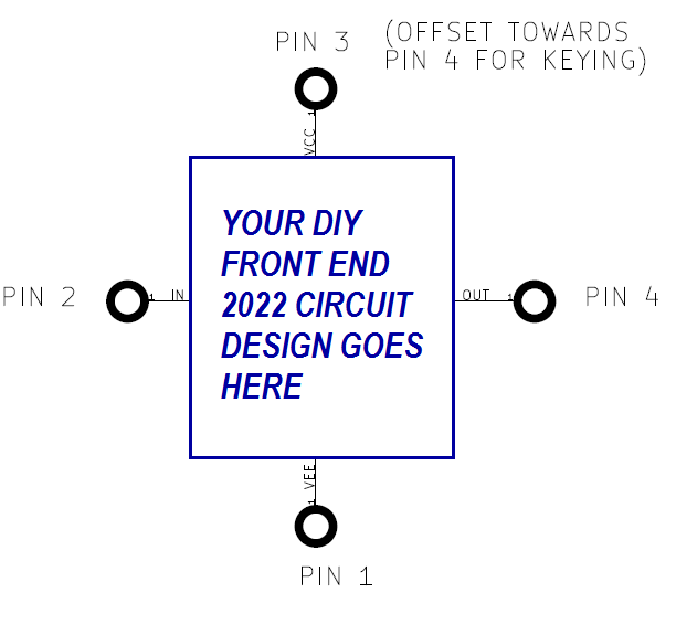

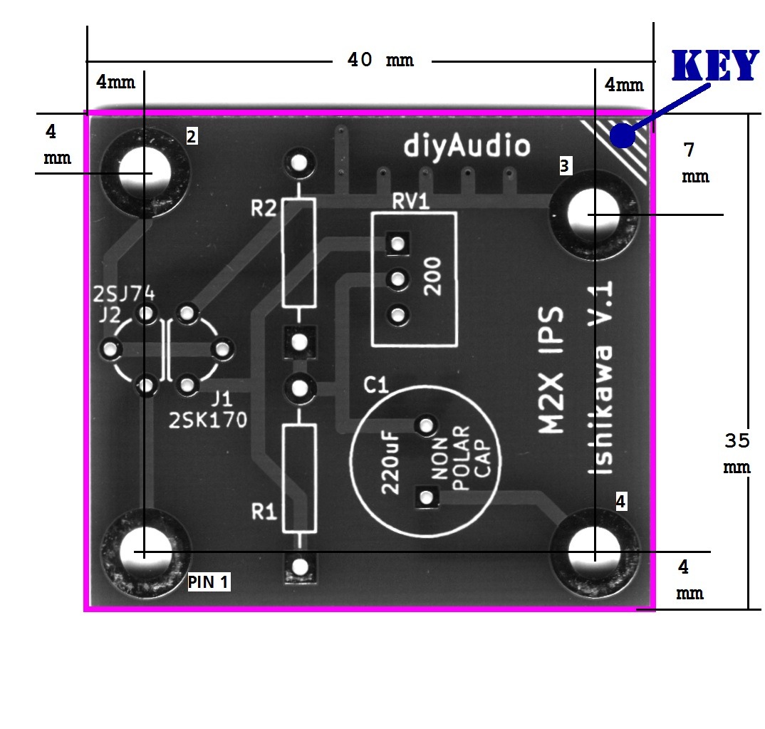

Maybe someone might want to create a PCB which allows builders to use Nelson's DIY Front End 2022 circuit, as a front end for the First Watt M2x (?). It would be a daughter card, just like all the other daughter cards which the Store ships in the M2x board set ("Ishikawa" , "Tucson" , "Mountain View" , etc.). Images below.
I doubt that I'll do this myself. Three years ago I laid out and released Gerber CAD files for the "IPS6" daughter card, which is quite similar, and I'm not too interested in a do-over. But there may be someone who wants to hear Nelson Pass's 2022 front end circuit (daughter card) playing through the M2x output stage. They might decide to lay out a board and publish their Gerbers here. That would be fun, that would be fugly.
