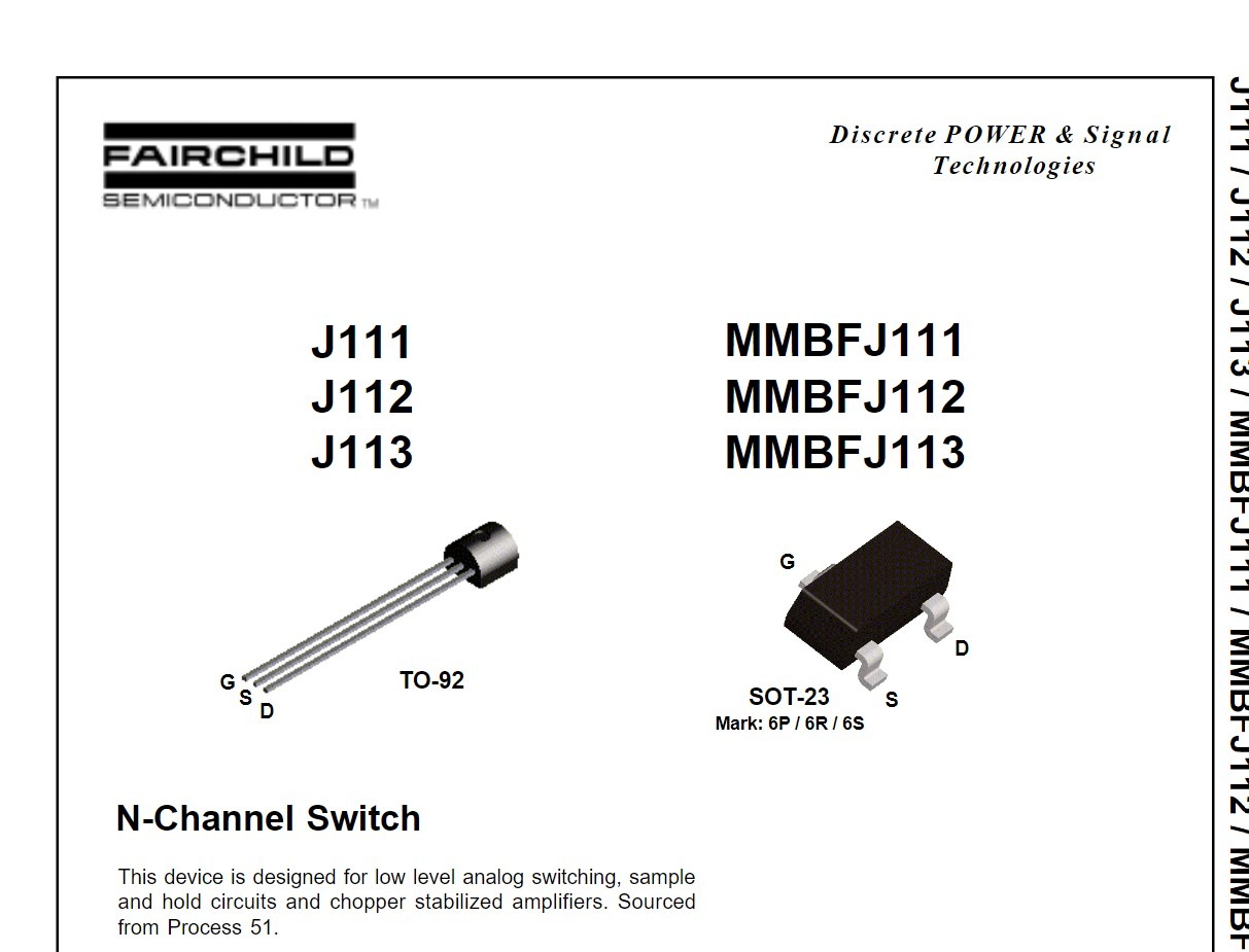

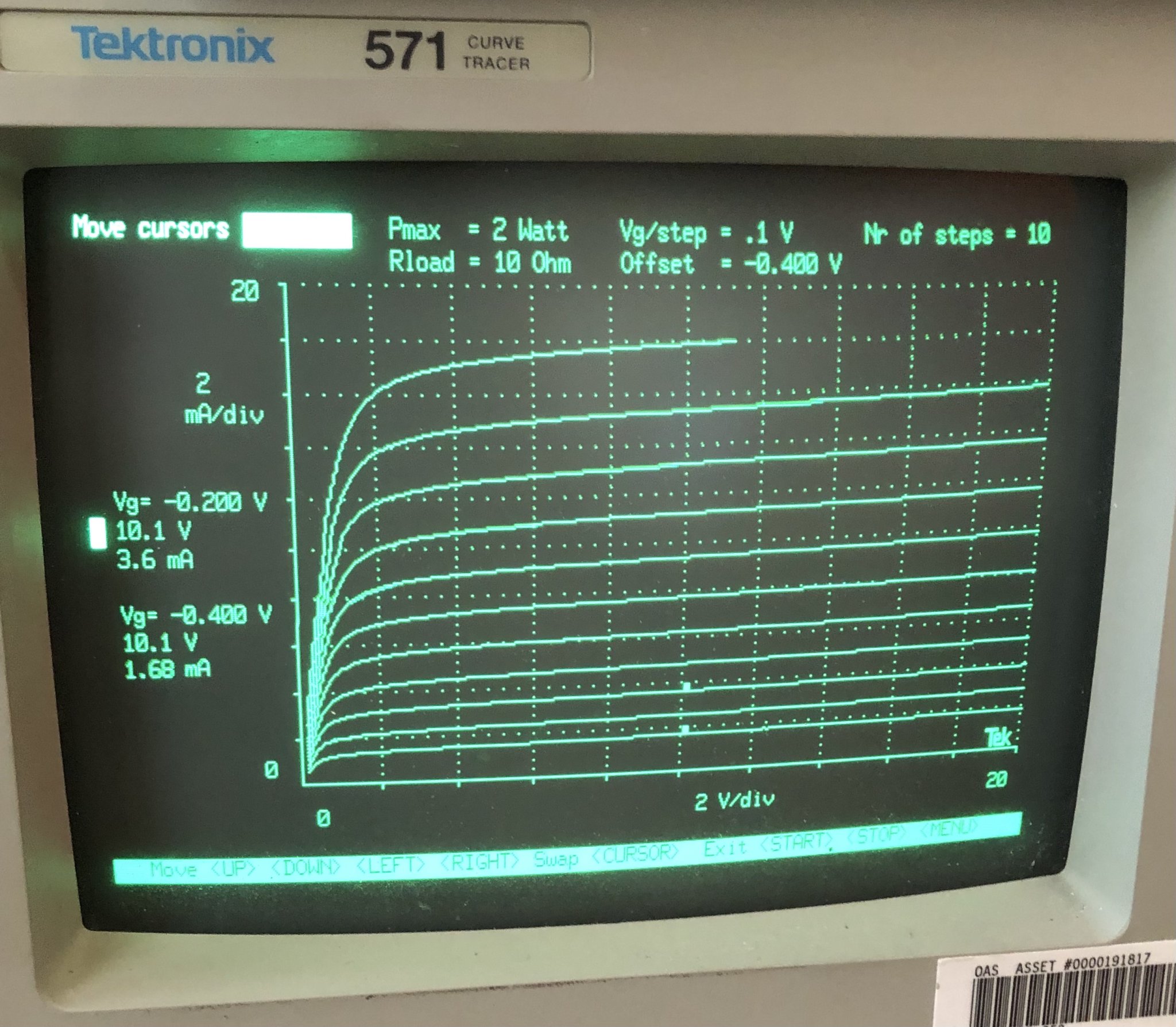

Mystery solved - my J113 is marked as Fairchild but when i checked using the Chinese Transistor checker, it showed Drain in the middle pin unlike all the datasheets showing source as the middle ( only Interfet is having middle pin as Drain). Then i realized i had tested it wrongly and to check i loaded the J113 in the curve tracer pins matching the cheap transistor checker, now I see nice curves with 3,6 mA at -0,2V VGS. I t had survived the wrong connections. Now I will check ( probably around 600 ohm range for Source resistor? ) on the test jig.

Good question. I would like to check them out as well as the duty is more of Constant current source. I did check in the jig and shows 4 mA for a VGS of -0.178V. Also nice Curve tracer output as well

Be careful with cheap Chinese testers. They are incredible value for the money but have some quirks.
If I put J113 in the tester at the same position, but second time rotated 180 degrees (still occupying same test contacts as first time) first time tester identifies middle pin as Source. With rotation, middle pin is identified as Drain!
