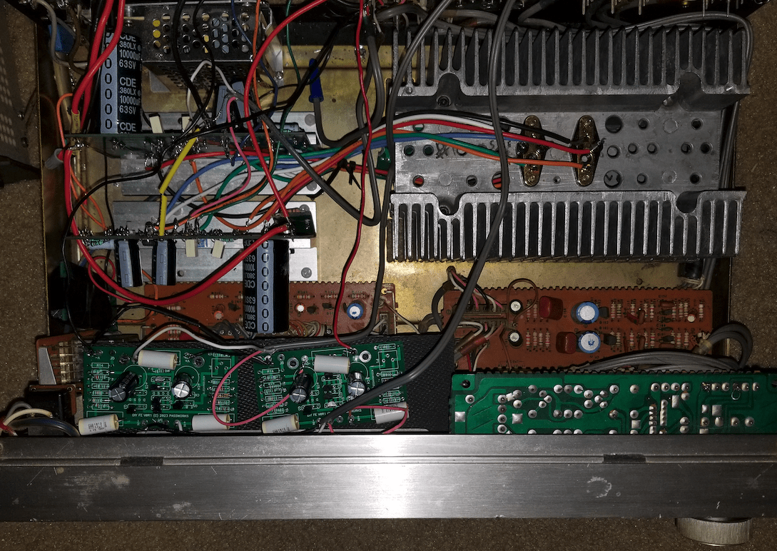

I hooked up the cards with external inputs and outputs then into the OS2 in the Sony TA 4650 chassis build. Room was a problem in the crowded milieu. Picture shows them tucked neatly under the front. Wiring was mostly rearranging the wire already in the unit.
I attached them single ended riding off the 36v power supply that powers the OS2. That doesn't seem to be a problem.
Blessedly with bated breath, I hooked it up to some 3.6 ohm full range panels @88db sensitivity. It worked! Nothing fizzled, sparked, smoked or made funny smells, just worked.
Seems like lots of gain. Even without break in or warm up, the sound is sweet, clean and ethereal, even with a non-ideal speaker. I probably can't hear any increase in distortion due to the somewhat lower than recommended voltage.
