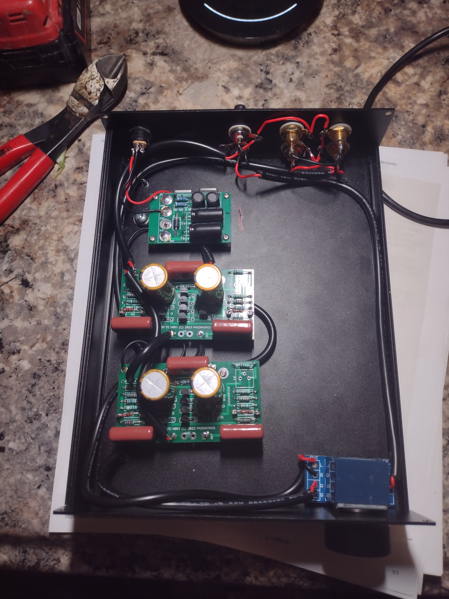

All up and running, works much better once i made a ground to the chassis. Alps 50k pot, installed female headers so I can change out the resistors to adjust gain. Currently using 47k resistors for the gain. Gustard x16 dac for input, first watt clone f6 on the output.
