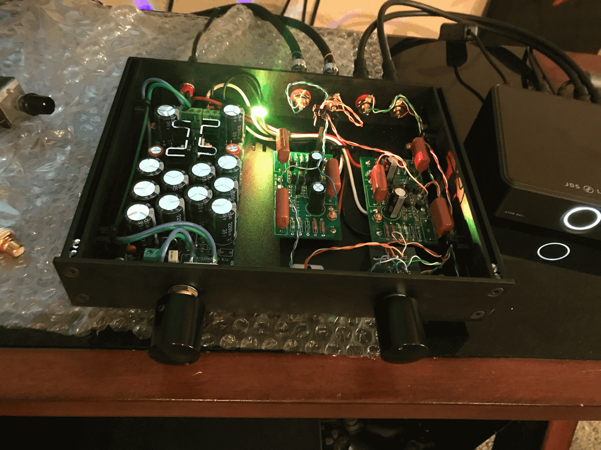

I used the original kit boards with no fancy parts with a VRDN board supplying +/-18V and powering Neal Brock's ACA Redux amps. I cut the heatsinks a little short on the VRDN board and then this lot fits nicely into a small 1U Galaxy chassis.
Streaming from youtube with a JDS Labs Atom+ DAC it sounded really good. To be fair I do not have well calibrated ears, but I liked it, so I'm not sure there is a lot more to add.

I measured 1.4V which translated to 4.2mA. It's close enough since Nelson has said that it is not at all critical.
I measured 1.4V which translated to 4.2mA. It's close enough since Nelson has said that it is not at all critical. So no worries. 🙂
Now my board quite perfect, 1.4V across 332R, 0.9V across 100R, offset 35mV with original value.

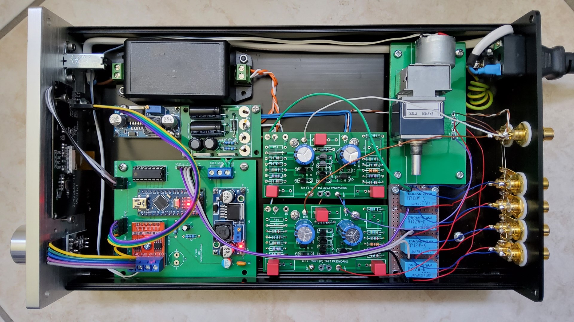

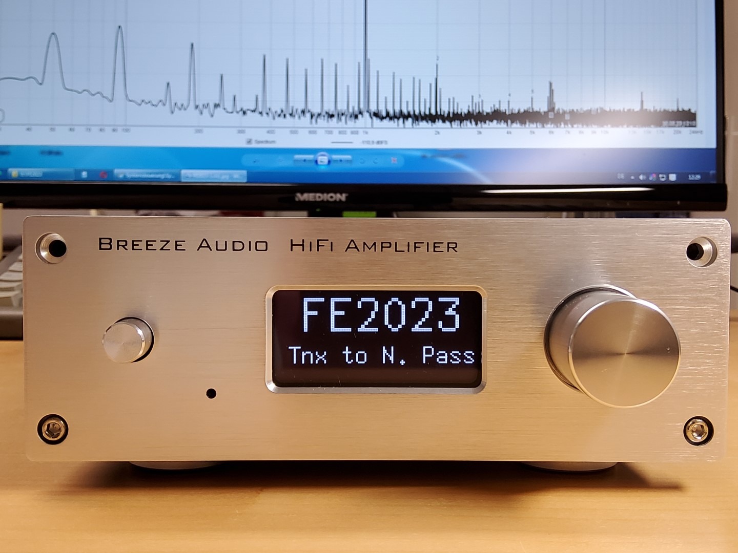

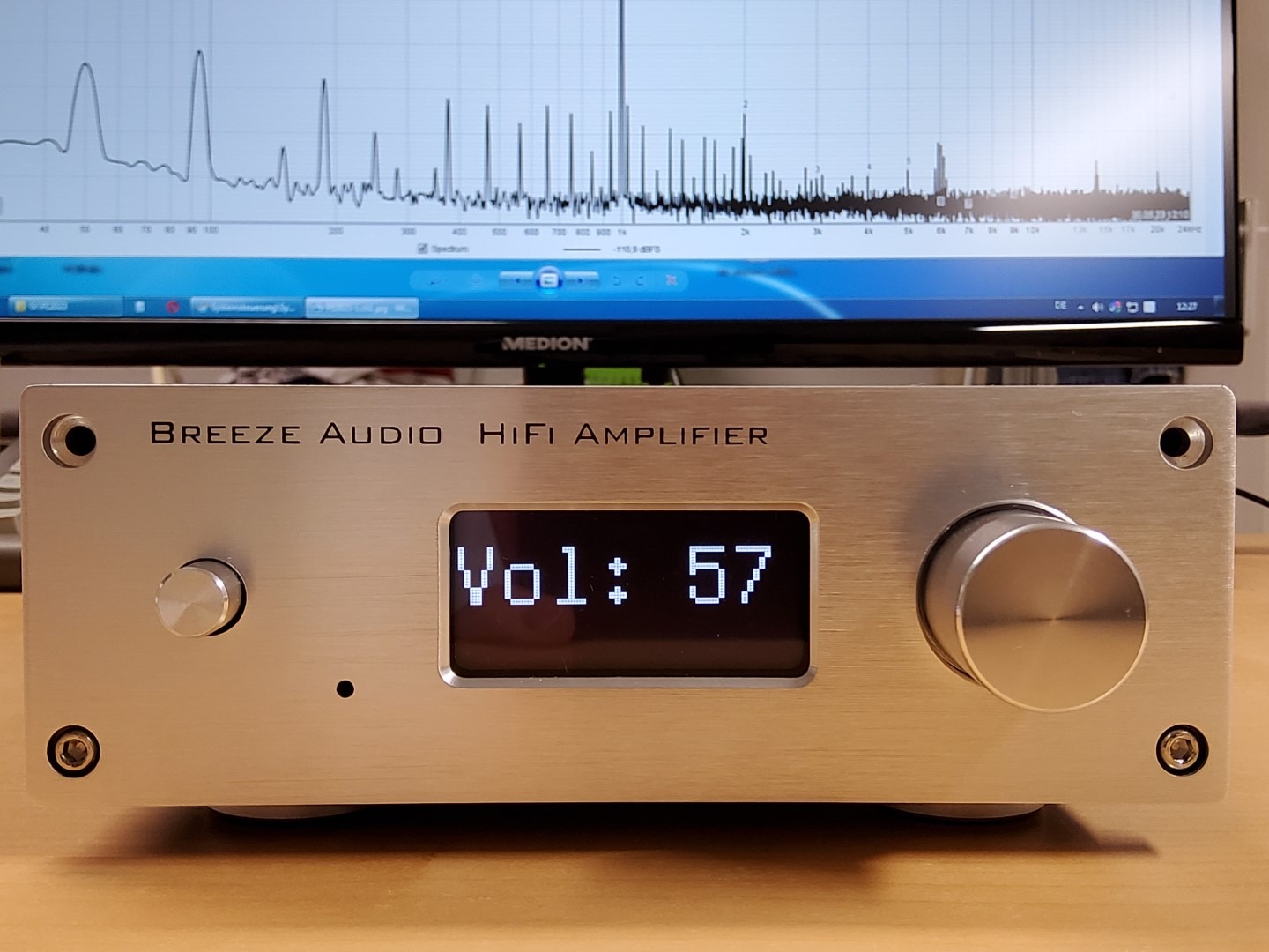

My FE2023 build with remote control is ready to fire up and testing now.
The idea is to use an old IR control lying around for input selection and volume control.
At first this project was planned to control an Iron Pre.
Some specs for this I have posted two months ago in Iron Pre builders thread.
But why not to use it in FE2023? I asked myself... So thought, so done and
I made my mind up to take a chance on a SMPS and found a tiny MeanWell with single 48 V 30 VA.
Why worry about 16 MHz from arduino, 150 kHz from step-down DC-DC converters
and 65 kHz from SMPS? Those high frequencies in my age are really unnoticeable...:nod:

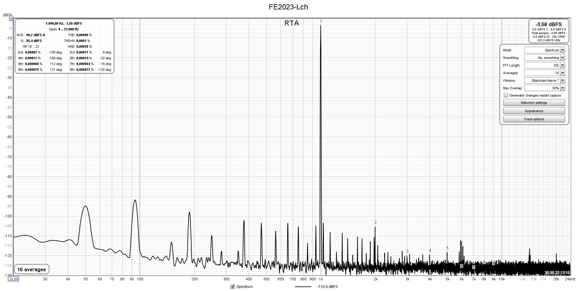

The first quick connect to REW w/o load looks very nice and I'm singing now:

If anyone is interested in this project I will provide all data to make it real with Gerber, wiring plan, software and support.
Last but not least many, many thanks to Pa for this excellent and fantastic circuit with KISS
and the best quality kits from the store.:worship:
More, please. The DC-DC converter and the Arduino and display boards. Are they discussed elsewhere on this site?
The remote control and all its components are working in digital domain.
So, I don't think, that this thread is the right place to discuss their properties.
You buy these for a few $ or €, solder on PCB, provide +12 V and upload the software. That's all.
The idea and BOM was posted in "Iron Pre Essentials Kits For The DIYA Store- Register Your Interest"
at #336 and #344.
Send me a PM, please if you need more details and want to build it. I'm trying to help.:wave2:
