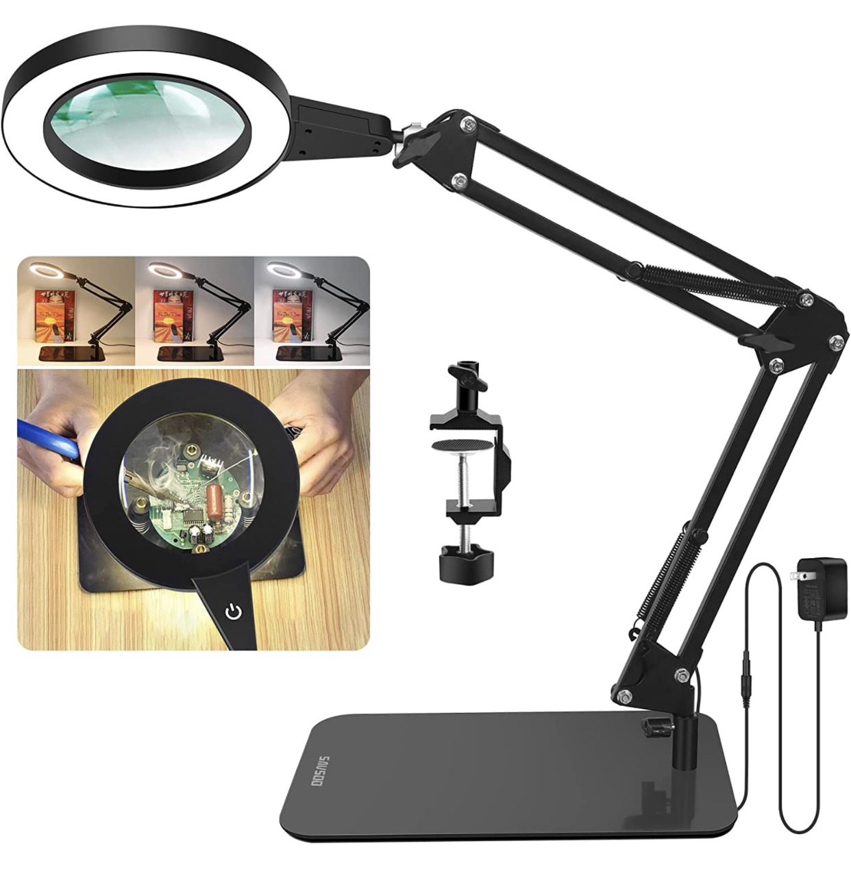

What? Nerve racking soldering? Get yourself a proper worklight with magnifying glass. Those are worth much more than their weight in gold 🙂👍
I actually use one of those headband 'stamp collector' types - they relatively cheap, not exactly professional fitting, but do the job very well - I'm currently looking at those "Vision Aid" ones with the included led light at about A$60.
I find the 'work-light' magnifier a bit clumsy with larger projects, but perfectly okay for small ones - the more recent led versions far better than my old fluoro tube one plus an adjustable "Planet lamp".
I have a table lamp almost identical to the one pictured and also this loupe for finer work. Both together aren't expensive.
