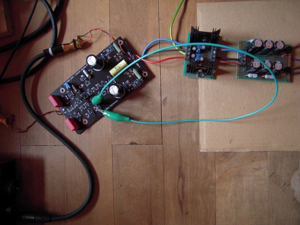

Hello frontend2022-builders,

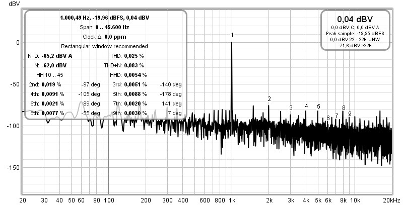

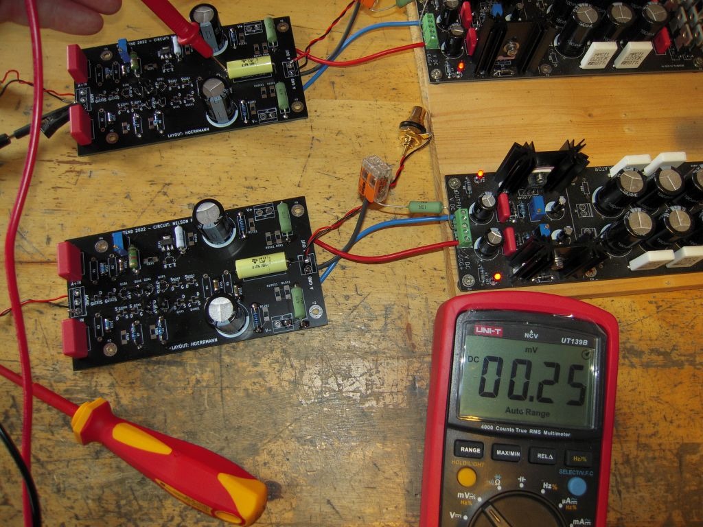

I made a new 'start-up' with this nice circuit. Made some new pcbs with more possibilities for experiments.
At Q1/Q2 I used Toshiba 2SK170 GR with an Idss of 6,81mA. Very well matched.
I exchanged the KSA992 against a ZETEX FZT951. Running at 9.8 mA. Why? Because I wanted to test it... It is a very low noise BJT.
Some adjustments to the resistors to get the DC-offset before the outputcap C3 to 1-2 mV. Behaves stable.
Very important: railvoltages have been reduced to +- 16 V DC - I didn't want to cook those precious Toshibas
After the 47 Ohm resistors (R9 / R10) I was anywhere around +- 15.5 V DC.

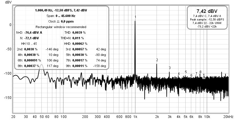

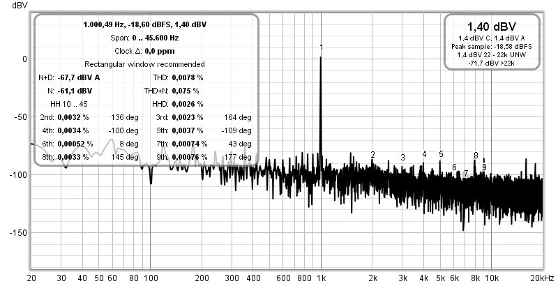

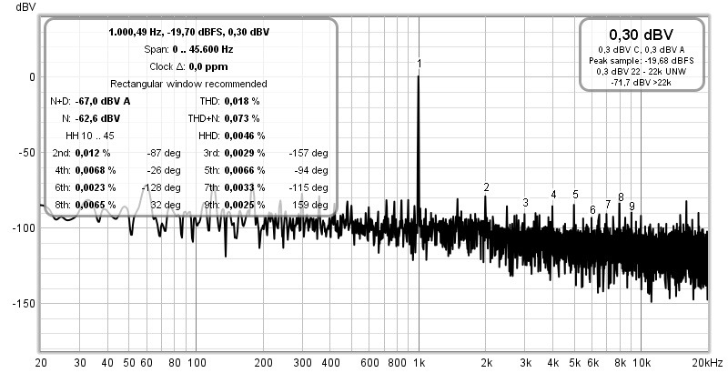

Then I made some measurements with the Focusrite Scarlet and REW.
Tried inputvoltages 100 mV / 500 mV / 1v sinus at 1 kHz. At output of the frontend 2022 - a 10kOhm resistor.
With 100 mV sin in I measured slightly above 1 V sin out.
And I've got this - in the pics...
Perhaps I can listen to this little creatures this evening?...
And they need some more adjustments...
Only some infos about my journey into this circuit.
Have a nice sunday!
Dirk 🙂

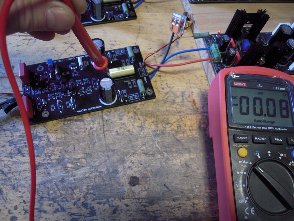

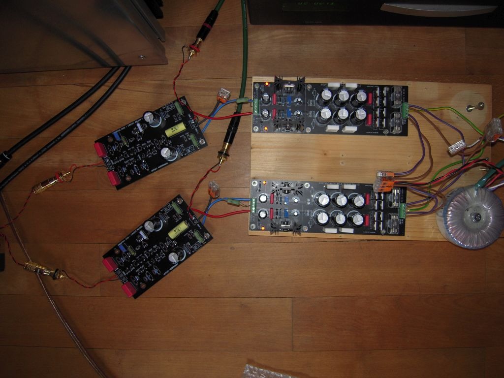

Hello out there,
could adjust the DCoffset at output to below 1mV. They are hangin' on the better PSU.
Those 'babies' are playing music...

Interesting FFTs. The distortion at 0.5V in is higher than at 1V in.
Is Vsin rms or peak?
The distortion levels overall appear quite high.
Is the noise level lower with the better PSU?
Hello Ben Mah,
the generator in the Focusrite shows 100 mV RMS or 141 mV peak.
Good night!
Dirk
Good night!
Dirk
The latest measurement shows lower noise level, below the harmonic distortion. So the better PSU does measure better.
When I do FFT measurements, I average the results. That way the plot of the noise shows with a smaller range in levels, allowing the harmonics to be more visible if they are at approximately the same level as the noise.
I am still curious about the overall distortion levels. They appear to be quite high considering that 2SK170 were used in place of J113 at the input. The distortions are actually higher than what would be expected for J113. Could it be the Focusrite generator? You could do a loopback check of the Focusrite at its various output levels. Also the Focusrite XLR input is cleaner than the TRS input. Which input were you using?
And your 0.5V input plot showed higher distortion than the 1.0V input plot. Perhaps they were mislabeled?

I have used the TRS-input. Will make a loop-check with the Focusrite.
