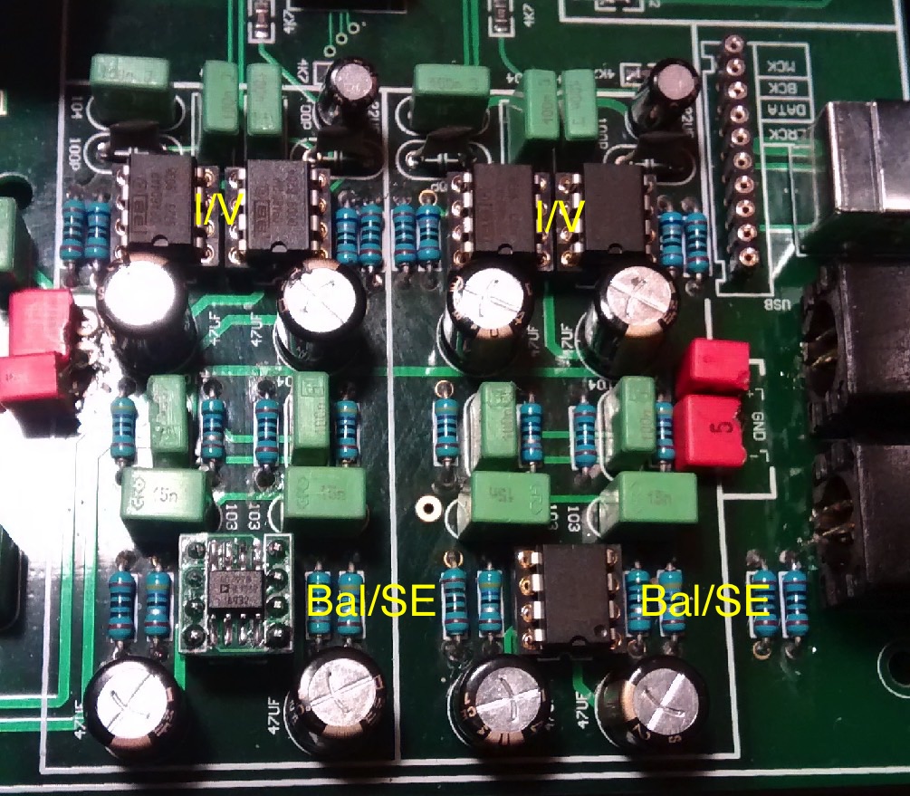

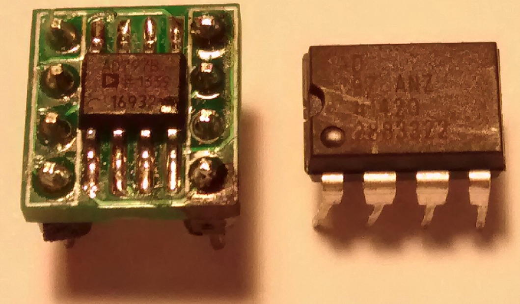

I purchased 6x AD797B in RS.
I put in the weilliang DAC. Measures are identical to 6x AD797ANZ received from Weilliang Chinese manufacturer.
I think the AD797ANZ received from Weilliang are originals.
And oscillate in the circuit I / V like AD797B. Also original RS AD797B oscillate. But they work very well in the output Bal / SE.
I have found that the 4x I / V is very hot AD797B like AD797ANZ. And 2x output buffer balanced to SE no hot AD797B like AD797ANZ.
4x I/V OPA604 is not hot.
2x Bal/SE AD797 with 4x I/V OPA604 is better measures than 2x OPA604 or 2x LME49710 .

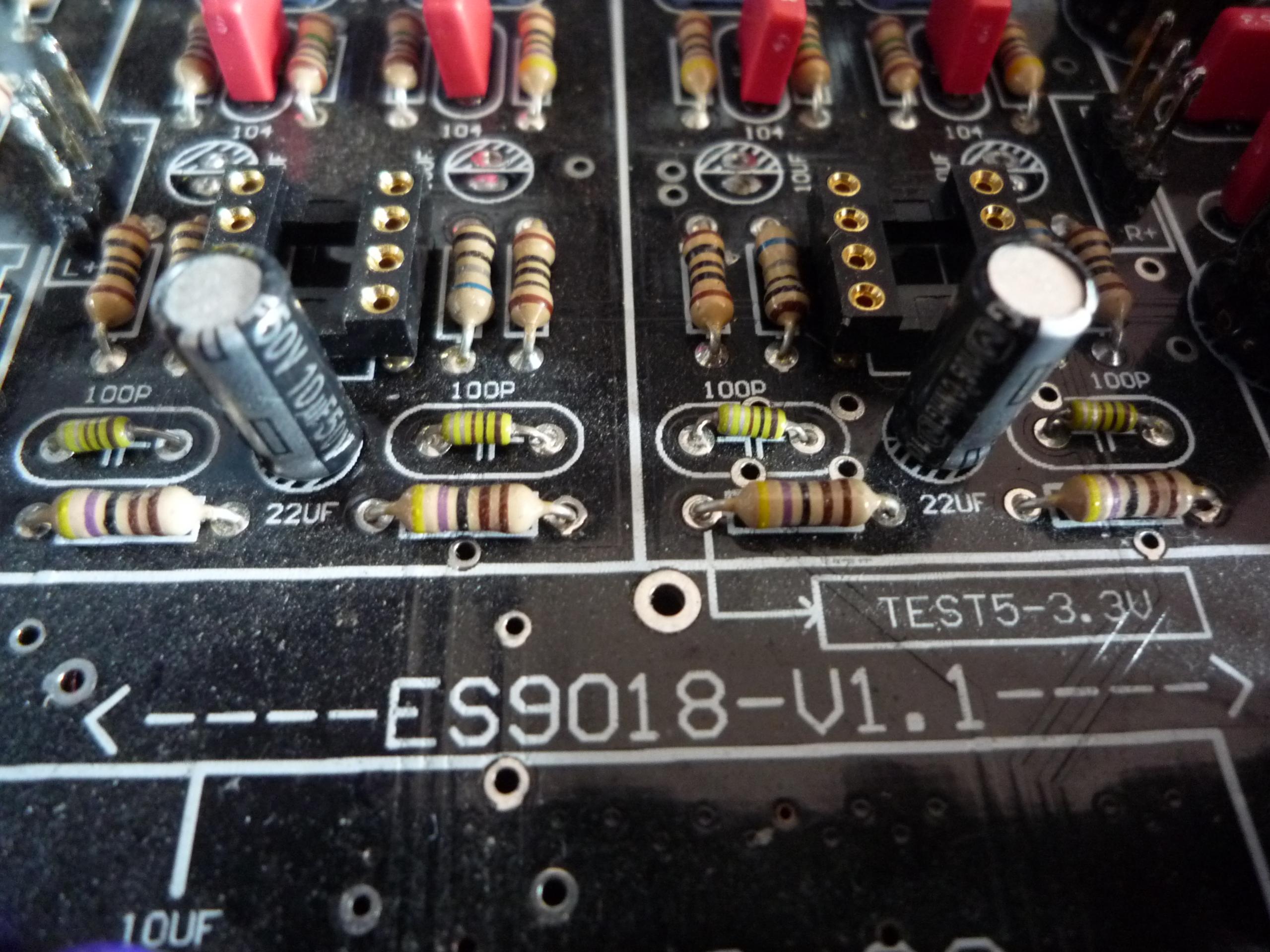

I've finally gotten round to giving my 2 layer board an overhaul. A close inspection appears to show 4 resistors fitted where there should be capacitors.
LC2 & LC10 are marked on the schematic as capacitors with a value of 100P (101 caps maybe?) They are adjacent to the dual opamp. Same for the other channel.
It seems the board has been fitted with 0.1ohm resistors instead.

Those are caps. No doubt but take one out and measure if you are unsure. If they would be 0.1 Ohm resistors not much signal would come out 😀
Caps which have resistor colour bands on them? I have never seen a capacitor like that before. I'm talking about the 4 things in between the electrolytic caps, and above the 4 resistors in the foreground., marked 100P.
Yes those are caps with a color band indicating their value. In the past also caps were color coded and some Japanese manufacturers still make caps in this form. To distinguish them from resistors they tend to give them odd colors like light green. Just leave them or, if you want the best of the best, change them for styroflex caps. They are definitely NOT 0.1 Ohm resistors.
http://www.csgnetwork.com/capcccalc.html
BTW why are the 10 µF decoupling caps (electrolytic) gone ?
BTW 2: if those 22 µF caps are the output caps changing them for MKT 22 µF will really give a benefit.

Well I already replaced some cheap blue caps with the red WIMAs you see in the picture and removed the 10uF decoupling caps as I am part-way through upgrading the board. The 6 smoothing caps in the digital supply have also gone.
There is a significant problem with noise in this DAC which is why I am looking to upgrade it's components. I did not rule out any type of idiocy with the build, as the 22uF caps are actually again 10uF.
It does seem to be a capacitor in the photo but the colour bands do not calculate to 100Pf.
Measure them in that case, I think they're 100 pF. I would use styroflex there but I stock those. They are possibly hard to find nowadays. You can't go wrong with Panasonic FC 10 µF 50V for decoupling the IC but beware that you buy the "thick" version and not the ultra thin version (yes there are 2 versions 10 µF 50V). Replace the 10 µf output caps for 22 µF 16V MKT. If you can't find them I can supply those as I bought the very last batch from Wima a couple of years ago. Don't think of DC coupling unless offset is 0 mV 🙂 Beware I don't know this DAC so I assume the 22 µF are output caps. Please find out if they are.

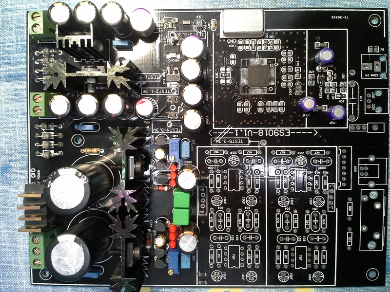

Here is the full board.
I have already made some changes:
The two large caps top right and all of the red ones are now Panasonic.
The larger electrolytics to the left of the heatsinks were Silmic II on delivery
The small red electrolytics are now Wima MKS2
I have got Panasonics to fit where caps have already been removed.
Can someone help me scope out what else to replace?

That board is not brilliant design. I have it year or more back. I start to build it but i noticed quite some mistakes.I don*t know anymore because that dac was not interested anymore because of just spdif input... also usb input is spdif input.
If i remember corectly...something was vrong around RCA gnd..i think it is connected wrong.
15V regulators are quite noisy, i redesigned it and it was ok but not perfect. Use L or 4.7-10R resistor and cut the lines to opamp suply lines.
Decouple 1uf before and after all 3 ADP151.
I think that also one resistor on spdif input is not ok ...i think it is 10k around LMV spdif ic...
cut out those reistor capacitors...put 68-100p wima or mica, styroflex are hard to find.
22Uf cap change to 10uf tantal and 1uf mkt...this is important filtering of offset pin voltage. it brings a lot in mycrodynamic. Ic decoupling caps 47uf KZ or FC. and under the board some 100-470nF mkp or pps or mkt or ceramics.
