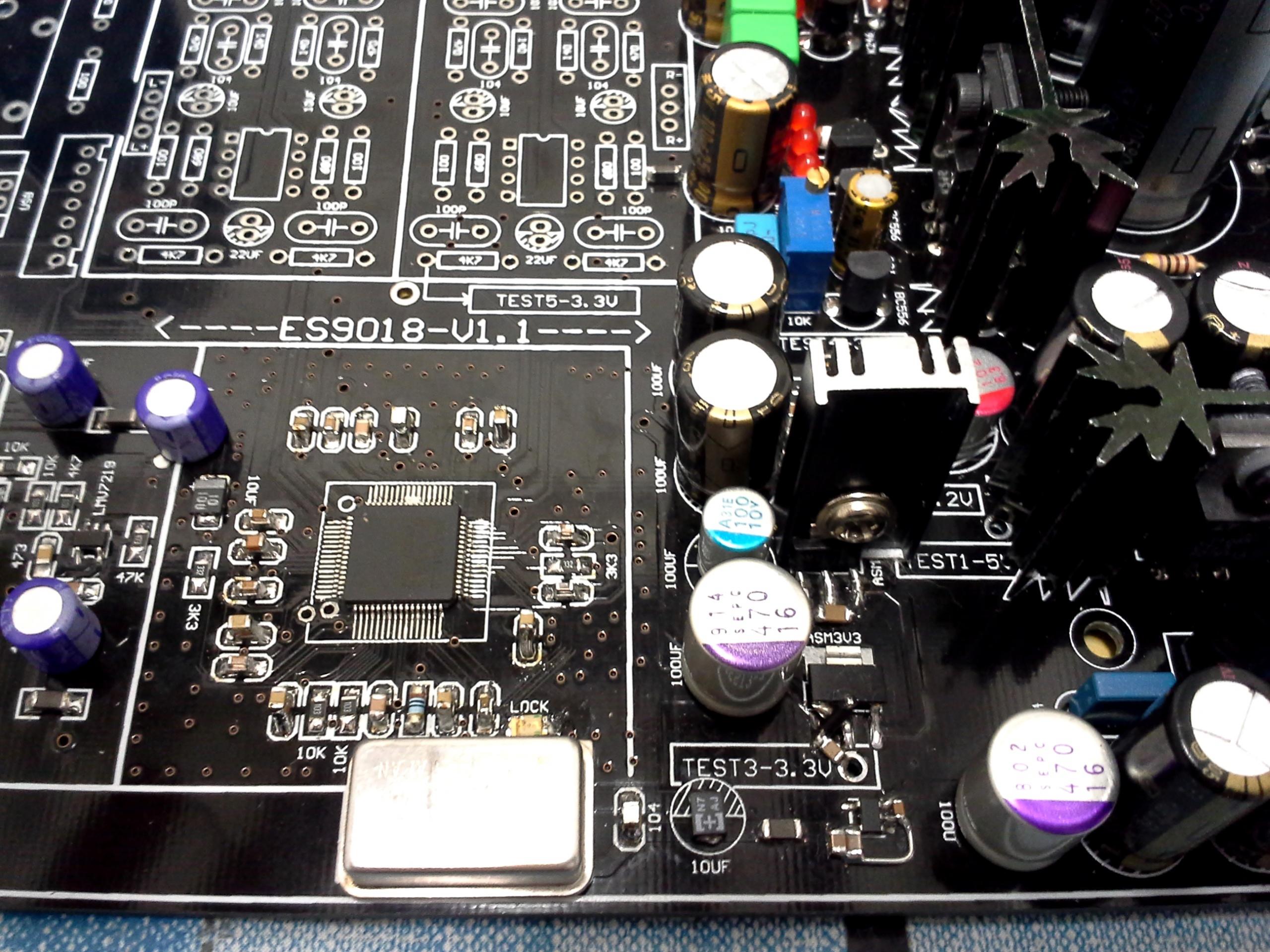

I get also that 2 layer black es9018 dac into my hand.

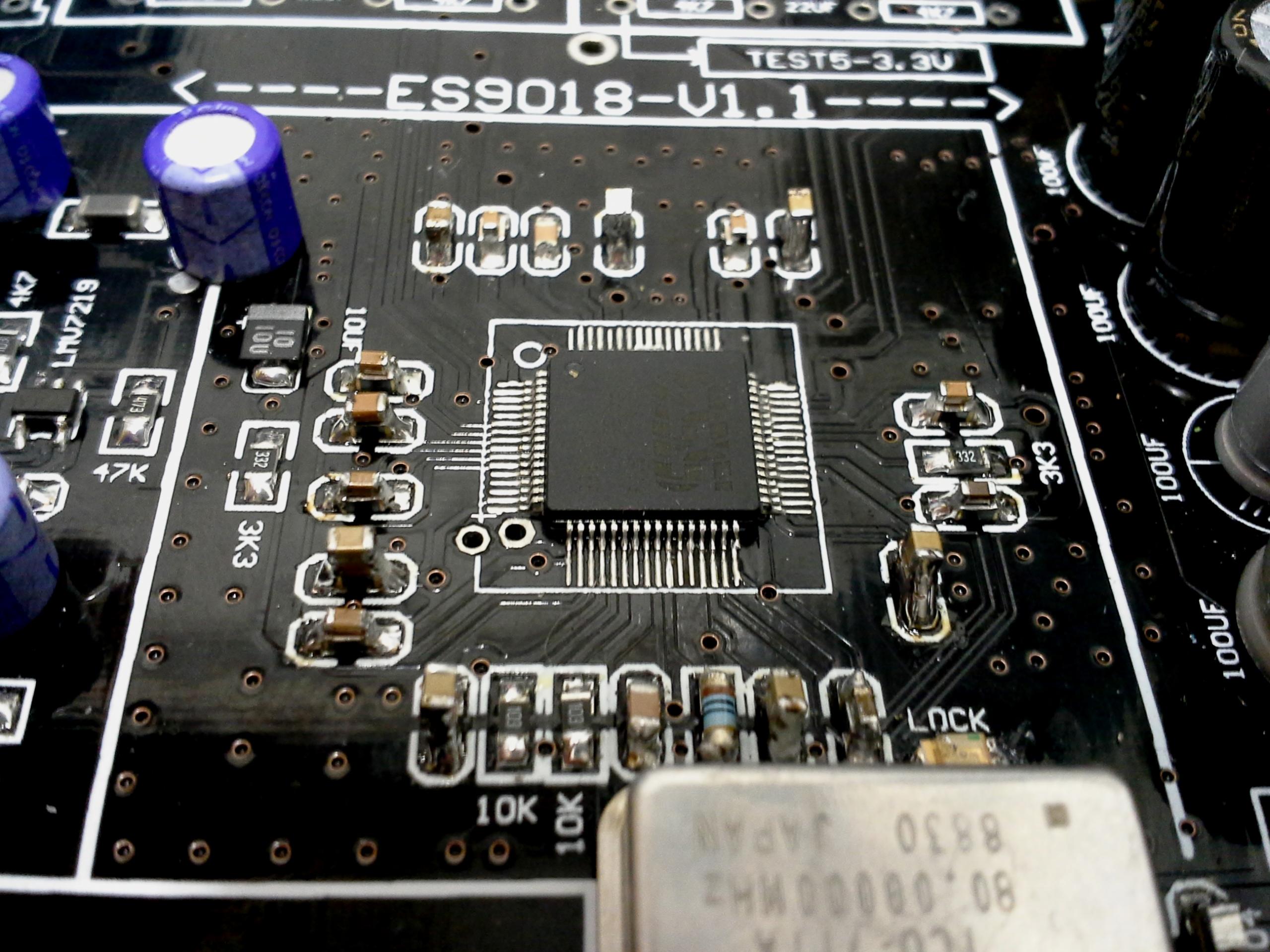

Some question... do you guys also have *problem* with ams1117 1,2V regulator. It gets very hot. I installed heatsink on it but i can stil touch it for max 6-7 sek. Can somebody measure resistance between 1,2V output from regulator and GND on this dac? I measured about 0,6ohm.
Dac is working, lock led is turning on at output from es9018 i get signal...measured with scope, but output stage is not soldered because I look for another suggestion.
I do some modifications.....
Kubota regulator gets some ripple when you instal first 2sk246 ...i haven*t get 2sk30 that is on scheme. So i change it to bf245a biased to 1,8mA and ripple is much smaller.
Zener diode is changed to 3 LED, at output i put 600ohm 100khz inductor and ripple is almost 0.
3,3v ADP gets 1uf smd at input and output and also 600ohm ferrite after 220uf cerafine.
3,3v ams1117 is changed to lt1963 3,3v, ripple is 40% smaller and I can put os-con after reg. After ams1117 os-con is not a good choice.
Es9018 gets at VDD 100nF+10nF PPS+10UF smd
Avcc 1UF+10nF PPS
Dvcc 100nF+10nF PPS
I put original sheme parameters of second stage in

Some picture of reg and some playing with multiple bypassing at es9018.

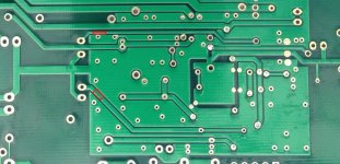

Hello androa76.
Mine is 4 layer. No overheats the ams1117.
I asked to manufacturer DAC scheme to help solve my problem.
I mailed to manufacturer graphic measures before my answers on this forum.
But never responded me.
Do you have DAC scheme?

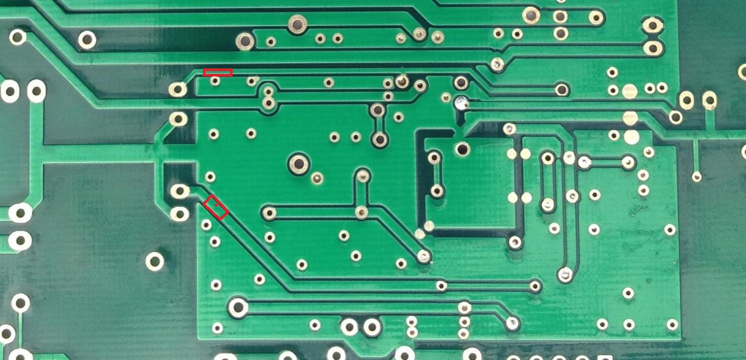

After AMS1117-1,2v try to cut lines and instal 600ohm ferrite. Put 10uf smd on the top of 0,1uf smd. Ferrite + cap = noise filter.
I have done on all lines and noise is much smaller.

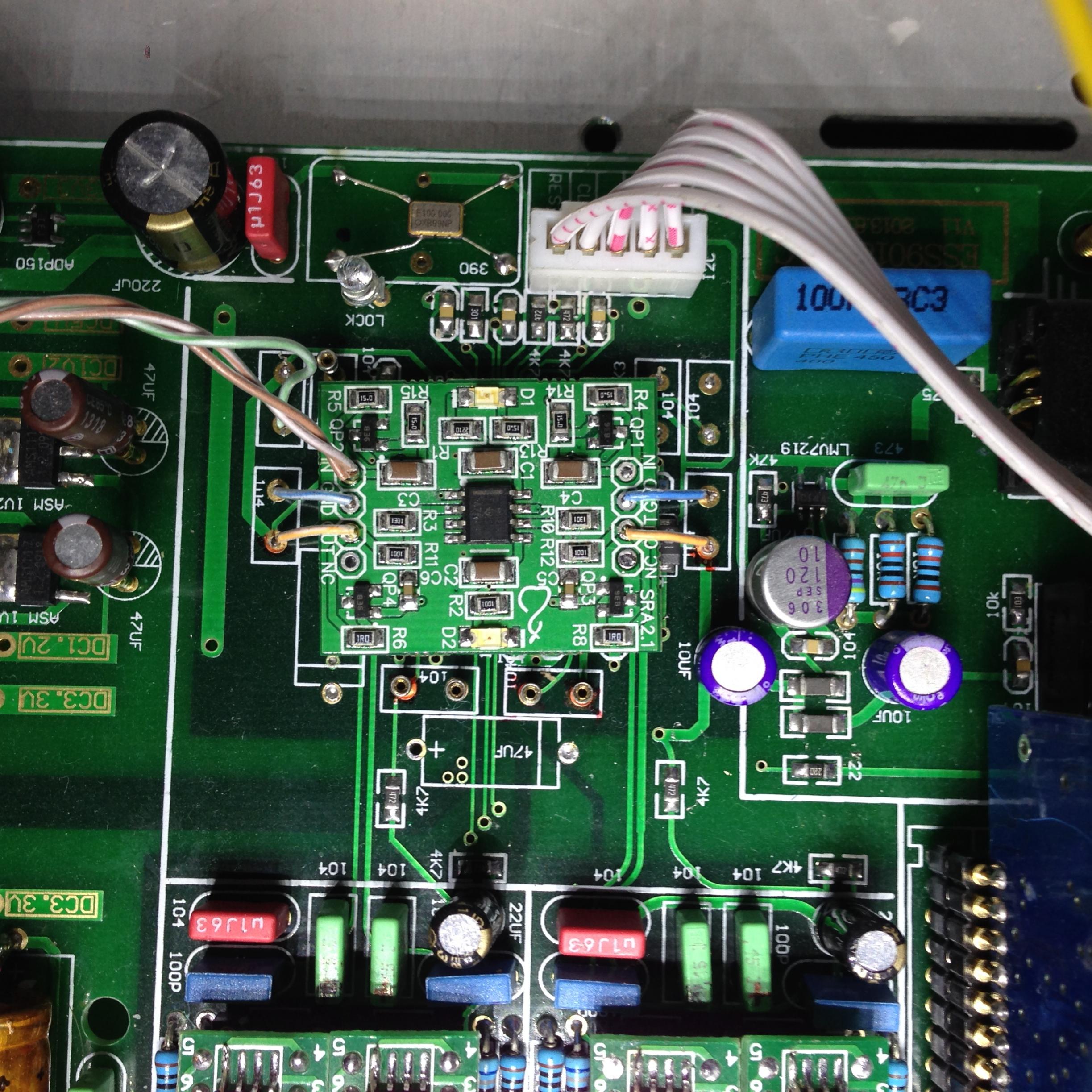

What do you think about output stage schematic???
Btw if you need schematic for your green dac, send me your mail. I have other problem, i can*t get schematic for my dac board

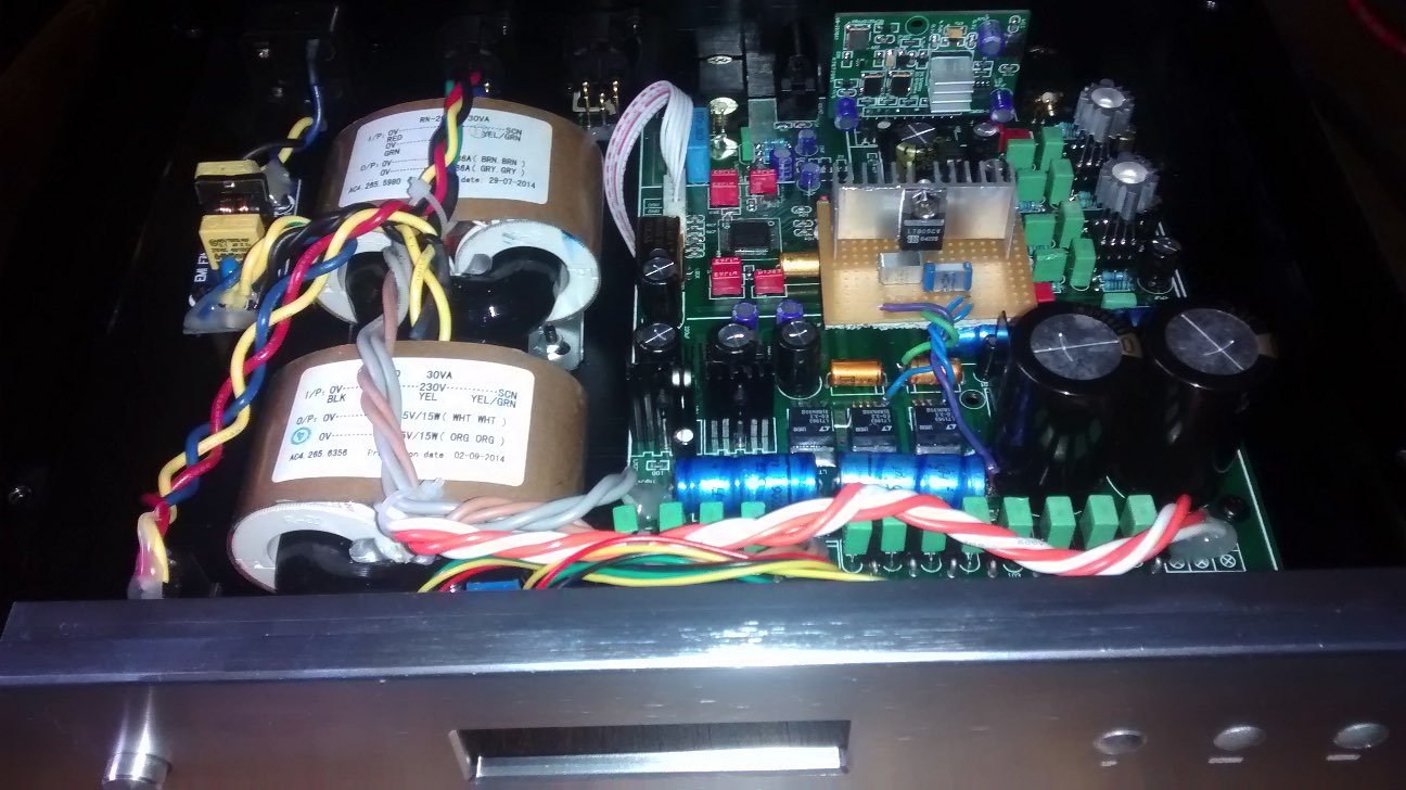

Hello Androa:
The two outputs AMS1117-1.2 V: 242 and 288 Oh. (5 mA).
The DAC comes with a 9 V + 9V transformer for digital sources.
One 9 V. provides 13.8 V at the input of LT1963 + 2x AMS1117.
Other 9 V. for the 7805 and LM317 + ADP150.
LT1963 digital cooler than analogs.
Now both analog LT1963 14.3 V. before, now 5V.
Hello Damuffin:
I have the finished the DAC. The sound is better than others DAC I have. The LT1963 regulators are very good. I have done measure at all points of the DAC and is running fine after correcting dissipation problem.
It is difficult to replace with trident without damaging DAC if there is no problem to solve.

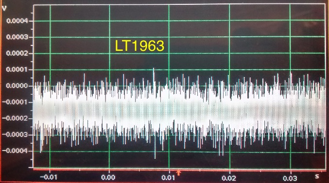

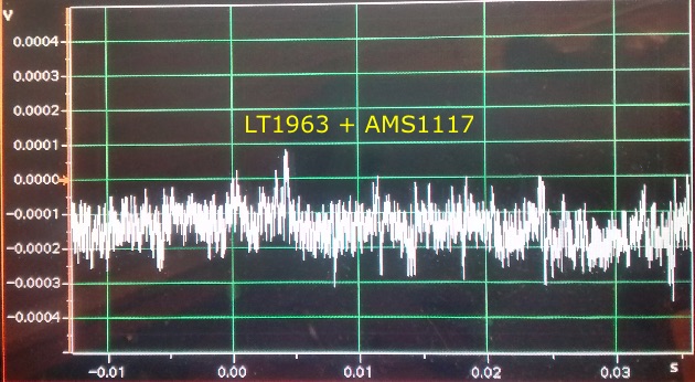

Hi Oneclock,

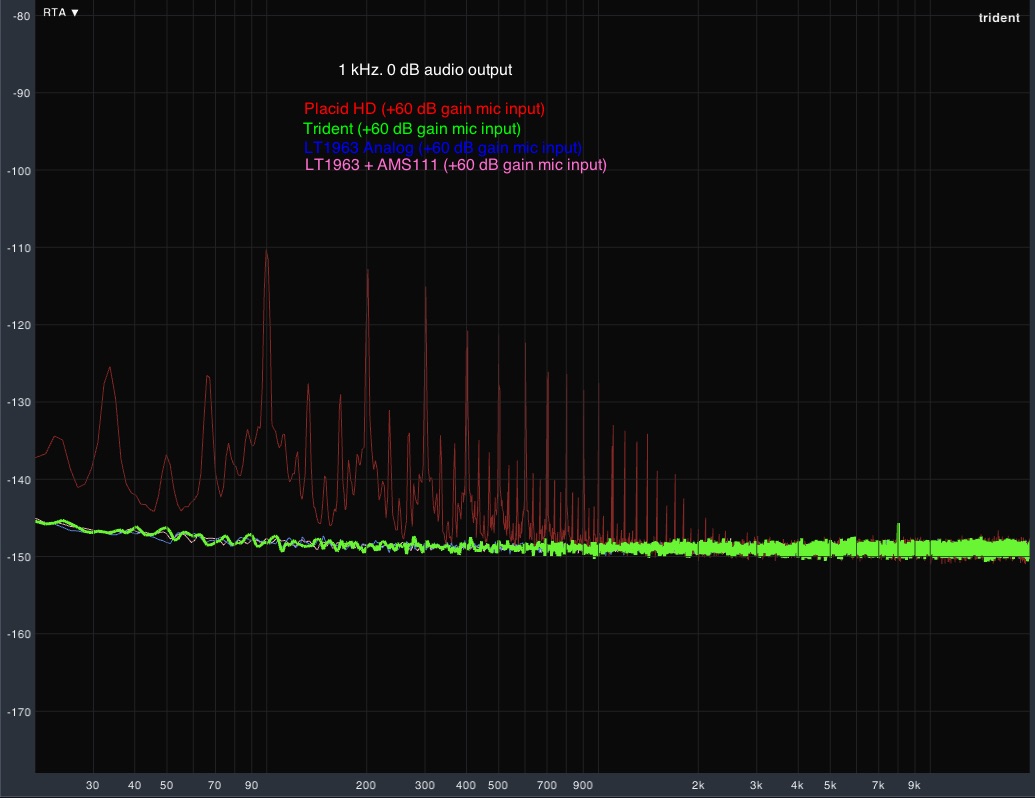

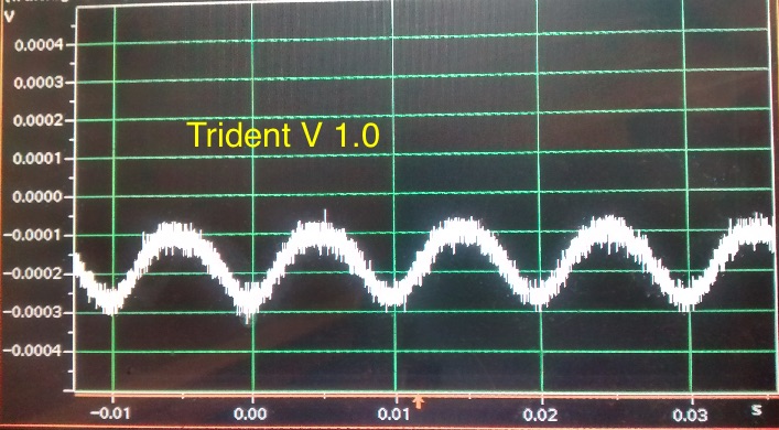

The problem with the Avcc supply is the uV ripple coming in. The 7805 as a pre-reg will help lower the ripple to the post-reg but for even better results add a large Silmic between.
You need to measure the uV ripple if you want to compare it with the Trident (Shunt regulator).
Hi Damuffin.
Behind the 7805 there is a 4700 uF electrolytic capacitor. It does not see good in the photo, it is black gold letters.

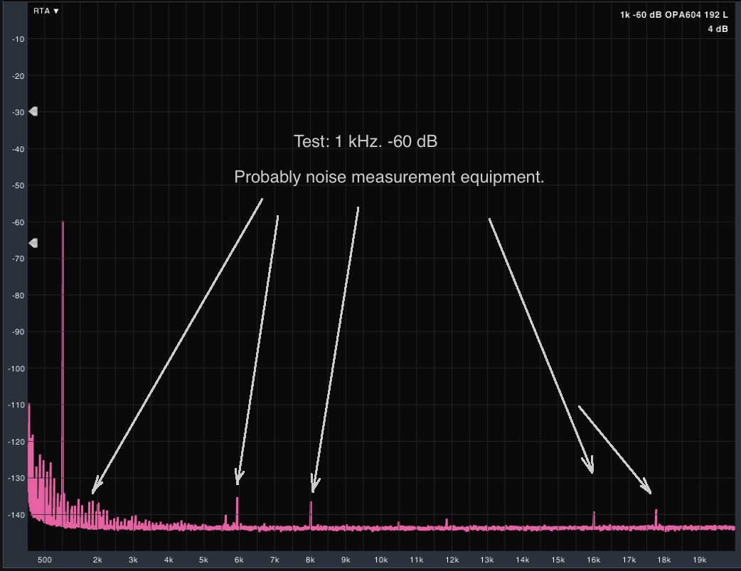

Talk you about 50 Hz AC ripple input or ripple with music output?
It´s about my graphs? DAC measures: the noise that appears on the graph is from my measure card (motu ultralite mk3) no from DAC.
I have pending a very low noise power supply with excellent 50 Hz. rejection for my measure card. Now is a simply external transformer to 12 v. cc.
I can measure both the AVCC DAC and Trident regulator in a Buffalo DAC. I compare next week.

I built this DAC using a RaspBerry PI (type B) to control it, which works fine, but now I want to put it into an aluminium case. Problem with the PI is that the USB connector is connected to the (digital) ground. Should I connect it to the (grounded) chassis? Or would that cause ground loops or hum?
I measured LT1963 + AMS1117 and compared with Trident. I could not find differences.
The measures are to 1 kHz. 0 dB in analog output. Normally I measure with audio card 0 dB line input.
With maximum sensitivity oscilloscope impossible to see differences.
Measure is the same with audio card, microphone input, gain set to maximum +60 db. To ensure I put also Placid HD (+60 db amplified).
Hello Damuffin:
It is not measurements on the audio output. It is measure the ripple voltage in regulators outputs. It is the spectral measure of ripple with +60 dB amplification.
My oscilloscope has 2 mV. maximum sensitivity. 1 uV is -120 dBV. Ripple is measured at -145 dB in frecuency. It is 50 nV and is not visible. But I will measure ripple with a device with uV. sensivity. In time if for you no valid in frecuency.
I have new measures with 0.1 mV resolution on another device. Show new information. Maybe not as good as supposed by calculations with the measured frequency. Also 50 nV. made no sense as LT1963 features: Low Noise 40μVRMS
