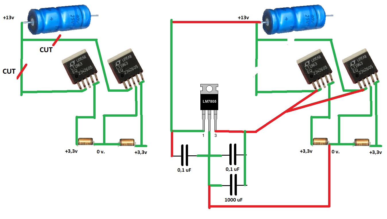

Hi oneoclock,
I want to try out what you did with lowering the voltage down to 5v.
Is it possible for you to make a quick drawing, or explaining how you did it?
-usbdac
Hello Androa:
The two outputs AMS1117-1.2 V: 242 and 288 Oh. (5 mA).
The DAC comes with a 9 V + 9V transformer for digital sources.
One 9 V. provides 13.8 V at the input of LT1963 + 2x AMS1117.
Other 9 V. for the 7805 and LM317 + ADP150.
LT1963 digital cooler than analogs.
Now both analog LT1963 14.3 V. before, now 5V.
Hello Damuffin:
I have the finished the DAC. The sound is better than others DAC I have. The LT1963 regulators are very good. I have done measure at all points of the DAC and is running fine after correcting dissipation problem.
It is difficult to replace with trident without damaging DAC if there is no problem to solve.
