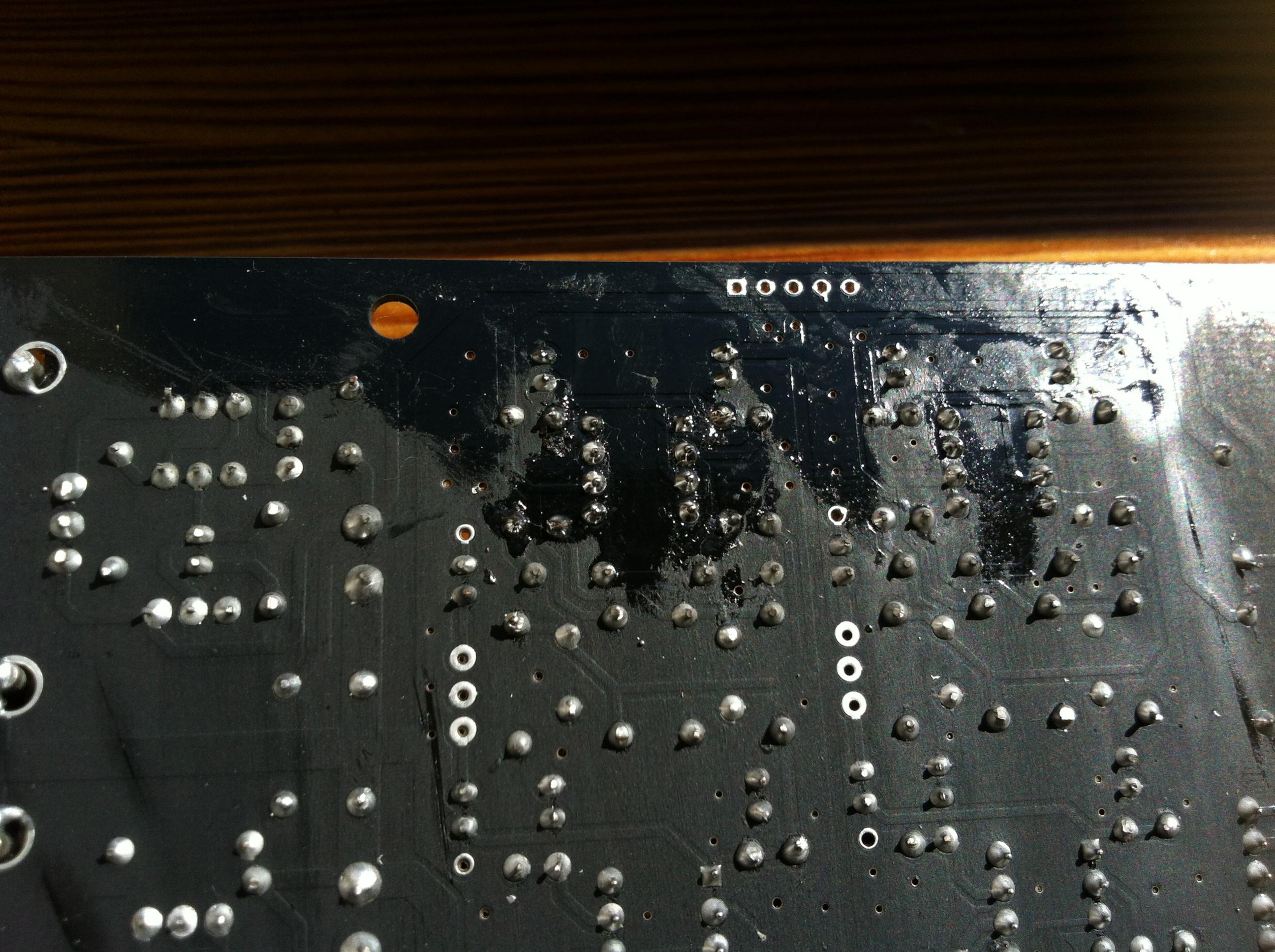

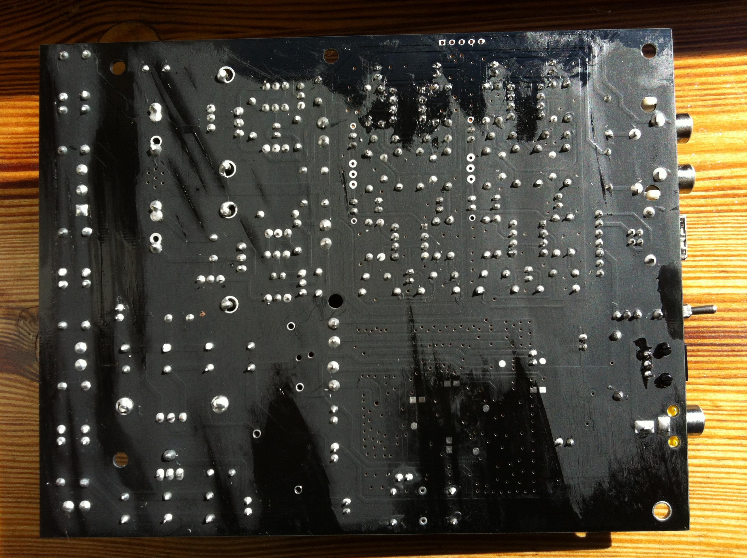

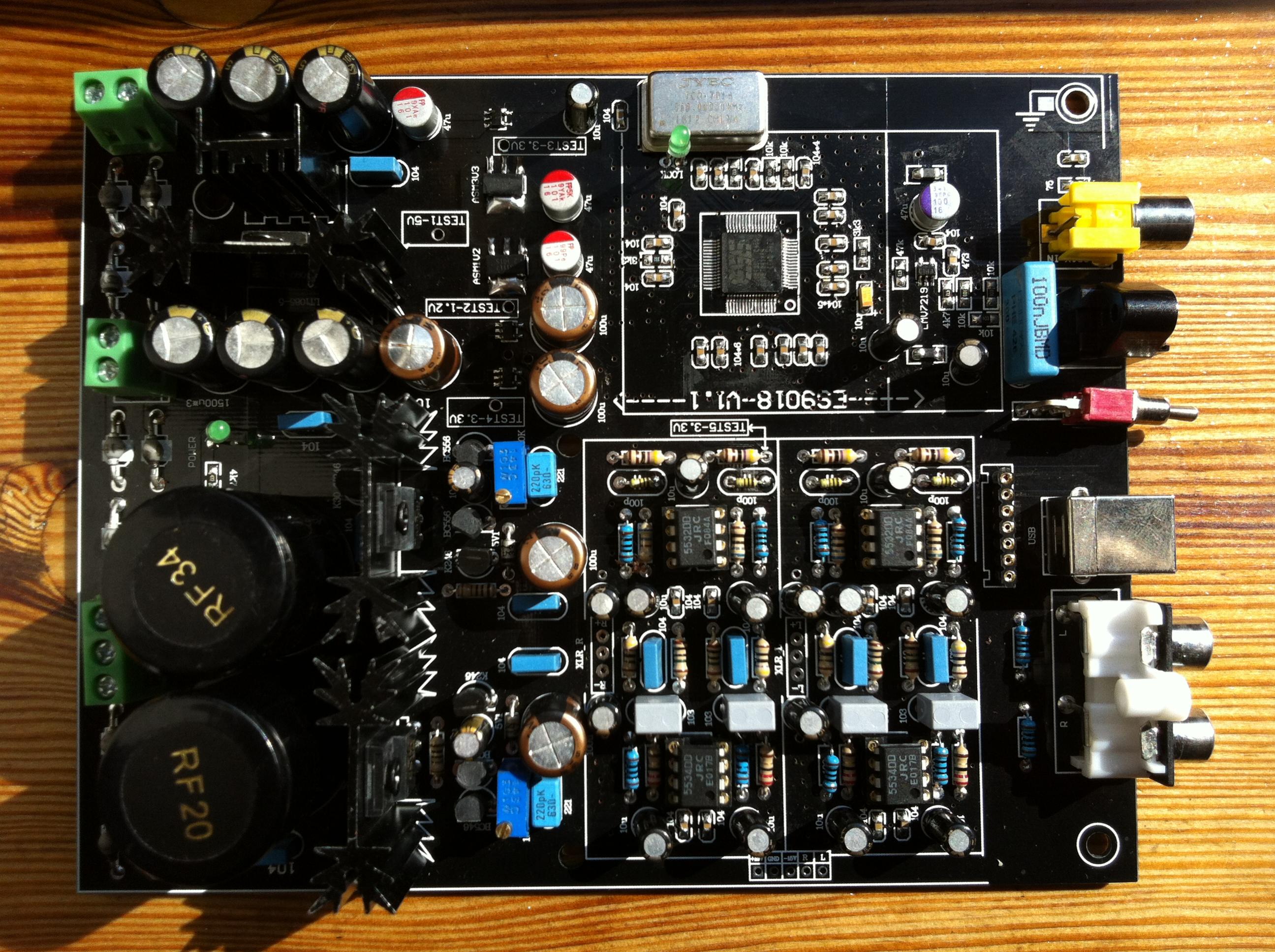

Got mine today from diyhifishop.com.
Dull surface on the bottom covered with some sticky residue, like grease.
Smells like rubber. Maybe it was the foil they wrapped it in.

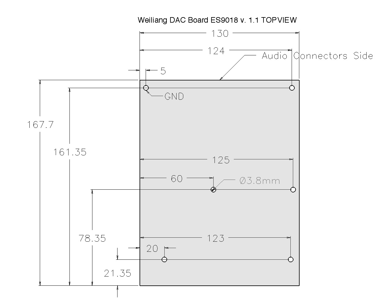

Nevertheless I took the effort to measure the board for those being interested.
The fixing holes are not placed symmetrical but there seems to be no reason for this by the layout , besides a fixing hole close to the AC input where a capacitor is in the way.
Maybe another hint that the board is kind of "universal" and that he fixing holes got their strange positions from an earlier design/application with different traces.
I have no transformers yet to provide power and check performance...

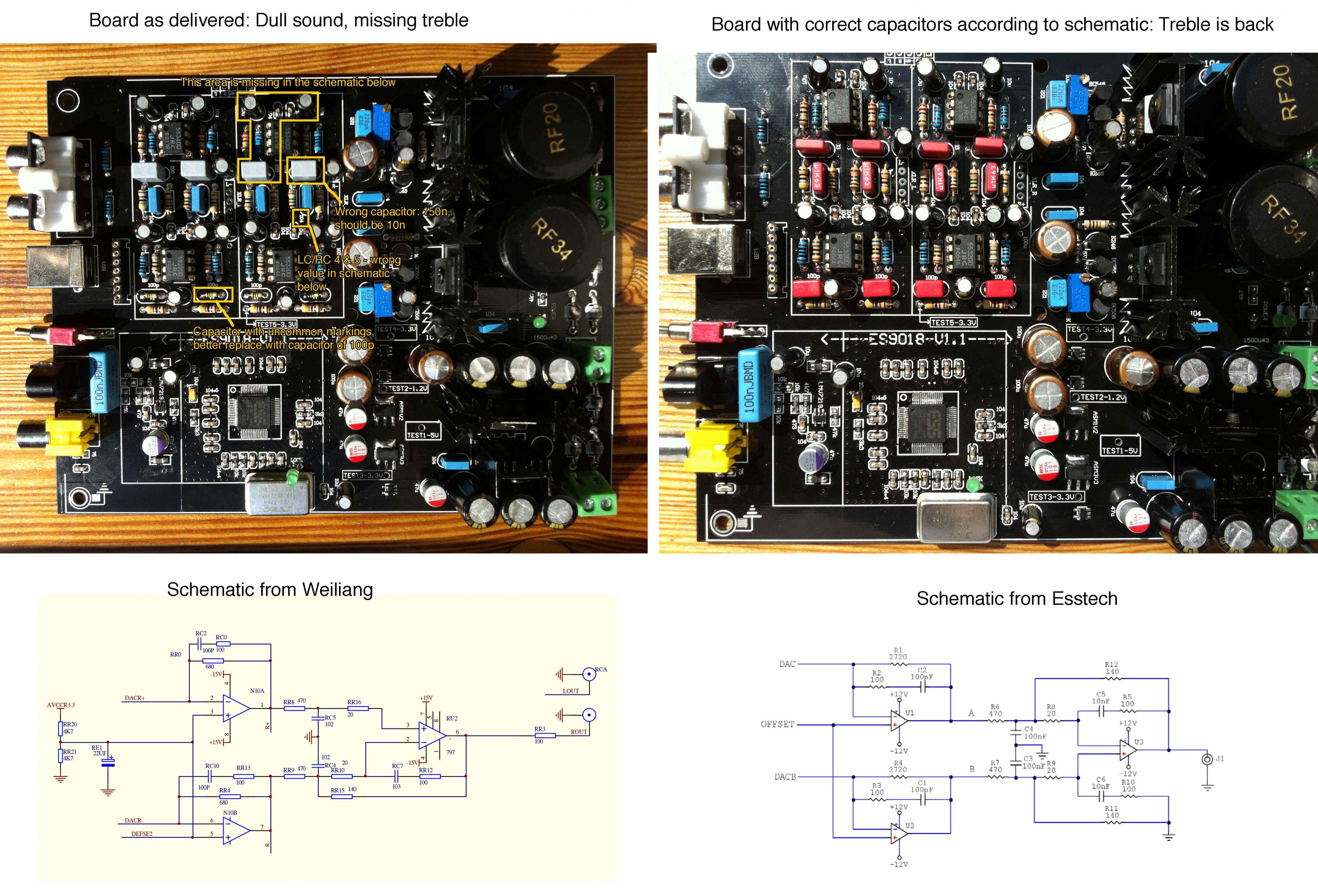

Checked the Weiliang today - WOW -but not in the way one might expect.
It sounds extremely DULL!
NEVER heard such big differnce to other DACS EVER!
Compared it to Sony CDP-X5000, Buffalo DAC II, even a 33 year old CDP-101.
Even checked cables.
The dullness is so strong that I thought that de-emphasis
was switched by some fault. So i took Sony YEDS-18 test disc that has emphasized tracks, but no difference when other Players have de-emphasis on. The Weiliang still sounds dull.
I can´t imagine that the different filter types of the ES9018 would have such an audible effect. Maybe bad implementation of opamps?
Opamps are NE5532 / NE5534, maybe generic, company JRC
Playing Silence and ramping Volume all way up, the Buffalo II and Sony X5000 are dead silent. Hum on the Weiliang. The Sony uses regular voltage regulators 78xx / 70xx as well as the Weiliang

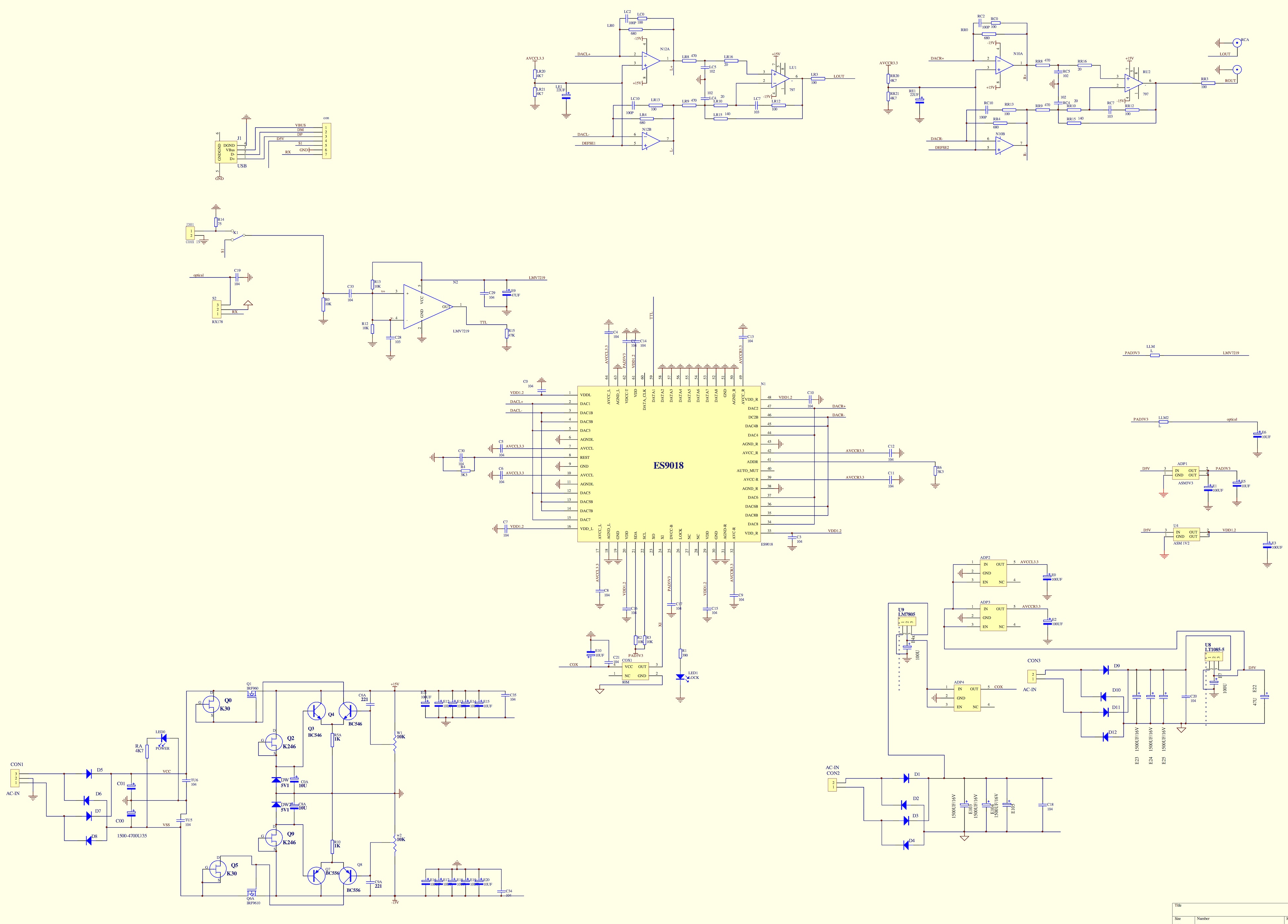

This is what Weiliang / diyhifishop (or "minishow" on ebay) sent me as schematic

But the feedback between the opamps output to the inverted input looks strange to me. I do not understand the two resistors and one capacitor between opamps output and inverting input...

I made a jpeg from the original schematic.
Maybe you can mark the areas
or even draw in the new connections...?

Interesting...i have found picture of mine...and is also v.1.1. but not the same as yours...
My has no 100n decoupling near ne5532...your termination is correct 75ohm.
on your schematic LC4,5 and RC4,5 are 102 ...it must be 104 on board. take out LC, RC10 and LC,RC2 and measure if the small one are capacitors. If this 2 are resistors than feedback is not right. Then we will go on.
Gnd under is hard to see...clean pcb with isopropyl. I think it goes, from rca out till 5pin vias into Kubota regulator...that is ok...mine is going opposite ...into es9018 3,3v gnd.

O.K got it, it is 0.01 µf and a resistor of 300Ω.
On my board it is LC4 / RC4 and LC5 / RC5 have a value of 0,15µF
Resistors LR16 / RR16 and LR20 / RR20 have a value of 22Ω
This makes a low pass starting at 48kHz
According to the schematic the values should be 22Ω and "102" = 0.001µf.
This makes a low pass starting at 723kHz.
But the markings on the board state "103" = 0.1µF
Low pass starts at 72kHz
Will replace the 150nF with 0.01uF and see what happens.

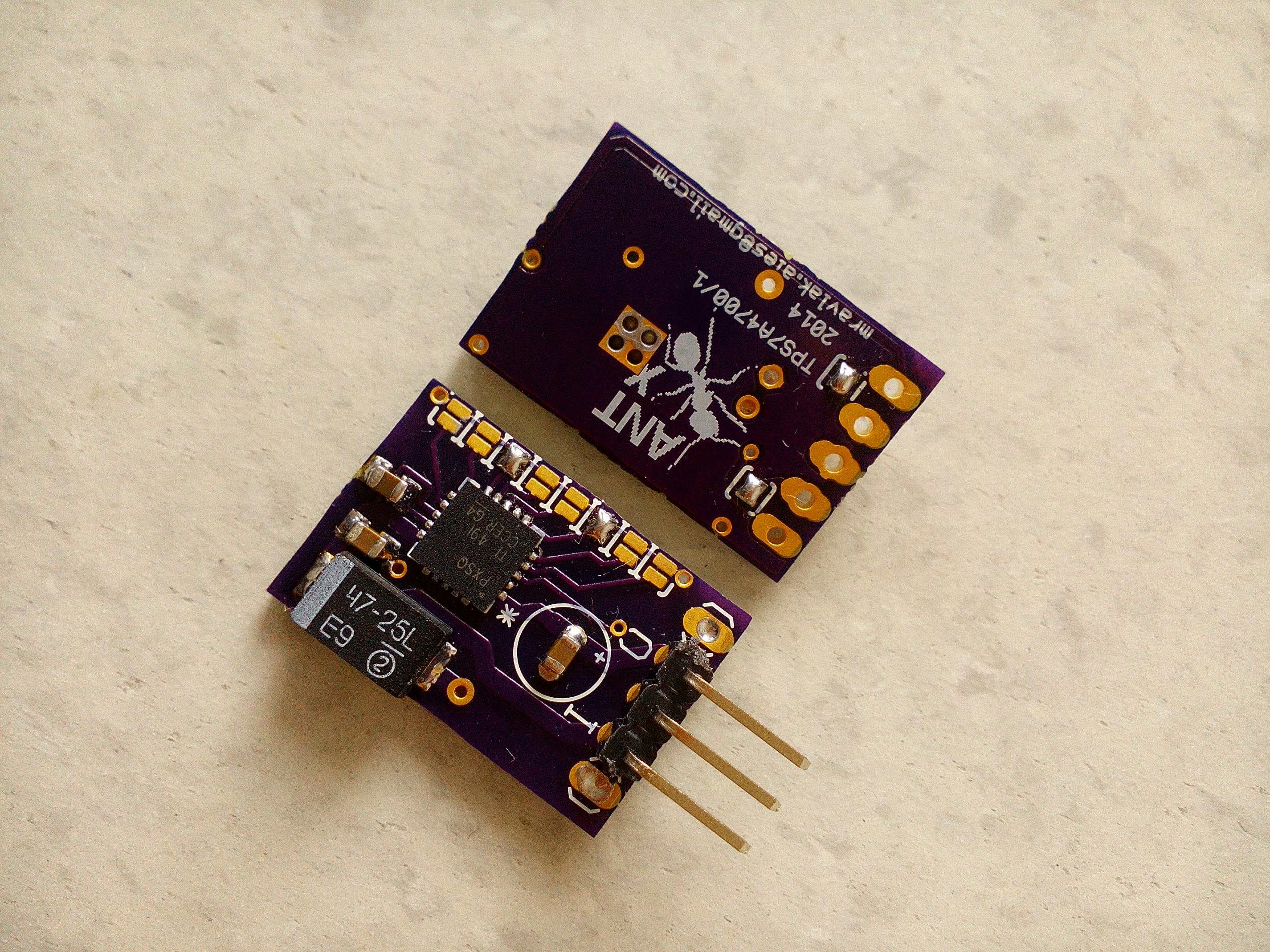

For 3,3V reference a will use TPS7A4700 mini reg from Aleš Mravlcax

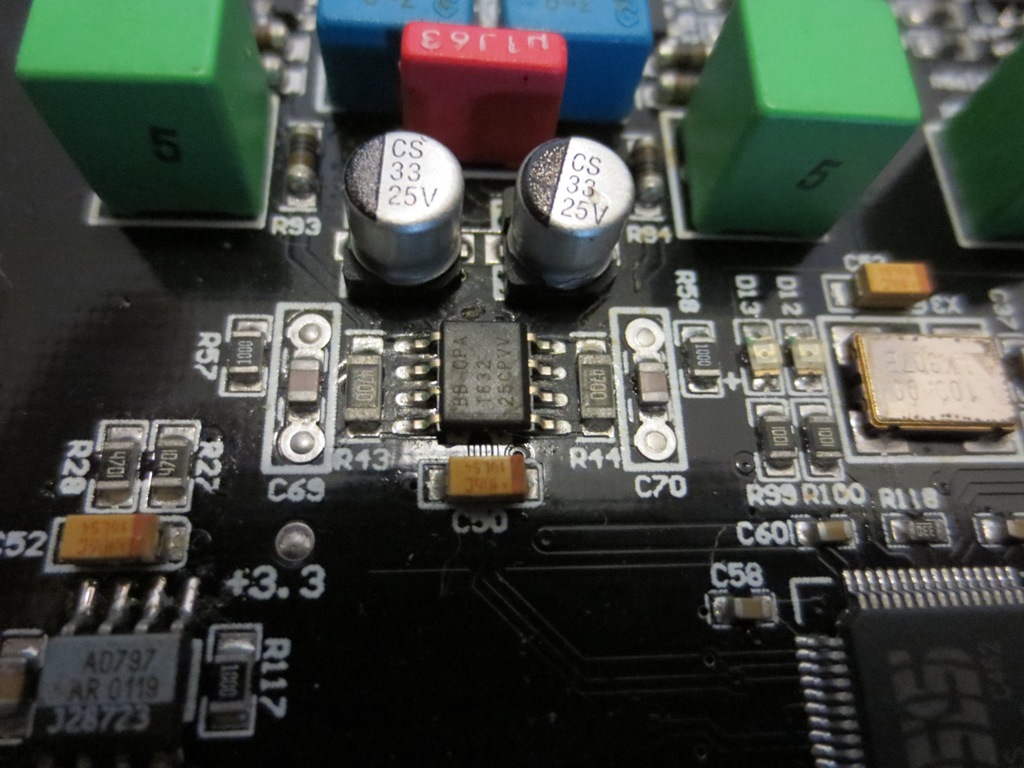

In the attached photo is a roundup of what Weiliang made wrong.
As far as I remember, those wrong 150nF capacitors were mentioned in this thread before so this error might be in many boards.
I replaced the caps according to Weiliangs schematic and treble is back again.
Differences to BuffaloII are now almost negligible.
Still have to look at LM7805 feeding ADP4 and xtal, seems to make some
hum/noise in the analog output. (At least removing AC power from this
circuit results in lower hum.)

Here is the schematic again.
http://www.diyaudio.com/forums/atta...i-end-usb-dac-es9018-schematicdiyhifishop.pdf
Please check CON1 / CON2 / CON3
Input voltages are 2x9VAC and 15-0-15VAC.
But heatsinks get very hot! Especially the small one.
Doing some math, talking about the +/-15VDC supplies, feeded by 15VAC
15AC rectified is about 24V, correct?
Thus 9V will have to be dissipated as heat for the needed +/-15VDC.
Also as far as I understand schematics, 9V AC are rectified to 14VDC for 5V final voltage
Again 9V are dissipated as heat. Maybe my math is wrong assuming
that alternating current equals 1.6x in rectified / direct current...?
Only the 9VAC inputs have 5V voltage regulators attached, one even being low drop according to the schematics.
Dropout voltage is normally much lesser than 3V
Thus 5 to 6V AC (equaling about 8V/9.4VDC) should be sufficient?
The +/-15V lines are based on transistor design - don´t know whether this equals a "discrete" voltage regulation.
But again assuming 3V dropout voltage, 12VAC equaling 19.2VDC after rectification should be sufficient...?
Hi I see you haven't used the right math before. It is a factor 1.41. Ripple voltage and diode Uf also need to be taken into account. You are right that voltages seem randomly chosen on the high side, as often with chinese designs. You could do with less heat indeed.
You could use 7V and if you replace the 7805 for an LDO version you could go as low as 5V AC. Preferably a bit higher to be safe. So 6V AC.
Never assume anything so please measure the dropout voltage of the 15V regulators before making statements.
* Dissipation is not just voltage, it is the product of voltage x current thus power. In Watts.
