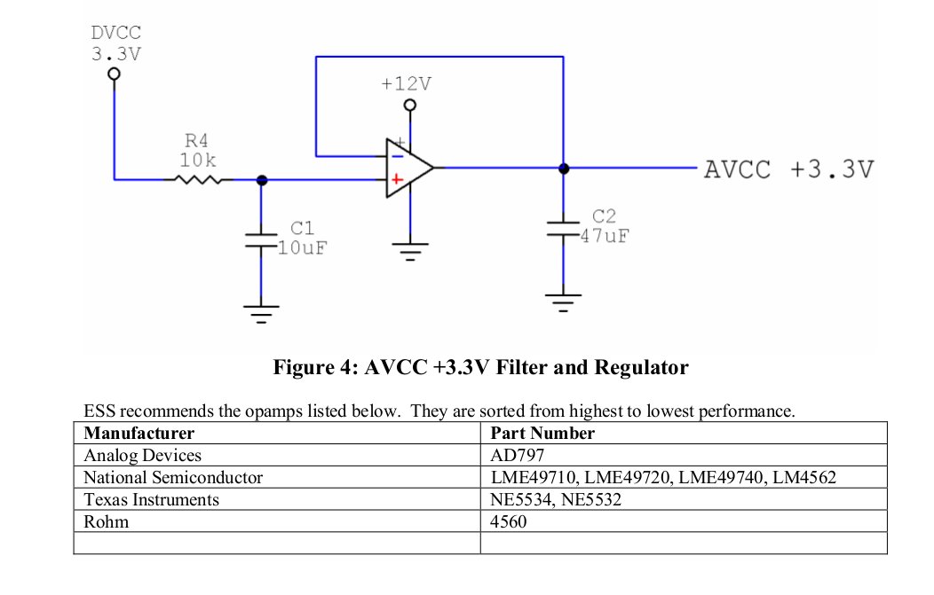

Let me resurrect this thread.
I am in a very slow process of building ESS9018 dac.
I have written in up here:
Slow construction of ESS9018 dac
The reason for this post is a question about AVCC regulator which stopped working.
I my never ending tweaking phase (gremlins whisper in my ear I can make it even better) I tried separate 3.3V DVCC and AVCC using two LT3045. I tried also multistage regulators one LM317 (regulating to 5.5V) and then two ADP151 regulating to 3.3V. DVCC is taken from one ADP151 directly while
the other 3.3V is used a reference for the op amp buffer as suggested by ESS (see attached picture). The capacitances are like in the pic. The only diff is that the VCC for the opamp (lm49710) is 5.5V coming from the first stage of regulation.
Well it worked fine until I decided to put LT3042 instead adp151 to provide 3.3V reference.
Now I have 3.3V coming from opamp but only with light loads. With the dac attached output of the opamp drops to some 2.7V which I also see at the inverting input. The noninverting input is nicely at 3.3V. I really do not understand. Have I zipped the opamp?
Before you ask: the dac is fine all works fine (with the opamp regulator)
