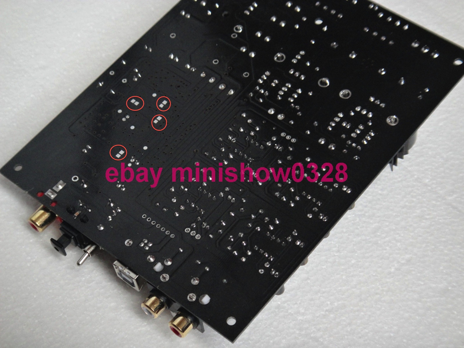

Connecting the ground planes beyond the DAC in the red circled area reduces the hum a lot. They are connected somewhere anyway but I assume return paths become shorter by doing so. Still not perfect, but not very much louder than other DACs.
No hints for what the pads are good for and of course no support from the seller whose name is prominently featured on the attached photo.
I assume the marked areas are not for shortening but for smd caps and proper decoupling of the ground planes.
Anyone any idea what the values might be?
