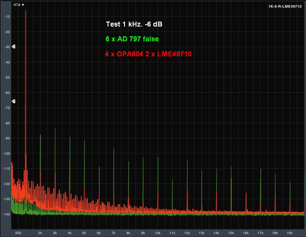

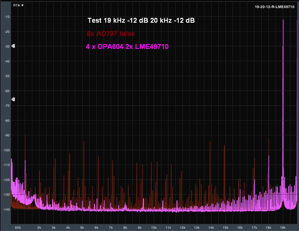

I have a 4 layer board DAC with TCXO 100 Mhz 0.1 ppm and 6x AD797.
The sound is for me, the best DAC I have, and the best DAC I listened. The 6xAD797 aren’t original. But they sound well.
And I buy 2x metal LME49710 to Weillian. They are original.
I put original 4xOPA604 and 2xLME49710.
It´s the difference with false AD797.

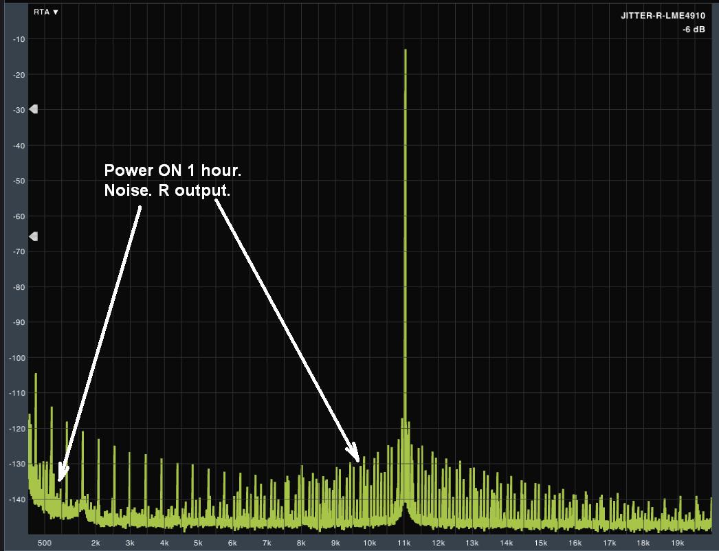

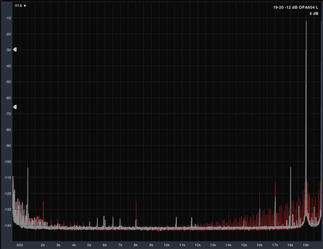

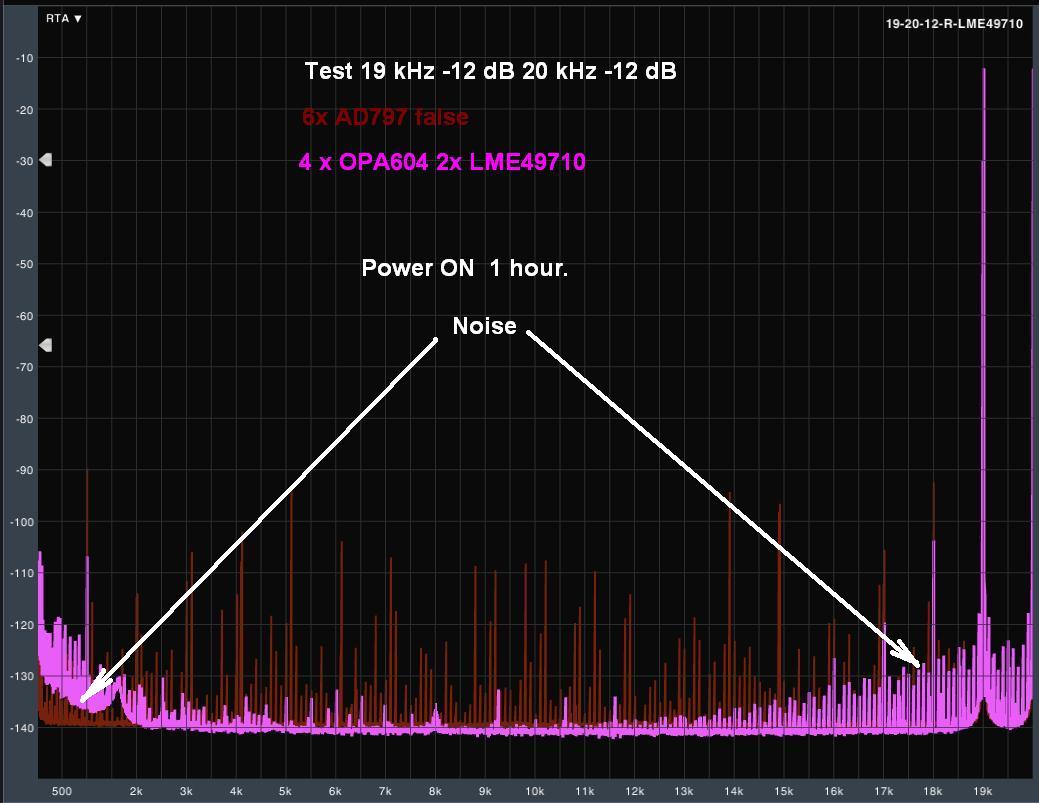

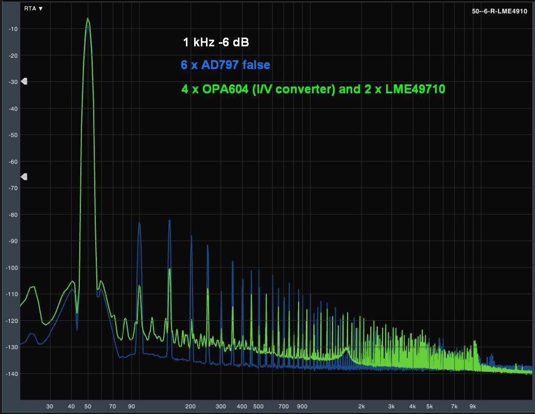

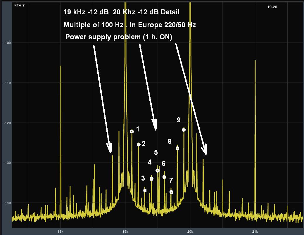

The DAC have a problem. After a half hour power ON, the sound is still good but has a lot of noise in the measure.

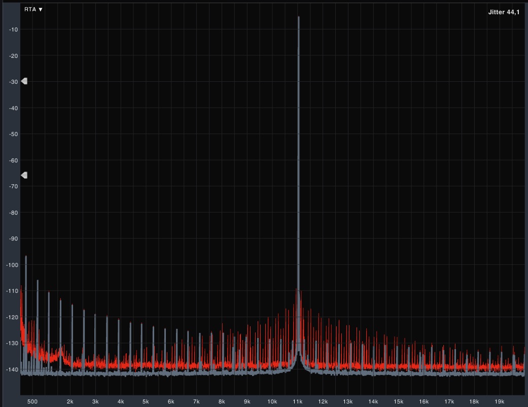

You can see in the last images the measure with 4xOPA604 and 2xLME49710 the DAC have 1 hour ON. And see the problem in the J-Test Jitter. The noise is a multiple of 100 Hz. You can see nine spectral noises between 19 and 20 kHz. It is a problem of power supply. The problem is greater in L channel than R channel. So it's not a Jitter, TCXO or TCXO power supply, or analog 15 V common L and R power supply.

Your problem is most like likely related to the Cheap TCXO. The Stock TCXO gave me some issues as well. Try lowering your sample rate.
The 9018 AVCC L&R supplied to DAC is terrible. You should replace it's power source as recommended in earlier posts.
I measured the spectrum of all power supply. The TCXO and TCXO power suply are good. The TCXO is not the problem.

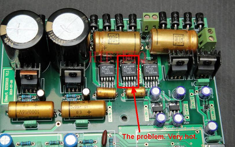

The problem is the regulator TL1963 3,3 v. AVCC-R is worse than the rest when heated. The three regulators get very hot. But this in the middle of the other 2 dissipates heat worse.
I put a heatsink with thermal paste over the TL1963 and the problem is solved for a hour. But just warming up heatsink also.

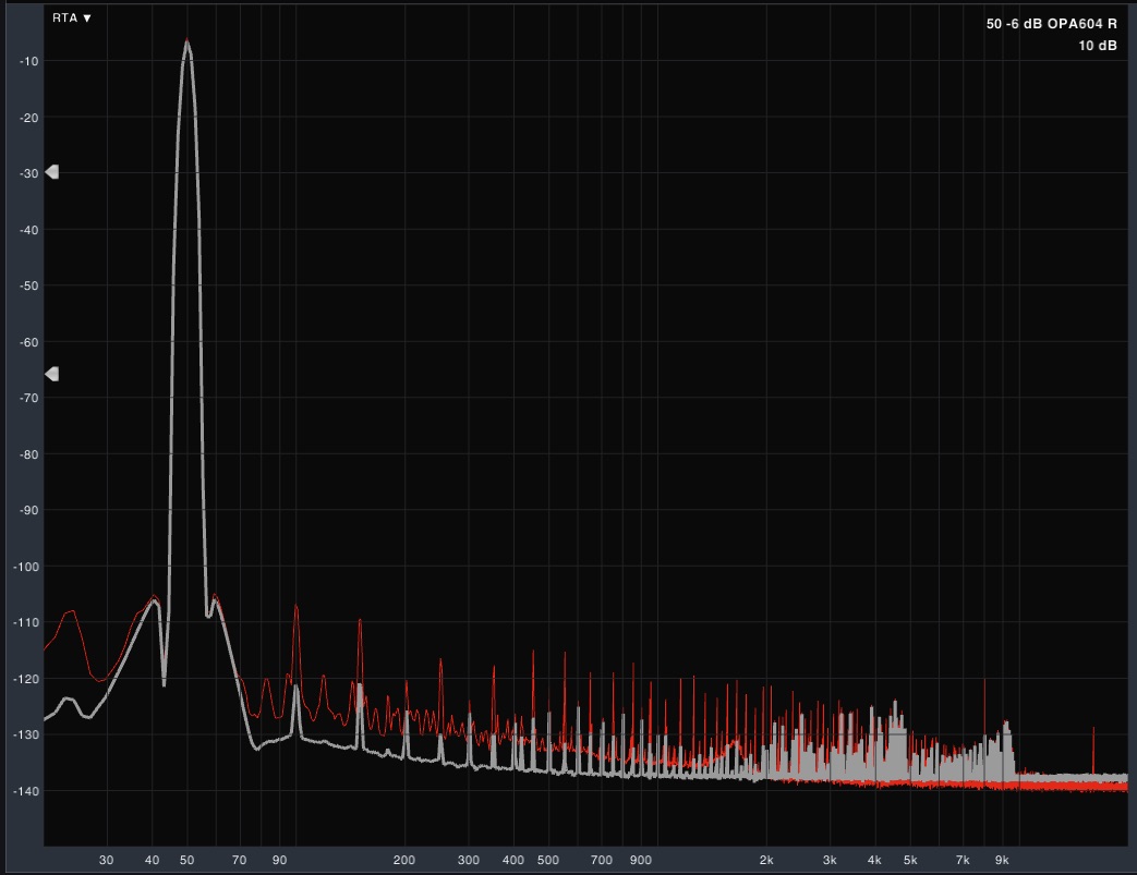

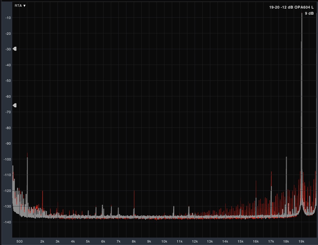

The voltage on LT1963 is 14 V. at the input. I put first a 7805 to reduce it to 5 V. at the two LT1963 L and R input and the problem stop.
- Red only 2xLT1963 (14 V.->3,3 V.) 4xOPA604 2xLME49710.
- Gray the new measures 7805 + 2xLT1993. (14 V. -> 5 V. -> 3,3 V.) Several hours of operation. 6xOPA604.
Now is the same measures in channel L and R. TL1963 do not get hot.
