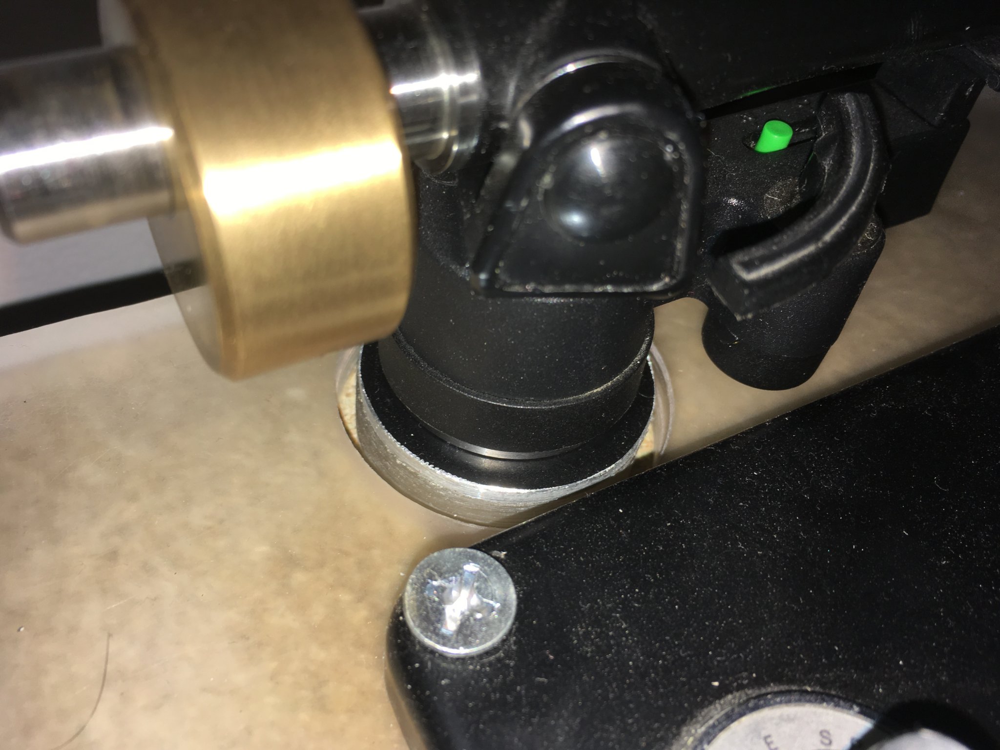

What should be considered as "arm base" for Rega RB 250 in order to do the calculations? This black bottom "ring" before brass part? Brass mounting? Nut? Not sure what to take into calculations...

sorry but it is not clear to me what you mean by "base" of the rega tonearm. The lower and upper ring that tightens the tonearm on the armboard?
that is what I used. It is a difficult choice, none of which is wholly satisfactory.sorry but it is not clear to me what you mean by "base" of the rega tonearm. The lower and upper ring that tightens the tonearm on the armboard?
It is a difficult choice, none of which is wholly satisfactory. I used the the bit between the bearing and the thread. About 20mm in length, I believe.

thanks for info about Rega, but now I am wondering... how to screw it to something so thick? it has like 25-30 mm of thread to be used to fix it in the hole...

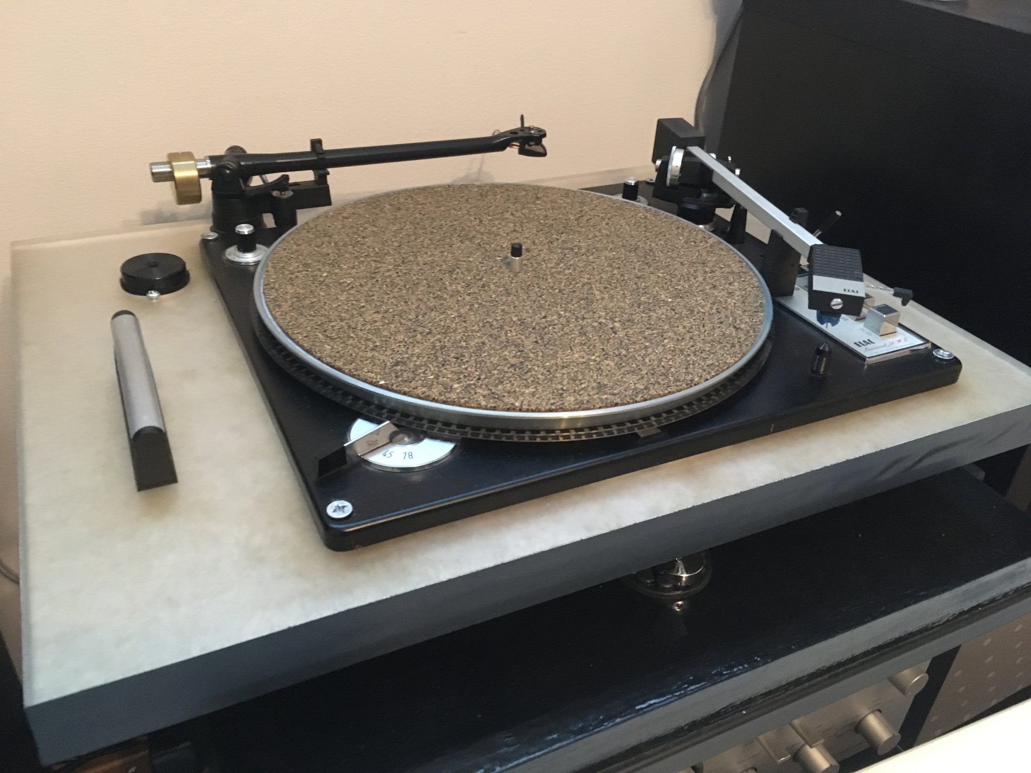

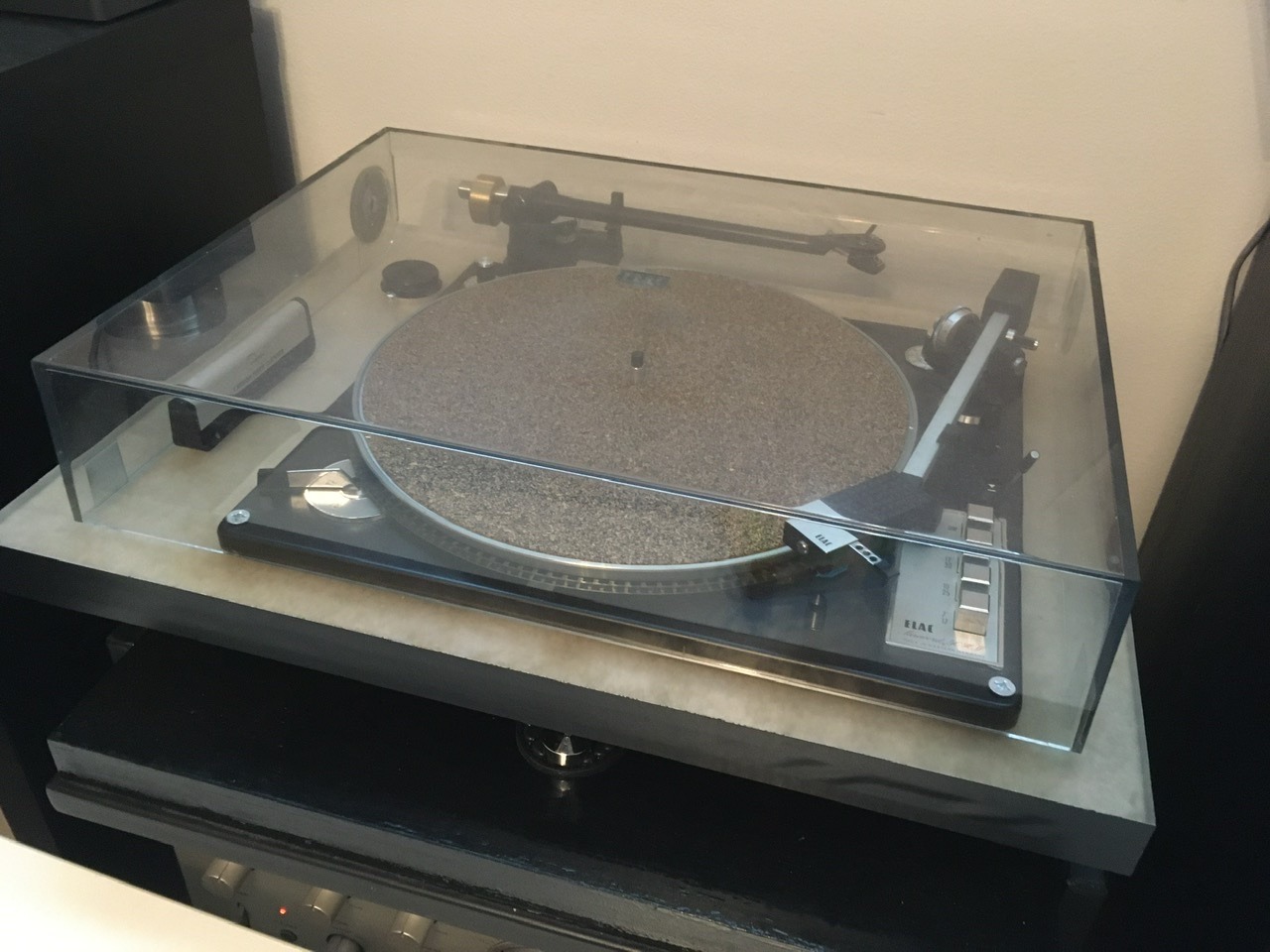

btw, I’ve made something for the New Year 😀
as i have said, acrylic-chipboard-acrylic, pretty simple… 10mm/12mm/10mm. glued in sandwich with mentioned 3m tape.
used your suggestion for position of spikes , which bases are decoupled from shelf with some shoe dampers 😀
you can see how i tried to isolate the arm. just drilled till chipboard, so its like its on some kind of island... just one 3mm aluminum plate also glued between top acrylic island and base of the arm, for height leveling purpose... sounds great, i am very satisfied. Could look way better i know, but didnt have time for better shiny looks this time...
