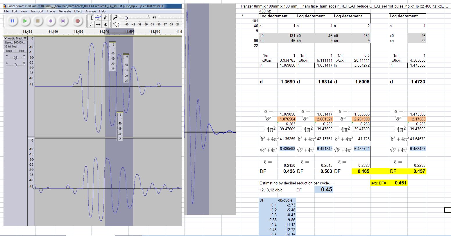

On the 8mm x 100mm x 100mm Panzerholtz sample in the post above, I get good damping (0.4 and better) up to about 500 hz. Above that, it reduces to lower values like 0.2, etc. Does that seem about right?
I'm intending for it to be a benchmark for other combinations.

Hi Hugh
I get about 0.43 from your traces, after correcting for values above 0.3, or 0.45 before correction. I would expect higher damping at higher frequencies, not lower.

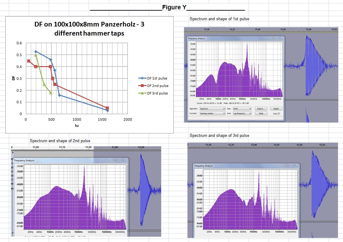

Ok, I'm disappointed I was unable to match your results for DF at higher frequencies. I'll try again on 20mm Panzer and fuss a little more over the pulses I select.
I'm posting this for another purpose. Figure Y shows the DF vs. Frequency for 3 different pulses. I selected a variety rather than subjectively choosing "good" ones.
What we get is a bit of variety in the DF results. The first 2 are good up to nearly 500 hz. The third drops off after 200 hz.
When I test the Acrylic/MDF/Acrylic combinations I'm trying to be more fussy about the pulse shapes. But I'm getting an even wider range of DF values vs. frequency.
It may be a good thing, but I'm finding it a bit disturbing. Maybe this Acr/MDF/Acr combination will be very dependent on the type of outside disturbances and music content compared to Panzerholz.
As a sanity check, I pulled up the files from a much earlier post. It was 1/4" Acrylic-1/2" Acrylic -1/4" Acrylic with Ductseal between the layers. So far, much more consistent and the DF is looking better at higher frequencies. I may be going for a final build more like that.
Will try to make time to post more graphs.

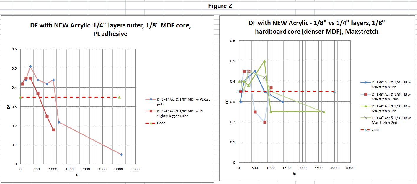

Continuing from a few posts above...
These DF (Hammer tap) tests were performed using NEW Acrylic instead the old weathered pieces I have on hand. The panels are 4"x4" or 4.5"x4.5". Thicknesses of the outer Acrylic layers were 1/4" or 1/8".
One of the cores is 1/8" MDF trimmed from a thicker piece. The other two are "Hardboard" which looks like MDF, but just a bit more dense.
The left side of Figure Z uses a stiff adhesive - Lepage's PL. The Acrylic layers are twice as thick as the core (unlike previous efforts). Note that there's quite a different in the calculated Damping factor for the two different pulses. The Light Brown trace stays over 0.35 DF up to 1khz.The Dark brown trace is good just over 500 hz. I'm sure if I examined more pulses that spread would be even greater.
That's a bit discouraging, but I suppose this combination (scaled up to a full plinth with 2x 1/2" outer layers and 1/4" MDF Core) MAY still work OK as a plinth.
The Green traces on the right side of figure Z are a repeat of the above except the adhesive is the softer Maxstretch adhesive. The core is Hardboard. It seems like maybe the the DF results may be more repeatable in the 800 to 1000 hz area (light green vs. Dark green). Repeating with more pulses would be needed to confirm.
When filtering the pulses at low frequencies, I did notice that the "logarithmic decay" was very hard to get anywhere near straight. DF of 0.4 and above could just as easily have been called 0.3 . So, there's a slight hint that the Maxstretch (or Hardboard?) allows the low frequency DF to get a little mushy.
The blue traces on Figure Z use Maxstretch adhesive again. The layers are all 1.8". Again the two traces show poor repeatability.
Then, I reworked some old results from a much earlier post. It was three layers of acrylic with Ductseal in between. It seems very good for DF and repeatability. More later on that.

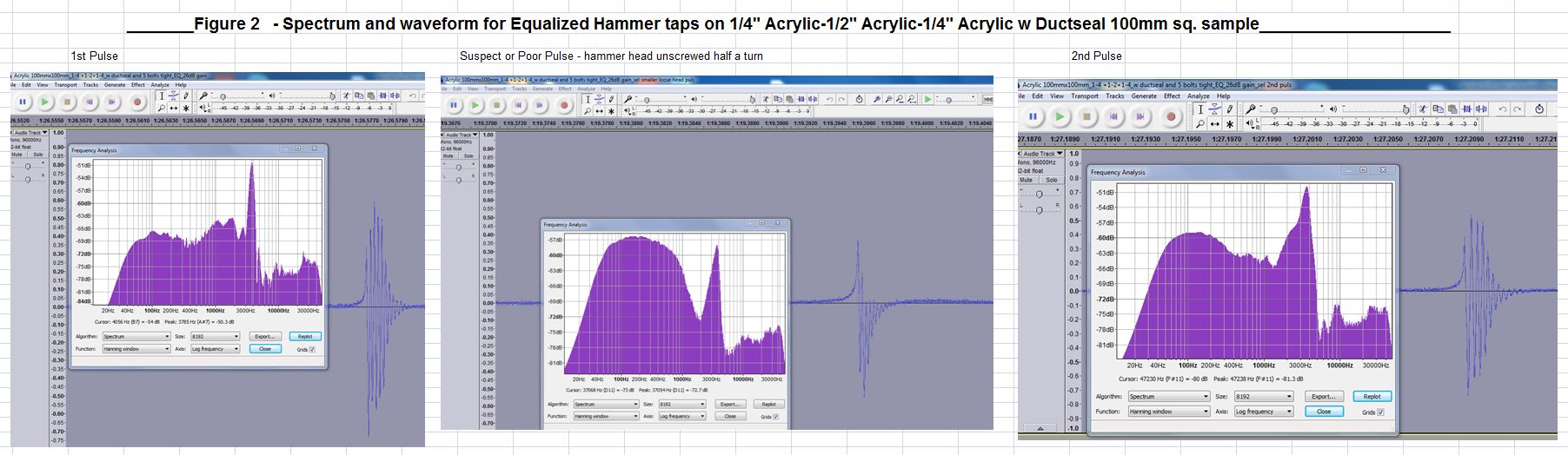

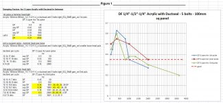

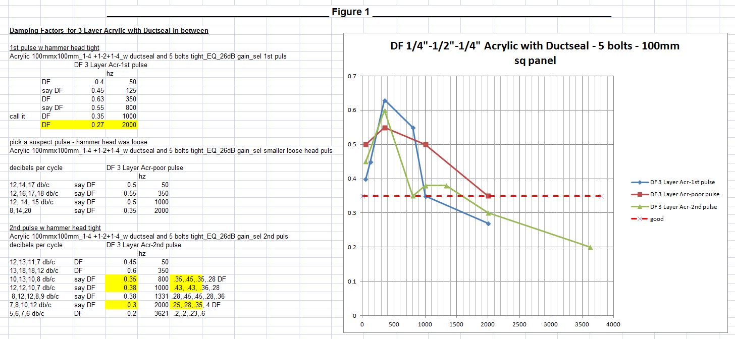

3 Layer Acrylic with Ductseal
This one is described as a full sized plinth on page 26 post 252. The test sample (100mm x 100mm) is 1/2" Acrylic sandwiched between 1/4" Acrylic layers. GB Ductseal is in between. Bolts in the corners and center hold it together because Ductseal is not an adhesive. So, once again this does not meet the definition of CLD.
Figure 2 shows the waveforms and spectrums for three Hammer taps. The ones labelled as 1st and 2nd are subjectively deemed "good". In the middle one, the tip of the hammer had worked it's way loose. I'm calling this the bad pulse.
Figure 1 shows the Damping factor estimate at various frequencies for each pulse. I did the last one this morning and found the repeatability is not quite as nice as I was expecting. But the overall results are better than anything else I've tested.
I suspect that other thicknesses of layers would also be fine. I'll likely go with 1/4, 1/2,1/4 inch just because I have some 1/2" pieces on hand.
I'm also intending to try GE Maxstretch (and no bolts) as well as Greenglue (with nylon bolts). But I will to shelve project this for a few months. Other activities coming up.
Correction... That should read " The layers are all 1/8".
