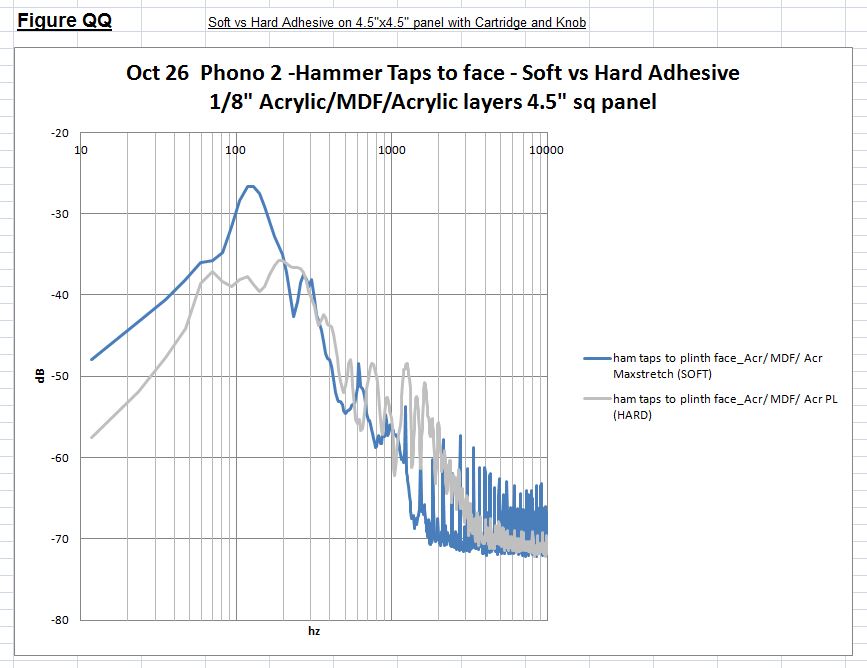

Figure QQ is a Hammer Tap rework of Figure Q with a similar conclusion in my view. The softer Maxstretch adhesive allows resonance at lower frequencies. The PL Adhesive allows more vibration above 500 hz. It almost looks as if each expends the same overall amount of energy - just differing spectrums.
Later, I'll post another test on an actual Turntable that suggests why this may not matter. It'll be Hammer taps.

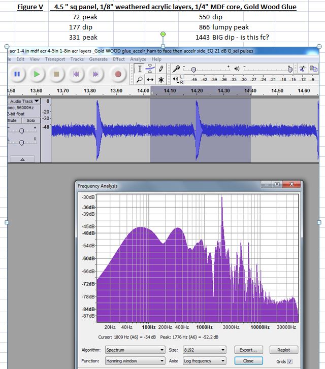

Cats,
Lately I've been using the FFTs to decide what's well damped. But, here's one example of a Damping Factor calculation by Logarithmic Decrement. The steps are described for some "scrutiny". It may also help anyone else crazy enough to try this. It's a tough one. DF is around 0.6.
After I thought I was "done" I realized I should have tried other filter combinations. If I reworked it, I think it would still be well over DF = 0.4.

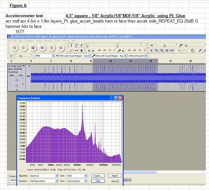

Figure A is from an earlier post. It's the 4.5" x 4.5" Acrylic/MDF/Acryic with PL Adhesive Mini Plinth from an earlier post. (1/8" layers). The FFT has been equalized as decribed earlier by Cats Squirrel (this thread I hope). I picked the moderate, wide 330 hz hump as my resonance. Alternately, I could have gone for the one around 180 hz. Similar hump - similar results?

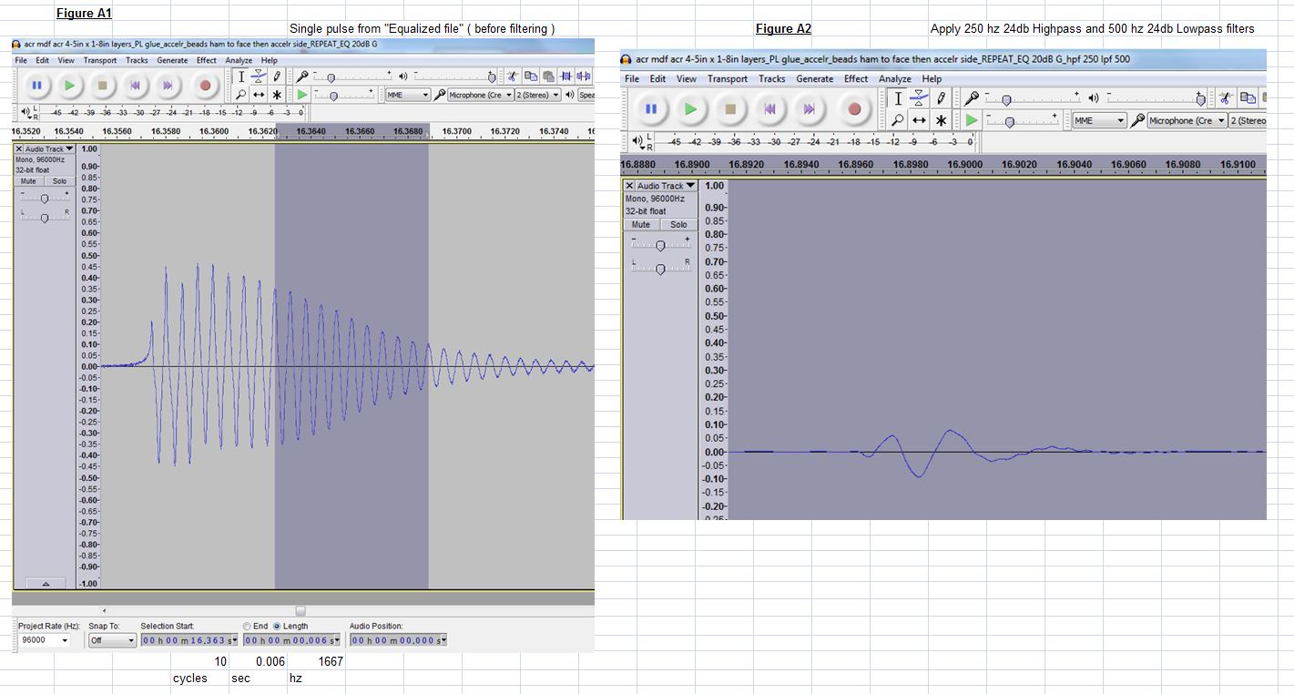

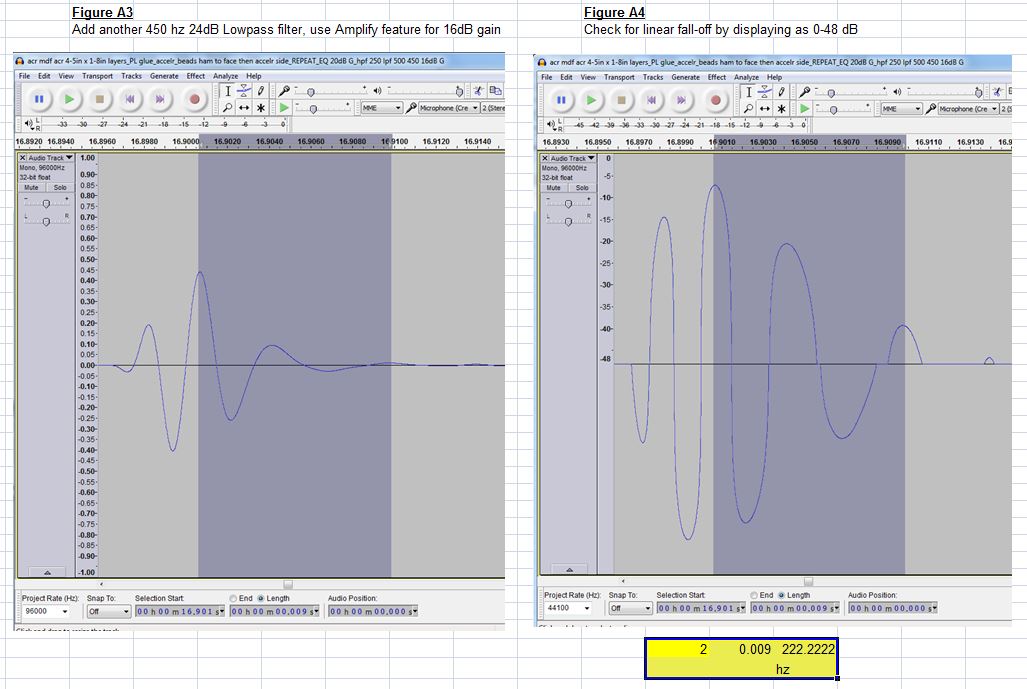

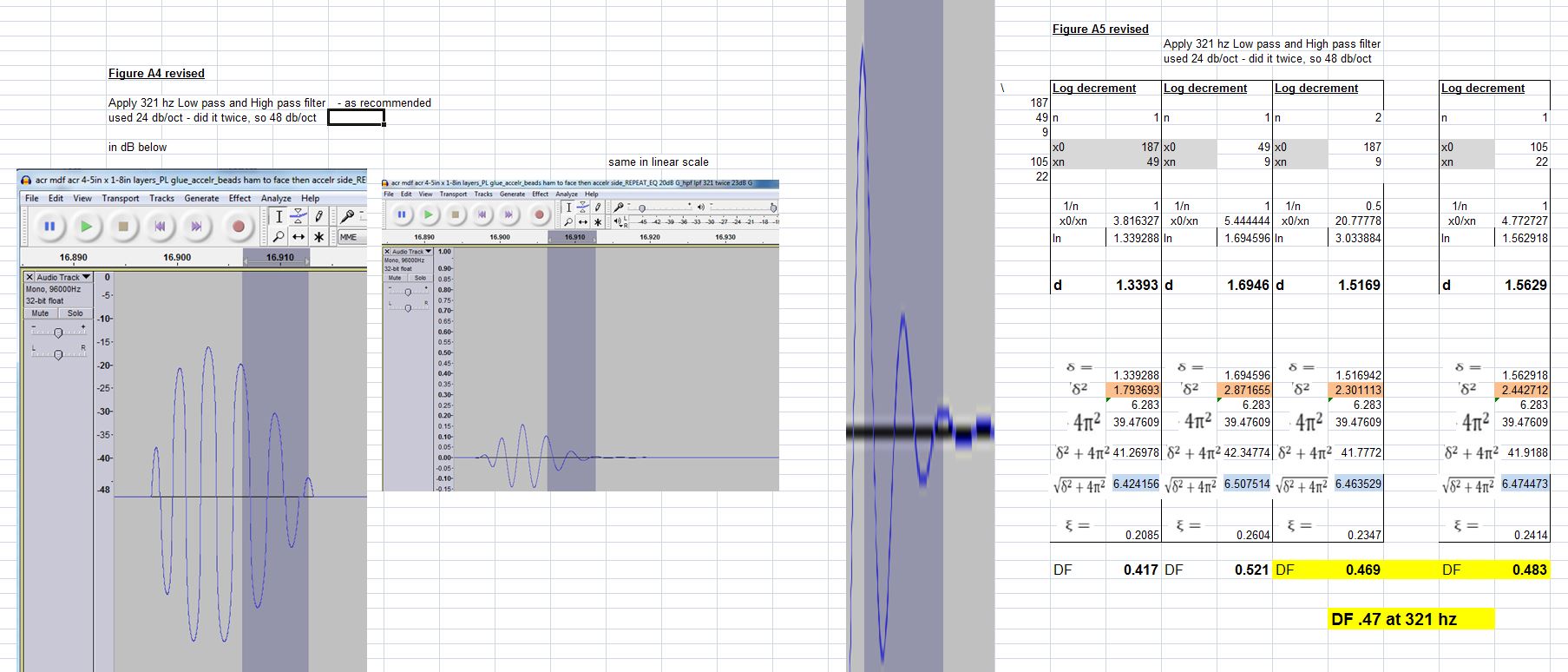

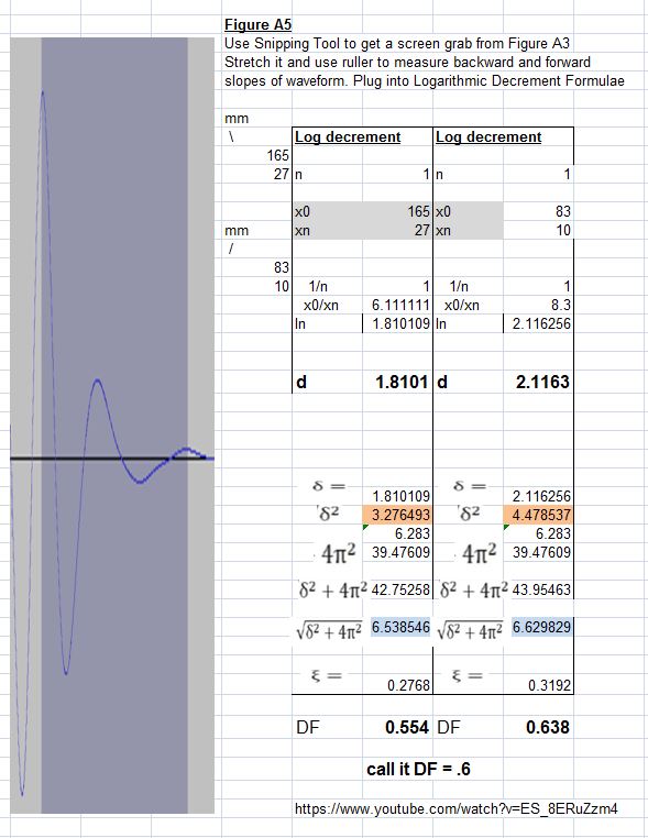

Figures A1 through A5 describe the steps to measure Damping Factor by Logarithic Decrement. At the end, I realized I'd captured a combination of the 330 and 180 hz, so it could use more polishing. The point is, this is the method I'm using to compare materials. Does it look reasonable otherwise?
A 100mm x 100mm combination of 12mm Acrylic /14mm MDF /12mm Acrylic shows a DF of about 0.35. I'm thinking that's probably the ballpark for a real plinth made from these materials.

Scratch that last statement. I just re-checked the "100mm x 100mm combination of 12mm Acrylic /14mm MDF /12mm Acrylic using WOOD GLUE" in more detail.
I get DF of 0.46 for humps at 1000, 600 and 200 hz.

Ha! I just measured the DF of the trace of that which you tested and posted, and I obtained a DF of 0.46 (accounting for answer above 0.3). 🙂
If this is really a true reflection of the material you have made, then you have truly made progress. Well done.
Now repeat the experiment with several pieces of acrylic/mdf/acrylic PVA glue, and hopefully obtain the same results (or very similar!). Also try different thicknesses, and a one sided one (acrylic/mdf/no second layer).
When applying filters, use the same frequency for high pass and low pass. Also, use no more than six hammer taps to work on, and cherry pick the best to obtain the six.
Just in case anybody wants to see what this does, see the attached revisions to figures A4 and A5 from post 409. I picked 321 hz for the filters. I suspect if I'd used 180 (lower hump) the DF would be lower.

Is suspect that the harder glues for Acrylic/MDF/Acrylic will be better for Low Frequency damping. I'm intending to post another Mad Scientist test on a Turntable that suggests the higher frequencies don't get to the Cartridge. So, efforts to damp Acrylic/MDF/Acrylic further may actually be worse at low frequencies.
Of course, I'm ahead of myself here. Be prepared for another Flip-flop later.
That's looking like a really good idea. I have an older file for 1/8" Acrylic outer layers and 1/4" MDF as the Core. It's a cheap brand of PVA Wood glue on this one.
I get Damping factors of .4 or more at at 72, 177 and 331 hz.
Then I get LOW DF's of around .15 at 550 and 866 hz. I wonder how the 1/8" core compares to this.
Question...
The spectrum is for just one pulse, but typical for the group. Is that big dip at 1443 Fc by any chance?
John,
Hugh
Let's refine that a bit...
Efforts to use CLD (e.g. Greenglue) to damp Acrylic/MDF/Acrylic will likely diminish LF Damping. Other damping techniques may help. I really don't know.
