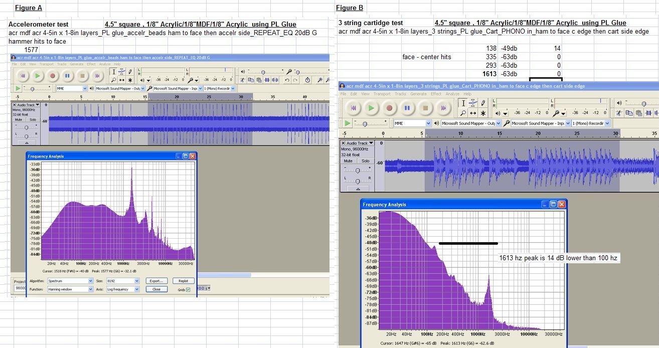

Figure A in the attached is a 4.5" square sandwich of 1/8" Acrylic/ 1/8" MDF / 1/8" held together with Lepage's PL "Construction adhesive. It's a Polyurethane that sets up fairly stiff when it cures. The accelerometer is hot glued to the center of the string-suspended panel. Figure A shows the spectrum from Audacity after several hammer taps to the opposite face (in the center).
There's a spike of over 20dB at 1577 hz. (Bryan, I did test the Accelerometer on a speaker to see if it can read this high - it can). The very narrow width indicates it's a poorly damped spike. I was wondering if this could be Fc, or something just above Fc where the damping is poorer.
In Figure B, an old Magnetic cartridge is held against the same panel. As Cats Squirrel pointed out, the response to the peak (now 1613 hz) is suppressed. But, in this particular example, that peak is about the same as a few other resonances - 293 and 335 hz. As a reference point, it's just 14 dB lower than the response at 100hz.
Our hearing is more sensitive at 1613 hz than at 100 hz. If this was a real plinth, I suspect the 1613 hz peak might be audible, or a “colouration” at the very least. (In fairness, if I showed other examples where the panel is struck in other locations, it's much less dramatic. I’m picking an extreme example.)

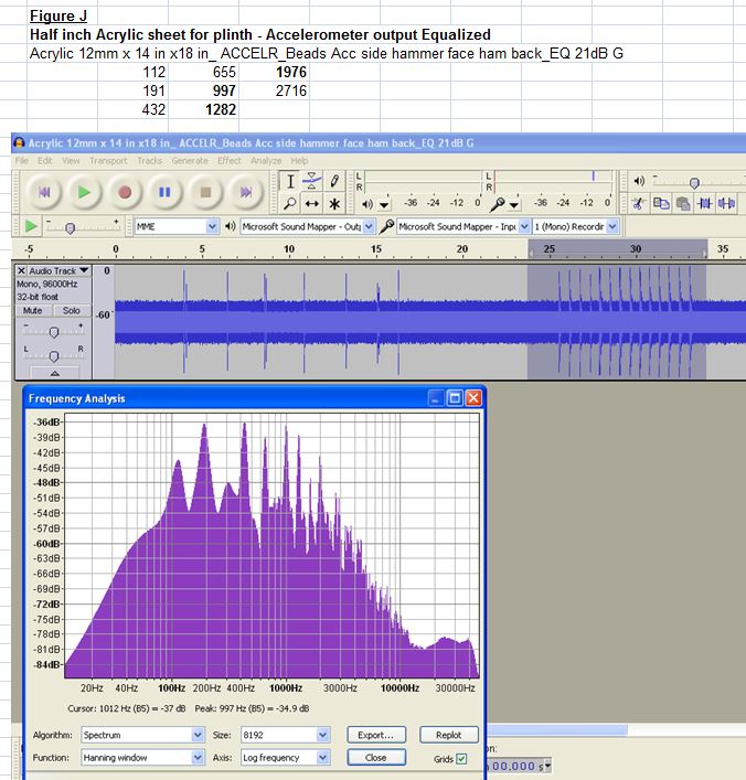

Figure J is one of the Acrylic panels intended for the real plinth ( 1/2" (12mm) x 18" x 14"). The panel shows a variety of nasty, narrow peaks at 655 hz and above. I suspect that one or more of these would also be high and poorly damped if a hard glue like Lepages PL or Epoxy was used between the layers. I'm hoping the rest of these tests demonstrate a way to cope using softer adhesives. I haven't built the real plinth just yet, so take it with a grain of salt.

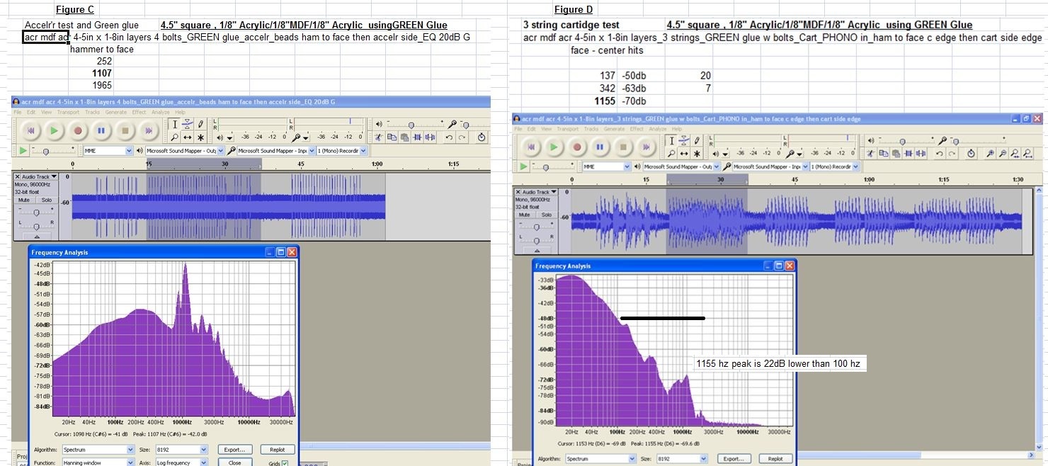

Figure C is an Accelerometer test on the same Acrylic/MDF/Acrylic layers with Greenglue in between. (The corners had to be bolted as the Acrylic is slightly warped and green glue is not really an adhesive.) Note that the main peak is now at 1107. The height is lower and the bandwidth is wider from the improved damping.
There may be a penalty in the lower frequencies. There's now a wide hump centered at 252 hz. I expect that the lower frequencies are still well damped (> 0.4 =DF as a guess).
Figure D is the corresponding Cartridge output through a phono stage. The peak is now 1155 hz. It's now 22dB below the 100 hz mark (black line). It's also a wider peak compared to figure B, suggesting it's better damped which will make it diminish faster.

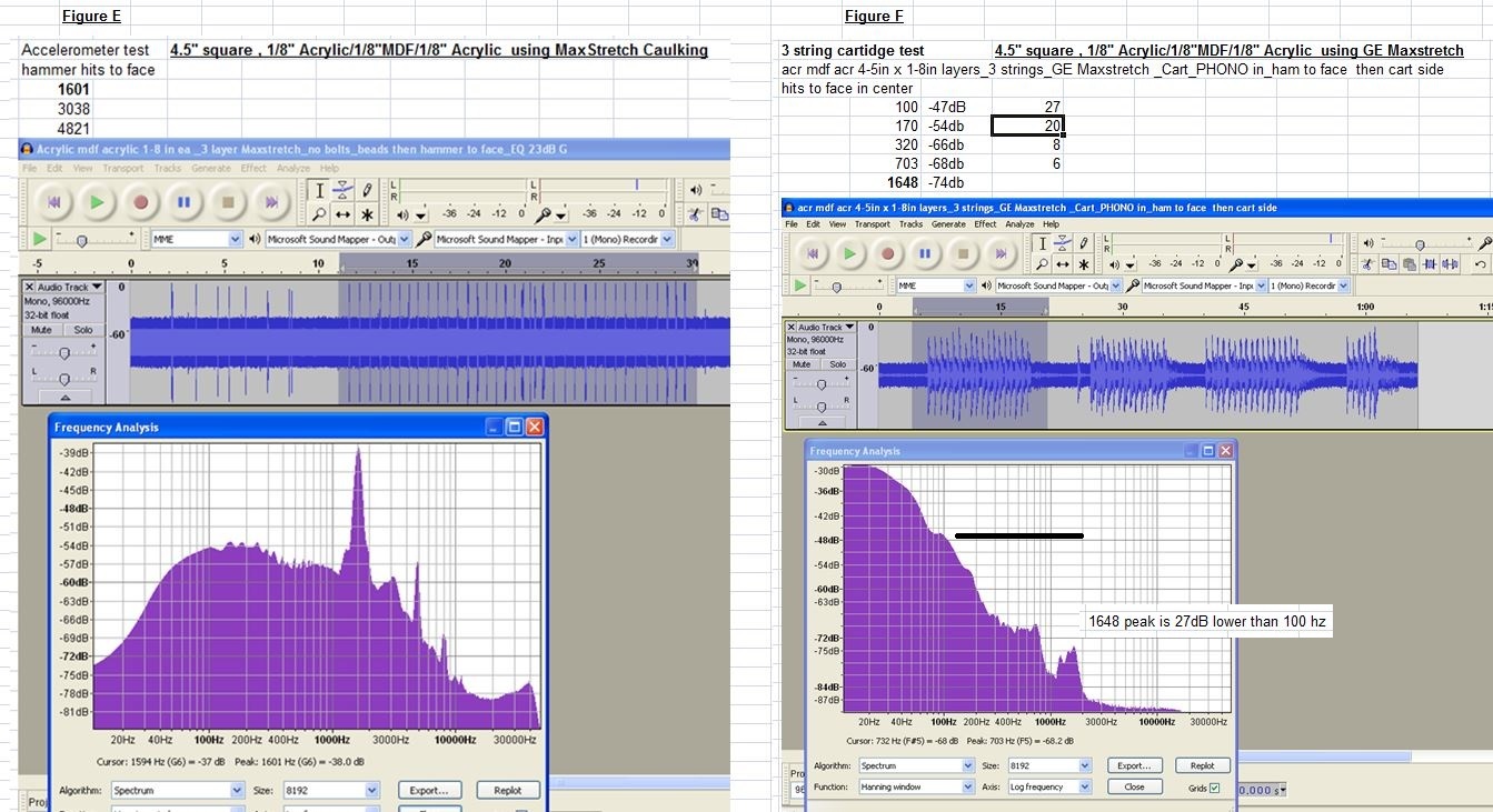

Figure E and F are show the effect of GE MaxStretch as the adhesive. It's labelled as "Elastomeric". It also recovers slowly when stretched, suggesting it is also Viscoelastic - just not sold for that purpose.
In figure F, the resonant peak at 1648 is fairly wide - good damping.

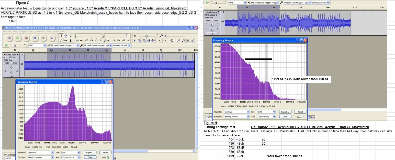

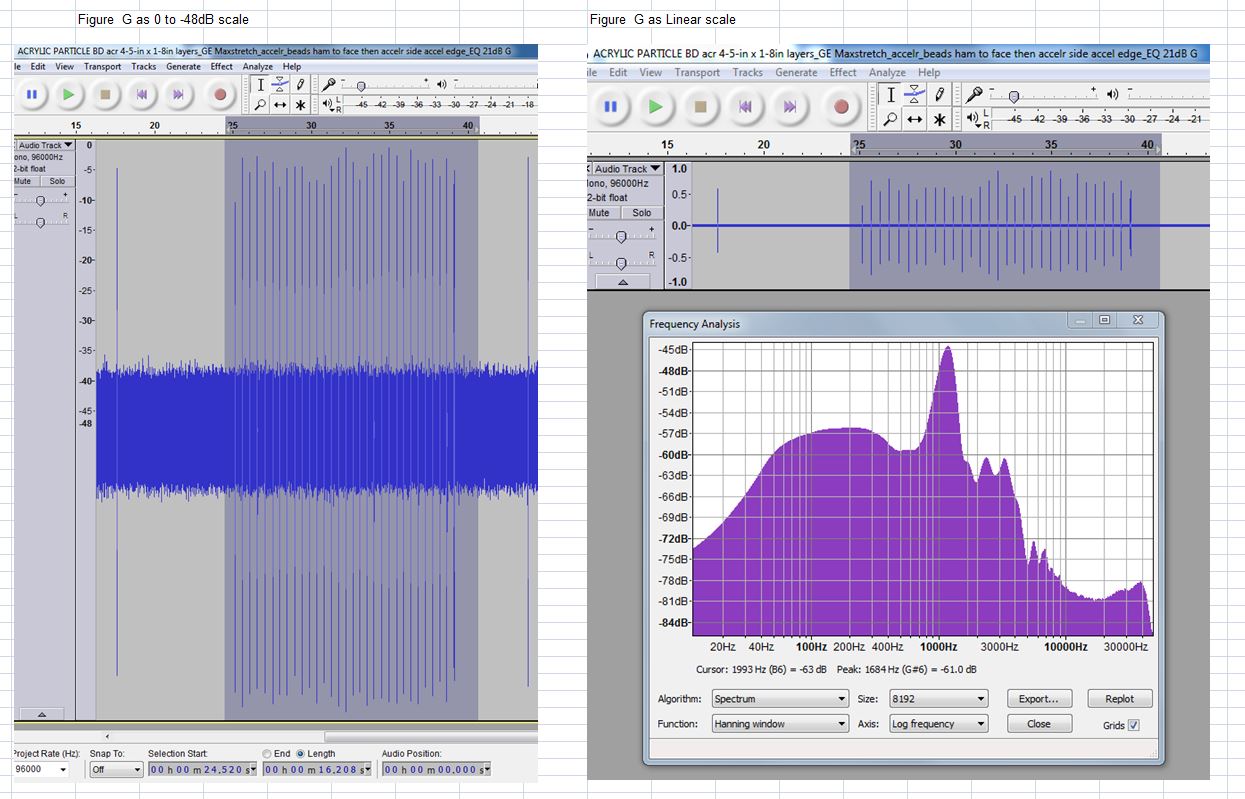

Particle Board (aka Chipboard in the UK) with Maxstretch is used in Figures G and H. The width of the peak (1167 hz) in Figure G looks like the best of the lot.
The cartridge output in Figure H has a corresponding peak at 1110 hz. It too appears to be wide and well damped. It’s peak is 26dB below the 100 hz line.
I wonder if I should try a (quarter scaled) panel using Greenglue, Chipboard and Acrylic as well.
