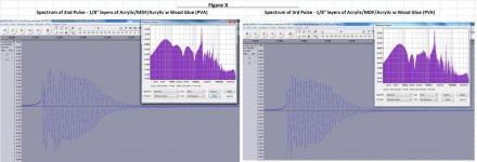

The spectrum is for just one pulse, but typical for the group. Is that big dip at 1443 Fc by any chance?
The dip at 1443 Hz looks like anti resonance! [oh, have I opened a can of worms?]. Here's Wiki's thought on the subject:
"Anti resonances can occur in all types of coupled oscillator systems, including mechanical, acoustical, electromagnetic, and quantum systems. They have important applications in the characterization of complicated coupled systems".
Does the acrylic/mdf/acrylic/wood glue now look like two coupled systems?
The Fc would be a positive peak on your trace.

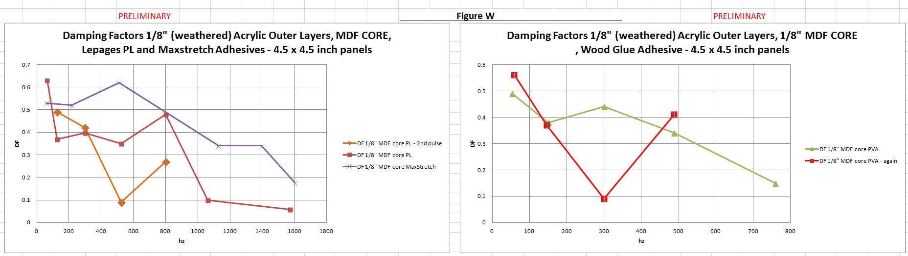

This is by no means complete, so I've labelled the graphs as "preliminary". It needs a lot more work, but more feedback may ensure it's not wasted effort.
I've picked out what I believe to be "good" pulses for a few existing panels and used Equalization, filtering and Logarithmic Decrement to calculate the Damping factor at several frequencys. In figure W, I've repeated the effort for two similar pulses on the PL (Orange and Brown traces) and Woodglue panels (Green and Red traces).
They don't repeat very well do they? I'm offering these explanations:
a) Hjam picks poor pulses.
b) That's the nature of the materials. More pulses are needed to characterize them.
c) Other? Bryan, have you got another explanation? I'm guessing you've already seen this sort of behaviour.
Figure X shows the waveform and spectrum of the "PVA" Pulses in figure W, just in case it's (a).
If it's (b) , the woodglue (PVA) traces look good up to 150 hz - (DF around 0.4). Above that, it's the bad part of town. The DF of the two traces do not really agree.
The PL glue does this at about 300 hz. I've only done one pulse for Maxstretch.
I'd say that Anti-resonance seems like a good explanation for the bad parts of town. So does Hysterysis, harmonic distortion, etc.

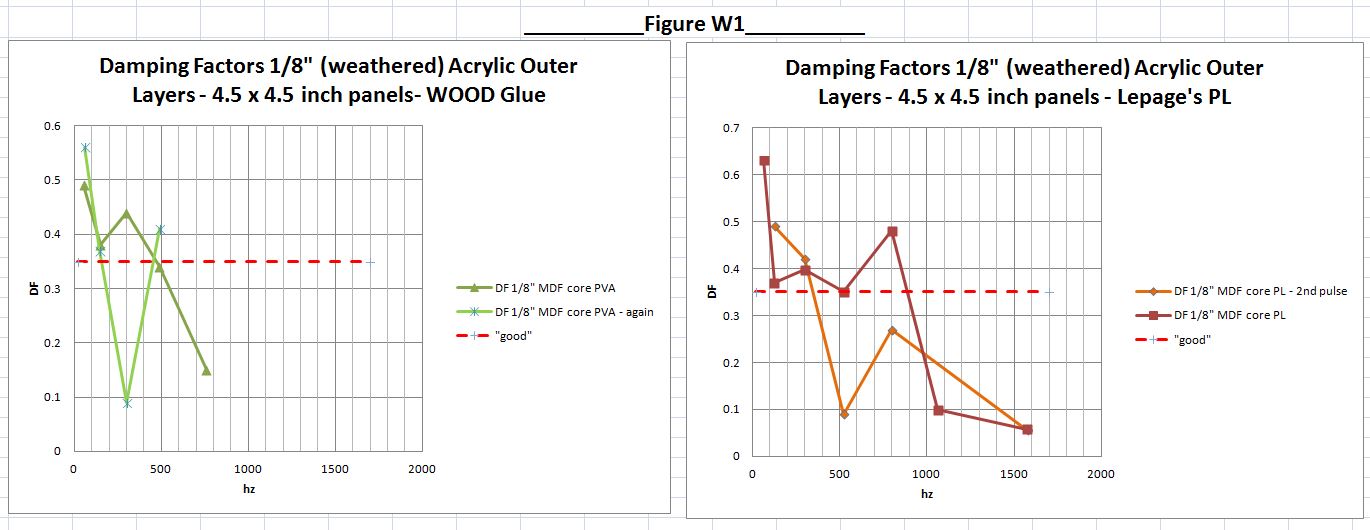

Here's a more about the adhesives. These tests are very dependent on which hammer tap pulses are picked - Frustrating! Each graph could use more repeats, but there is a general trend, so posting them anyway.
Figure W1 (left side) has two traces from two pulses on a panel that used Wood glue (PVA). The first trace suggests good damping ( above 0.35) up to almost 500 hz. But the 2nd trace suggests good damping only up to about 150 hz.
The right side uses Lepage's PL. Surprisingly, it seems better than the Wood glue. Good damping up to over 300 hz or almost 900 hz.

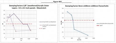

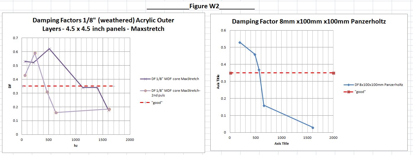

Figure W2 (left side) uses the softer GE Maxstretch. Now it's looking good past 400 hz - maybe even 1100 hz.
As a reference, the right side is a piece of 8mm Panzerholtz. In this example, the "good" region is up to 550 hz. I'm sure a second pulse will show differing results.
At one point, I thought Maxstretch may somehow amplify the low frequencies with repect to PL. A set of tests with beads indicates this is not so. The same test selecting hammer pulses says it is true. Stuck on this point for now.

I think I'm sorted out on the hard vs softer adhesives. It seems that PL and Maxstretch respond about the same to taps from a 12V solenoid. The applied taps are a bit stronger than hammer taps. Not good to measure damping, but good for evaluating the magnitude of the spectrums.
