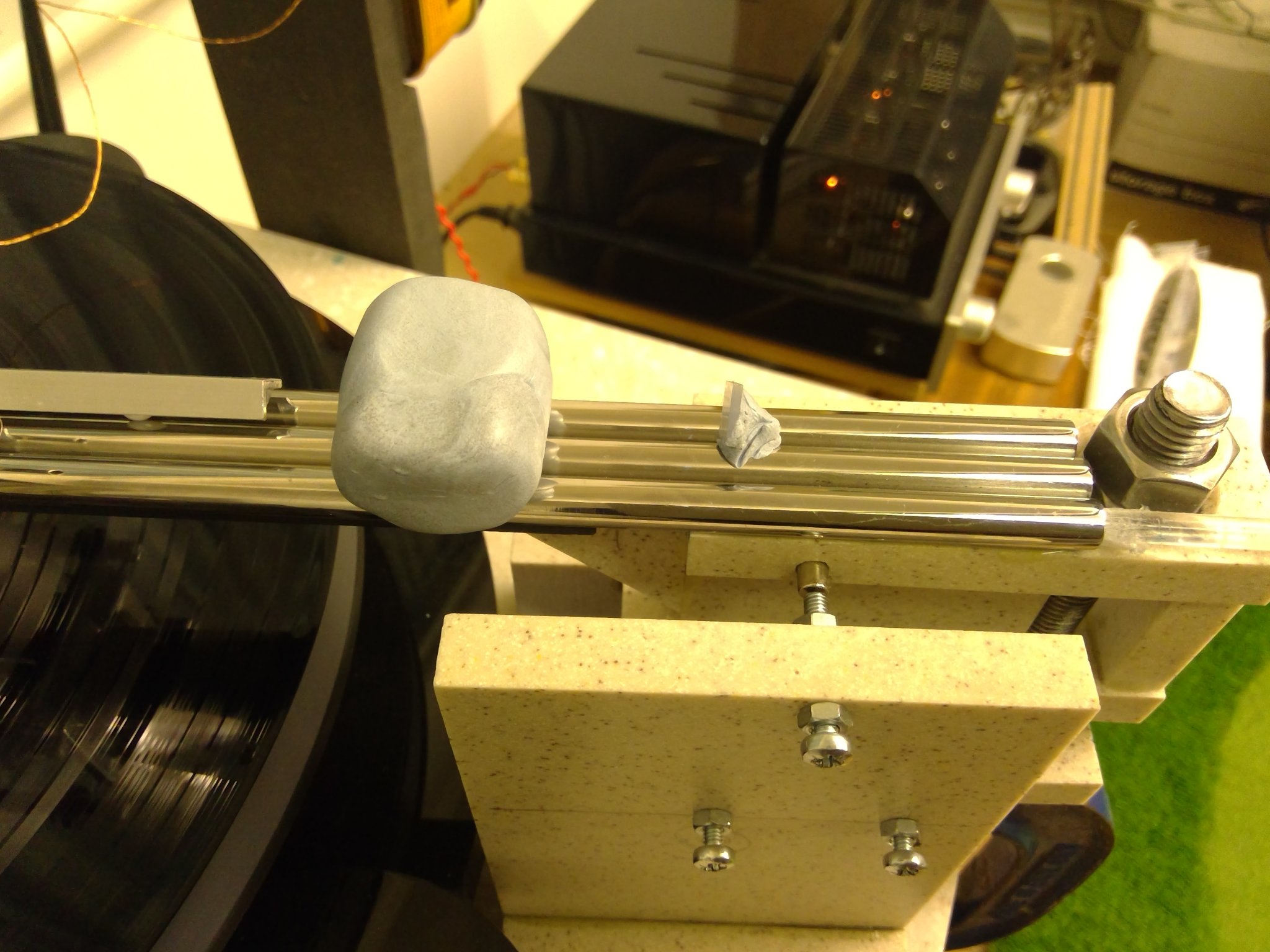

My RTA has undergone many iterations and is playing quite nicely these days.

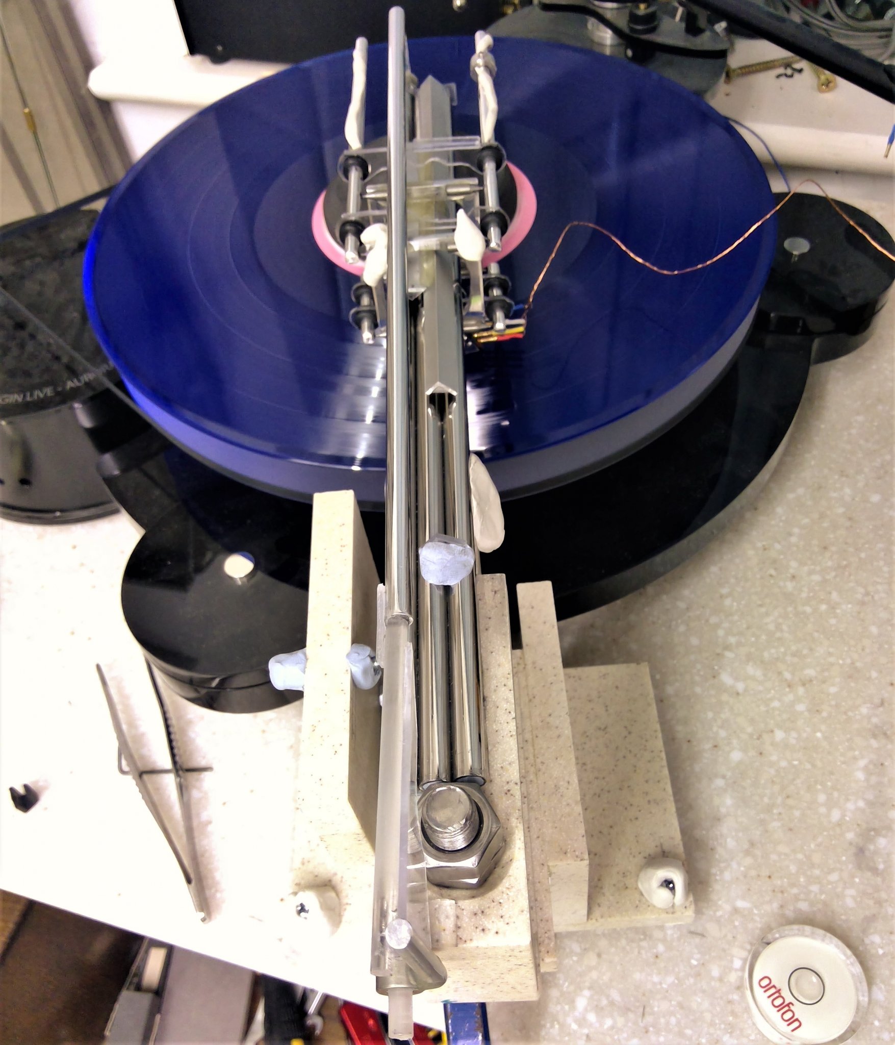

I made the hinge away support by iterative experiments, stiffness was very significant, so i have a very large bolt ground to a taper working with Avonite parts as can be seen in the picture.
I already imagine that moving the pivot to reduce the free length of the rails should stiffen and raise the resonant frequency to benefit.
What else might help in designing new parts here please?

I don't see any materials you have use in the construction (except the added lumps of plasticine type) which may (will) cause problems.My RTA has undergone many iterations and is playing quite nicely these days.
M
Many thanks Cats, the Blu tack are little damping experiments, the aluminium rods seem better with that damping than without, then the pieces on the cartridge side or balancing weights.I don't see any materials you have use in the construction (except the added lumps of plasticine type) which may (will) cause problems.
of course its difficult to be sure as i cannot have one without the other.
I intend to try a shrink sleeve on the aluminium at some point instead.
I assess such experiments with measurements.
Here attached are how that lot plays a 1000hz tone.
However, reading your informative thoughts about materials i hoped for some suggestions for further improvement, where might i start looking please? - all ideas much appreciated!

Hi Hugh, no, these are stainless tubes, i dress them for straightness and polish them. These have been damped internally in three different ways, a foam rubber insert, sand inside and blu tack, they currently have the blu tack, the sand may have been very marginally better.Hi Mike56,
Are those Tungsten Carbide rods? What would you say resonates more, the rods or the rest of the aluminum?
I haven't tested my LTA for vibration yet, but I suspect the rods are the worst of it.
Hugh
Using a stethoscope i listen to taps on the various parts, and also cartridge on record through the speakers.
The rods give a dull thunk, the carriage sounds more lively...........this may also be because it is closer to the cartridge.
Making everything really stiff was the main route to improvements and the side bands you can see in the measures are much reduced as a result, damping the parts is less predictable.

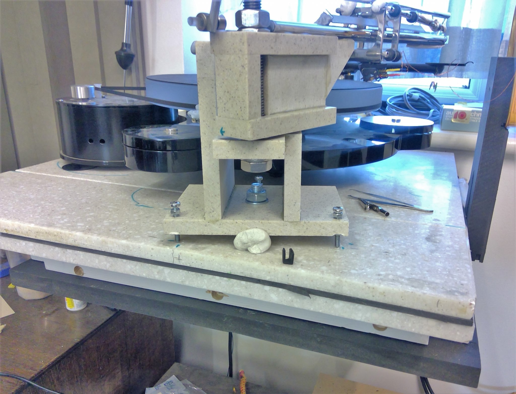

At the moment my TT and TA are mounted on separate sheets of Avonite (Corian alternative) the TA is bolted to its one and the TT rests on its own.
Then these sheets sit side by side on a sheet of Mass loaded vinyl around 4mm thick (the black layer in the picture) which sits on another sheet of avonite.
This whole sits on a shallow sand box on a wall shelf.
My feeling is that the weight of the top lot connects the top sheet quite firmly to the MLV and so to the bottom sheet of avonite, maybe this works like CLD?
My question is simple, would it be better to
1. Leave as is
2. Bond with bitumen roofing glue (viscoelastic?) the top and bottom avonite sheets to the MLV
3. Remove the MLV and bond one sheet of avonite to the other with bitumen glue
Obviously i only get one chance at this as bitumen glue is sticky stuff!

Nice looking work Mike.
I suspect some sort of viscoelastic might work better than the MLV between the layers, but I really don't know for sure.
The Roofing goop scares. Anything I've used on shingles stinks for a long time. Not good indoors. And, like you say, one chance with that stuff.
I like GB Electrical Ductseal because I can pull it apart if I don't like the results. It cleans up with Varsol. If it's a success, finger tight nylon bolts helps keep the "bond".
Some types of Plumber's putty might be similar (but some dry out and get a bit hard after a few months). Blue Tack, Modelers clay, Stretchy acrylic caulking, butyl tape - lots of choices.
I also bought a can of Butyl sealing goop that I've not tried yet. I'm not sure if it stays soft.

Thanks Hugh, i shall have a look at Ductseal, interested in your methods and any test results, blu tack over that area is too large, but i have lots of success with it locally and you can often see local blobs around as experiments.Nice looking work Mike.

Meanwhile i "dolloped out" some bitumen glue to see what i have, to be honest the smell/volatiles wasn't so bad as the warnings!
It stays liquid a couple of hours and starts to set, question is, is it a V.E. layer at the end, do i aim for a couple of mm? i could fence the edge of the avonite, level it and make a pond before adding the second sheets, i see it as quite practical if its a sound idea!
