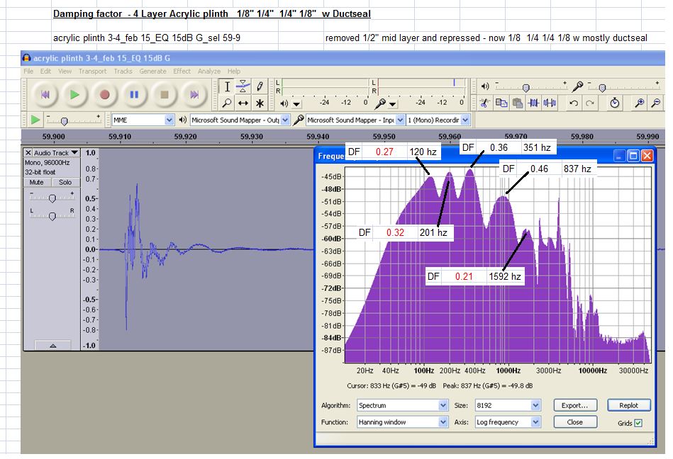

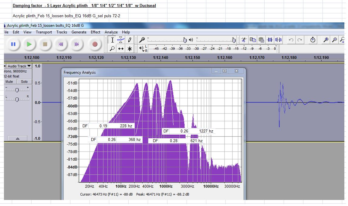

In post #510, I was optimistic about that 5 layer Acrylic combination when I tested a 4"x4" mock up. Here's the results for a 19" x 15" (plinth size). It was the same layers - 1/8", 1/4", 1/2", 1/4", 1/8" with Ductseal pressed in between the layers.
It's not as impressive as a full size combination. Every resonant point is well below my DF=0.35 target. I'm guessing it's still better than MDF or similar, but no cigar just yet.
H
H
I removed the 1/2" layer from the middle and reassembled and clamped to get a 4 layer combination. This time it's 1/8", 1/4", 1/4" and 1/8" and mostly Ductseal as the 3 elastic layers in between... Better!
I'm thinking I may buy two more sheets an see how a 6 layer combination performs.

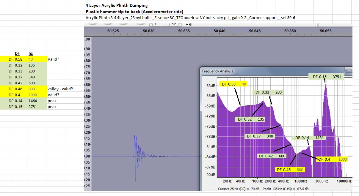

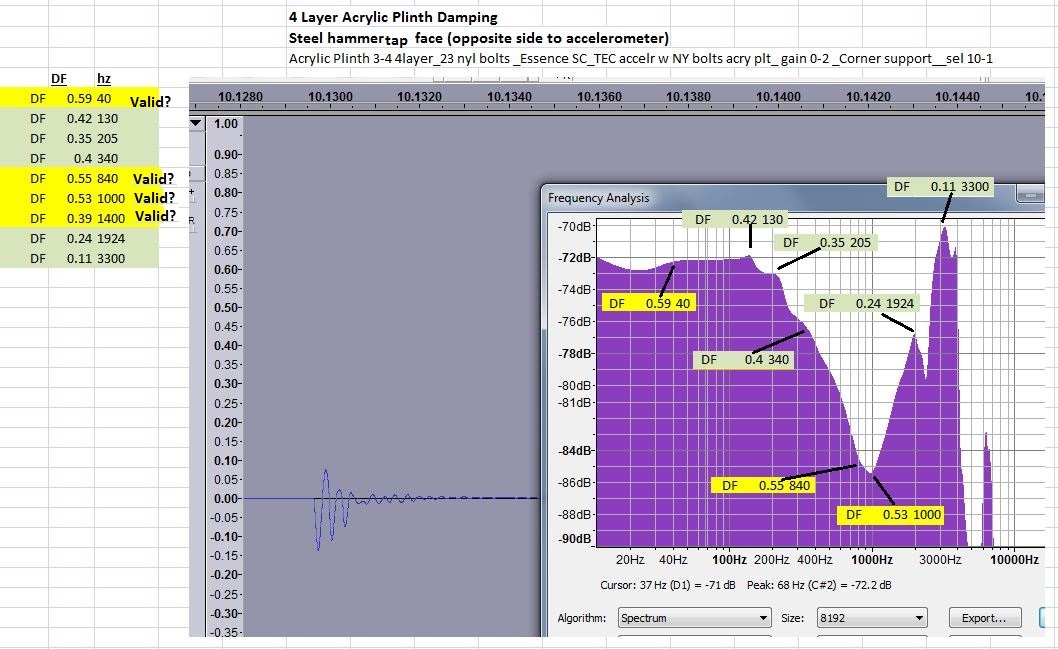

Here's a repeat of the 4 Layer Acrylic Plinth Spectrum and Damping from post 522. This time it's a better Accelerometer and Soundcard.
The method of attaching the accelerometer effects the results. I used nylon through bolts and silicone grease after some experimenting, but I can't swear it's the best way. There is also a difference in tapping the accelerometer side (back) vs. the face - partly due to the Viscous layers I think.
Cats Squirrel cautioned me that DF measurements below the resonant points are likely not valid tests of the material itself. I've highlighted those spots and a few others that I'm unsure of in yellow.
Overall, I'm delighted with the Damping results. The peaks above 1000 hz look a bit imposing, but I believe it's the performance below 1000 that counts. (Comments please).
The lowest resonance (if it's real) is a bit low. I probably could have used thicker layers to get more stiffness and more mass.
I will post a test on MDF to put this in perspective.
Hugh

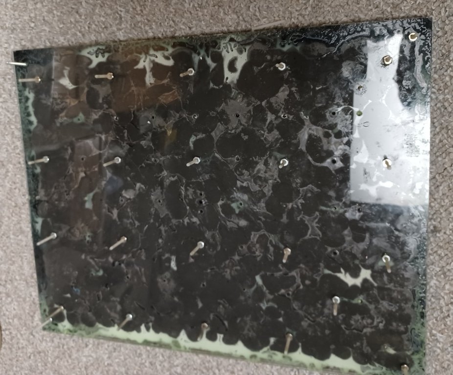

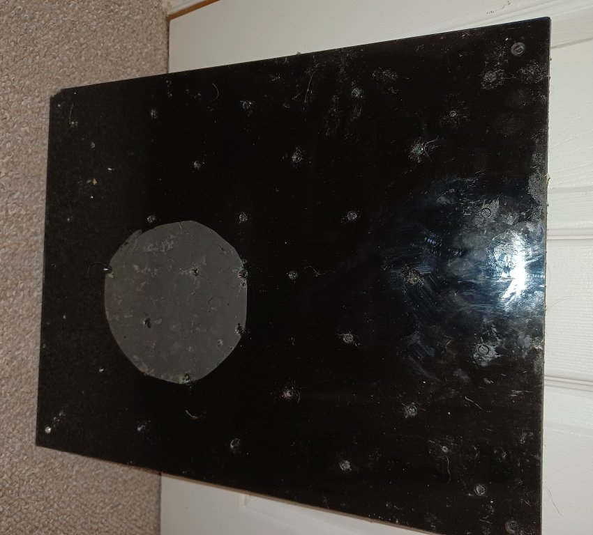

I haven't cleaned all the Greenglue remains of the surfaces in these shots. Not really ready for prime time.
The top layer was painted on the back surface to hide everything underneath - except for a round area that exposes the compressed Ductseal.
The Bottom shot also shows the compressed ductseal. The green along one edge is Greenglue that hasn't cured yet. Trimming the nylon bolts await a decision whether to add more layers.

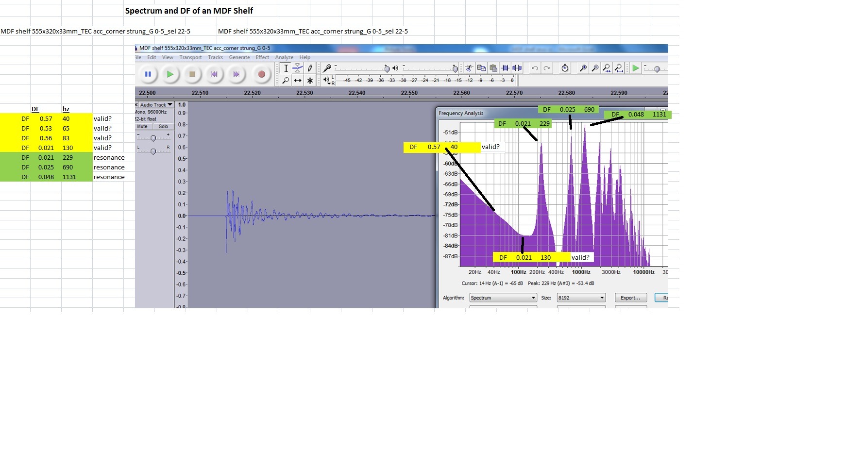

This is an MDF shelf that's about the size of a plinth, but wrong proportions for a plinth. Note the horrible damping at 229 hz, 690, 1131, etc.
Great damping from 40 to 83 hz, but these are likely not valid measurements of the MDF. I don't know FFTs well enough to explain this point, but I am curious.
Hugh
