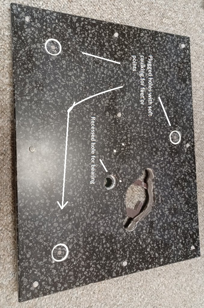

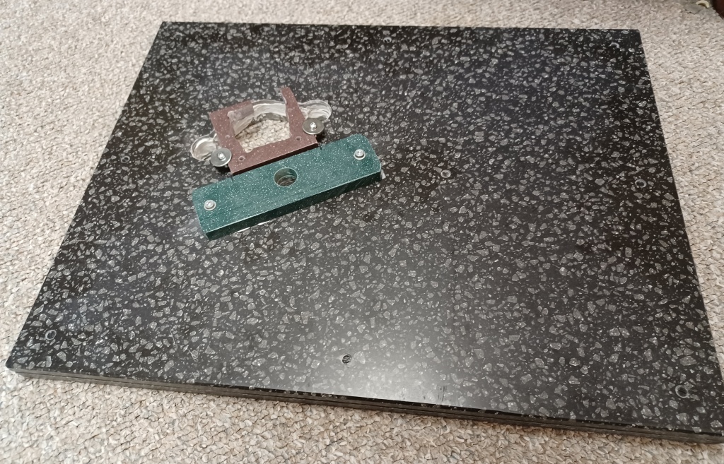

Further, I would ensure that the upper and lower skins remain completely isolated from each other except by the core, ie. no through-bolts or potted inserts.
For the past few months, I had been thinking I would bolt everything through the two Corian layers. But MrKlinky's comment reminds me that this is not really taking full advantage of CLD.
I recessed the hole for the bearing so that it only contacts the top layer (1st picture). The white circles were cut with a hole saw through the bottom layer only. Then they were glued back into place so as to contact the top surface. The white surround is a soft, stretchy caulking. This is an attempt to keep air from getting at the Ductseal between layers.
There's also a groove cut along the edge between the 2 Corian (actually Megalite Solid Surface) layers. This was later filed with a clear, soft caulking.
Reactions: MrKlinky

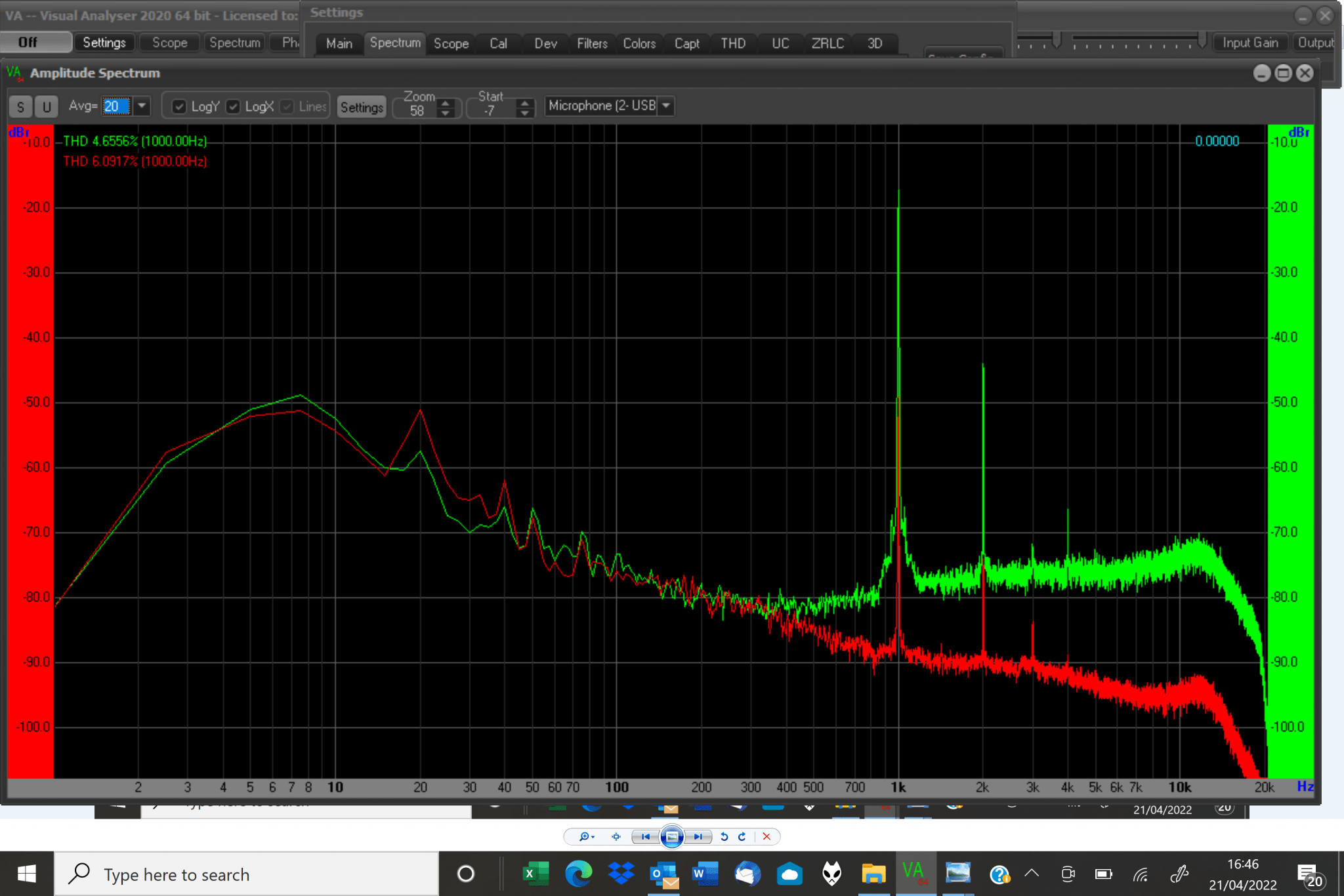

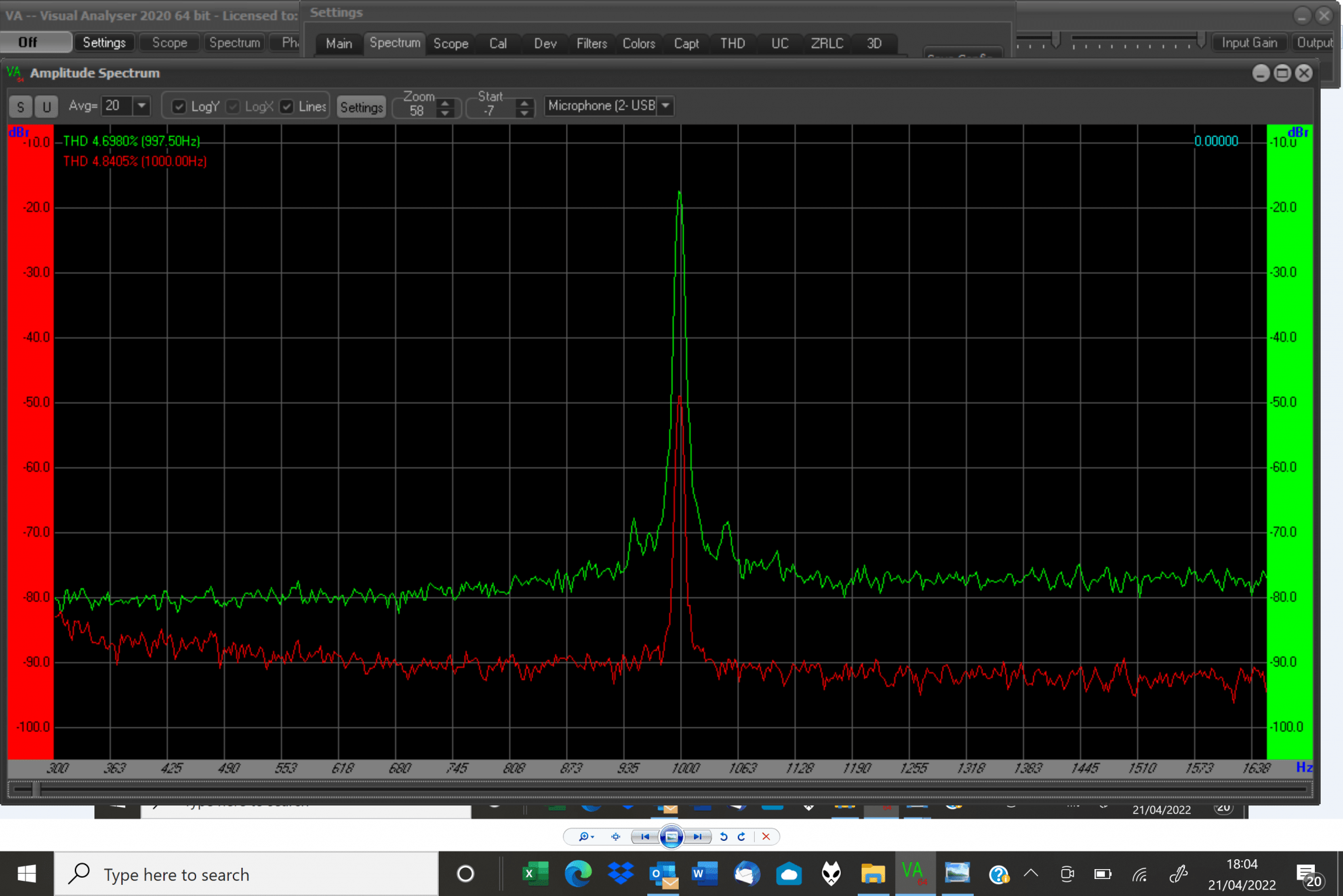

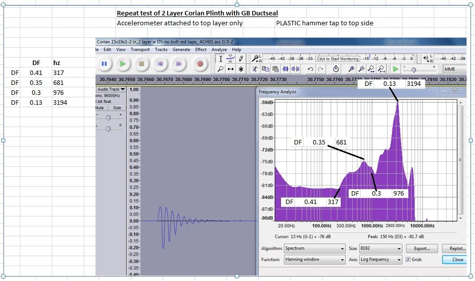

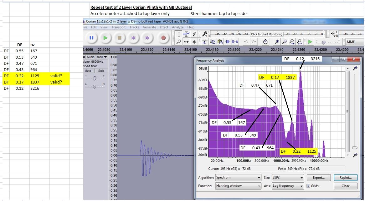

A disclaimer...
Cats Squirrel has some concerns with a few of waveforms in some measurements I've made. If I was doing this for a living, I'd dig a little deeper figure out what's going on. But, time constraints. So take this for what it is - amateur effort with amateur test gear...
In posts 545 and 546, I had created some coupling between layers as an attempt to simulate the bearing attaching to both layers. Later, I repeated the measurements. This time the Accelerometer was attached to the top layer only. It was adhered using silicone grease and a sticky red tape intended for sticking Tyvek house wrap.
I picked 2 "typical" pulses from the lot. One was using the steel tip from the little Elf hammer. The second used the plastic tip. Here's the Spectrums and some measured Damping factors in a few spots. Both look good up to 1khz, so I'm very happy with this plinth.
Many thanks to Cats squirrel for his advice over the past year or so!
  • Repeat - 2 Layer Corian Plinth DF and spectrum - Acc on top layer - Plastic tip.JPG

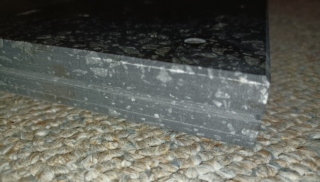

Applying Ductseal to the surface and clamping is a bit time consuming. So far, it's giving me the best results. Mostly, it seems to extend the damping into higher frequencies than other materials I've tried.
I did have another try with Corian and Blueskin (one sided adhesive) Butyl tape. This time I used a hard Urethane glue (Lepages PL) to stick the second layer of Corian. It was not so good.
I did see a few comments by Gedlee about adhesives for CLD in various places. He advised that it's the addition of fillers to the adhesives that make the difference. One is described here in post 532.

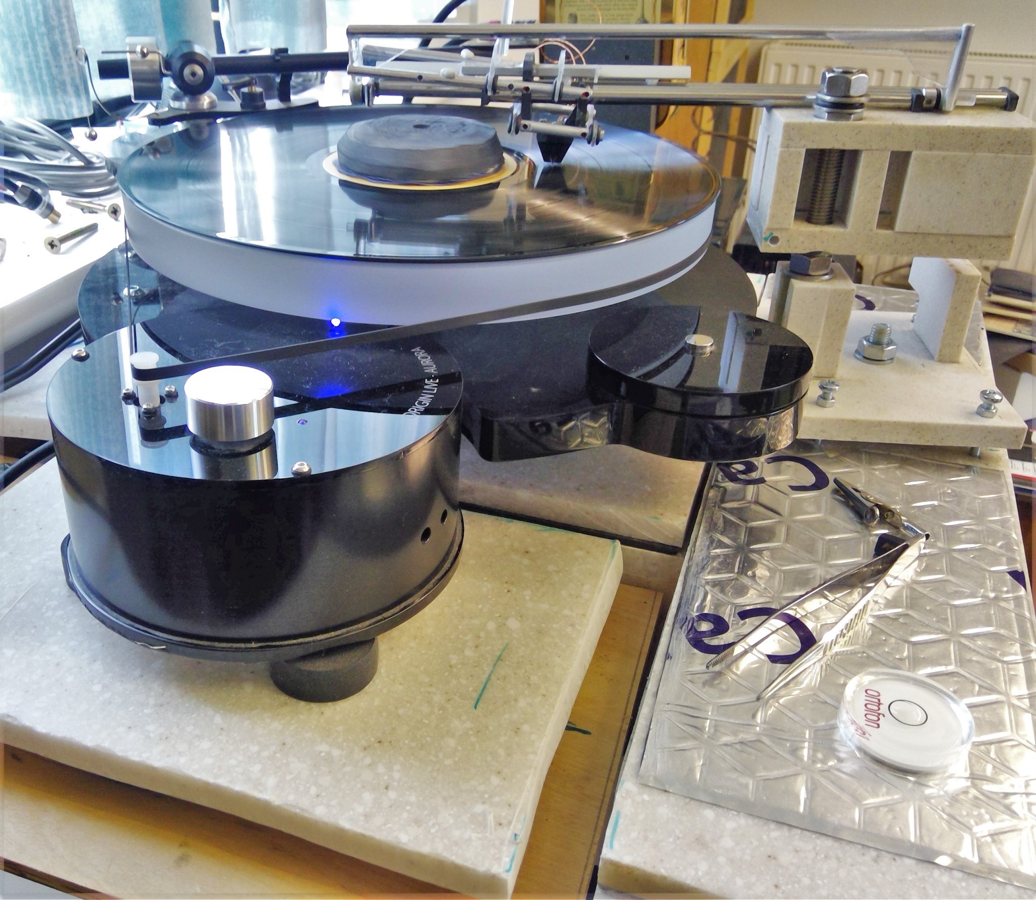

Looks good Hugh, what is the rest of the deck please?
What are current thoughts about what is connected to what.
I feel its fairly easy to conclude that if possible the motor should be as "unconnected" to the bearing, hence the platter and the arm base, but should the arm base and the bearing be tightly connected for synchronisation of any vibration between the two?
Mike
Thanks Mike,
The brown bracket you see in one of the photos is intended as a motor mount (initially). I have one of the standard (Primotek?) 120V ones used on Regas, my existing Heybrook TT2 and lots of others.
Later, I intend to rest it on a Sub plinth to "unconnect" it better from the main plinth. I'll try to measure the noise floor in both cases.
I have a bearing and Delrin platter from Tangospinner that I didn't photograph just yet.
I'm now experimenting to figure out the how I'll damp the Carbide rods for the LTA as well as a support structure for the rails. So, still a fair way to go.

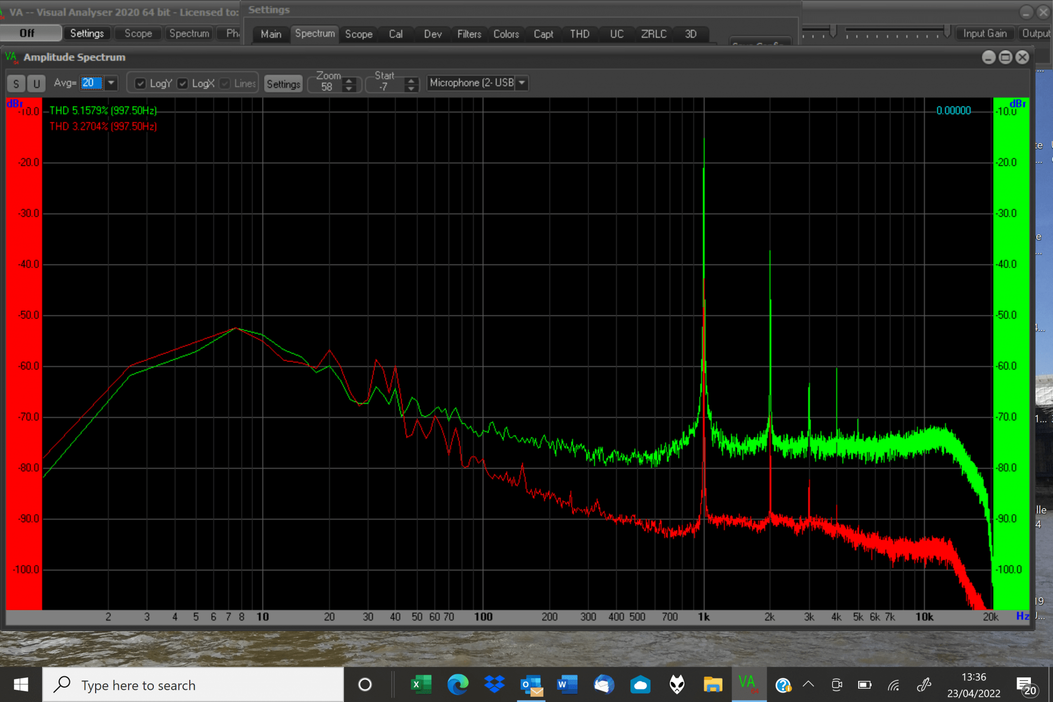

Excellent, interesting stuff Hugh, i spent today isolating the motor pod which is Origin Live to get rid of some 20 and 40 hz artefacts that were carrying across, i used some little sorbothane rounds i happened to have and thats done quite well, sufficient to expose that the next frequency to look at is the 50Hz which is hum from the wiring............if you look at the wee spike at the bottom you can see its 50 hz off the main spike either side and its evident in the full spectrum. if i cure that i will see the 20 and 40 again i am sure, an iterative process! mike
Reactions: hjam
https://www.diyaudio.com/community/threads/the-best-cabinet-material.276721/page-27
I should have added...
If "filler" is important in adhesives for CLD, I wonder if the same is true for tapes. 3M makes some expensive tapes for Vibration damping. Maybe they contain Butyl (or similar) along with lots of additives to create friction.
I'm guessing that's why the Ductseal works well compared to most of the other materials I've tried. It would be nice to find something economical that acts as a good adhesive as well as a Viscoelastic. I'm hoping to apply some of these techniques to speaker cabinets way down the road.

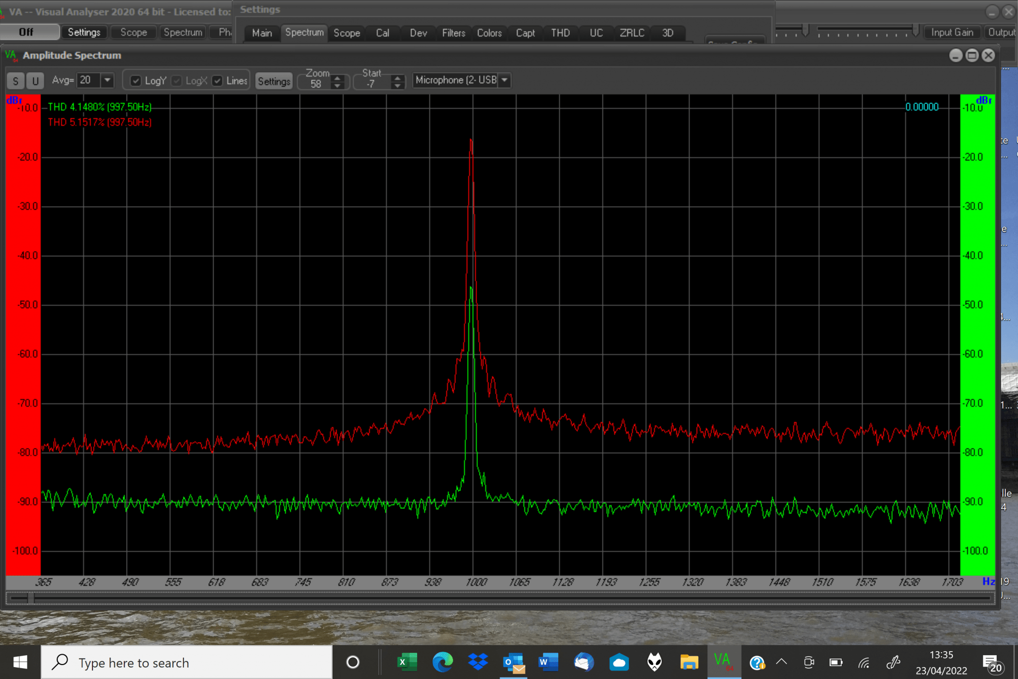

Nice work!
Everything is always a prototype here Hugh, so i cut away the motor pod part of the plinth and supported it directly from the wall shelf with an inner tube and sorbothane polos in between, as per pic, this further tidied the 0-100hz peaks and improved the signal spike as per these new measures as attached
