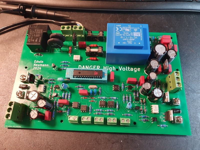

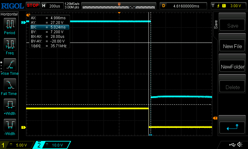

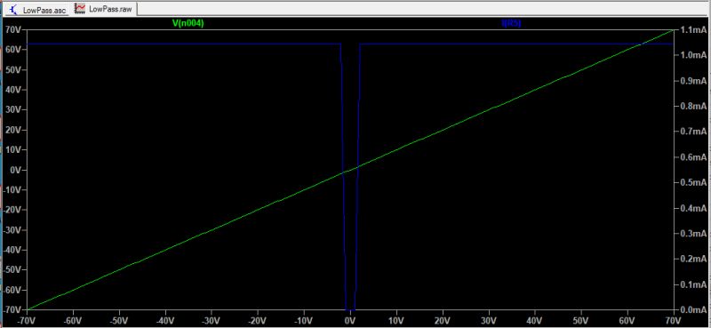

Turned my auxiliary circuits design from #3622 into a real life prototype and did some initial hardware tests. After a session with the usual prototype tweaking it now all seems to work. The software still has to be written so I can only test isolated parts at the moment. Below a scope capture while measuring the shut down response of the MOSFET solid state relay, yellow control signal, blue is output. I measured 28 micro seconds, that is way faster then it takes the low pass filter to produce a step response. At the bottom a spice output from the DC detector, green is DC sweep -70V to +70V, blue is the output. Fault condition below -1.3V and above +1.3V DC offset.

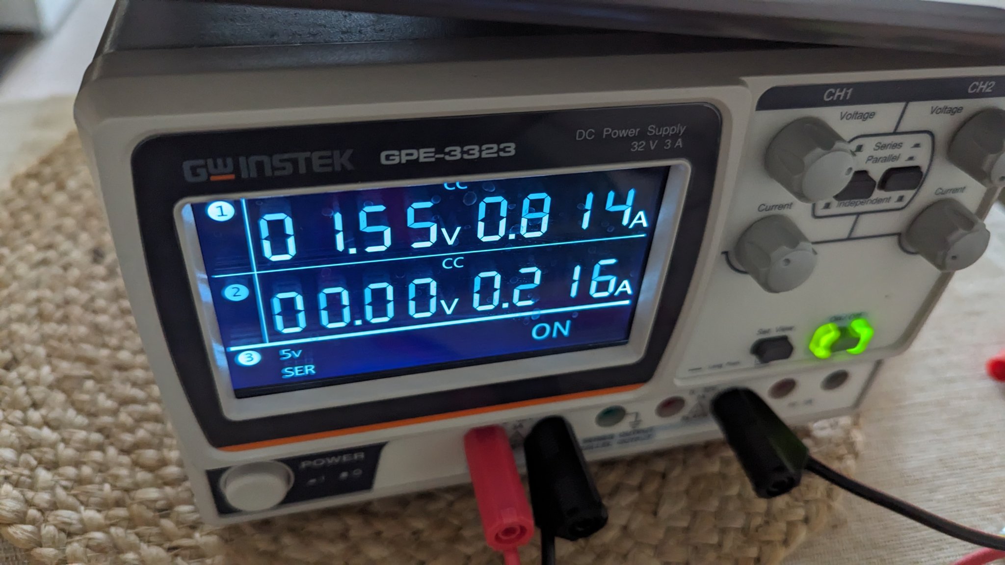

Trying to remember how everything works after a hiatus.
V+ to output shows, v- to output shows 1 ohm, should be over 10k
Used bench psu for power up.
Less than a volt for the output bias.
Psu image attached just in case

DC Power is supposed to be connected between the rails and ground, not to the output. Voltage is not measured in ohms. Did your short the output back then when you where connecting the speakers? Usually doing so will produce a spark, a sound, and possible a mark on the connecting part.
Are both sides of your GWInstek switched on, and wired as they should? What are the current limiter and output voltage set to? Are the fuse's of the amp still ok?
V+ to output shows ... what?
Anyway V- to output at 1ohm suggests blown (shorted) output (R trace+R emitter+R zobel coil), were rail fuses blown did you replace fuses?
My troubleshooting would then be something like remove all that channels output transistors and go back to step 16 of the build guide.
