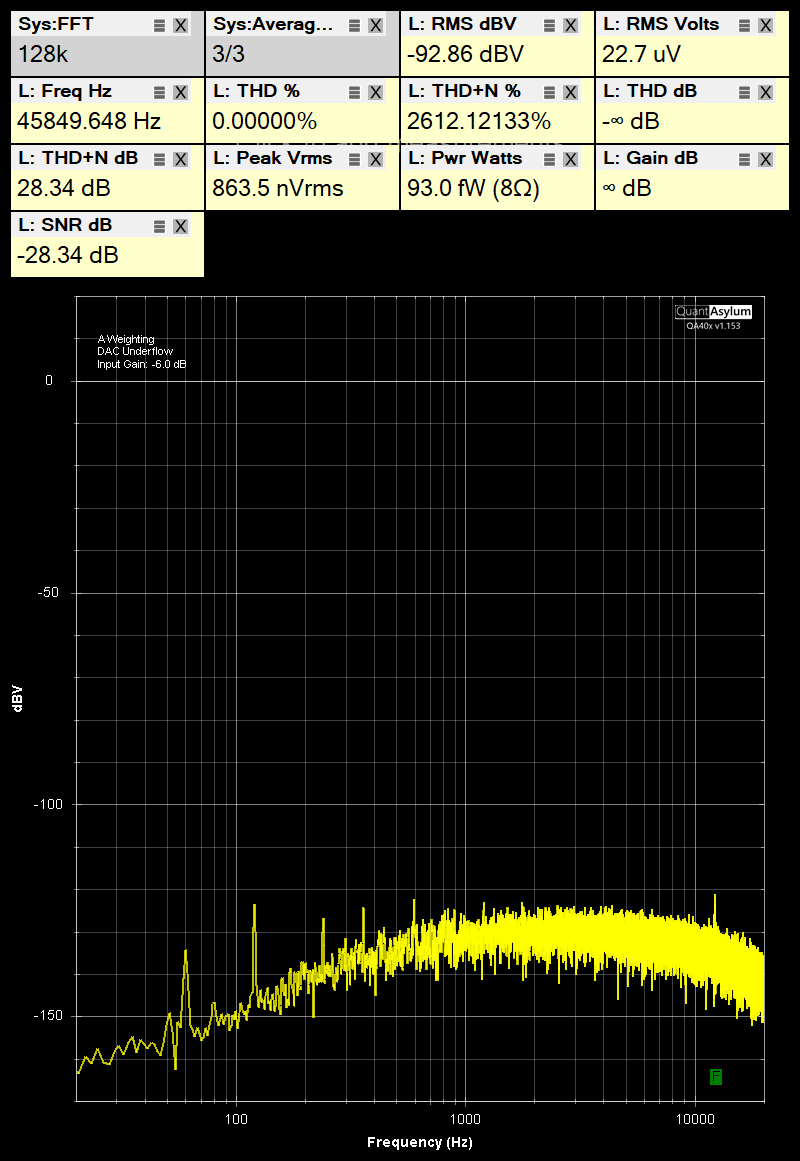

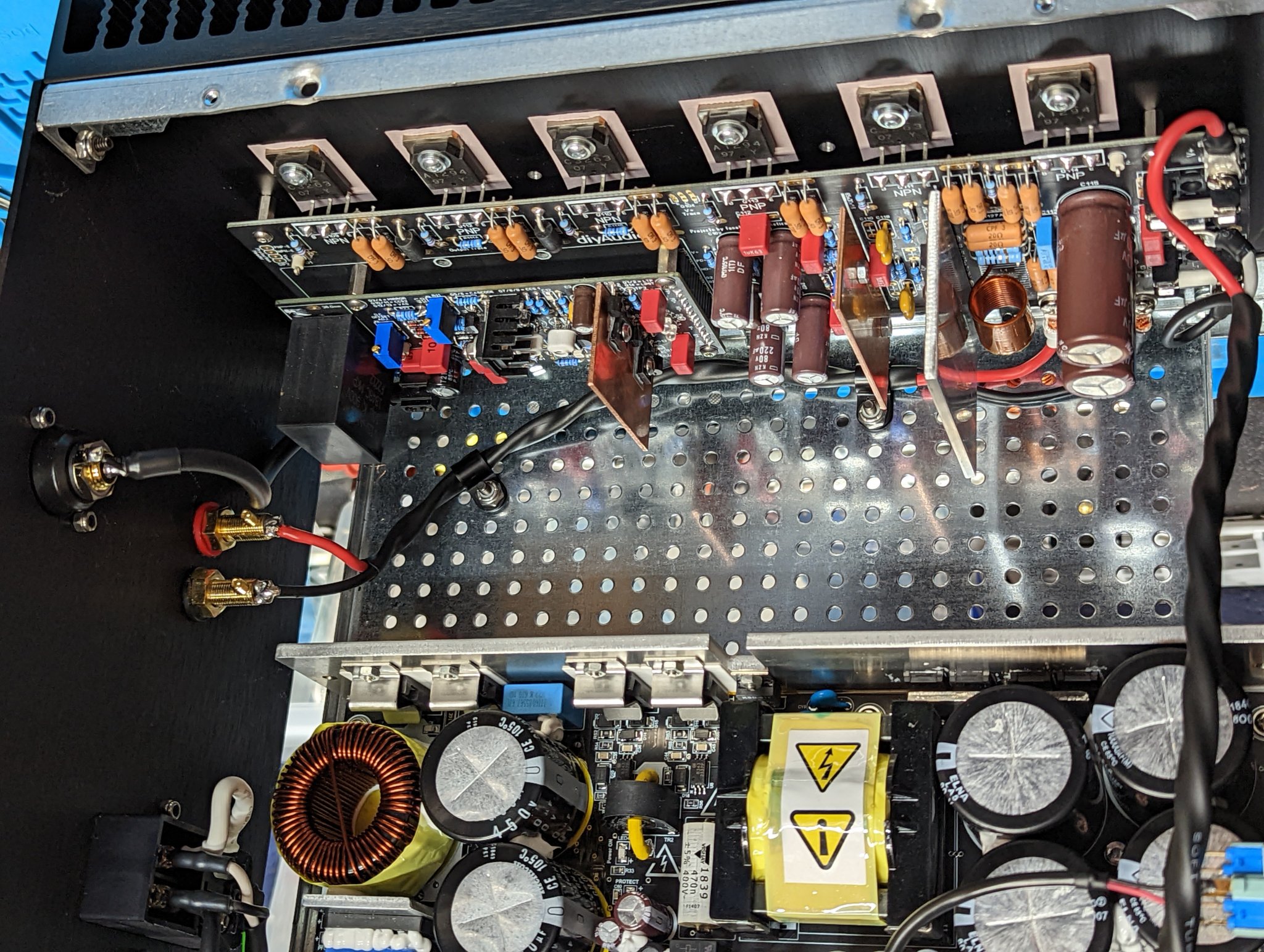

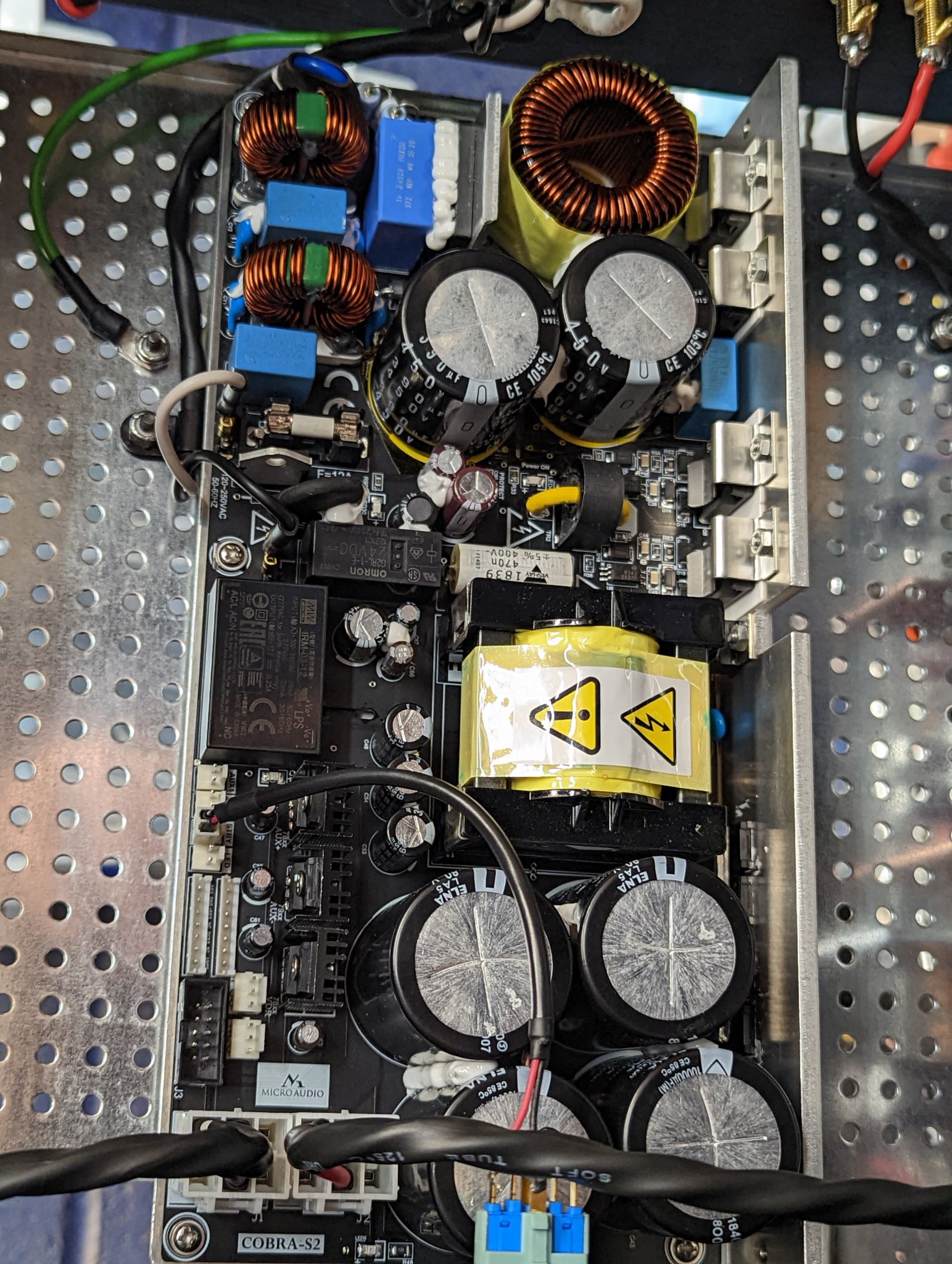

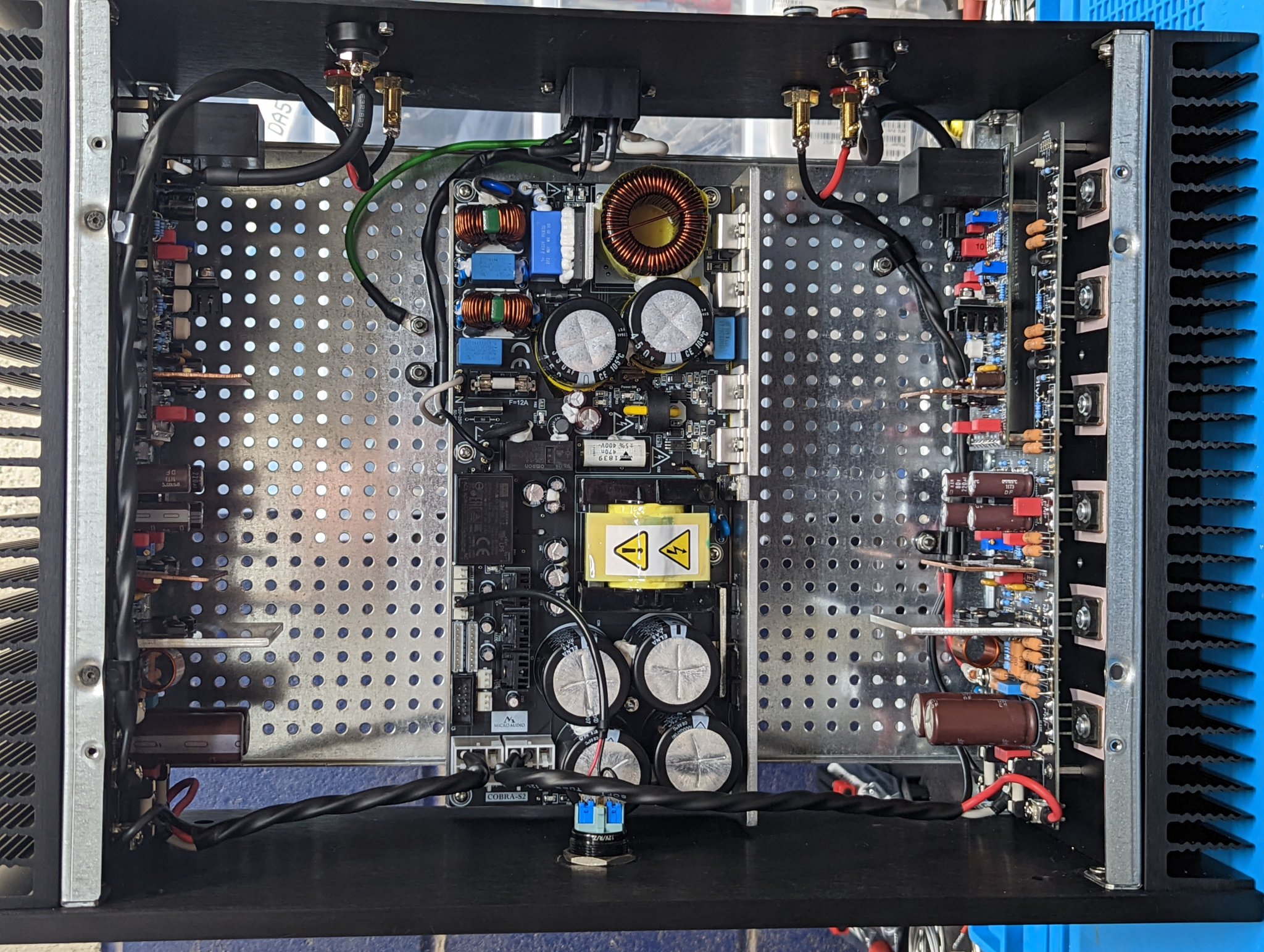

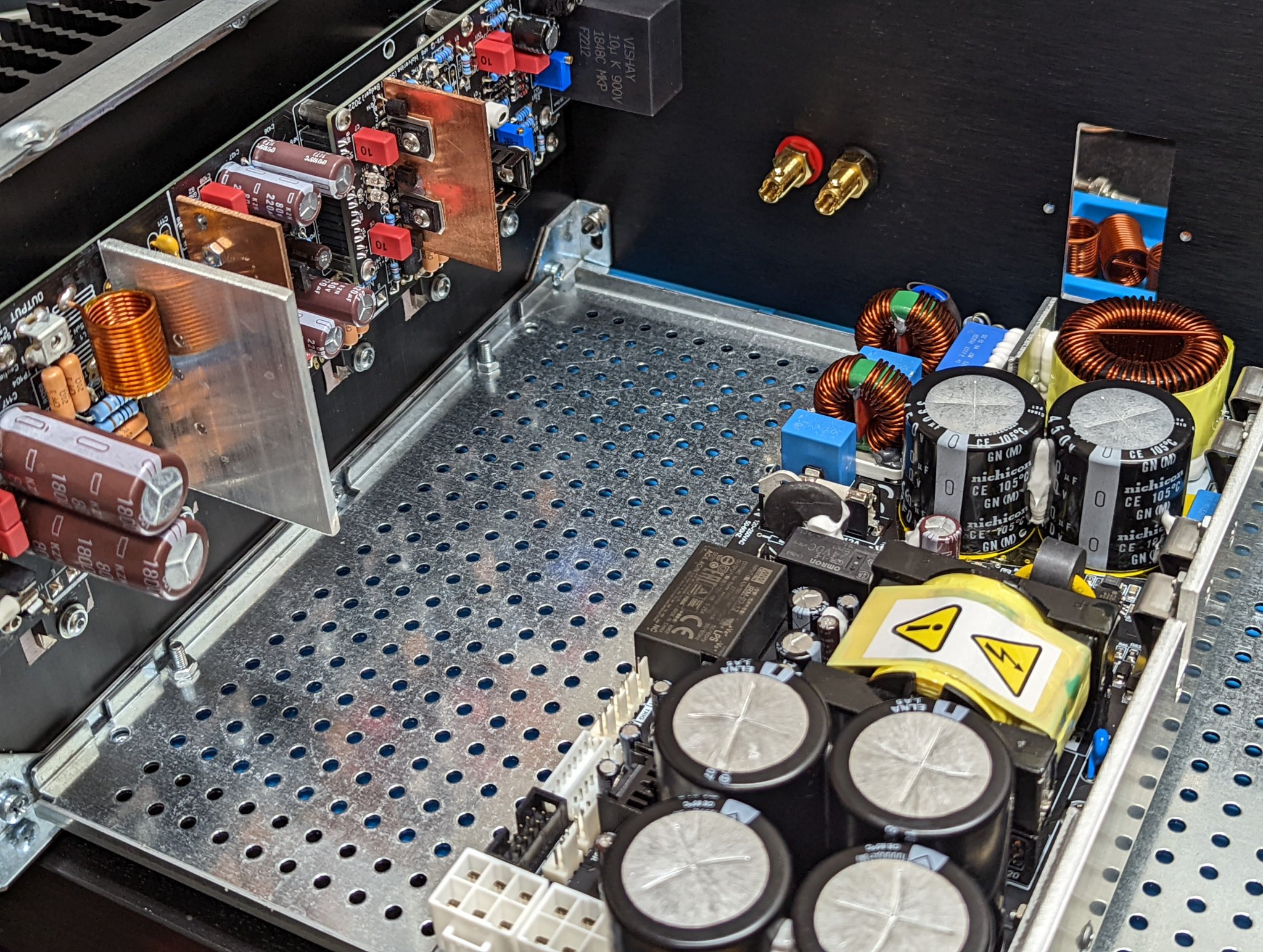

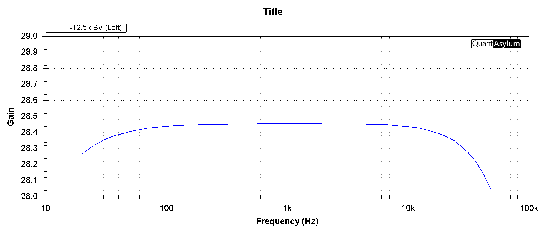

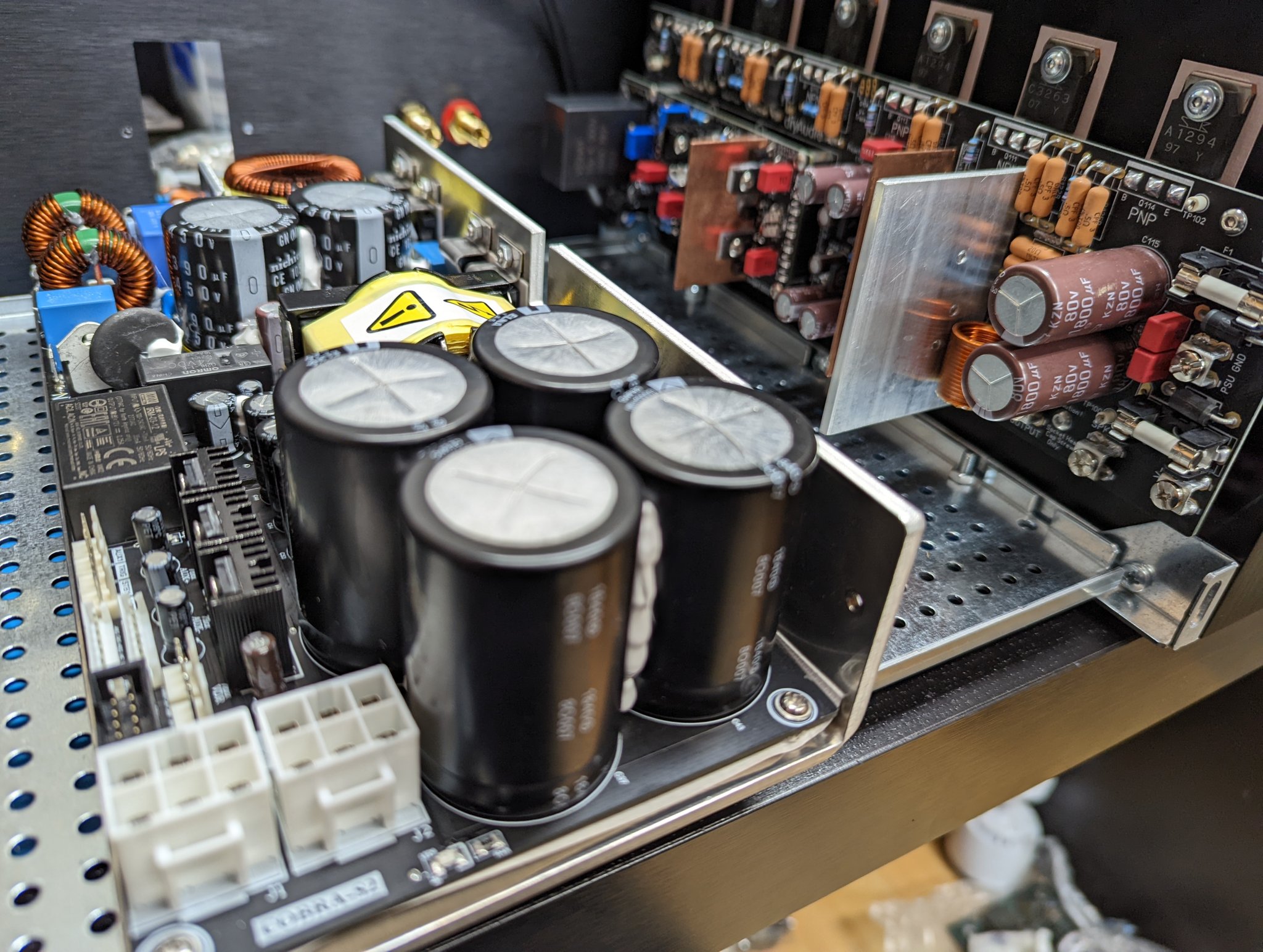

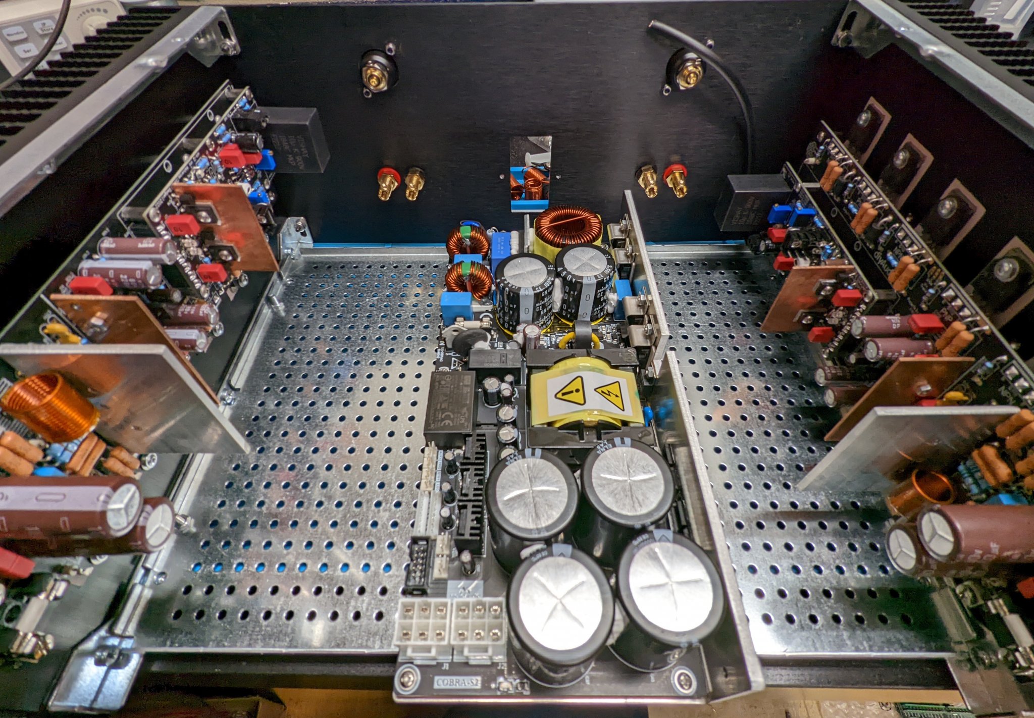

1st Chassis is now complete! I am testing the amp on my JBL Studio 590's and WOW does it sound awesome! The SMPS from Microaudio is top notch, comparing it to linear supplies I have built in the past, you would not know the difference, minus the weight and extra wiring. I do have a bit higher noise floor on the left hand board, but I am going to try some aluminum or copper plate to create a shield between the SMPS input and the left channel. I measured the left channel at -91 dbV A-weighted and the right channel at -94 dbV A-weighted, but its below what I can hear through my speakers.
Not sure how that compares with other builds, my wiring could also use a tweak, but I want to run this amp in over the next few days, then remeasure the voltages to see how stable it stays.
The final home for 2 of the amps / 4 channels is going to be for my JBL Project Array 1400's that are being actively crossed over with a Minidsp flex. After listening to this amp on my baby JBL's, I cannot wait to get another amp chassis complete!!
Thanks again to the TEAM for all the work on this amazing amp!

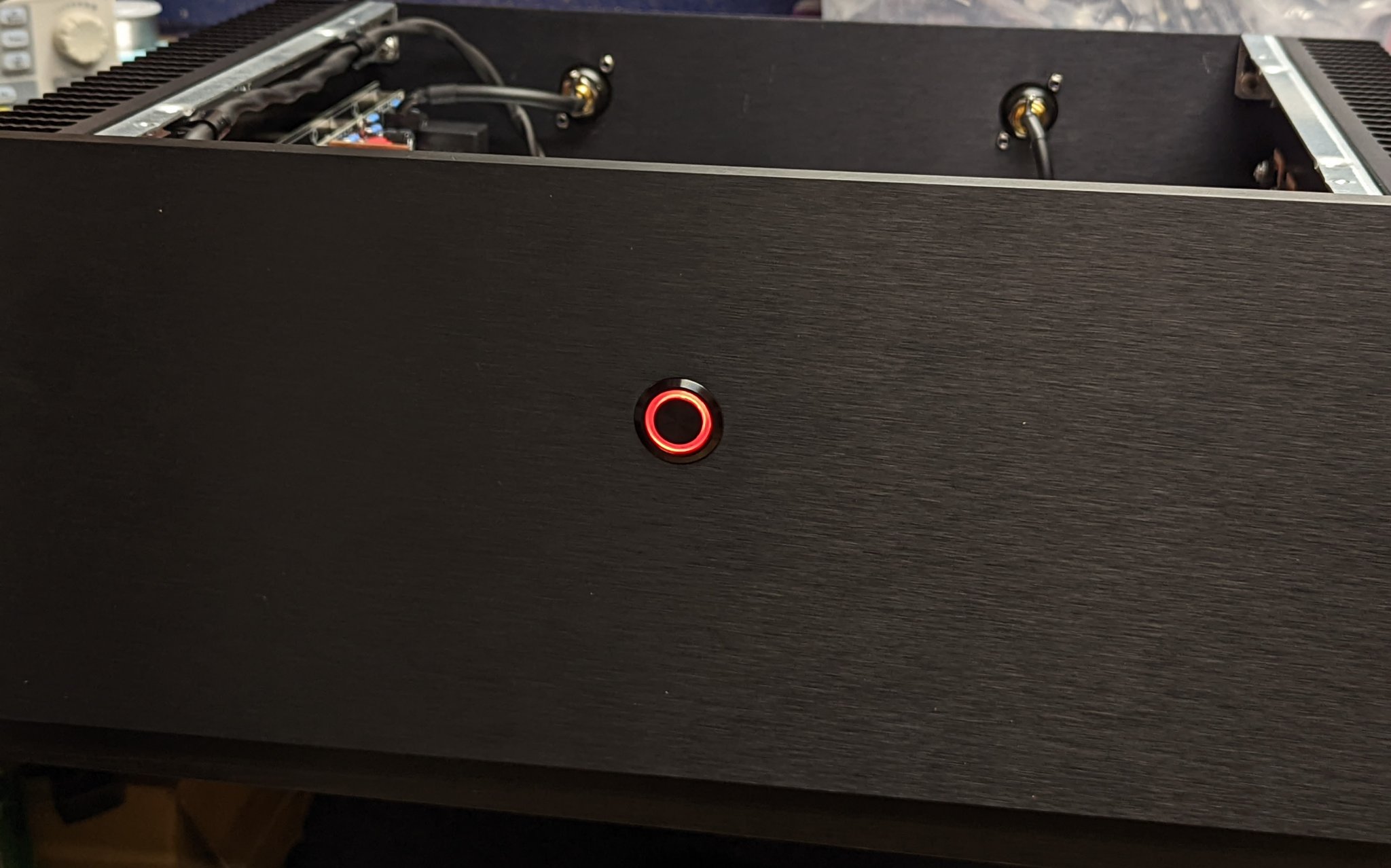

@fireanimal Do you have a source and part number for the power switch. That is exactly what I have been looking for.
Yep. Amazon. MGI SpeedWare Black Aluminum Push... https://www.amazon.ca/dp/B08FWWQC49?ref=ppx_pop_mob_ap_share
