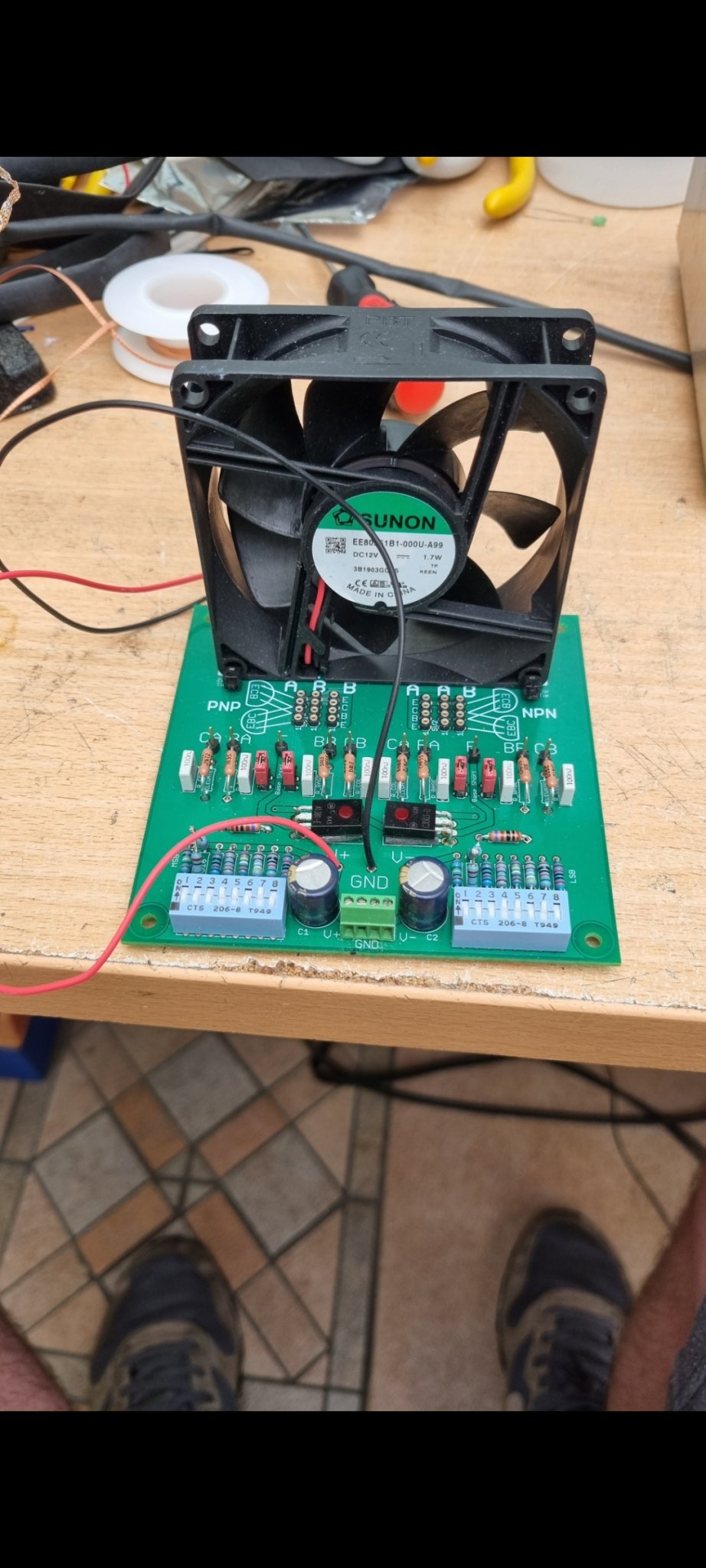

This is a bom of the most currently revised transistor matcher, hence, it will require modification based on the older version that I sold. For example, the dip switch required is a 6 position NOT the 8 position listed in this BOM, also you won't need to purchase all the resistors listed because of the 8 position dip listed in this BOM. So just subtract 2 of the listed resistors that are specific to the dip switch. Remember you can exclude the caps parallel to the precision resisters. The schematic attached is correct for the matcher board I've been selling
Should be on page 23. Used during testing without output transistors installed.
J103 is only installed when testing up to driver when the outputs are not installed. It is removed once the outputs are installed.

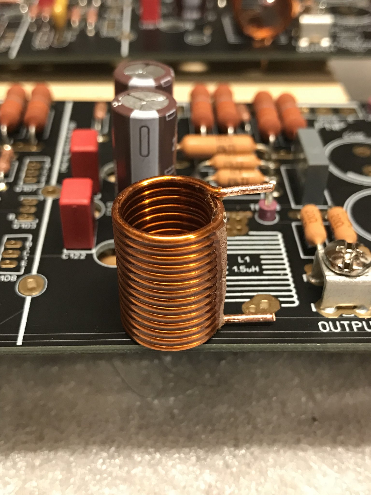

If anyone in the US is having trouble sourcing or making the inductor, I’m willing to make extra epoxy dipped coils for $10 shipped per pair. Pm if interested, I probably have enough wire for a dozen coils.
Dumb question, what is the proper name of the type of meter that can measure low inductor coils like these?
Any suggestions of a decent economical meter to do such measuring?
An LCR bridge is able to measure a coil.

LCR meter. If you follow the build guide on wire size and dimensions, you shouldn't need to measure them, they will be close enough. There are also calculators online for air core inductors, which calculate inductance by size/turns.Dumb question, what is the proper name of the type of meter that can measure low inductor coils like these?
If anyone's wondering what the updated matcher looks like, here it is.
