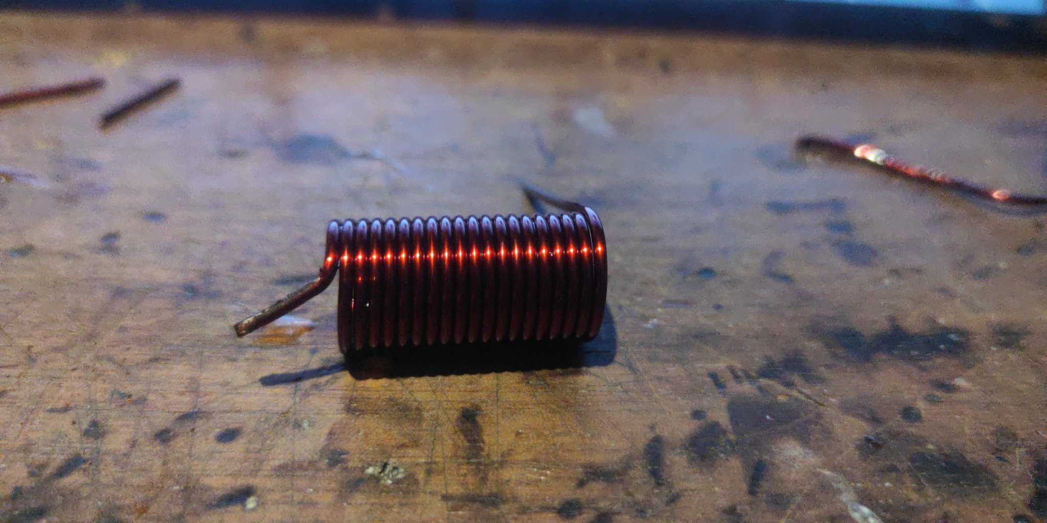

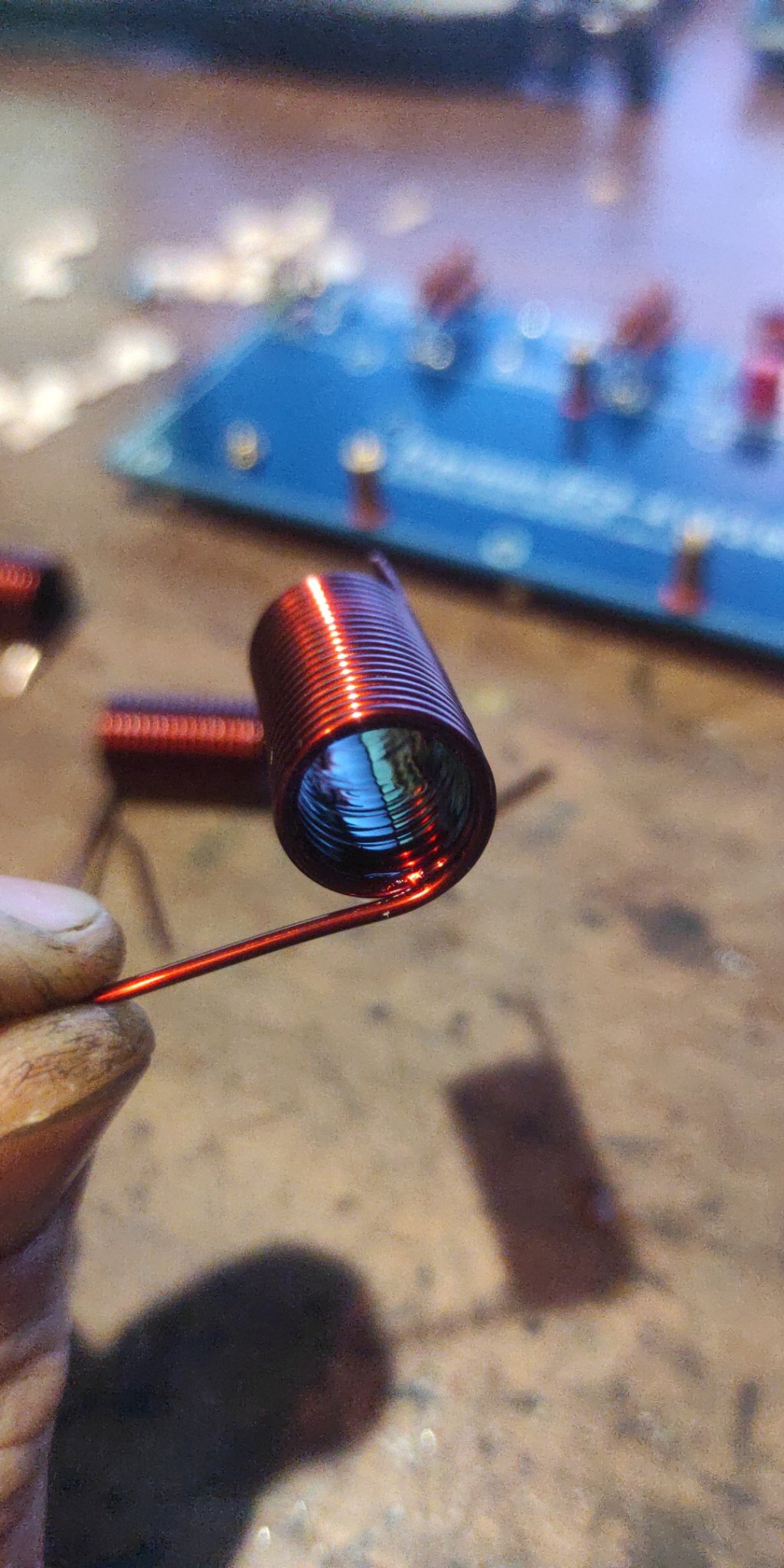

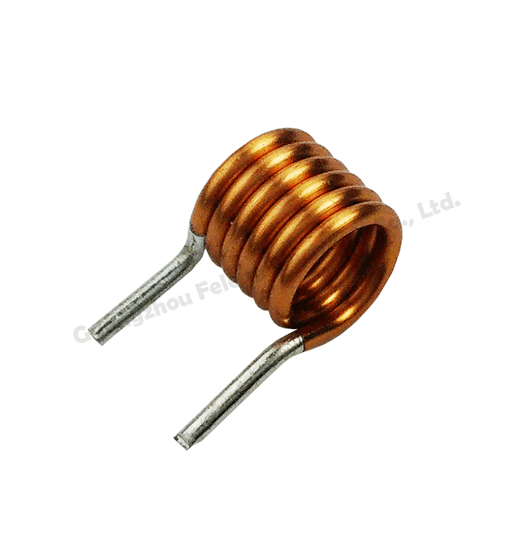

Does anyone know if I wound the output coils backwards here? urgh fail.
It looks like it but it will still work just the same.Does anyone know if I wound the output coils backwards here? urgh fail.

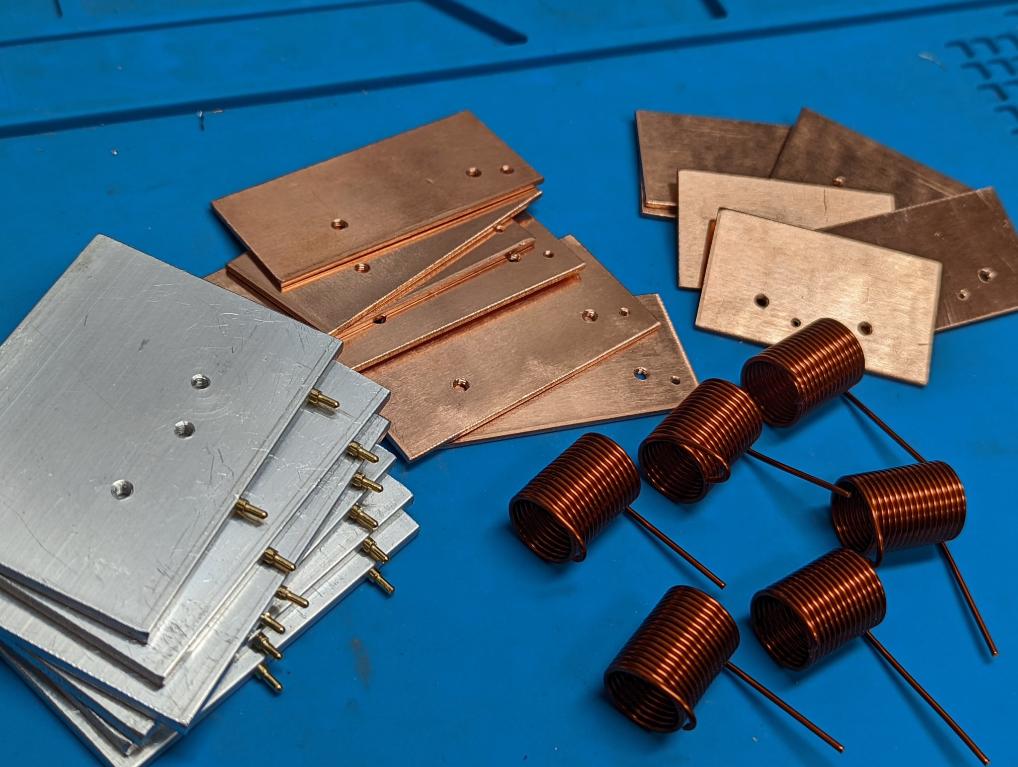

Spent today making all the heatsinks and winding coils. I remade the CCS/VAS heatsinks because I wasn't happy with the 1st ones. On a side note the pins for the driver heatsink are a tight fit, I had to use my drill press as a press to push them in, but that's a good thing as they will have excellent contact in the heatsink!

Clockwise is correct as noted in the BomDoes anyone know if I wound the output coils backwards here? urgh fail.
I am left handed and anti-clock is the only way I can wind the damn things tightly, but as @jjs notes, the inductance does not care.Does anyone know if I wound the output coils backwards here? urgh fail.
Maybe a close photo of the coil would help.
The reason I say clockwise is because the holes in the pcb are offset from the centreline of the inductor. Winding the inductor coil clockwise will enable it to fit easier.
The other holes in the PCB on the centreline of the inductor are if people want to run their zobel resistor through the centre of the inductor above or below the PCB.

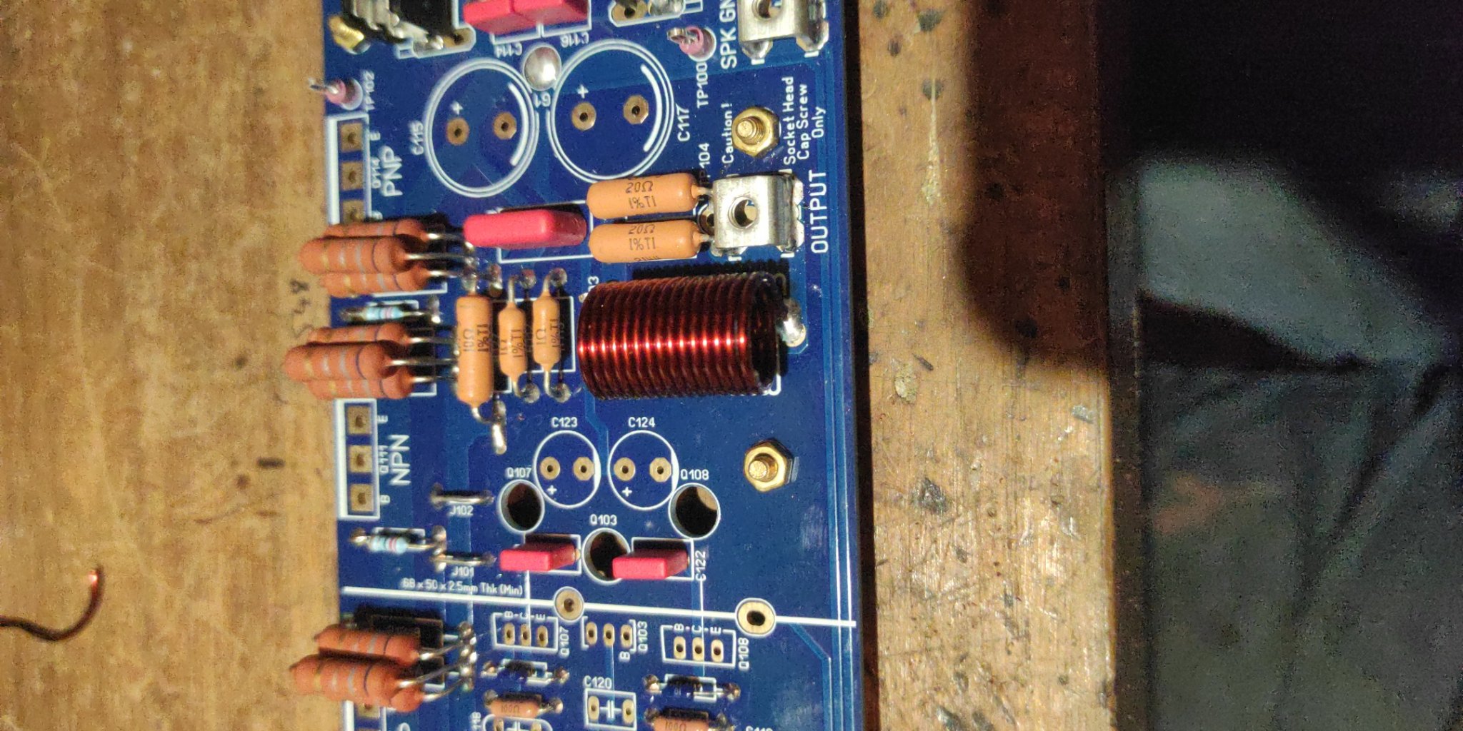

Here is mine I just started, letting glue set before I make them the correct size tonight.Here is a couple of photos of mine if it helps
Clockwise wound

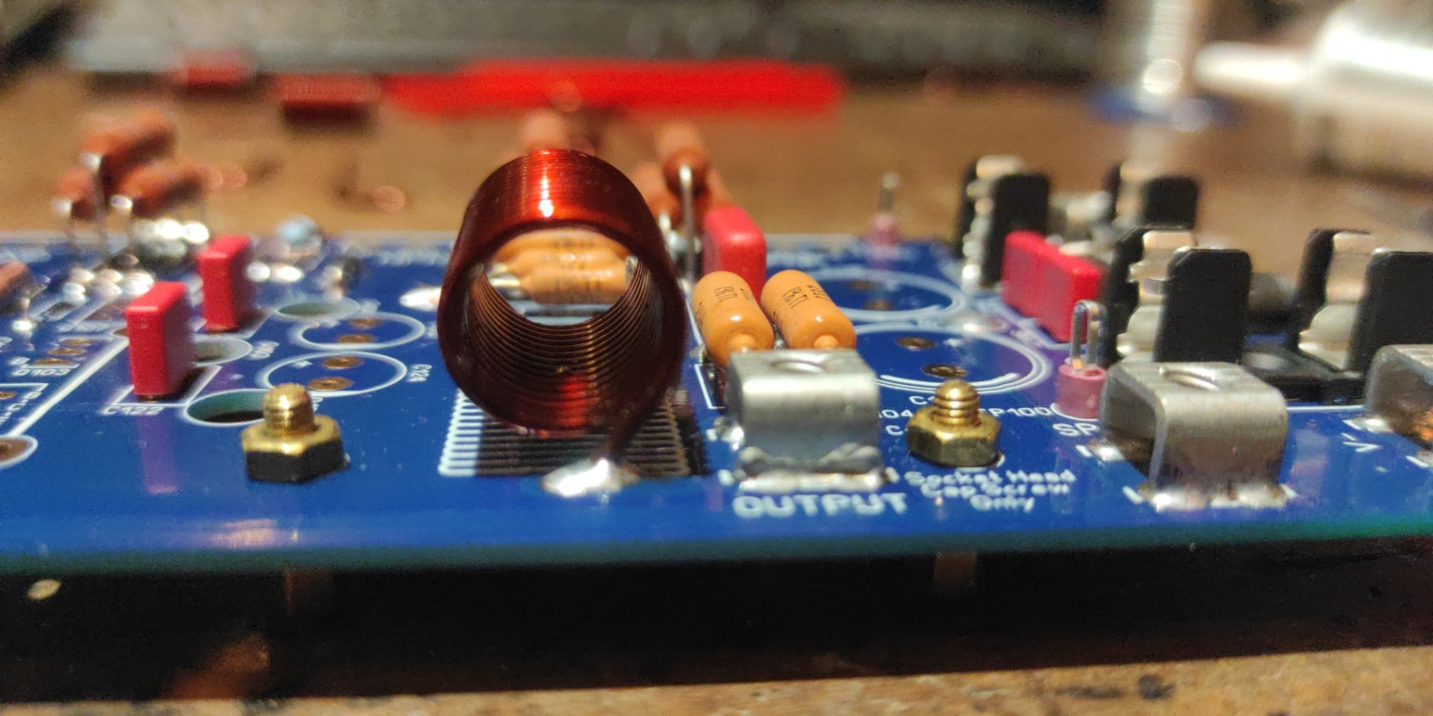

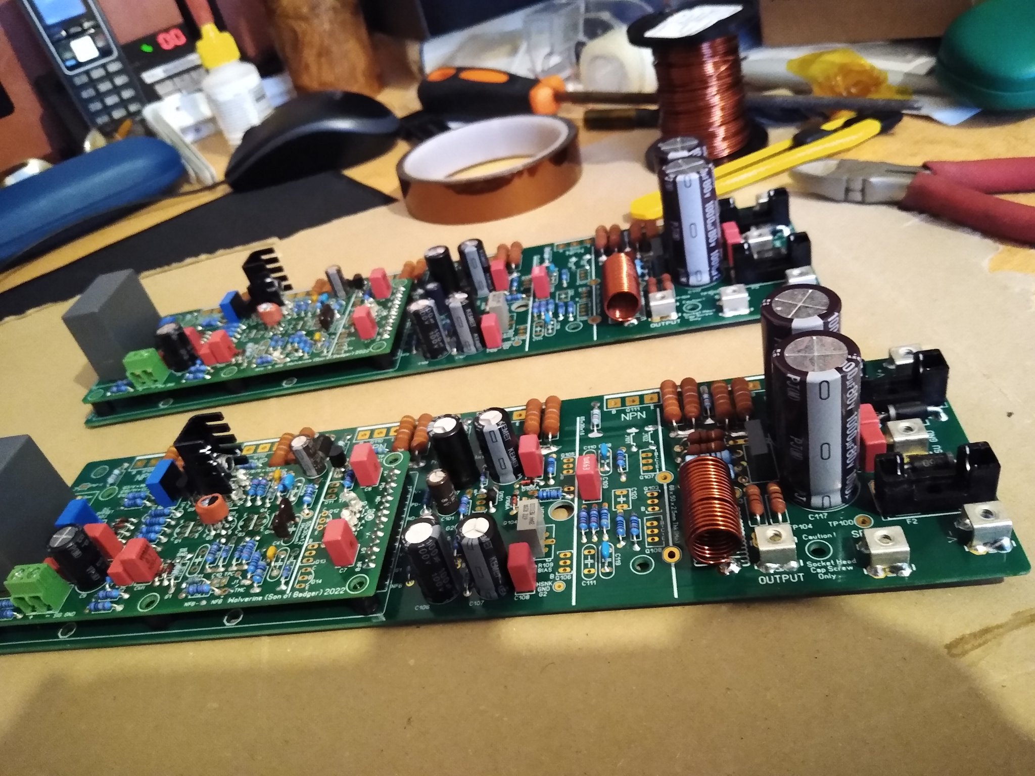

Installation of my output coil,
1.3mm wire.
Used mobile phone style clear glue for the inside to hold it together.
PCB standoffs and nuts etc are temporary until proper bolts and bits arrive.
Waiting on some transistors before I finish the board.

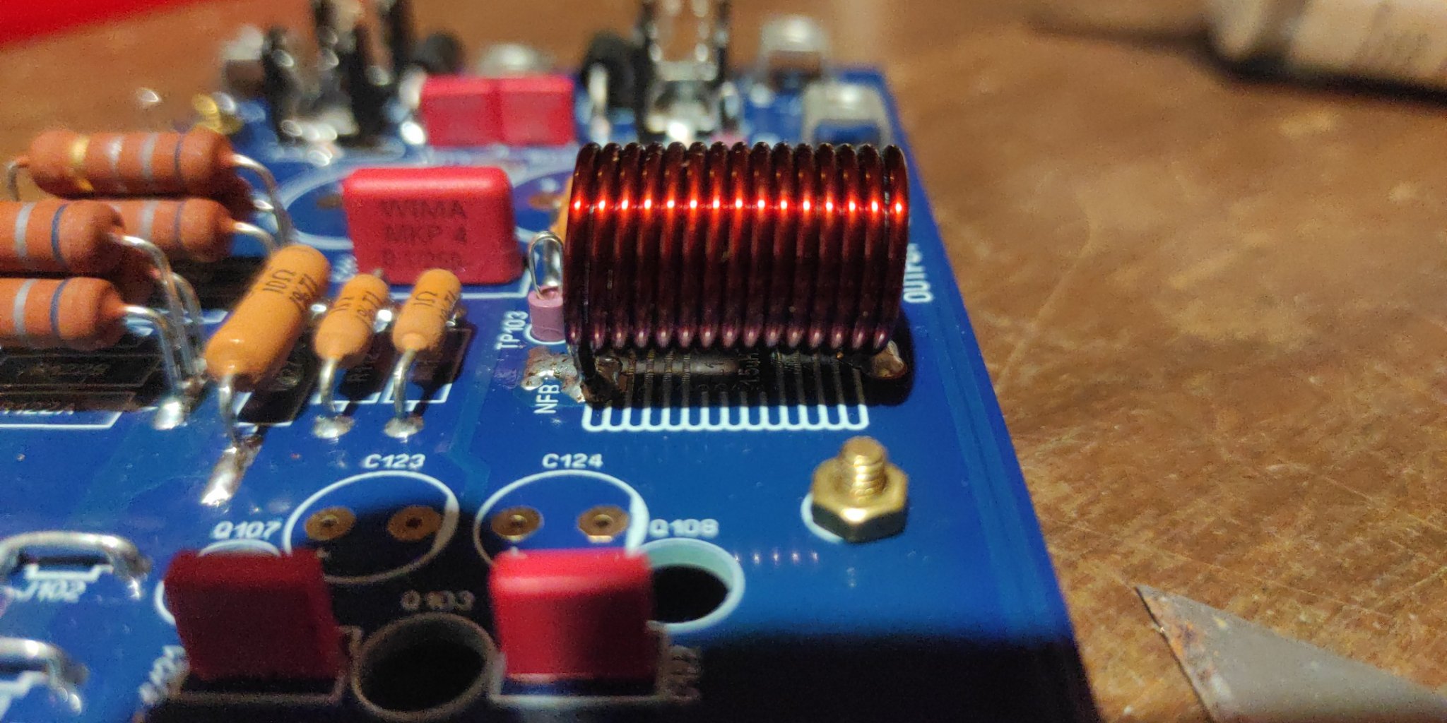

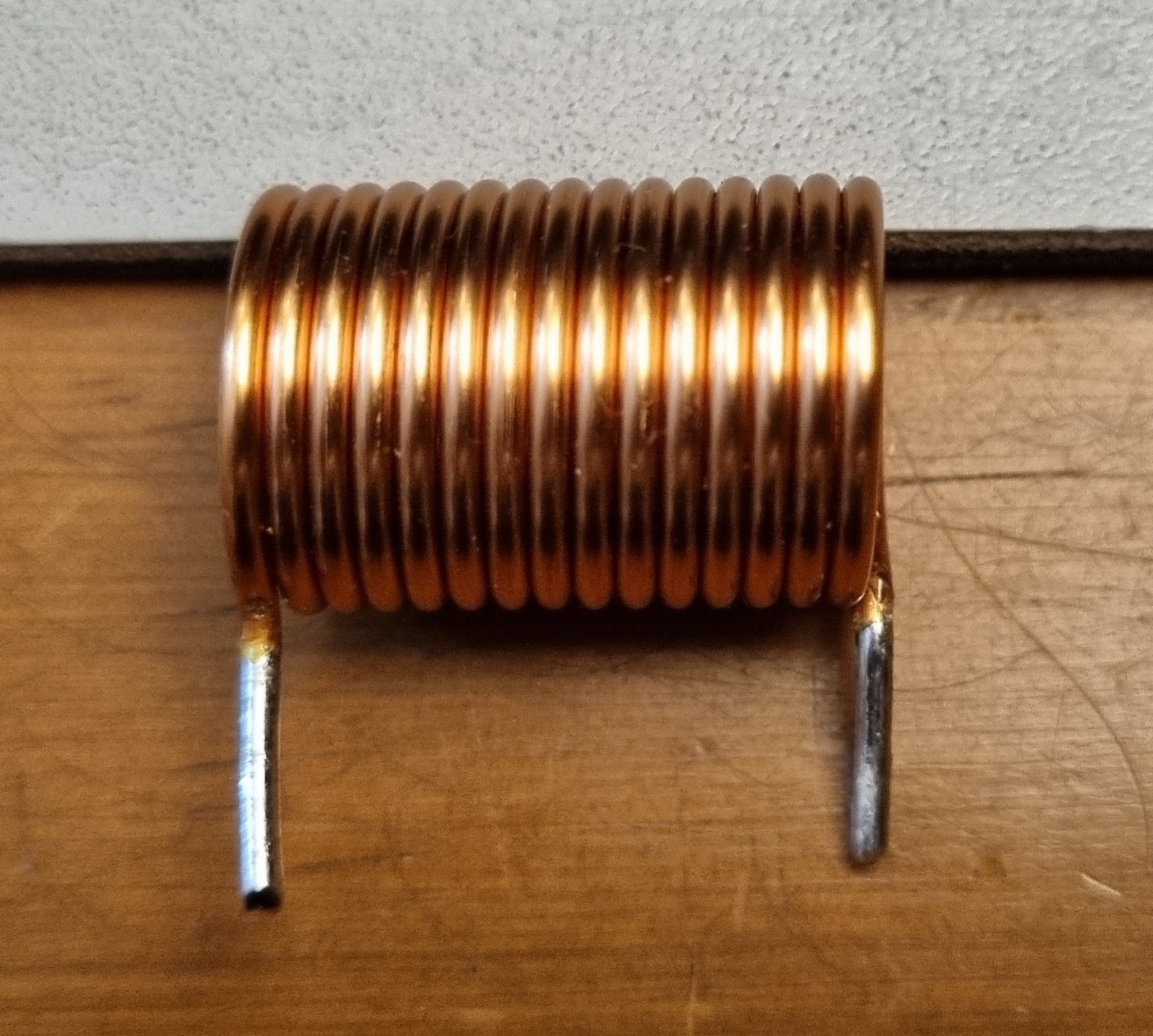

My 14 turn coil turned out well I think
1.3mm wire.
