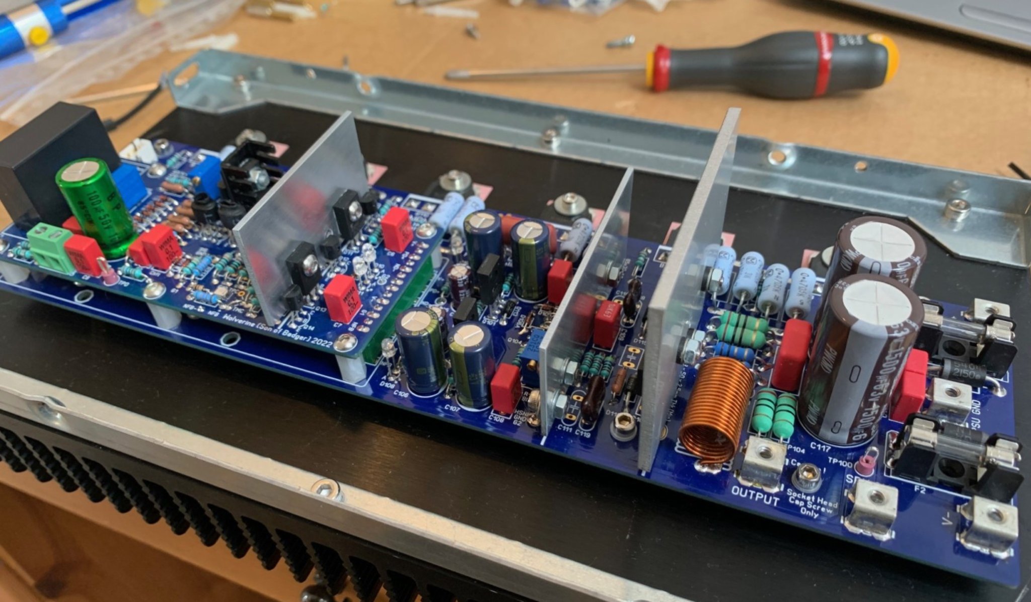

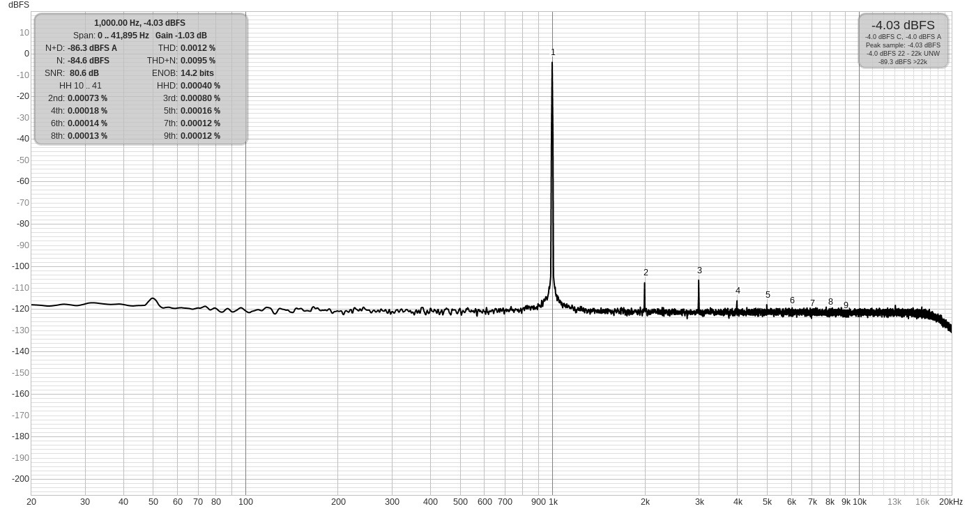

I have one channel up and running. I finally decided to put Q104 on the heatsink. When mounted on top of Q113 the bias dipped below 20mV after a high power episode. With Q104 on the heatsink the bias seems more stable, but I might be wrong. I also used a TTC004 (fully isolated package) instead of the recommended MJE340. Everything seems to work fine. The measured THD at 1kHz, 25W and 4ohm is below the distortion of my test setup.

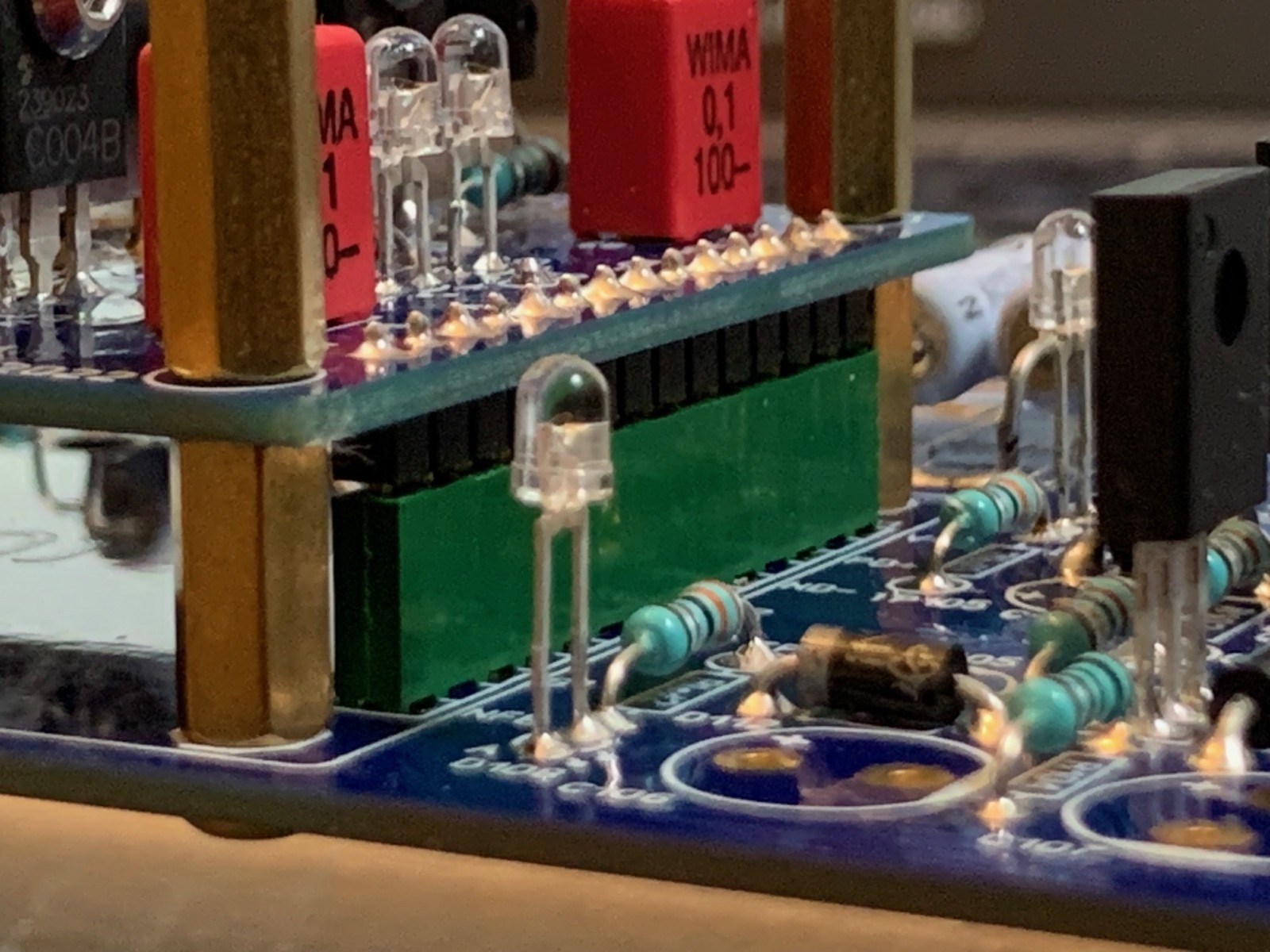

By the way, I used an alternative for the male and female SIP1 connector that can be used with 10mm standoffs and which can easily be sourced from other suppliers as well. The female base is the TE Connectivity 1-215297-4 (for example Farnell Ref. 3398239) which has a height of 7mm and accepts 0.63mm square pins.The male pin connector is the Samtec TSW-114-07-G-S (for example Farnell Ref. 2856753) which has a base of 2.54mm and square pins of 5.84mm length. Both are gold plated and readily available from other suppliers. As you can see in the image they are a perfect match with 10mm standoffs.

Not sure, you may have missed the 10mm option in the BOM;
Also I would NOT be switching the MJE340 for the TTC, RCC is fined tuned for the MJE340, and you could introduce a lot of error in the bias spreader.
Alternatives for 10mm standoffs ====> | 14 Position Pin Header Gold (Male SIL) for 10mm standoff | Round 575-8001001410001000 | ||
14 Position Female Gold socket for 10mm standoff | Round 437-8018301410001101 |

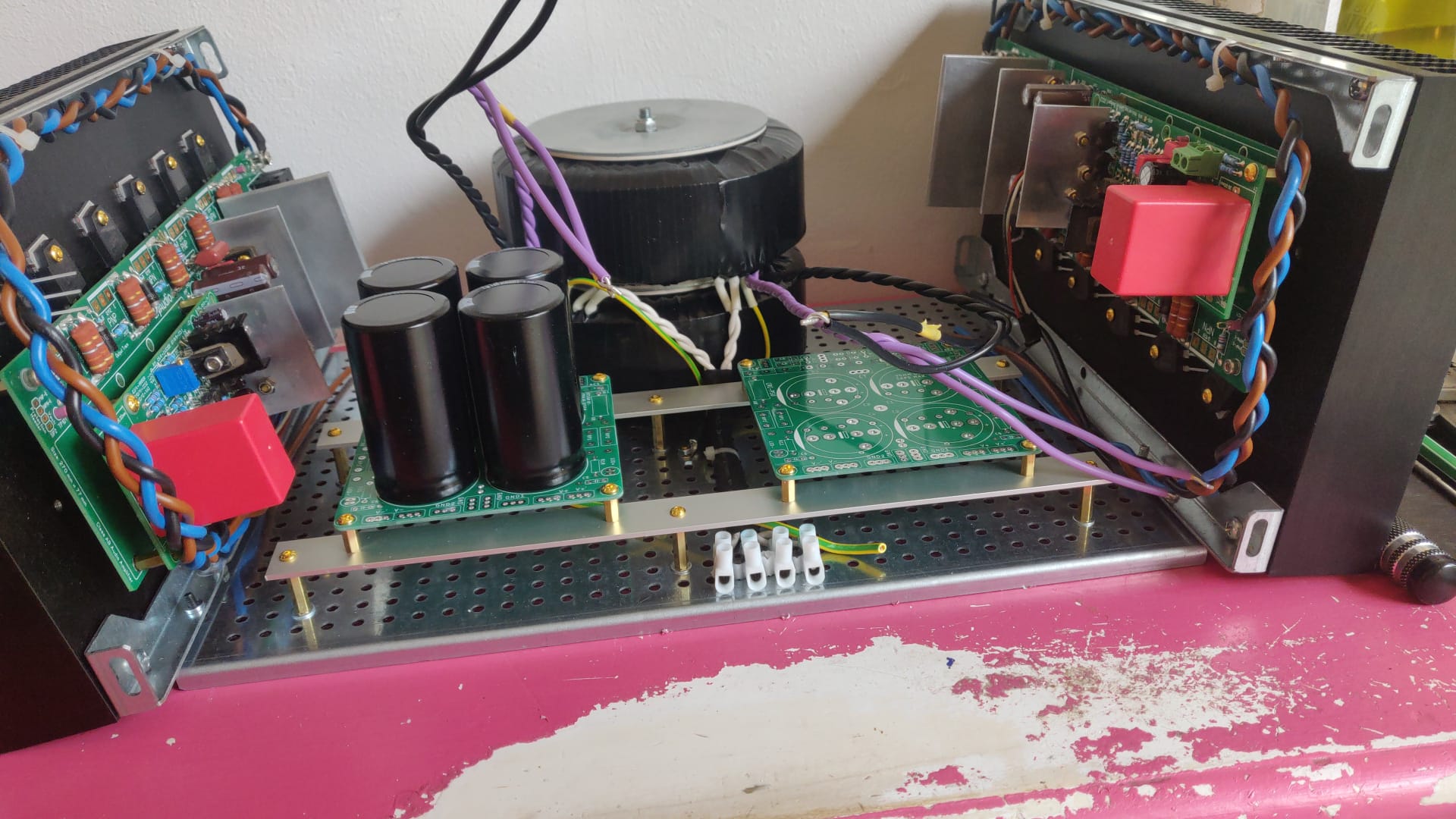

I have a 600VA 4x38Vac transformer which gives me +/-55V. That is why all my caps are 63V.

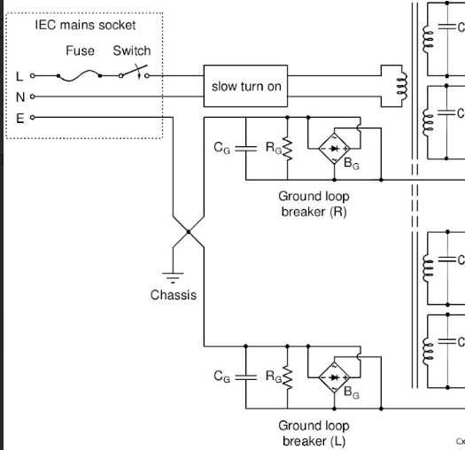

Earthing question. I'm using the groundloop breaker circuit of Rod Elliot. My toroidal transformers have there own ground wire each. Do I connect them directly to the chassis or to the groundloop breaker and then to the chassis like all the others?

The wires from the transformers are not grounds, they are screen wires, and should be directly wired to chassis ground.
THD1k 0.0012% and SNR 80dB is not good. Is it a measurement problem or something else ?The measured THD at 1kHz, 25W and 4ohm is below the distortion of my test setup.
Absolutely a measurement problem. Forgive me, I should have mentioned that this is not an accurate THD measurement of the Wolverine, but only a test to see if the amplifier works as it should. After building several tube and Pass amps, I had not yet achieved such a low THD measurement at this power level before...
For the anecdote, I can even tell you that I completely fried those beautiful resistors in the Zobel network in a moment of inattention when I connected my test equipment without a proper signal ground point. In a split second, amp went into oscillation and my oscilloscope went wild, mains fuse blew and that distinctive burning smell that all electronics DIYers know all too well. No harm done. I replaced the resistors, attached a proper ground and everything worked fine. Moral of the story : buy some extra resistors in advance and don't trust my measurements.

Please see Post #1 of this thread for measurements taken by me please.THD1k 0.0012% and SNR 80dB is not good. Is it a measurement problem or something else ?
