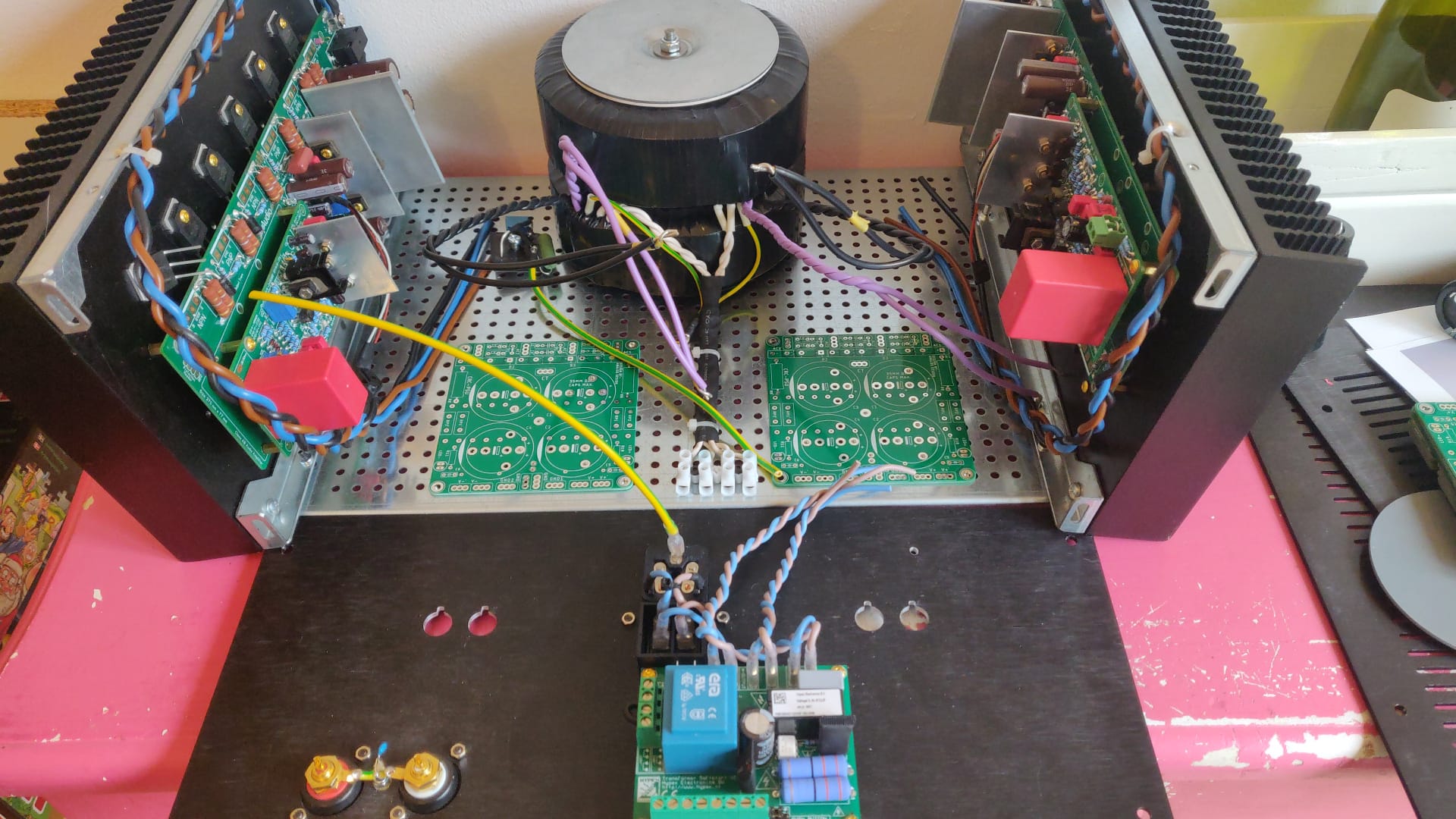

I have soldered prasi CRC power supply which is going to be used for powering up W. Can I ask questions here re connections and wiring or I d better going to the power supply thread (which I think is a bit of a mess due to the large number of different circuits designs in there) ?

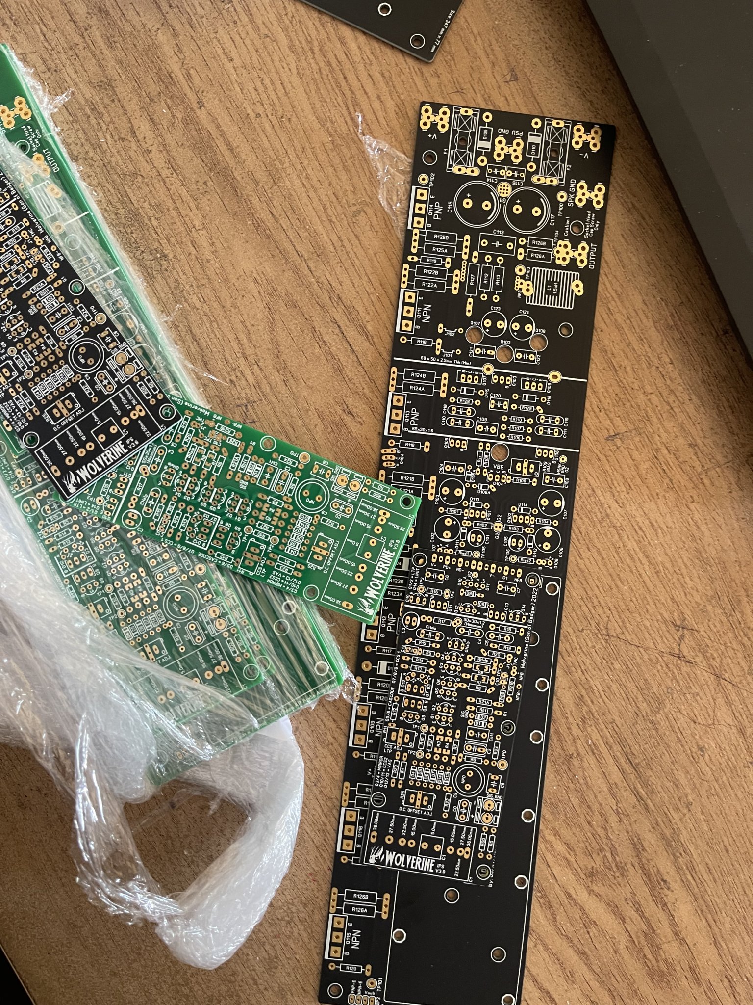

Yes I received mine few weeks ago and all was very well packed! So all boards arrived in very good condition. I must say, as stated by other before the pcb's are of very good quality! Also received PSU boards from the diy store and also those are very high quality.Hi Guy's, has everyone received there boards now and were they received in good condition?

Same here. Boards were well received and they are of very good quality. It is also clear to me that a lot of thinking went into this layout. For those who prefer to design their own pcb layout I would say, go ahead, have fun, learn a lot, but you probably end up buying those beautiful boards anyway. At least I did and I don't regret it (yet).
Yes I have received mine few days ago. I had a huge delay the boards took five months but finally got here undamaged not even a single scratch. Big thanks to you Mr Stuart for your undying support throughout this long five months.

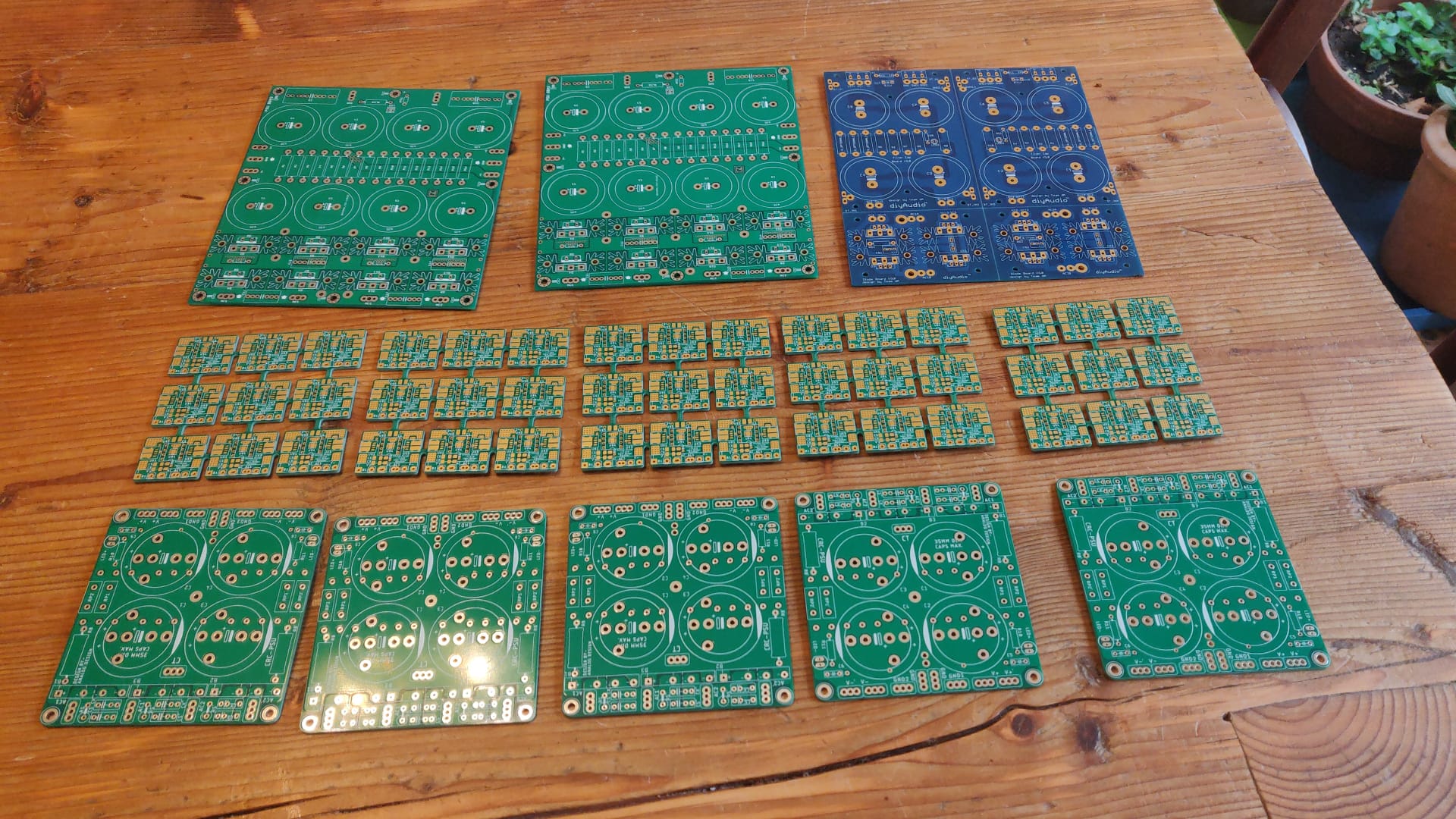

Hello gents....a few boards have arrived the last couple of weeks. I'm planning to use the Prasi boards with the dual channel fet LT4320 daughter boards and if that doesn't work for whatever reason I will use the standard fullwave bridges.
I've got way too many boards and some boards still need to arrive. I could spare a few.
The CRC-PSU boards from Prai on the picture is with 1 oz copper. The ones yet to arrive have 2 oz copper.
As for the questions. Well thats about the ground and ground breaker positioning points in the chassis. Does it really matter as long as I keep one of the main rules in mind to have one and only one central ground?
