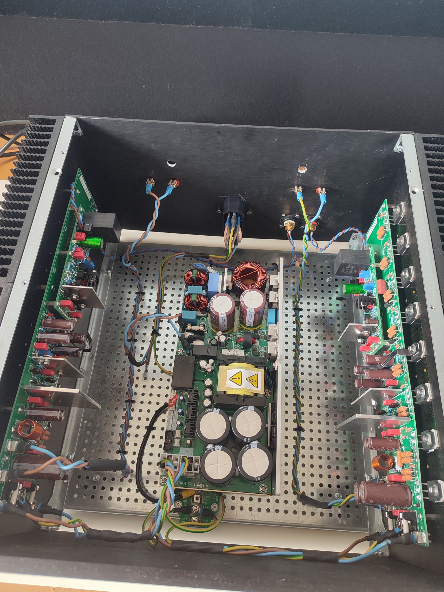

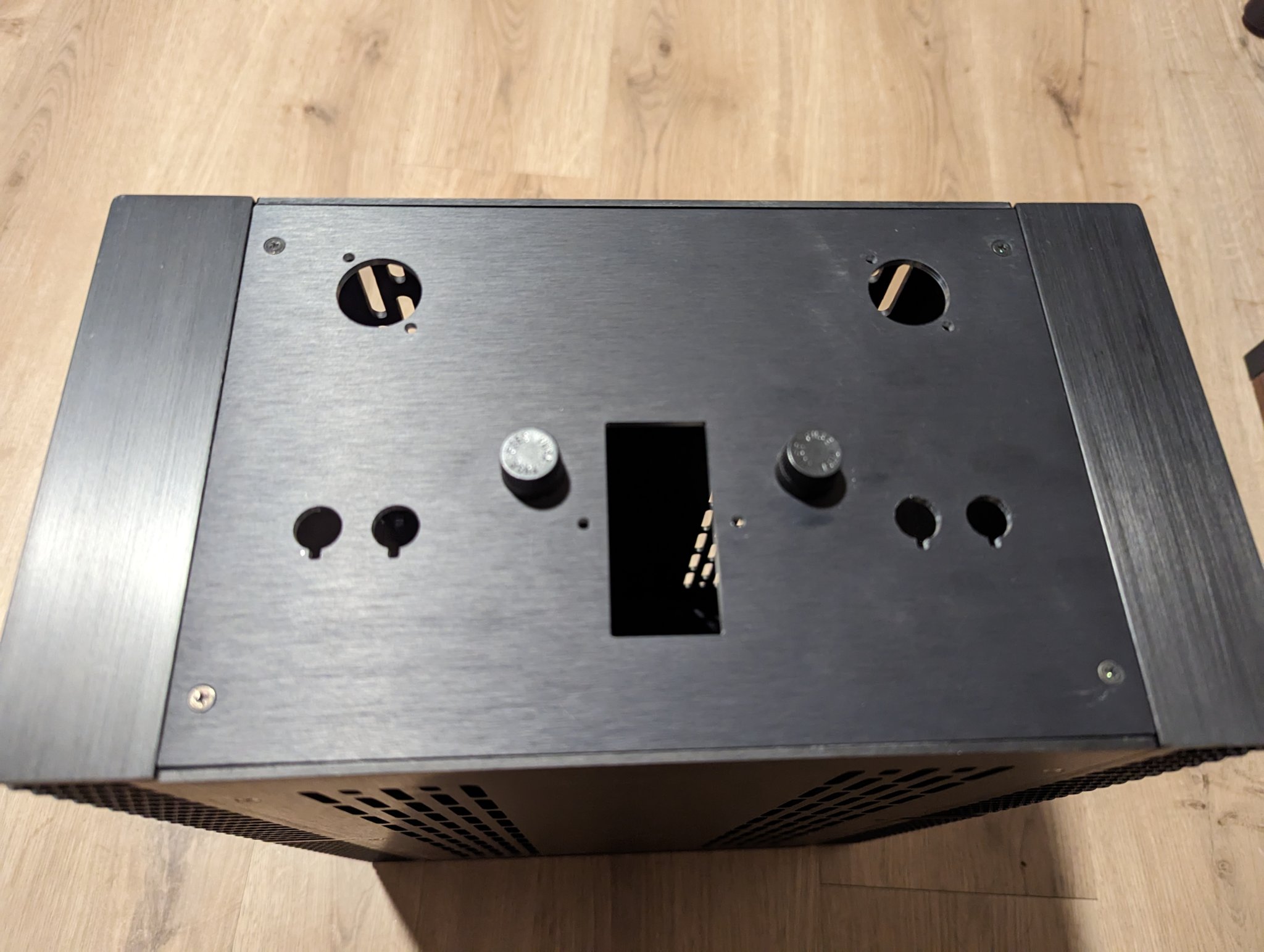

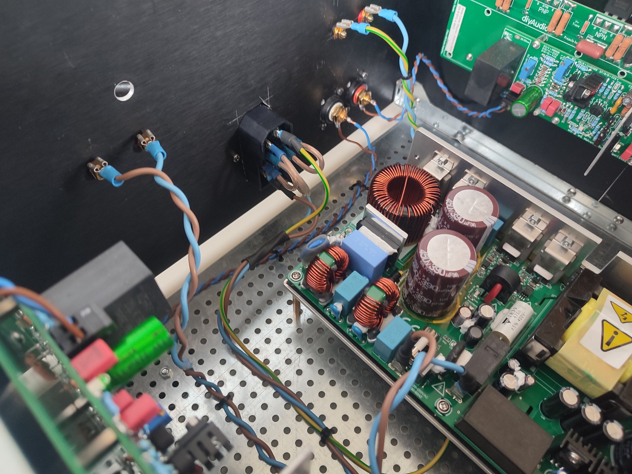

Here are a few pictures as promised.
In the rear plate are unfortunately two holes too many. I have only later read that the inputs should be close to each other. There are maybe 1-2 things that could be improved. But I am also as I said 100% satisfied.

I don't know if I'm allowed to post the picture. It is on page 63 in "How to wire an Audio Amplifier". I didn't do it that way either, but I had the option to do it later.
On page 38 it says: The left and right RCA receptacles on the source and receiving equipment will bemounted next to eachother–again, in the interests of minimizing the inter-channel loop area. The signal grounds of the RCAinput sockets are BONDED TOGETHER. The sockets are insulated from the chassis to prevent an internalground loop
Reactions: 1 users
And: use one ground-connection only, one "ground-wire" only.

In my opinion, No.
Use your backplate as is, especially if your building an amp with a dual mono power supply. I haven’t had any issues with input sockets that are not next to each other.
