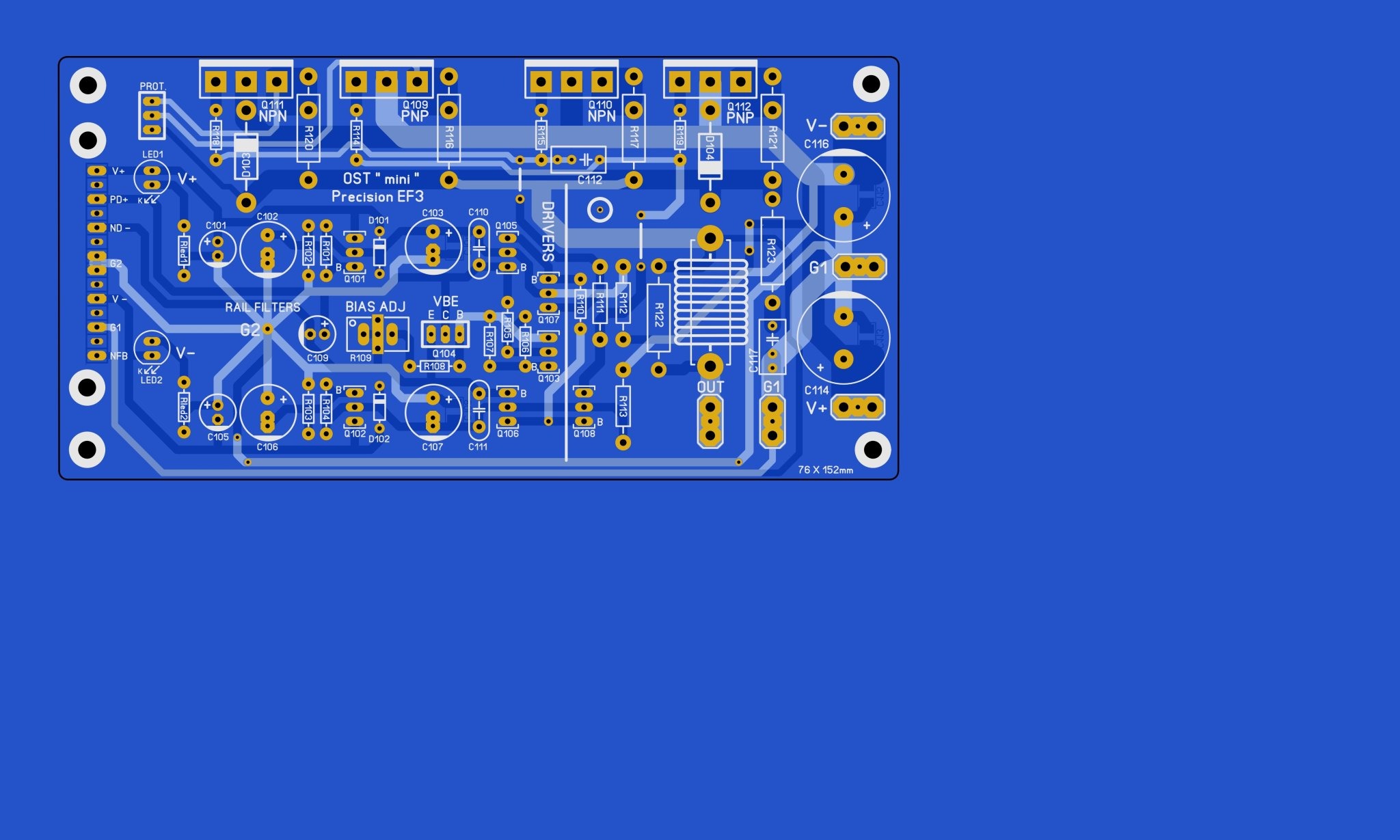

I only have a 300VA toroid , 4 X 6800uf caps, and a single 25A bridge on hand. I had to make a smaller OPS.

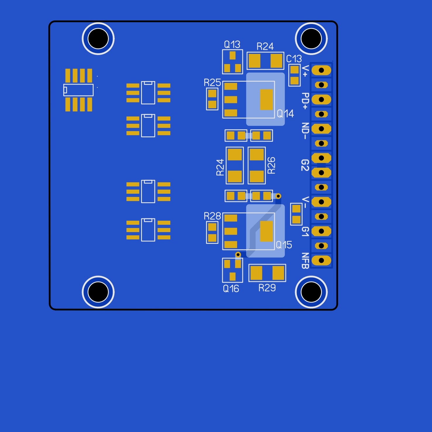

A spinoff of my designs is the fact there will be 3 new SMD IPS's soon. All compatible with any of these OPS's ....
I just loved to see all the joy of everyone's fanaticism in building these Wolverines. I even changed some things in my designs going by what I
read here (10K + 390R FB+input Z).

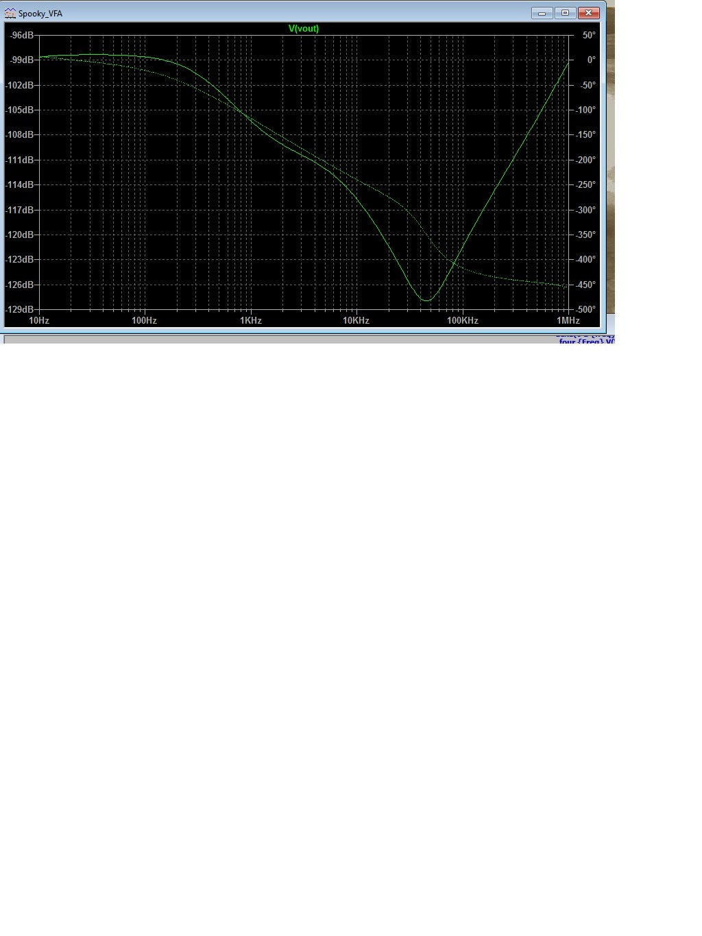

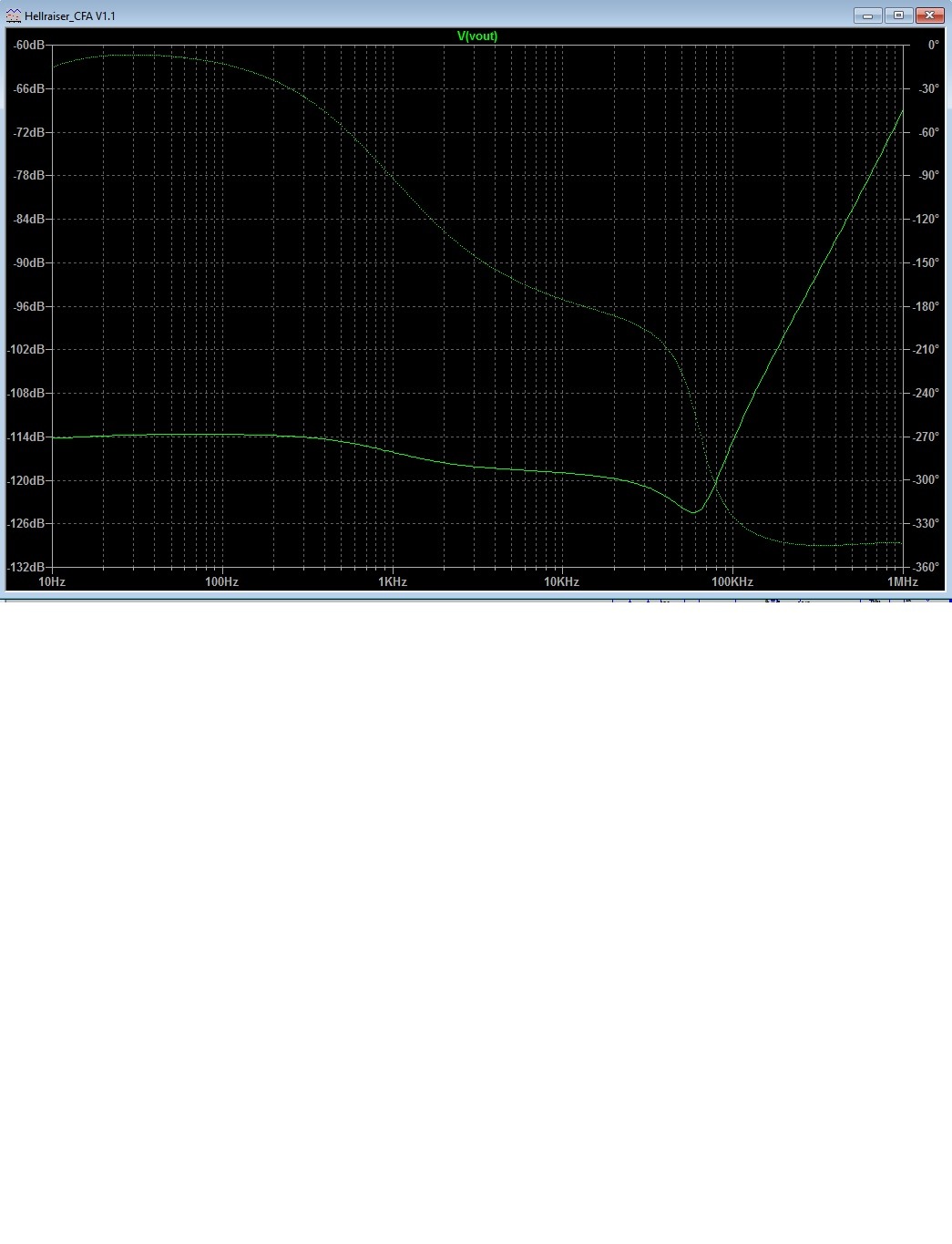

Yes , the PSRR is more important to me. Running many channels off the same supply.
Notice ( below 1) where the most cancellation is at 40-70Khz. This design was made for SMPS's.
I saw your test of the Wolverine and the switching peaks at 50 + 70khz. CFA (below 2) does the best in the bass realm.

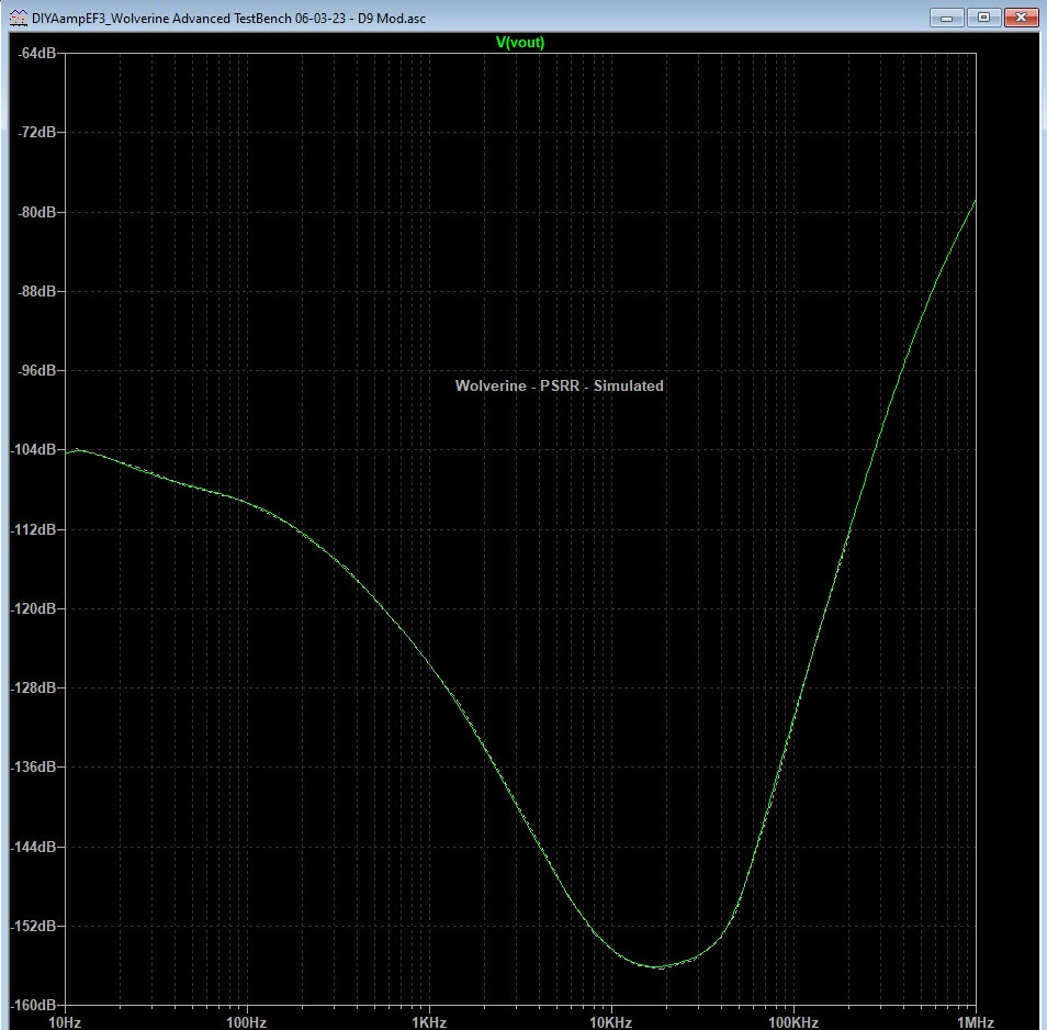

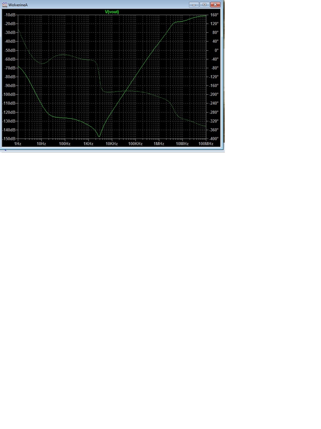

Oh , yeah . Wolverine PSRR is pretty good. Needs those real big ripple filter caps. But it is not a symmetrical design , less bass
and HF cancellation. Most builders use huge separate filters or even dual mono - should be good .
If you regulate the cascode and LTP CSS on the Wolverine , it can approach -110db - 20hz to 100khz.
Hi OS, please ensure that you enter the ESR into all of the capacitors in your simulation otherwise your simulated PSRR maybe out.
ESR and serial resistance is added. You can also simulate the phase differential of the ripple source.
If you read the Cordell and Self amplifer books , they admit a single ended VAS (CCS) based design has a slight PSRR "hit".
It is what it is !! That's why you don't run multiple Wolverines off the same PS.
The positive is that the Wolverine has obscenely low THD 1K - 20K.
At 20Hz , the symmetrical designs rule. Even in THD - at high powers.
see the PSRR at around 1K , that is why Fireanimal can get -150db THD.

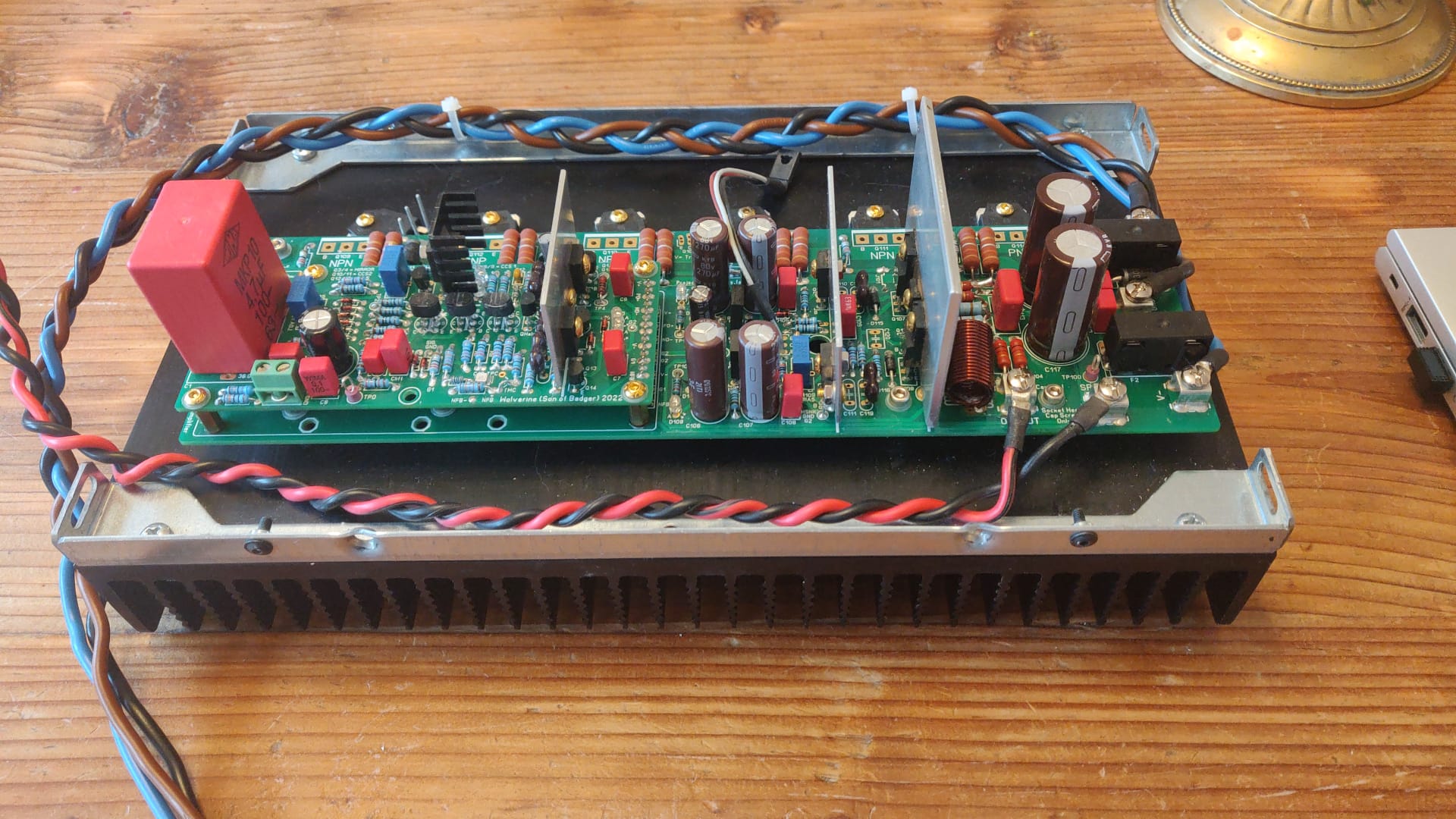

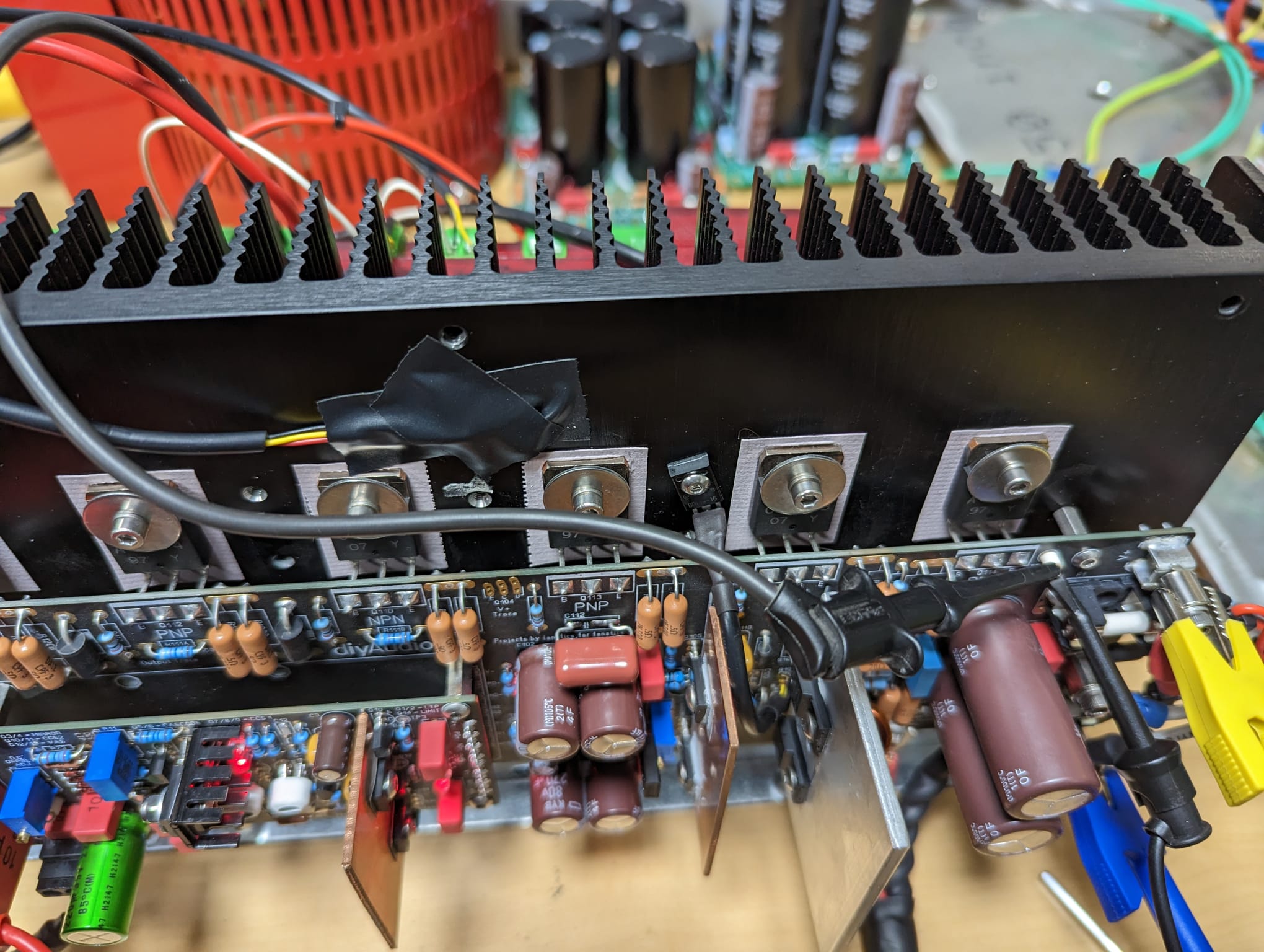

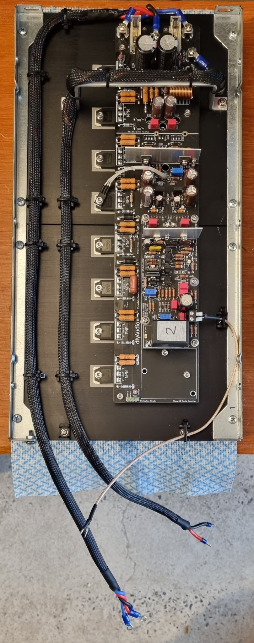

Hello Gents,
Did a lot of reading on wire postioning including the Wolverine docs. I understand most of it but stil have a simple question. Would it be better to route the power cables together with the speaker cables or leave a bit of space (like in the pic) between them?
thx

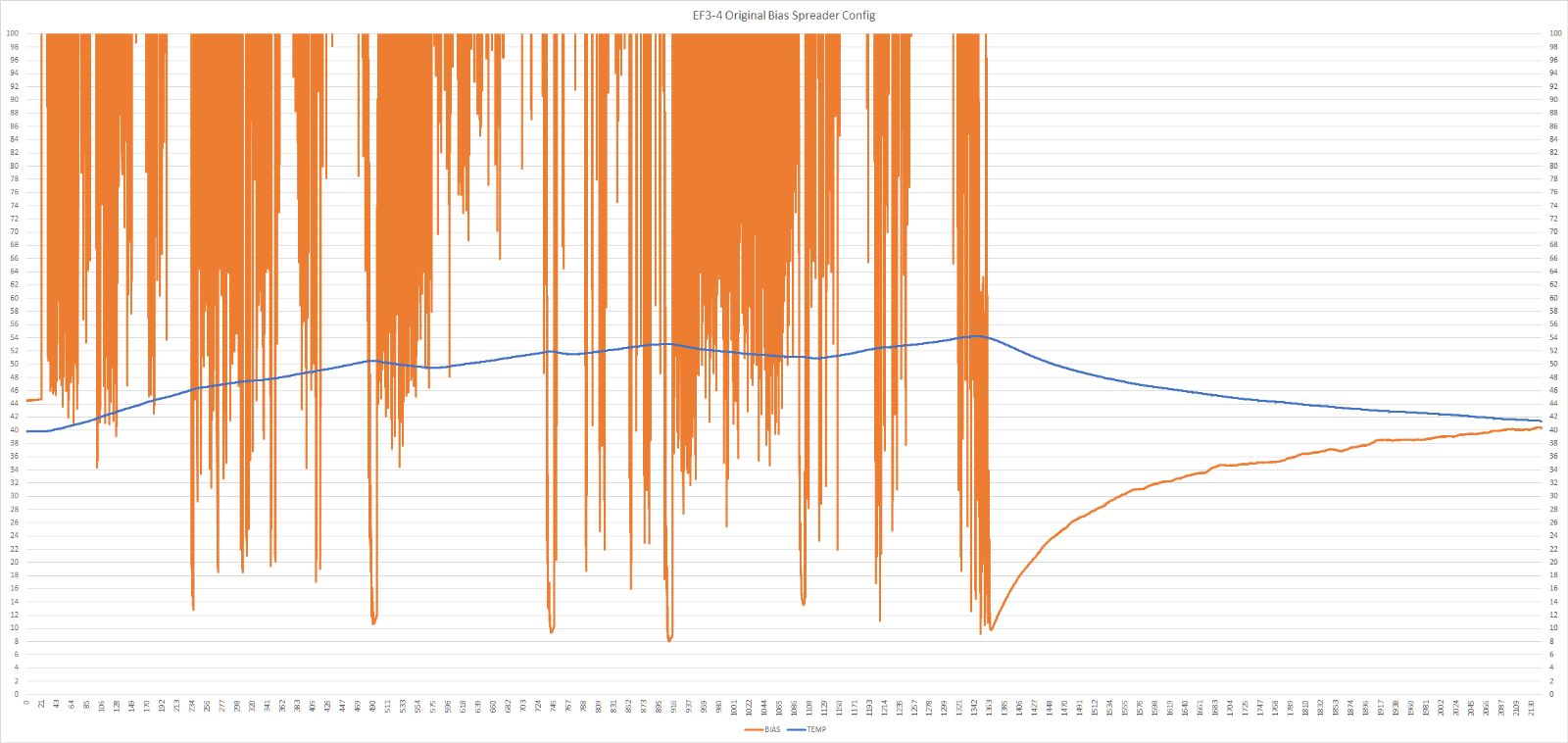

We have scrutinized the original bias spreader implementation, and completely overhauled it. After many implementations and bench testing various combinations of resistors and transistors, both the EF3-3 and the EF3-4 have been reworked and new modifications / values available. The modifications are easy and straight forward.
During the re-design it was decided that the original MJE340G was no longer going to be used, due to the fact they are not binned and there is too wide of a gain margin in those parts, resulting in too many values for RCC and potential mismatch and non-linearity if the wrong value for RCC was chosen.
The new transistors for both Q103 and Q104 are readily available, and tightly binned. Q103 and Q104 are swapping duties in the process, which allowed for way better tracking of both the heatsink and ambient temperatures. Q104 is now mounted on the PCB, and Q103 on the EF3-3 is mounted via lead wires to the heatsink holes beside the output transistors. On the EF3-4 it will be mounted under the PCB between the drivers on the main heatsink.
Testing was done with different combinations of drivers and outputs, while bias and heatsink temperature were monitored and logged in real time. We used both static and dynamic testing to confirm the results and that we had no thermal runaway, but the bias was also not dropping below a comfortable level. We were aiming for close to 0 but slightly negative bias vs temperature response, which was achieved on both the EF3-3 and EF3-4. The static test was 200 watts RMS into 4 ohms, and the dynamic test was a short playlist plated at maximum level into 4 ohms.
These results and the final outcome were not something that could be solved with simulation easily, and only with bench testing and real world results, could we fine tune the simulation and calculations to provide accurate and repeatable results.

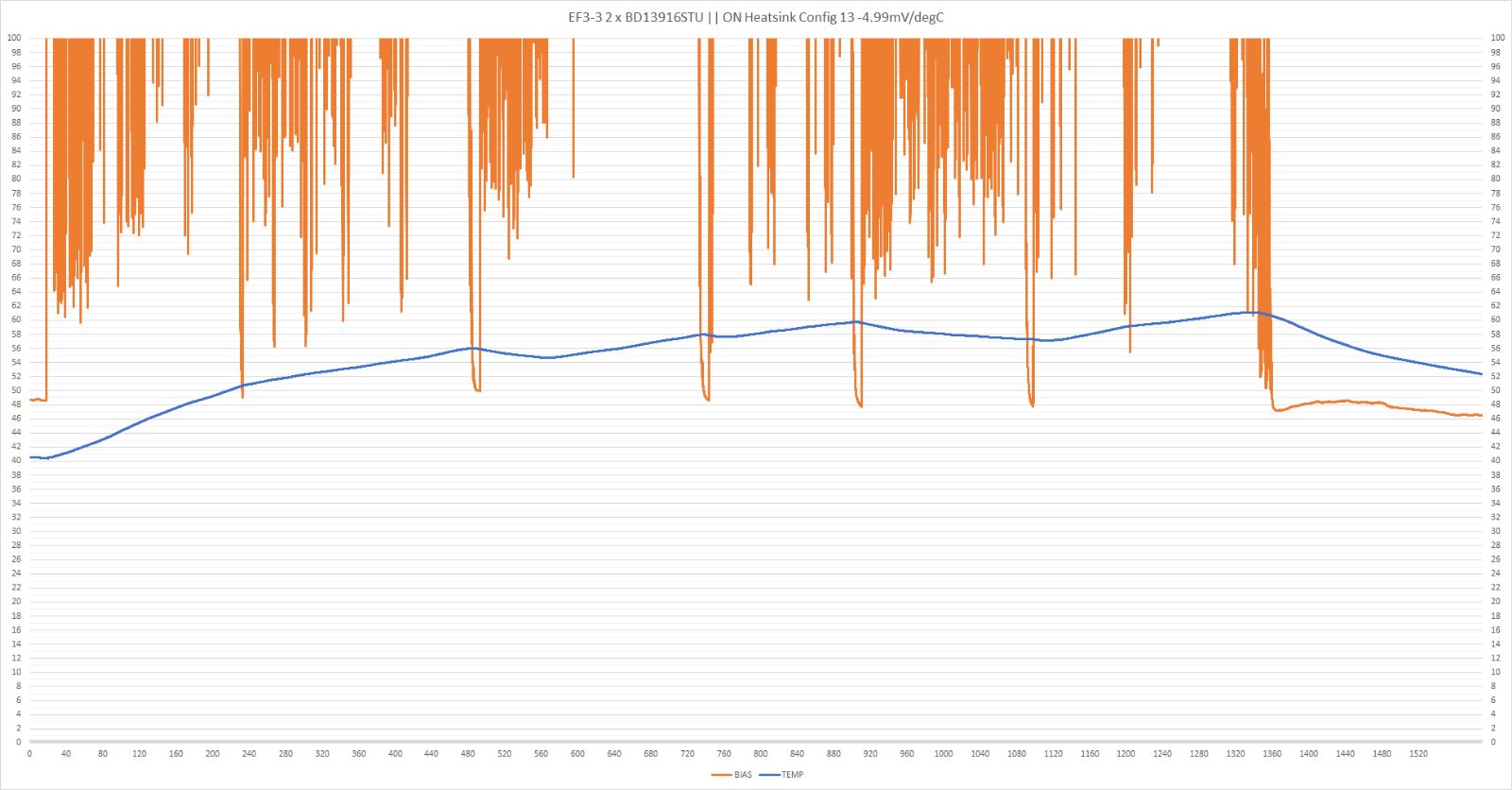

EF3-3 Original -3.25mV/°C​
Left Y axis is mV and the Right Y axis is heatsink temp °C. Bias drops between tracks and transitions during the songs. With the bias dropping as low as 8mV.
EF3-3 After -0.068 mV/°C​

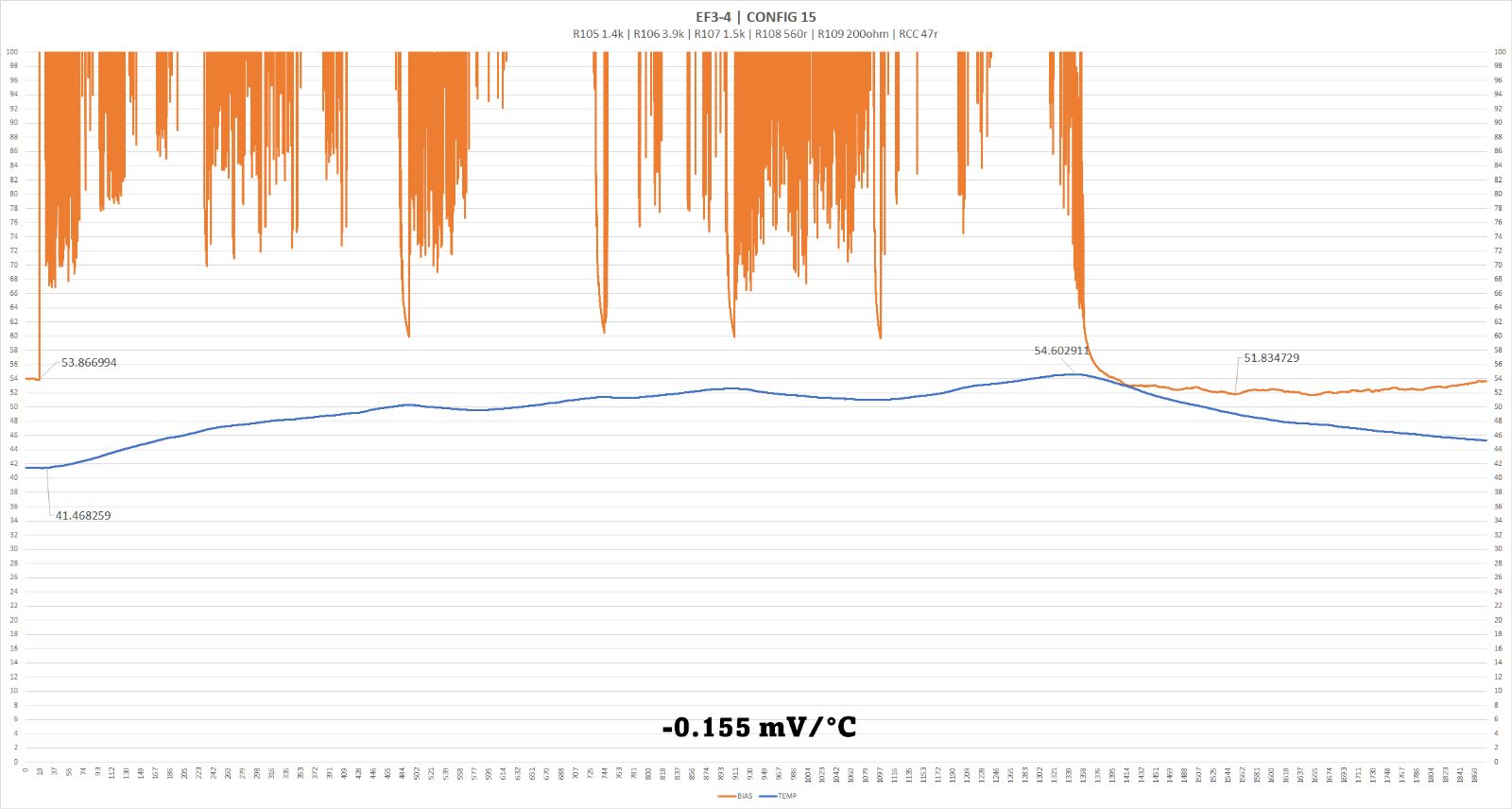

EF3-4 Original -2.415 mV/°C​
EF3-4 After -0.155 mV/°C​
We can see again a great result with the modifications on the EF3-4, with the bias holding up during all transitions.

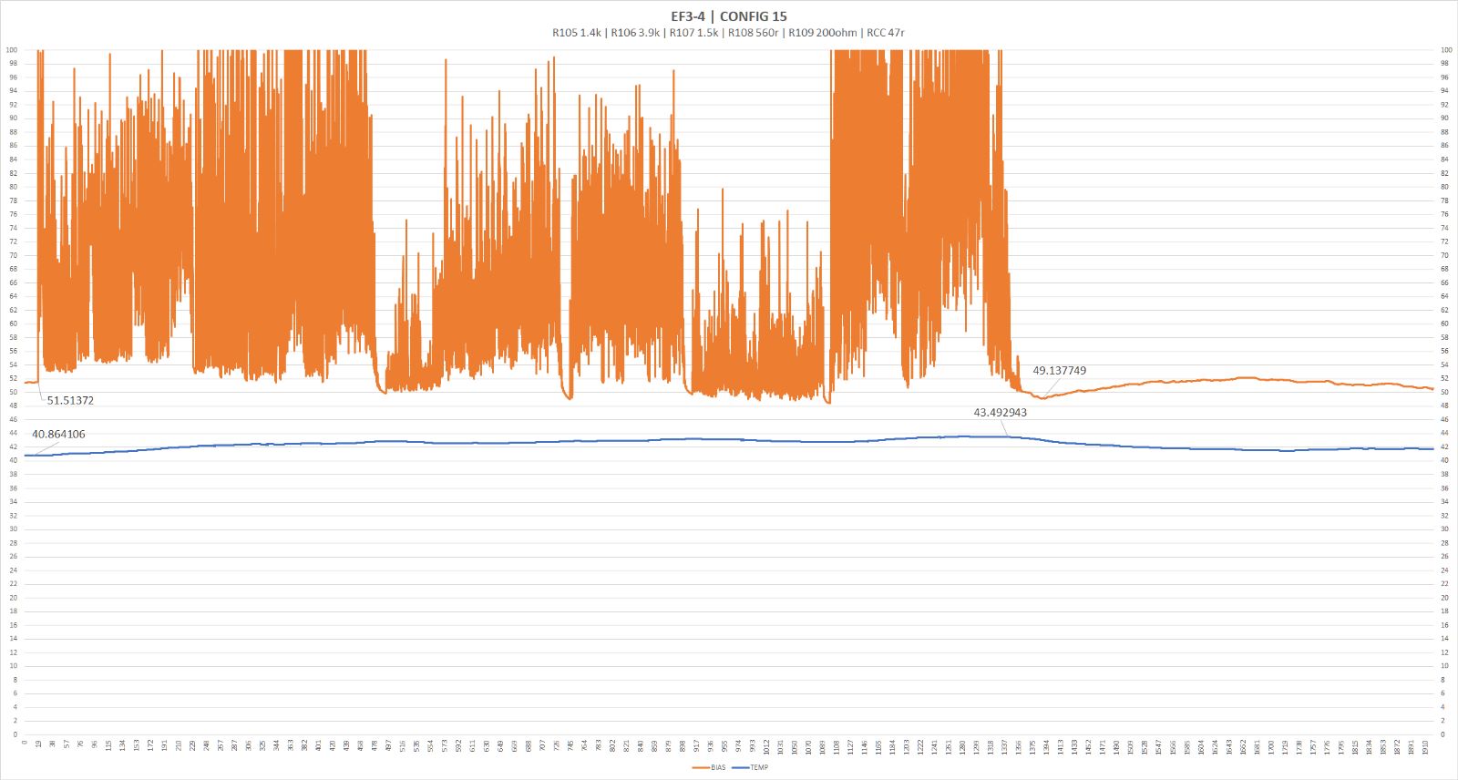

I want to reiterate, these tests were done at full level into 4 ohms, and way beyond a level that would normally be played at, I calculated SPL at 10ft would be 110-112 dB with peaks around 125 dB.
Here is the EF3-4 played at a more normal level into 8 ohms. SPL would be 95dB with 105-108dB peaks at 10 ft.
Basically no change in bias or heatsink temperature at these listening levels.

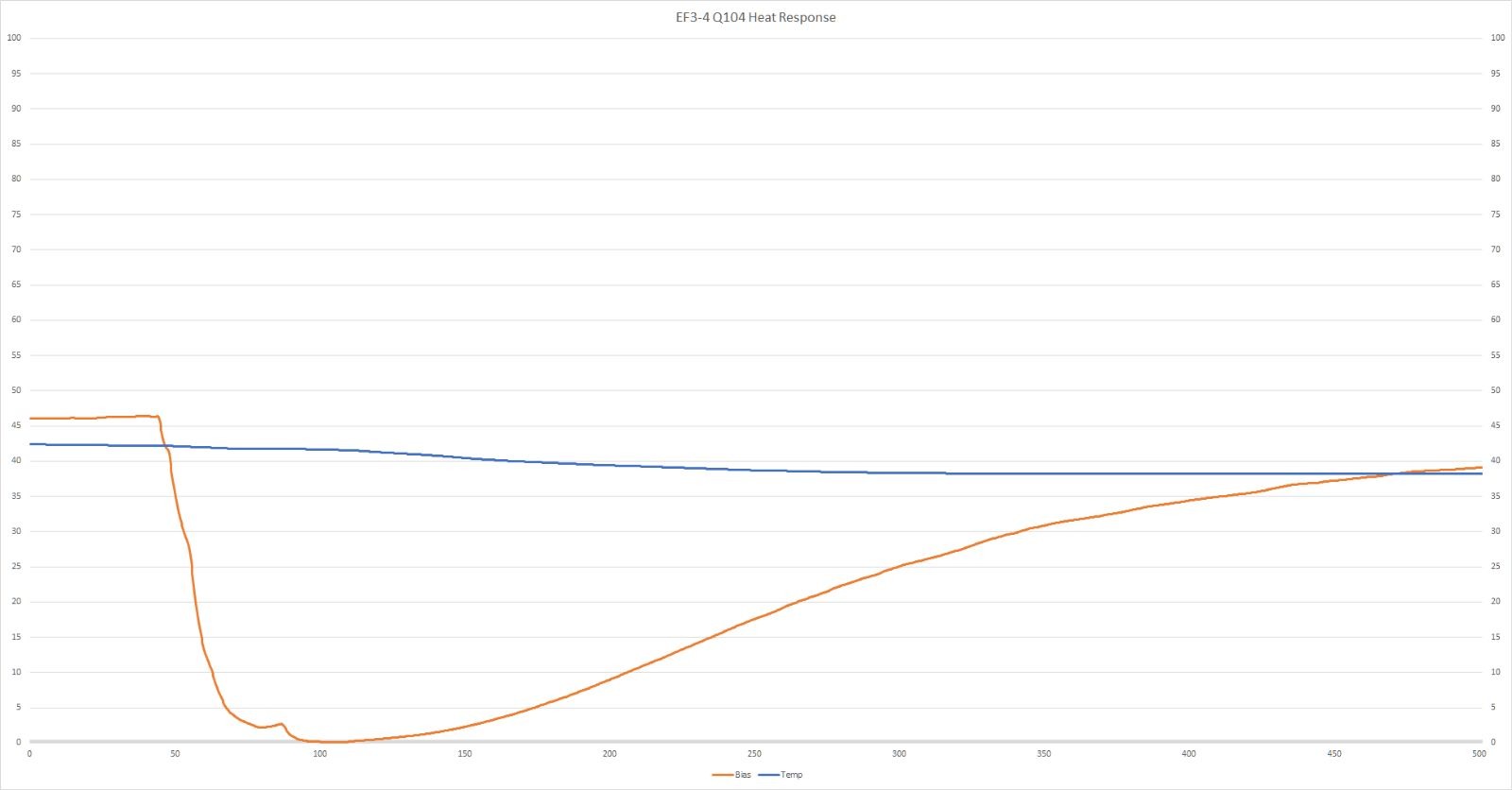

Q104 Response​
Here Q104 was heated to verify its response to temperature, as you can see when heated enough, it will fully shutdown the bias.
