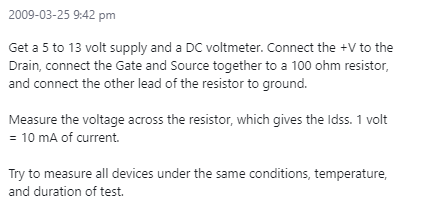

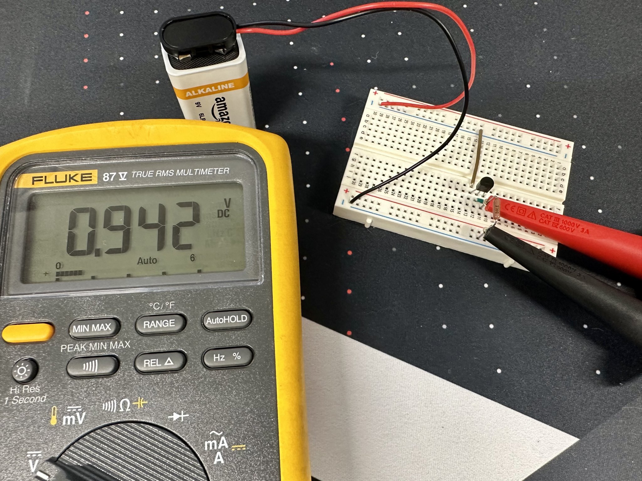

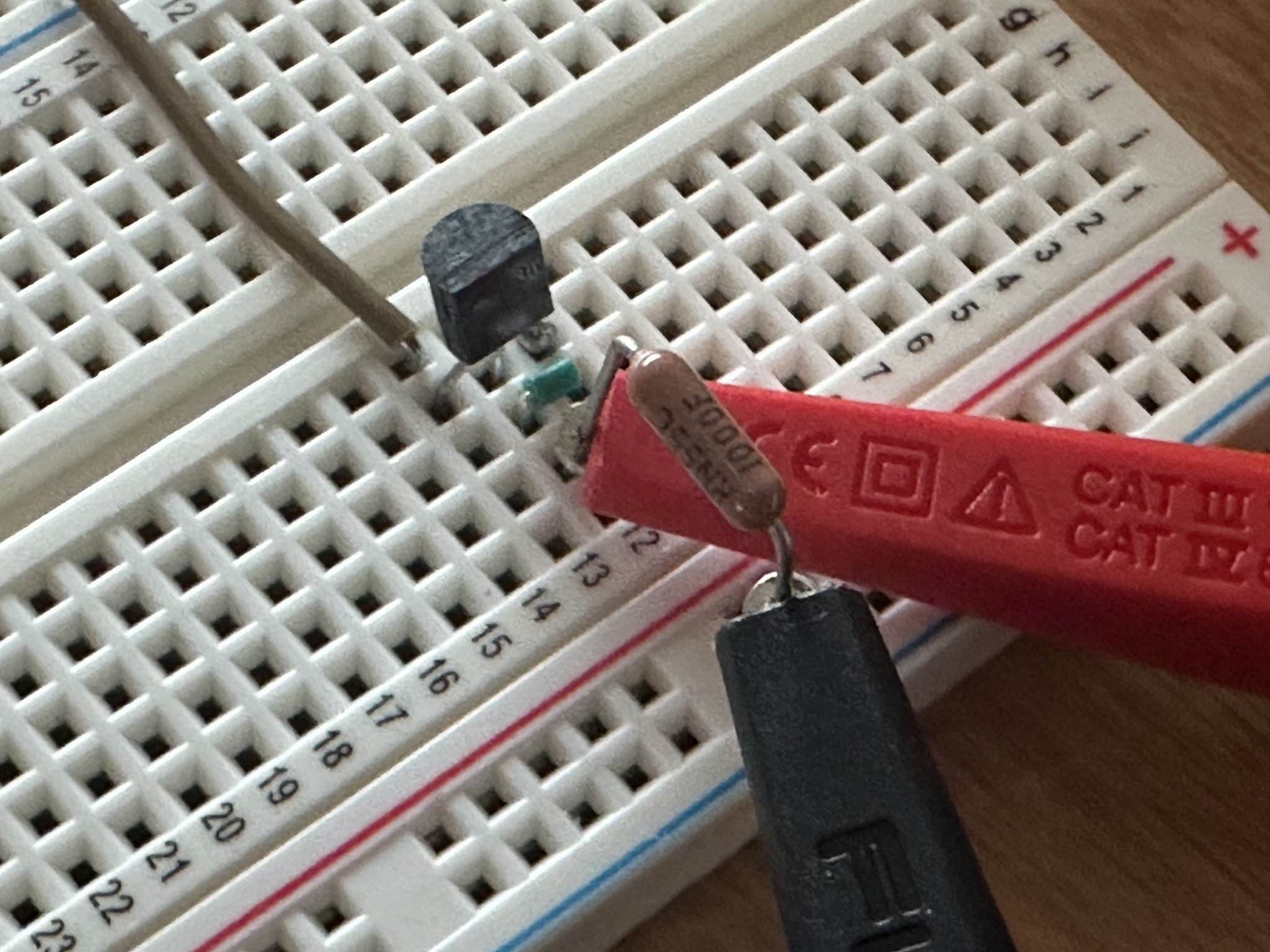

Apologies in advance as this has been covered ad nauseam. I recently came into possession of 100 2sk170BL fets, and I’d like to replace the Q1’s in my build. I’ve seen the formula that Mr. Pass provided and built a breadboard to test them. Before I do anything regrettable, I want to double check that I’m measuring them correctly and provided a pic.
https://www.diyaudio.com/community/threads/2sk170-matching.141162/#post-1784617
9v battery
100ohm resister
1vdc=10ma
Therefore 0.942vdc=9.42ma correct?
Correct.
Time in the rig is very important... it's best to put on music with a consistent rhythm, or just sing yourself a song or say a short rhyme or something like that for cadence, and take the reading at the same time for each device. You'll find that they tend to change as they warm up and the number never really stabilizes, so taking a reading at the end of a set period is the right approach.

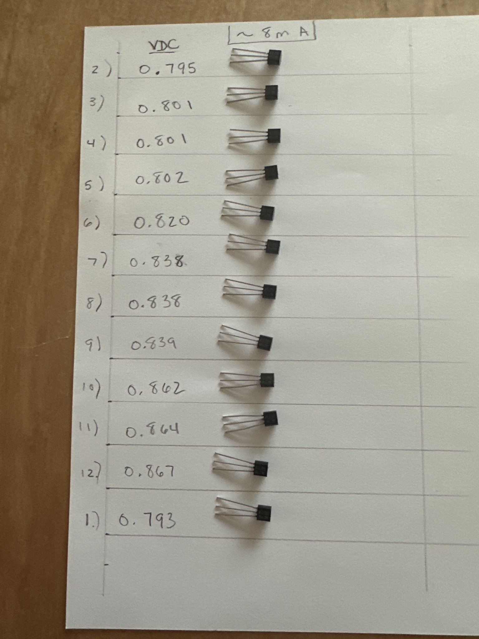

I finally received some resistors for biasing Q2 and spent some of the holiday grouping my batch of 2sk170s in hopes of finding enough similar 8mA values to swap all the Q1s in the crossover. The attached pic is my attempt at biasing Q2 such that it’s value is a bit lower than the Q1 (it may be too close). I was a bit surprised that the bias resistor for Q2 (27.4ohm) is so much lower than Q1 (100ohm).
1. Does 27.4R Q2 bias resistor seem too low?
2. Is the voltage delta between Q1 and Q2 too close? Should I have a bit more headroom to ensure Q2 voltage does not exceed Q1?

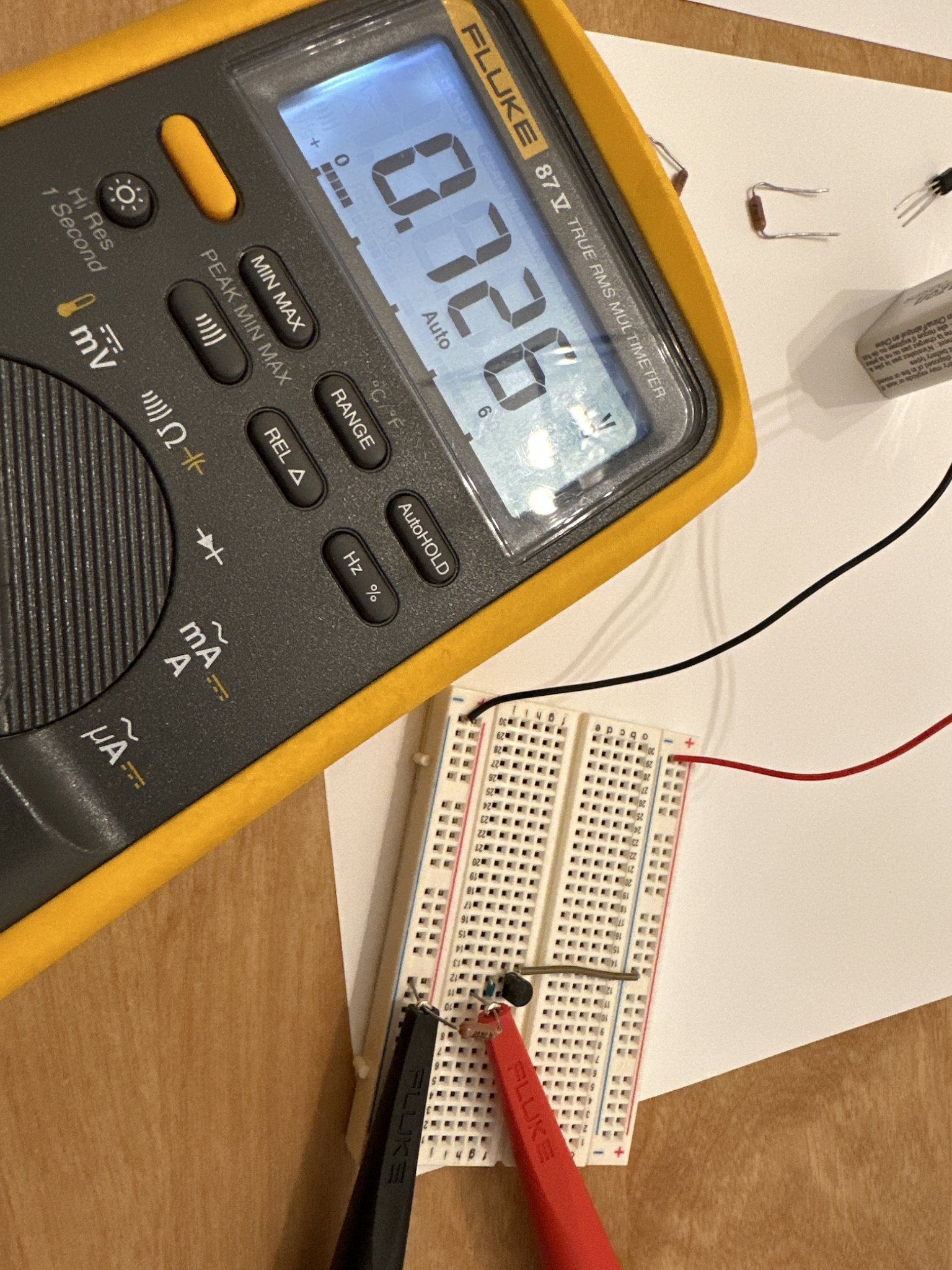

Just for context to my previous post, I removed the Q2 transistor that was included in the kit and put it into the bread board to test it. Using a 47ohm resistor for bias instead of the 100ohm used in the kit, I got roughly 0.727 vdc. If this test looks sound, it would be much easier to just replace Q1 and Q2 bias vs Q1, Q2 and Q2 bias.

The J113's in the kits are sorted by the pinch off voltage in .1 volt bins and matched to resistors to give about 10 ma bias current. You would want to run the 2sk170's as followers at roughly this figure and yours appears to be appropriate. No reason to spend extra money on 2sk170 as current sources. The bias current is not critical, but ideally you want q1 to have an idss similar to the bias value.

@ one and only, appreciate your help. Since I don’t have enough 2sk170’s over the 10mA mark, I’ll use the batch of 12 near 8mA to replace all the Q1’s and lower the Q2 bias resistor from 100R such that it’s idss is a bit lower…I’m getting .761vdc on my “test bench”. I did a quick google search of pinch off and most of the results were rather nefarious, so I’ll leave it alone.

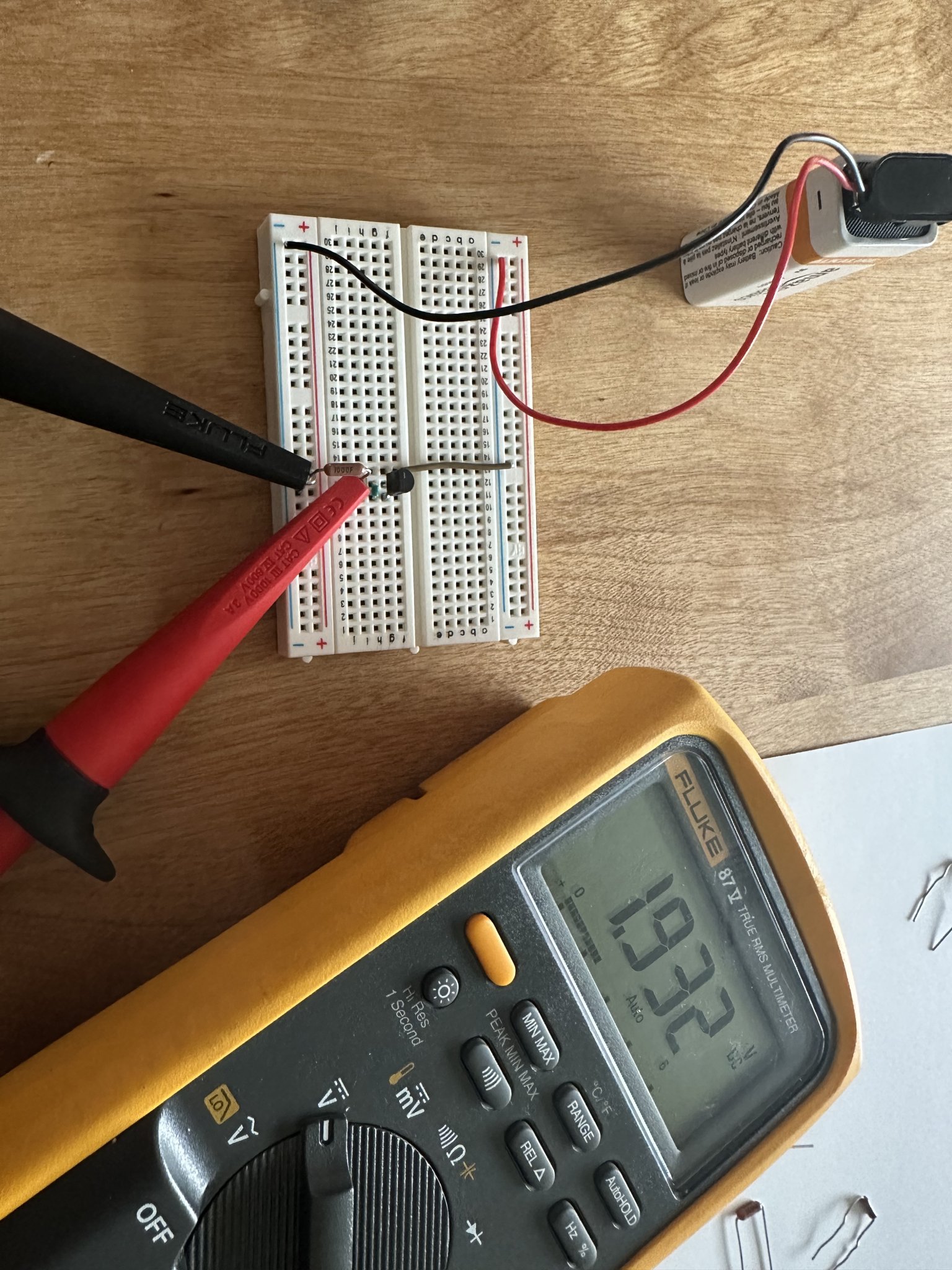

thanks Dennis. is the method of testing the Q2 current the same as the 2sk170? I realize the pinout is different. Do you need to connect the Q2’s gate and source together for testing as one does for testing the 2sk170’s? See pics for how I’ve tested the original Q2 with 100ohm resistor. It results in roughly 1.9 vdc. Using a 47ohm resistor cuts the current in half.
Please see the attached. For the Q2 bias resistor you want to connect it between the gate and the drain of the jfet.
The current flowing through the jfet is the voltage across R1 divided by R1. So you adjust R1 to get the current you desire (say, 8mA).
Notice that Idss corresponds to the case when R1 = 0 with a resistor on the side of the Drain just for current measurement.

Got it. I will test and report out. Thank you sir.
