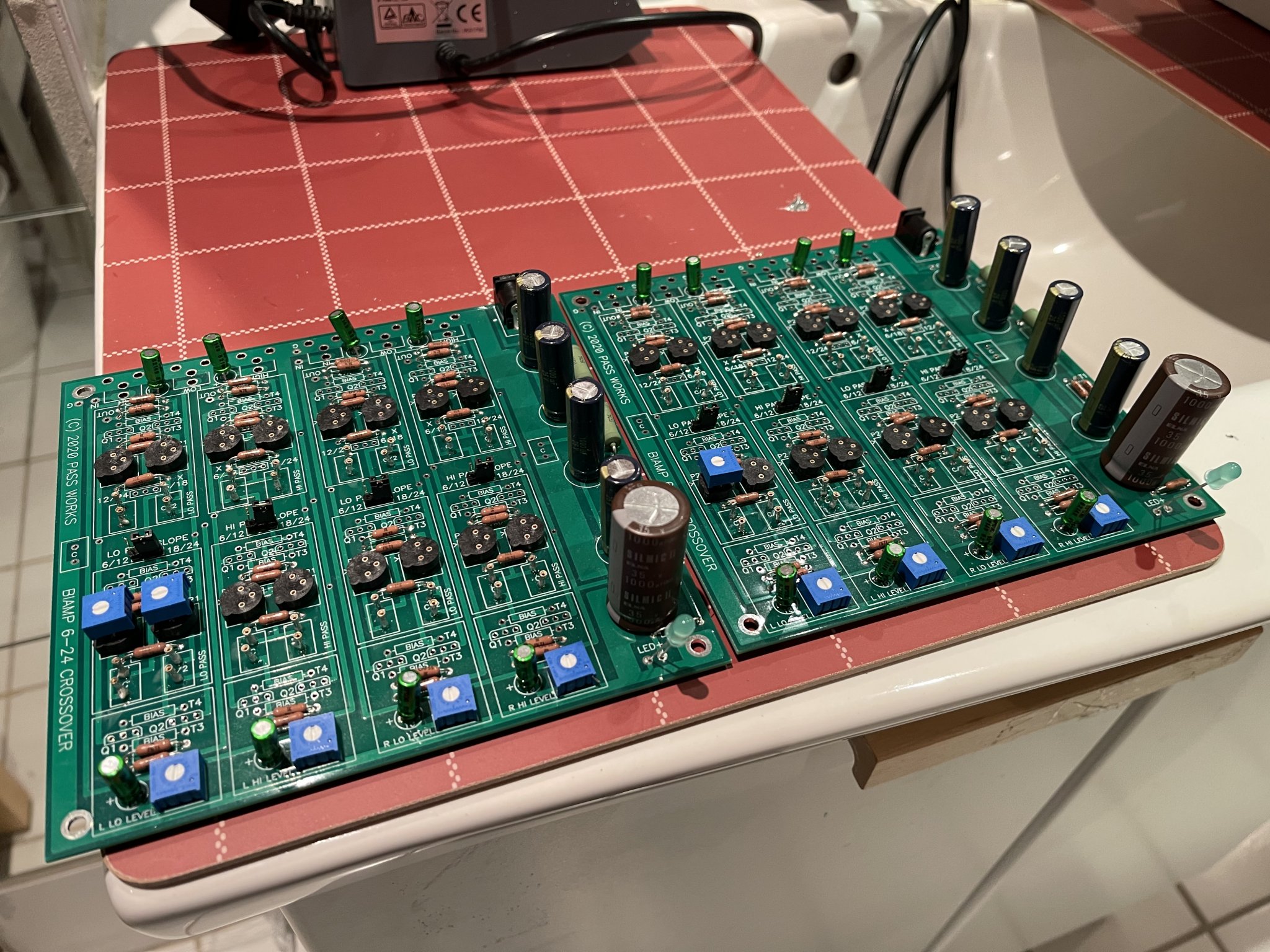

I’ve just found out about these crossovers and they look great. Anyone know roughly when they’ll be back in stock?
Cheers!
Cheers!

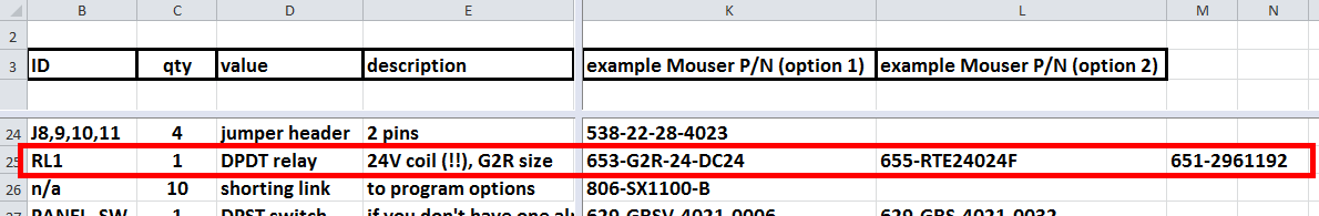

Oh, fabulous PS relay. Where art tho?I put this together as part of a revised power supply filter for the diy Sony Vfet and similar amps
to go in the diyAudio store and I have a nice pile of them ready to ship.
The full supply filter board will be posted more generally later.
If you're having a hard time finding a relay to fit in your power supply filter PCB, a possible alternative might be to use the Ship Of Theseus power supply filter PCB instead. It was intentionally and deliberately designed to use a relay spec and footprint which is available from multiple different manufacturers. And its coil is intentionally chosen to be 24V rather than 12V, because 24V relays seem to be easier to buy during the *an*em*c induced supply squeeze. Here is a link.
_
_
That looks fancy. Since I have two amps it is quite an investment just to get rid of turn off pop.If you're having a hard time finding a relay to fit in your power supply filter PCB, a possible alternative might be to use the Ship Of Theseus power supply filter PCB instead.

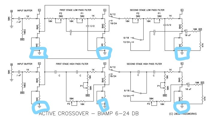

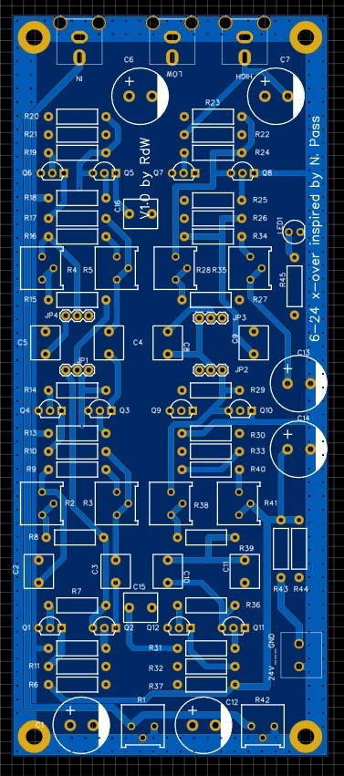

Hi all,
I am reviving an old project:
I want to try project P71 from Rod Elliot (Linkwitz transform pcb) so I will be using psu with +/- 12v.
As I am testing my EasyEDA skills, I wondered if I could use the +/-12v psu for the 6-24 crossover as well? Is my thinking that V+ in the original schematic can be supplied with +12v, VREF is GND and GND on the jfets (marked below) should be supplied with -12v?
Thanks!
Thanks!
That should work fine. Careful matching and/or adjustment of the bias resistors would allow DC coupling as well.
