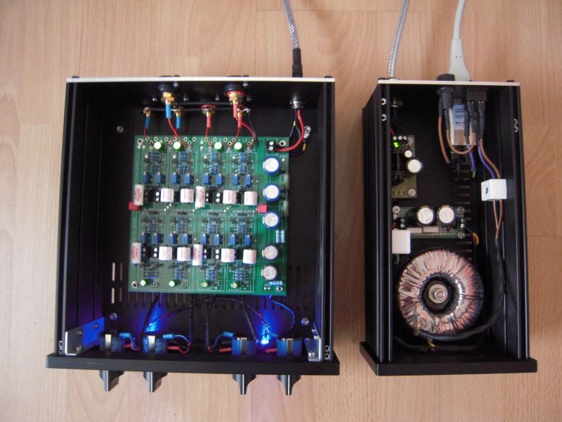

Trying to get all the parts needed to build a few of the XO's​
1000uf caps are no longer in stock at digikey.​
Can you suggest a replacement ?
Also, is there an improvement from using the vishay 10 position pots ( which i cannot find, but i did find 23 position pots ) or any other advantage ?
And the same question for caps, any difference, even a small one ,in using something like claritycaps instead of Wima ?
Hello RolandPSP,
I have built my 6-24-crossovers with bourns 25-turn-pots. I think they gave me easier adjustment of the crosssover points / - frequencies. No reason to use them soundwise.
For sure you can experiment with different caps. I made one version with WIMA-caps in the filters
and Nichicon UES bipolars as decoupling caps (before and after the buffer cells - or input and output).
As described in Nelson Pass article and bom. Sounds very nice.
Then I used Mundorf-caps and a few other brands. The differences were in my opinion that marginal...
I do not want to say that you shouldn't try it. Buy good caps. But caps which cost more than the 6-24-kit
and all devices together - makes no sense to me.
I wrote it many times - I hope the rest of your system is as good as this active crossover with the WIMAs
and some nice decoupling caps.
I changed the volume -pots at the input to 10-turn-pots for very accurate volume-adjustments between
high- and low-pass section.
But this is my opinion. 😉
Cheers
Dirk

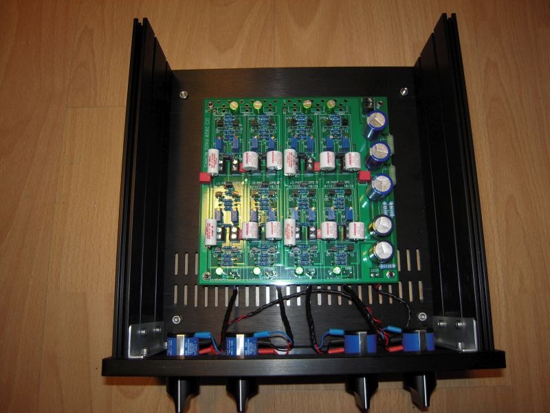

I would recommend a higher voltage rating, 35ZLH1000MEFCG412.5X20​
This is one possibilty to use bigger caps in the filterstage...
