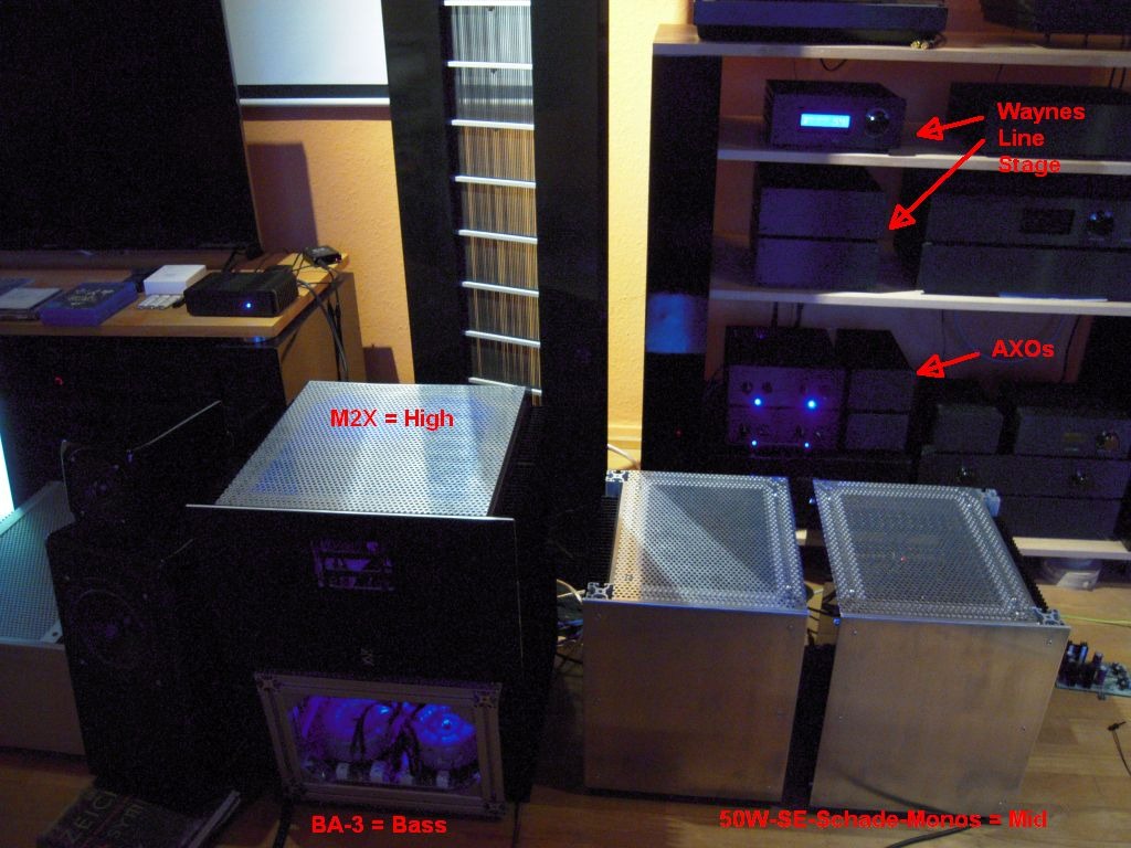

Hello rewind (post1115),
daisy-chaining two of the 6-24AXO is exactly what I am doing. Only different crossover-frequencies (for my speakers demands).
AXO 1: crossover from sub to 2-way (mid-highs) at 80 Hz
AXO 2: crossover from midbass to tweeter at 2500 Hz. Gets the signal from AXO 1 high-pass above 80 Hz
As you described it - it is a bandpass (in my case 80 - 2500 Hz).
I only have one PSU for each AXO.
Cheers
Dirk🙂
Cheers
Dirk🙂
Very nice setup.
If using two PSUs, why not use AXO 2 for both the highpass at 80Hz and the Lowpass at 2500Hz. Highpass going to the input of the lowpass. Then the midrange channels uses only one PSU and not two PSUs. Not sure if it will make a difference.
AXO1 would be used for below 80Hz and above 2500Hz. Don't mix them up!
Or better yet, dual mono! For maximum channel separation. Need to check this out if it is possible.

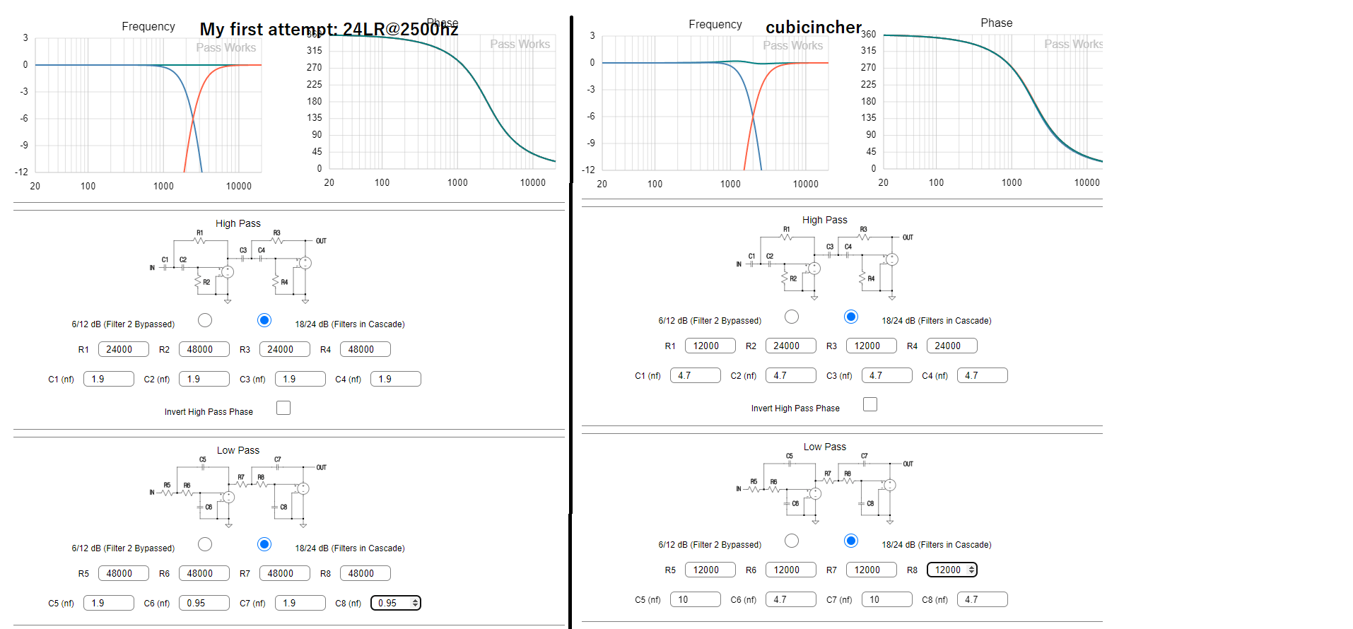

I long ago received my DIY Bi-amp 6-24 board, Jfets and bias resistors. I recently retired so have time to order parts and stuff away.
My first real world use will be on a mini-monitor with 5 inch midbass and planar or ribbon tweeter. Target X-over is 2,500 hz.
My question: Will the 6-24 with "stock version" 10K resistors on board be able to deliver a good 24db L-R 2,500 hz crossover, or should I just go with values derived from the Mike Rothacher spreadsheet? Can anyone speak from experience?

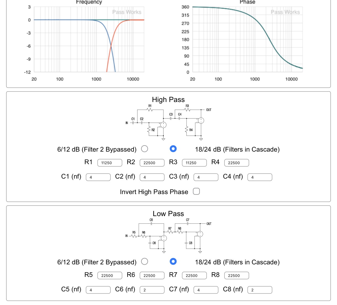

This is what I got. Everything is the same as the 1000Hz example in the article, except I used 4nF and 2nF.
I still don't know if this is a 24dB L-R slope.
