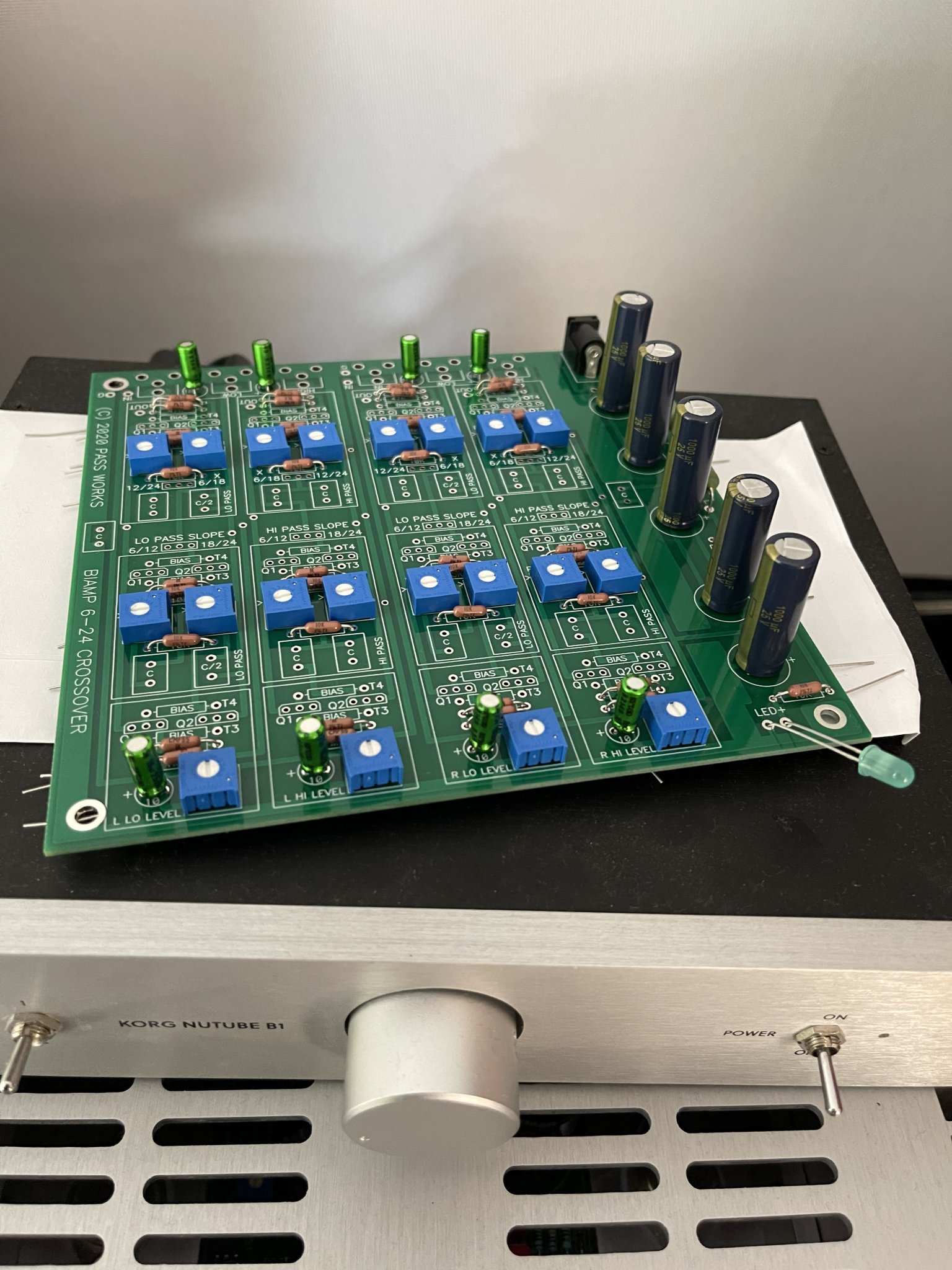

I am about to start building it now!
Of course I only ordered half of the caps I need for the filter. At 2 AM I only have half a brain and everything is mono. Gives me more time to do some cap rolling. Can try Wima VS Mallory first, since Mallory are cheap.
I don't like the idea of frying my V-Fet lottery amps, so I will trust that the Muses are good enough.I forgot: If you play around with film caps instead of bipolar caps pay attention on not getting DC-voltage
The Mallory 150 guitar tube amp caps are 99 cents each. 🙂Hello rewind,

I think a film cap (or no cap) would be the best if it is right in the signal path. Is the bipolar muse cap the only way to protect the amp? Or just the quick and easy way?Just to add: Papa used to recommend Silmics very strongly, many posts about the subject dating back to st least 2004. In for example the ACP+ manual, I seem to recall Nichicons used all around. And if my sources are correct, Pass Labs have swapped Silmics with Nichicon greens. Coincidently the production of Silmics have been moved out of Japan, and they also seem to be EOL.

Edit: Looks like much smarter people than I am has already debated this. After lots of talk about servos and parallelled film caps, the conclusion seems to be to not question the wisdom of Nelson Pass. Cap in, cap out, like in all Firstwatt preamps. Nothing more is needed. A too complicated protection can lead to failures that causes the accident that it was supposed to protect from. https://www.diyaudio.com/community/...-protection-circuits-for-preamp.336242/page-2
No need for polarized caps to get rid of DCI think a film cap (or no cap) would be the best if it is right in the signal path. Is the bipolar muse cap the only way to protect the amp? Or just the quick and easy way?
But why is 10uf used? In the world of non-polarized caps 10uF is easy €50 per cap. And I need eight. Is 1uF just fine and doesn’t change anything?No need for polarized caps to get rid of DC

Thanks, but I can't think of any better bipolar cap then the one in the BOM.The cutoff-frequency fc = 1_
2 x pi x R x C
If you increase the value of C (the value of your cap) in the upper formula - what happens to fc?...
And as long as fc is anywhere below 20 Hz - nothing to worry about.
