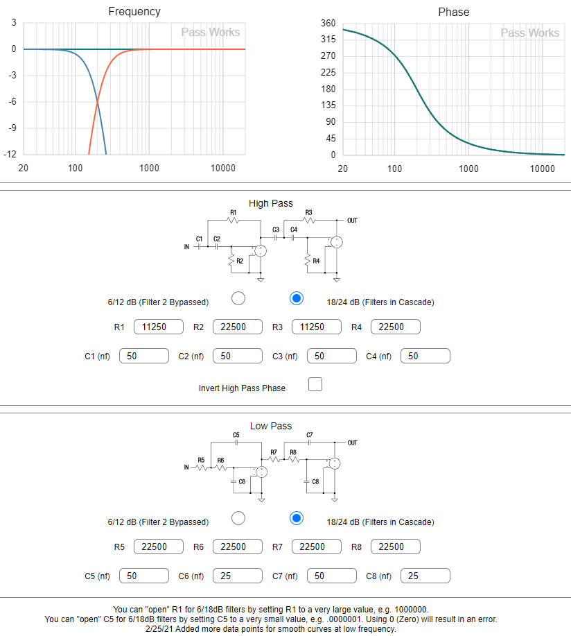

I'm usually happy with the results I get from this free online active filter generator web page. But maybe I haven't yet stumbled into areas where it is weak or inaccurate. Just plug in the damping ratio "zeta" which corresponds to a Butterworth filter, and Bob's your uncle.
They also offer the MFB topology if you seek a filter that's polarity inverting.
Thank you Mark! Pardon me for my ignorance... I can get the values for second and third order Butterworth filters with the linked website, buy could you help me translate the case of the third order one to the cascaded configuration of the XO here?

I was playing around with the simple crossover calculator last night from the article last night for the firet time. I got half way to build a crossover in microcap. Can anyone point me in the direction of a 24dB or 18dB crossover point at 200Hz?
