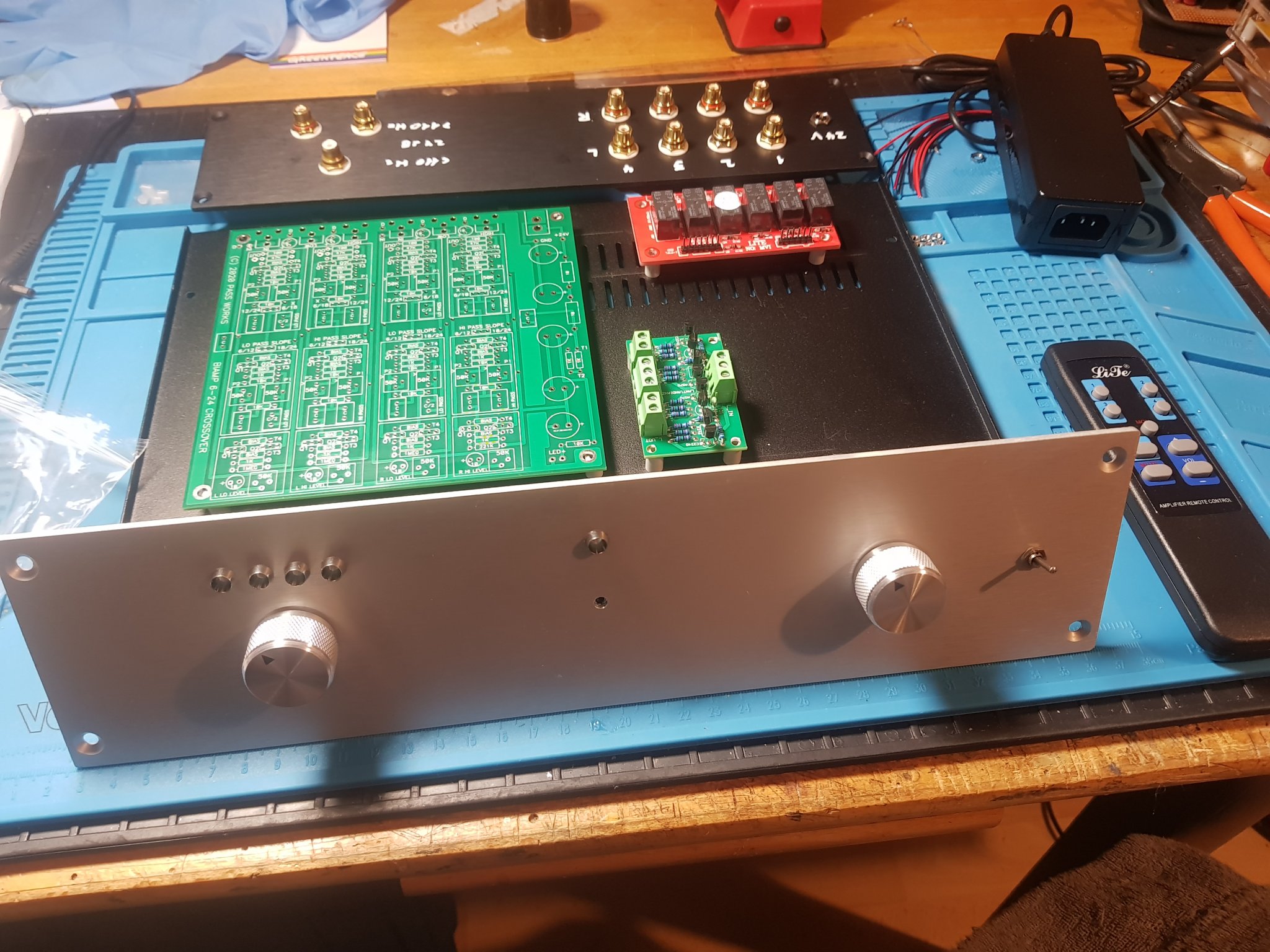

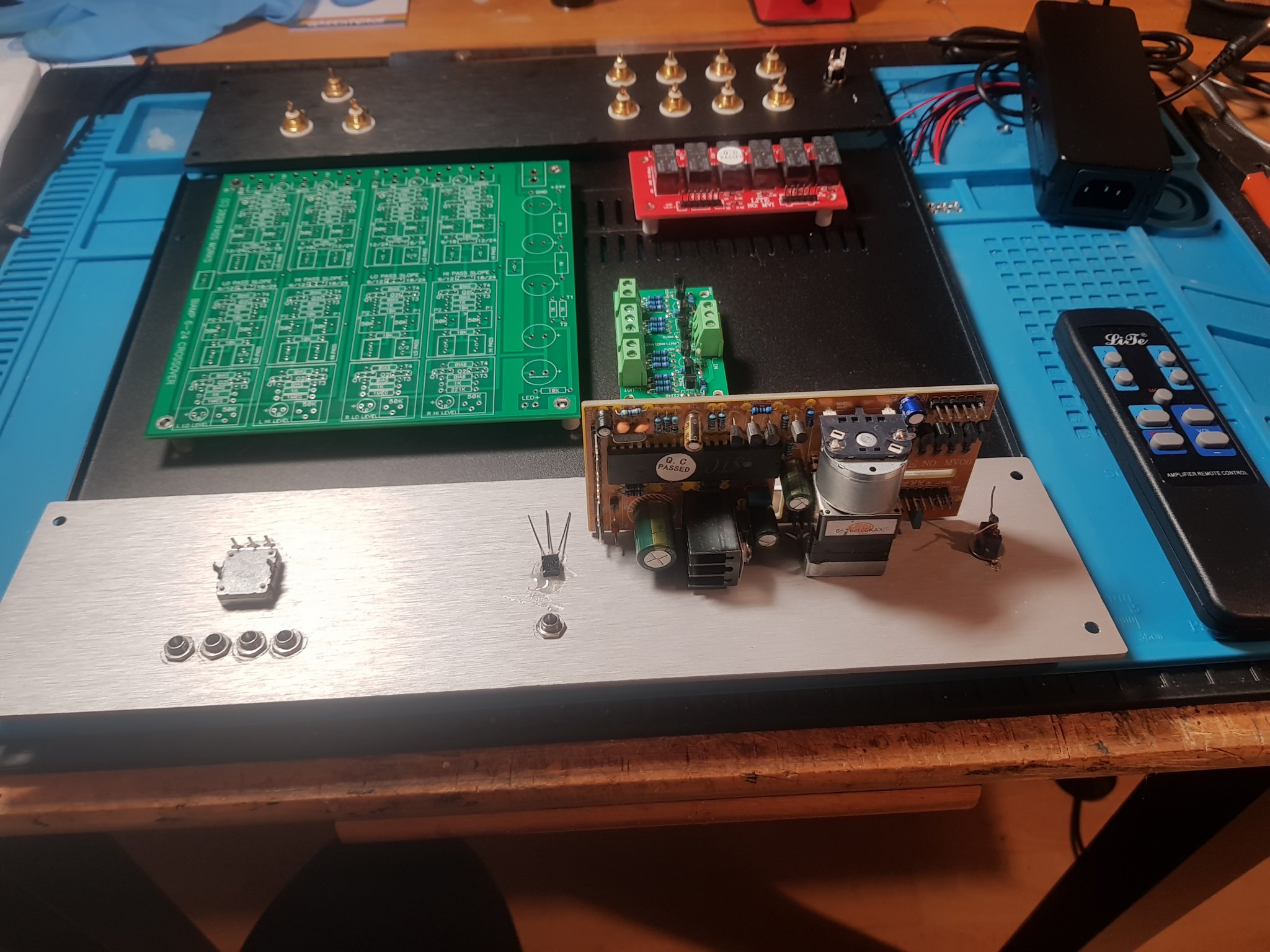

Today it was a rainy day here in Switzerland, perfect to solder the B1 buffer and to do the body work. It is the same enclosure I used for my ACA mini.

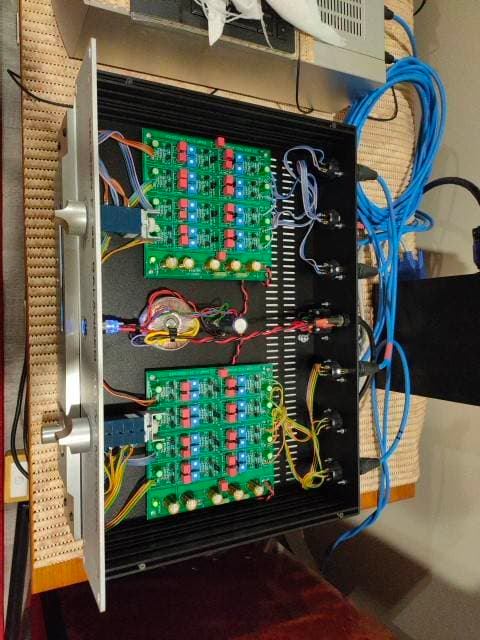

do you really hear a difference between the TKD and the ALPS , worth the gap price ?🙂Just thought I would share some pics of my fully balanced network. I am waiting for the TKD pots to come back in stock so forgive the temporary alps blues.
View attachment 1048256View attachment 1048255View attachment 1048254

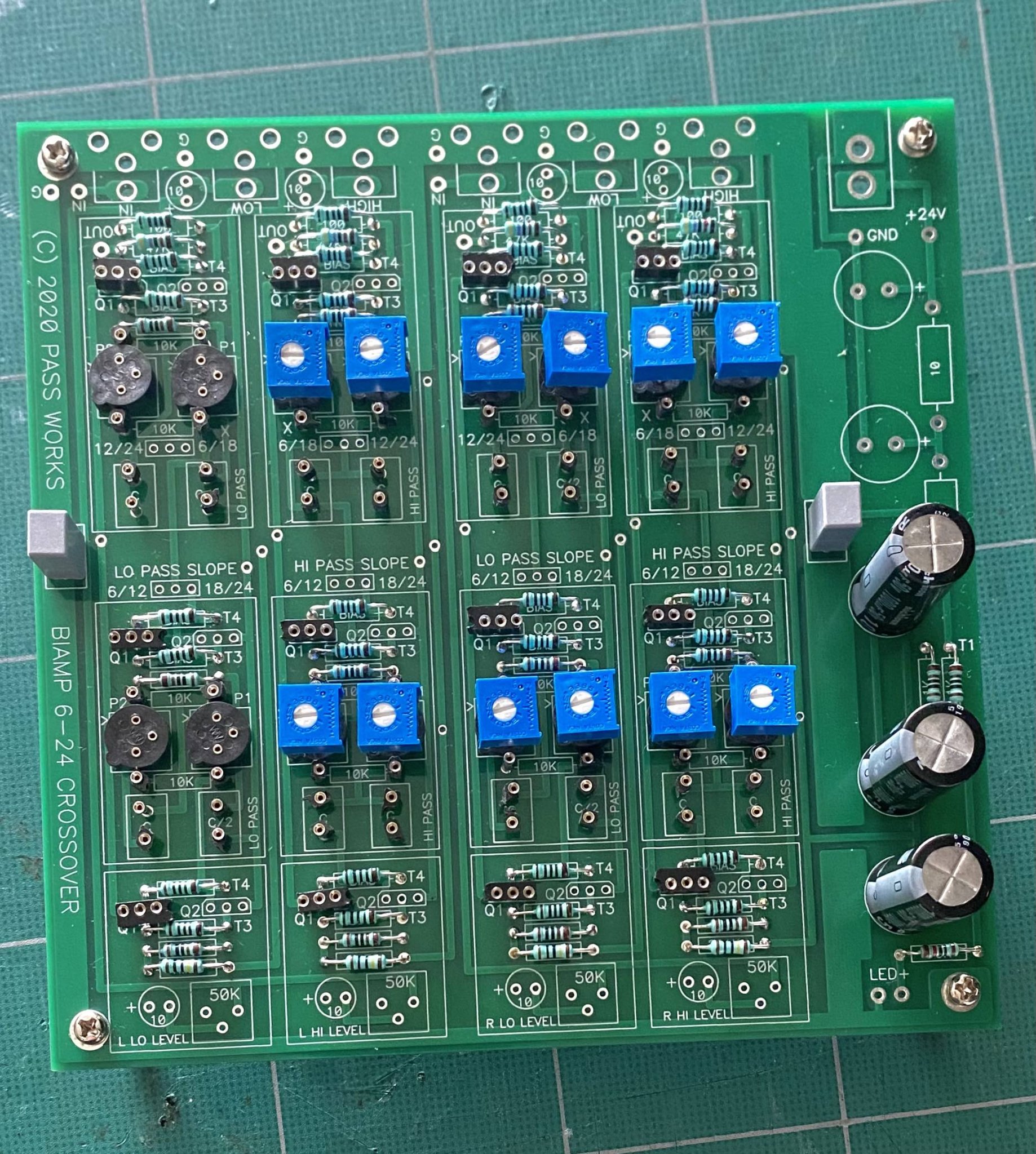

I am making a non adjustable 24db xover with the boards at ~80hz. What is the downside, if any of using .01/.02 uf caps with 140k/280k resistors? Any thoughts?
No issues with film caps. As the impedance goes higher, you becomes more susceptible to noise issues, but I use values that high routinely.

The low pass section won't be a problem due to the small gain bandwidth. I would keep it under 100K. 100K has significantly higher Johnson noise than 10K. Check the load and how much margin you have with the single ended bias current. Radiated noise or induced hum will be the most obvious issue with values over 100K.I am making a non adjustable 24db xover with the boards at ~80hz. What is the downside, if any of using .01/.02 uf caps with 140k/280k resistors? Any thoughts?

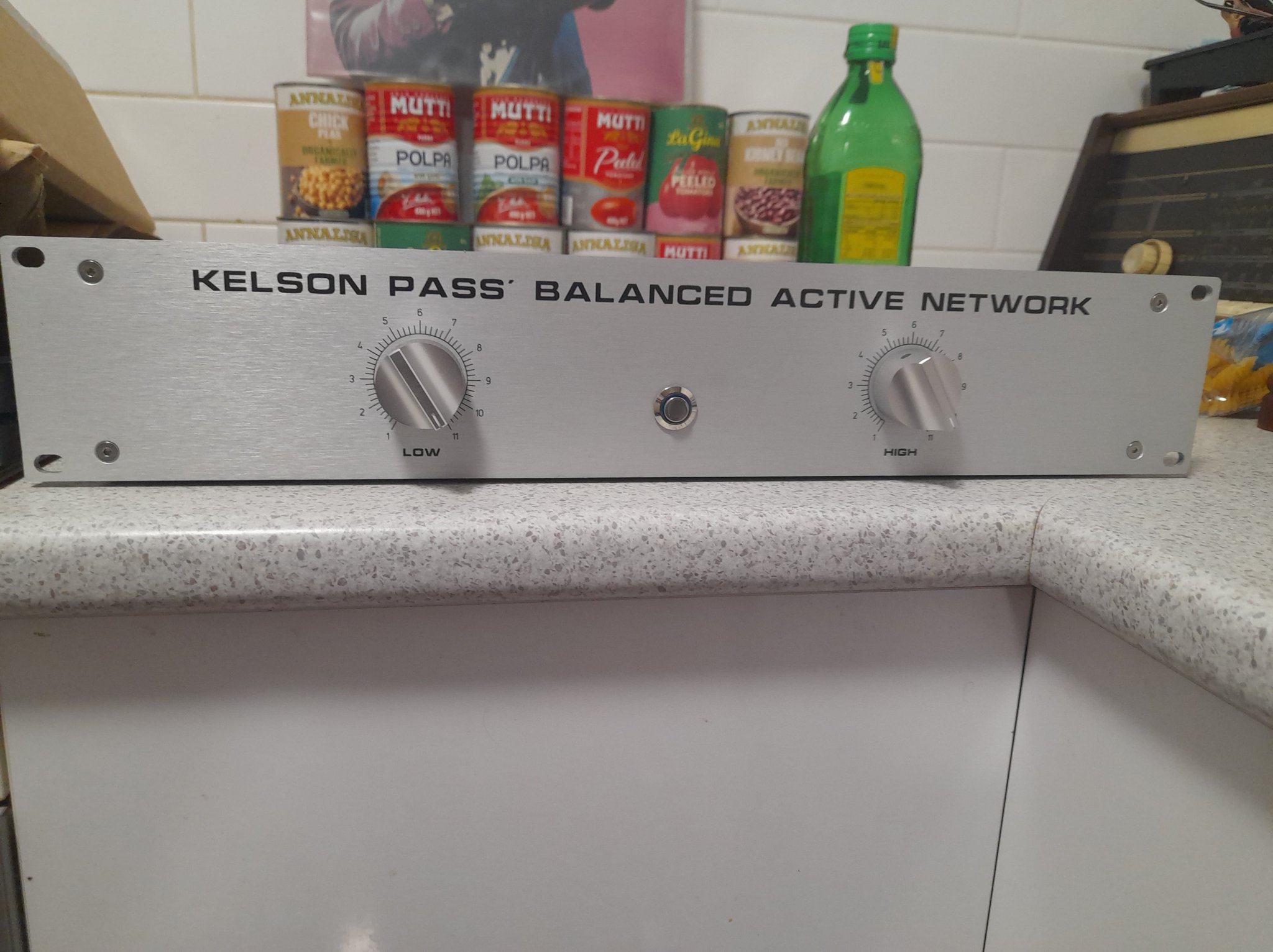

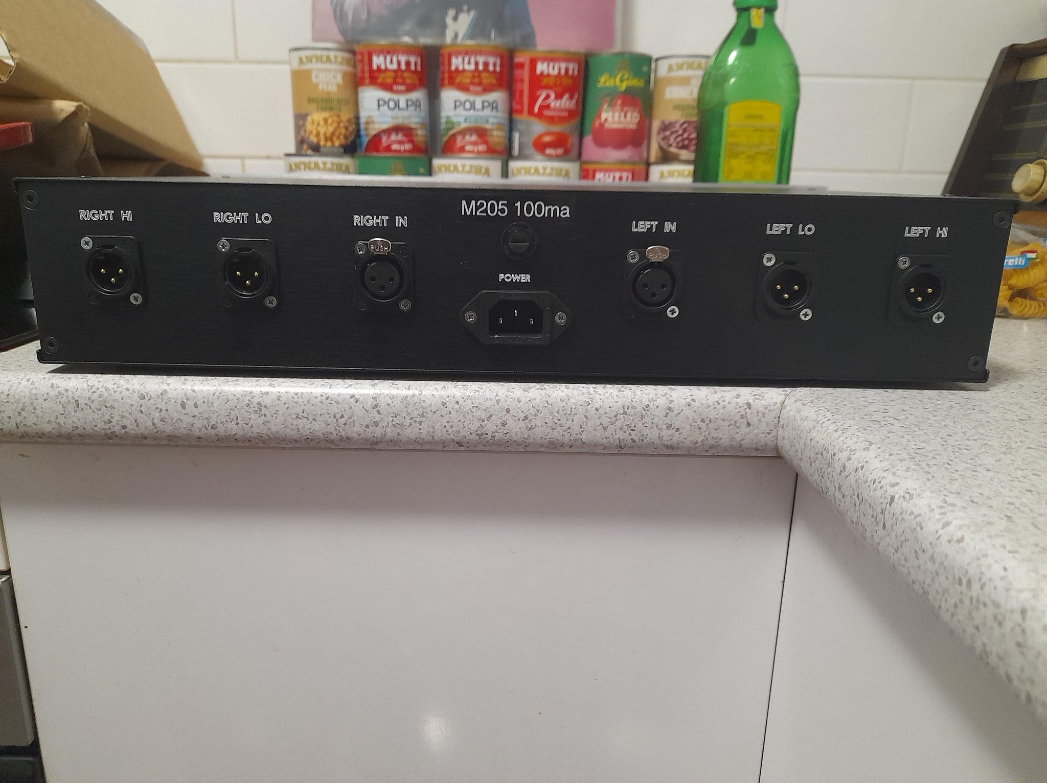

Pictures of my actual build, dedicated for my "big" setup in the living room, replacing a miniDSP 2x4HD
