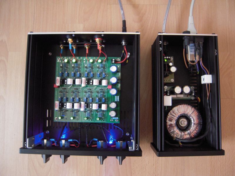

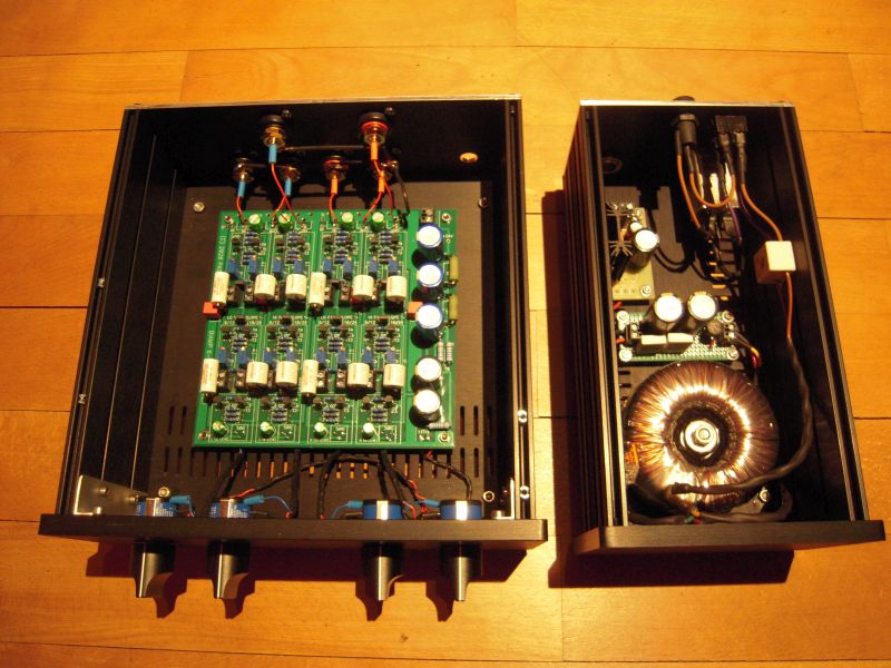

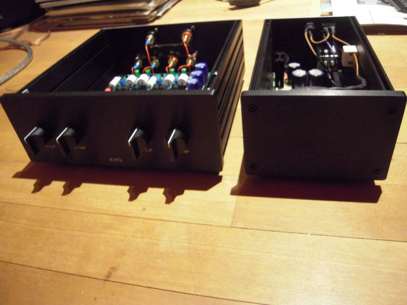

6-24XO for subwoofers
I am getting closer to finish line with my second 6-24 - AXO build for subwoofer... 😀
Cheers
Dirk

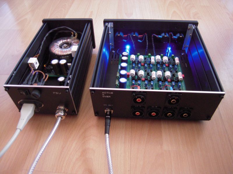

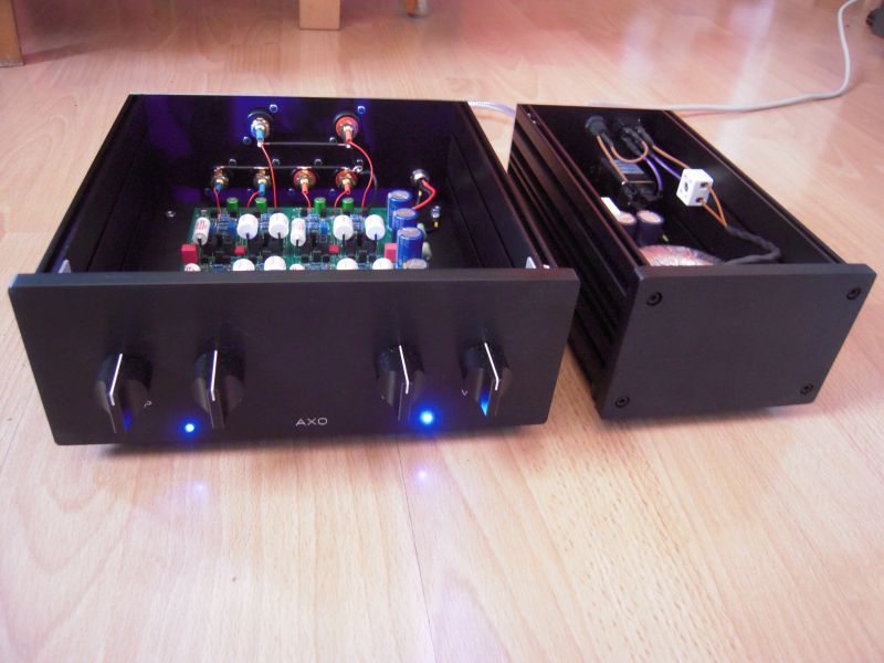

Hello members,
I made myself a easter-present 🙄 - the baby is up and running...
I have to solder 2 pairs of RCA-cables and perhaps this evening I will have a first
soundcheck?
Cheers
Dirk :drink:

I’ll start with those look great! I don’t know where to start with what did you use to build those and what is your crossover frequency? That linear power supply also looks great. I assume the volume knobs replaced the small pots intended to be mounted to the PCB. Great job!
to Billah #753
Hello Billah,
the crossover frequency is at 80Hz with 24dB-slope.
The PSU has a CRC-filter followed by a regulator for 24V DC. And there is the massive CRC-filter on the mainboard of the active crossover. More than enough.
And the pots are Vishay/Spectrol high accuracy pots with liner taper (10-turn) which replaced the trimpots on the mainboard.
Cheers
Dirk

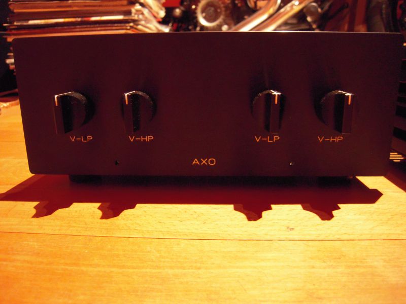

6-24XO for subwoofers - first listen
Hello 6-24XO-builders,
my second build of the 6-24-crossover is playing music. Really good
from the start with minor adjustments at the volume pots.
I have a really fat grin on the face.... 😀
Cheers
Dirk
