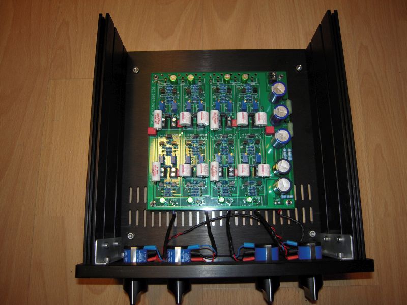

to Eitan100 #761
A closer view...
to Eitan100
Hello Eitan100,
I wouldn't worry too much about the caps. As lomg as they are from a well
reputated company.
I wanted to test the Mundorfs. It was their smallest value they offer (0,1µF).
It only made sense, because I have a crossover-frequency of 80Hz. So I needed a
pretty high µF - value.
In my other build of the 6-24XO I used WIMA-caps. They sound excellent.
Greets
Dirk

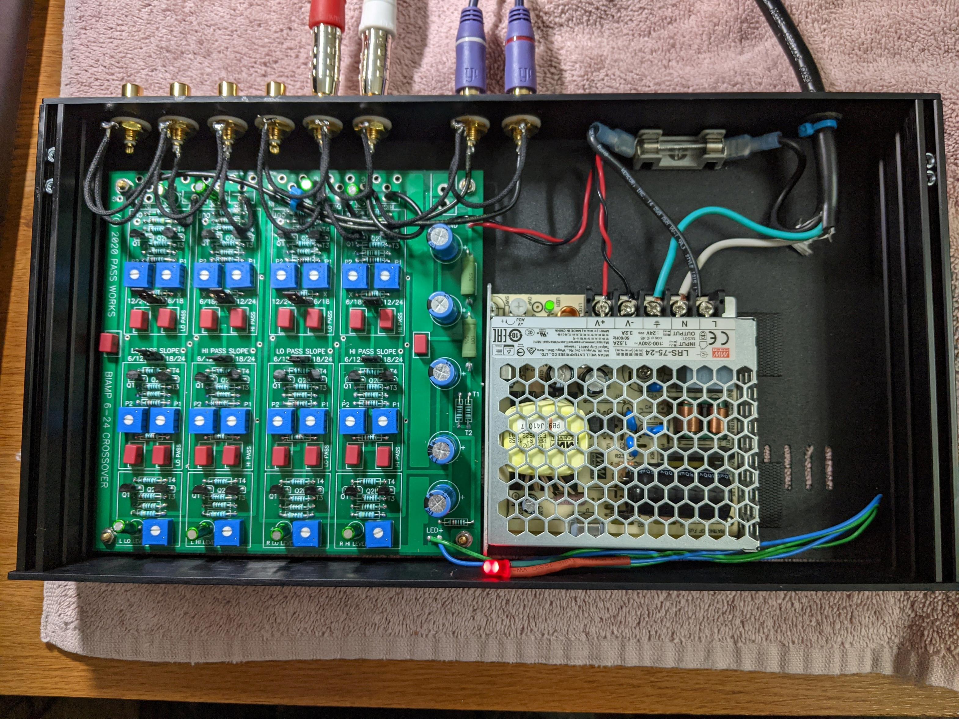

Beyond all hope... it actually works! And not only does it work, it's magic. It managed to transform the cheapest speakers I own, a pair of Sony bookshelf speakers, into some very respectable sounding speakers. I was amazed. Now the existing crossover in the speaker consisted of a single very small cap on the tweeter, so this was a big change in components. But the change in sound is quite dramatic. Thanks Mr. Pass!
I am now going to buy another board and expand mine to a three-way system. I may attempt to use it with an LX-521 build. I'll move the PS externally and the second board will fit on the right side. I already have the output jacks for the woofer output. And who knows. Maybe I'll go crazy and put an off-on switch on it somewhere too.
Congrats on the build!
I would not be able to resist the tempation to move the PSU as far away in the box from the x-over as possible though, to minimize the risk of inducing extra switching noise into the board.
