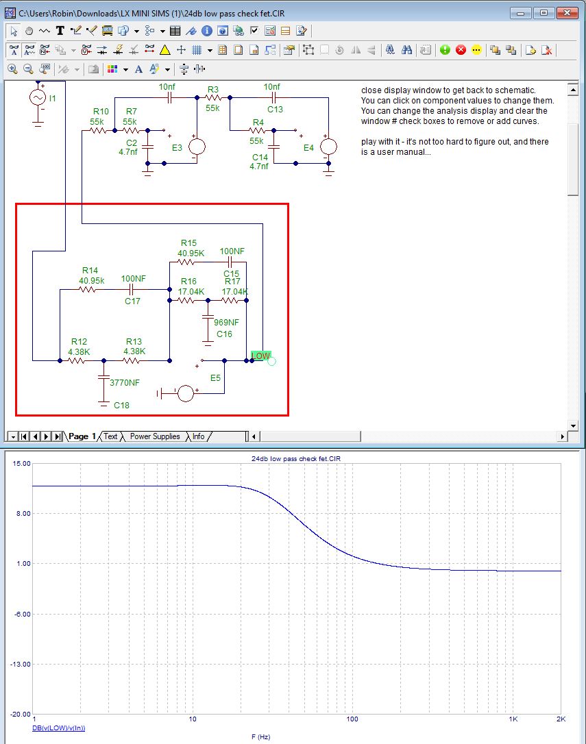

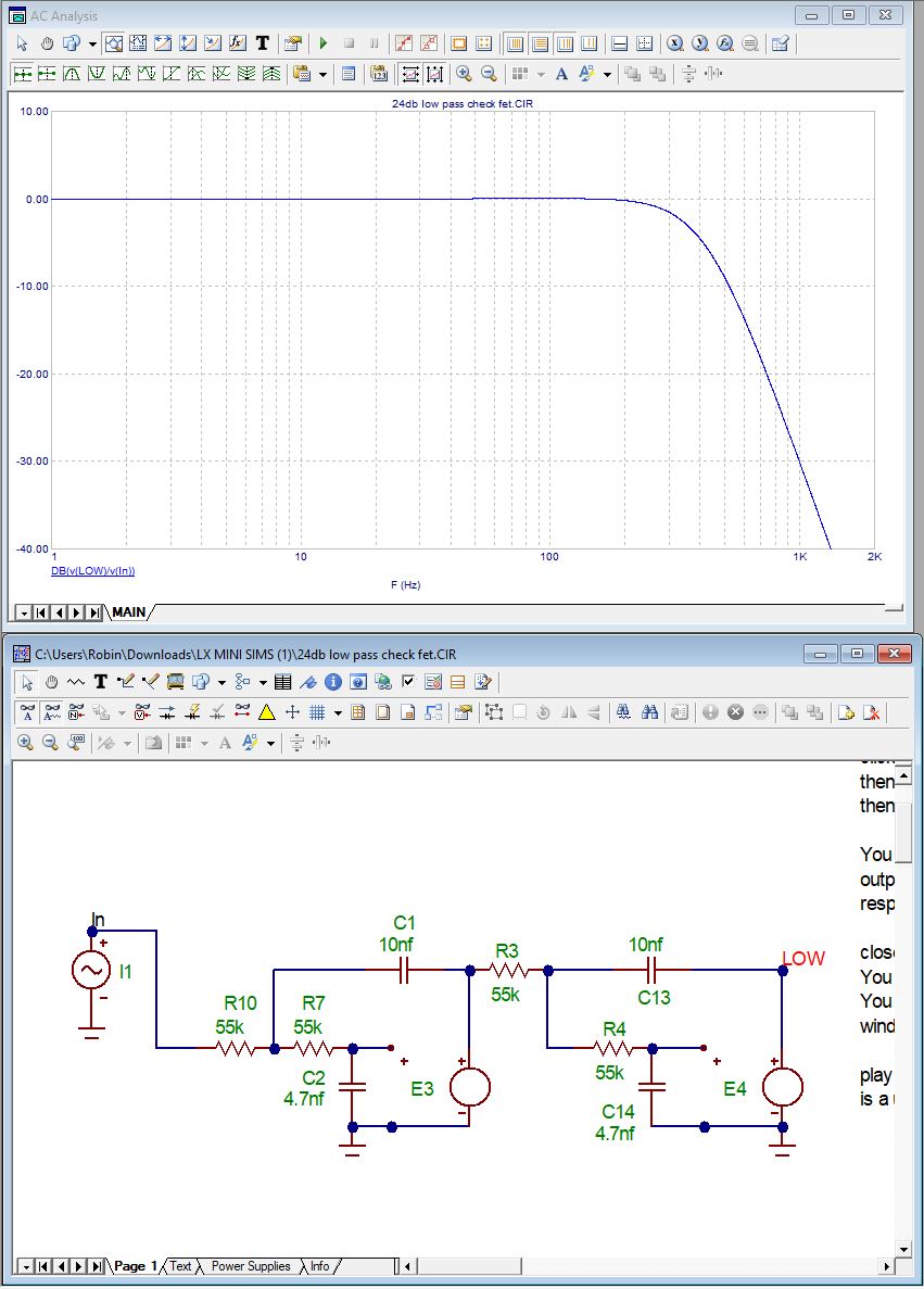

Allright, I love this tool and all its options! So I decided to educate/read some more on active (analog) crossovers. My aim is to create another board but a bit more tailored to my speakers. I started with microcap and replicating my low pass as it is currently in my system, a 24 low pass at 435hz, all good it seems:
attachment.php
Then I tried to add a linkwitz transform circuit, starting in Microcap:
attachment.php
So basically I just put in the schematic from Linkwitz. I am not so sure about the orientation of the opamp although the output in the graph is correct (11db gain as calculated). Where I am currently stuck is that I think that the opamp in the linkwitz circuit provides gain. Also I am not sure if this would work at all with the unity gain operating J113’s?
My question to the experts out here is whether it is possible to apply the Linkwitz Transform in the same 6-24 circuit using J113’s instead of the op amp?
I'm not an expert but I do hack around some... and like you I learn by jumping into deep waters
The 6-24 uses JFETs as followers in active filter circuits where op amps are often used. It's a purist HiFi design by a master and it deserves careful study.
I don't totally understand the Linkwitz transform circuit but it seems to do complex things with both phase and frequency response, and some of the magic is happening in the negative feedback loop of the op amp. This circuit could be duplicated with transistors but it will be more complicated than the 6-24.
Thanks, I am in doubt if I will overcomplicate things in trying to add this circuitry. I am stuck at the moment😛
But as I am making the boards anyway, I like to explore additional functionality. In the end this will determine whether I will go sealed or ported for my cabinets.
If it turns out to be too complicated I might try a separate board with the regular opamp and dual rail PSU.
For anyone wanting to mess around with the microcap file I attached it. Do note: one is the 24db low pass and the other one has added the (most likely incorrect) linkwitz circuit. Based on these file it should be quite easy to add the high pass part of the circuit🙂

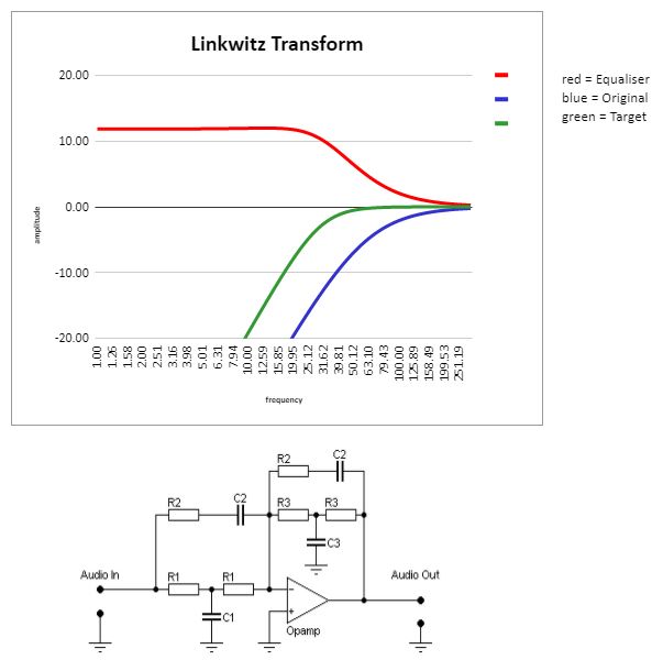

The transform circuit is 12 dB/oct highpass equalization and should allow me to take a driver in a sealed enclosure that has an Fc and Qtc for that enclosure and lets me "transform" or simulate a new Fc and Qtc for that driver in that enclosure.
Active Filters
In my example I have calculated the resistor and cap values (in spreadsheet floating around) to provide a 11db gain (red line in graph).

I have 15 inch woofers and excursion should be within xmax (or Xlim for that matter) with my limited spl requirements. Good to hear you liked it! More motivation for me to try it out.
It looks like the op amp route is the way to go. I will have to provide for a bypass so I can eliminate the op amp circuit from this elegant circuit if it ends up not to my liking after all.
